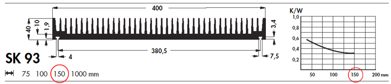

I'm thinking to get me two these, it seems like they will do the job.
Regards

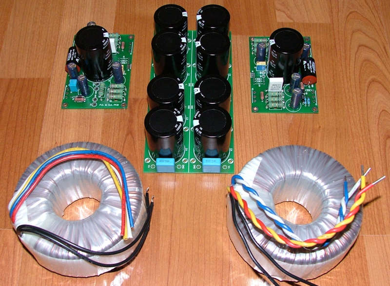

Amp Progress
Not to annoy any of you, but this is how far I got at the moment.
The big caps (Panasonic TSHA) arived today along with the 3W resistors. Most of the other parts I already had laying around.
Now I'm waiting for the heatsinks and fet's.:smash:
Regards
