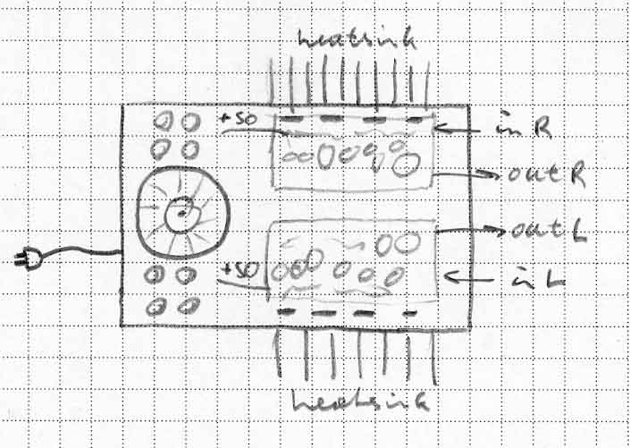

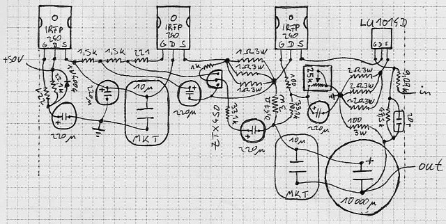

point to point mania
I have given it more thought and finnaly came upon the solution that will (hopefully) go into construction.
I think it offers small signal path lenghtht, em length (boy, my English is a bit blur today), actually it's designed to fit on one of them Eurocard/protoyping things.
I've checked a couple of times, but I don't guarantee that the design is free of wiring-mistakes.
The two ground-points should be connected "with a fat piece of wire" and then terminated to earth-ground via a resitor or one of them NTC things or else.
The pot will probably be a Bourns, cermet .5W.
Two remarks:
First, the power resitors should be mounted with a little distance from the PCB (maybe onto some individual stand offs where the big black dot are in the diagram) to allow some air to flow. There should also be some space to the right of the .47 3W Resistor.
The input resistor and the feedback network should be mounted at the bottom of the PCB. Else the power resistors will heat them up, which is bad if we want constant values. There will also be more space available on top of the PCB.
Second, the output-decoupling capacitors' placement is not ideal yet. As far as I know, bypass-capacitors should be placed closer to the load than the bypassed capacitor, which is true for the .47 3W resistor, but not for the 100 3W one. So there some improvement could be done. But maybe it doesn't matter dealing with such short distances. Your comment please.
Now some questions: How much power (VA) for the transformer? CLC-Filtering or will rectification and some big cans be enough? What happens if the value of the feedback-cap is increased?
Two remarks:
You can use a simple psu for this amp. The Capacitance multiplier clean up the supply rails really well. A couple of cans, say at least 30.000uF should do the trick.CLC-Filtering or will rectification and some big cans be enough?
A couple of 300VA trafos should be fine.
That P2P work look great.
