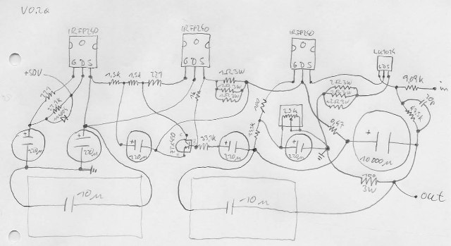

moe29 said:
Looks a little to busy for me to do it point to point...
Here's my take on a point to point solution, although it's not the desired star-ground solution.
And if smaller bypass caps are used, like 10uF polyester-film types, they can fit between the electrolytic ones, making it easier to use component's leads for wiring.
Cascode modulation ?
Can someone explain or provide pointers on how one determines the optimum modulation of the cascode tension?
Best regards.
Philippe.

plepez said:Cascode modulation ?
You can measure (or listen) to various values.
Hi Nelson, thank you for your reply.
If you allow 2 more questions on this subject …
So this is a purely experimental process; no theory and no calculation?
Will a spice simulation help or are we below the validity threshold of the models?
Regards.
Philippe.

plepez said:So this is a purely experimental process; no theory and no calculation?
The theory is straightforward enough - you can cancel
complementary Vds and Ids nonlinearities under the right
conditions.
You can calculate simulate this, but if you want to be certain
about the results you will test real parts.
Dear Nelson, thank you for you reply.
Ok, I have the feeling that looking at the curves published in Zen V8, I might begin to understand what it is about. I will try to simulate to grasp a better understanding but I will take your words about the real thing.
Best regards.
Philippe.
