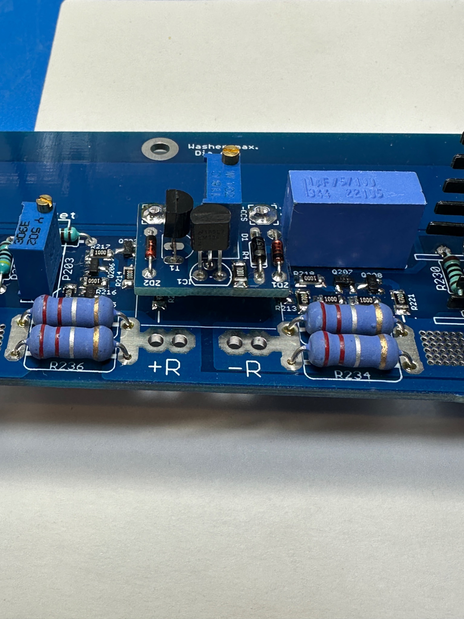

😆re-checked lq, offset and same for input buffers. Judged stability to be adequate, inserted JP101 + JP202.yes, but why?

Amp plays music. No buzz or hum. Will continue to burn in and periodically monitor offset.

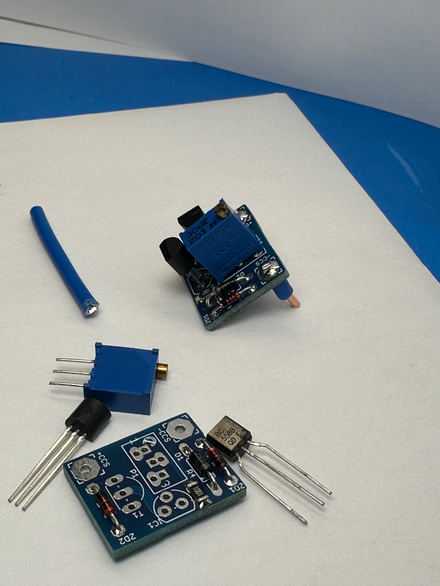

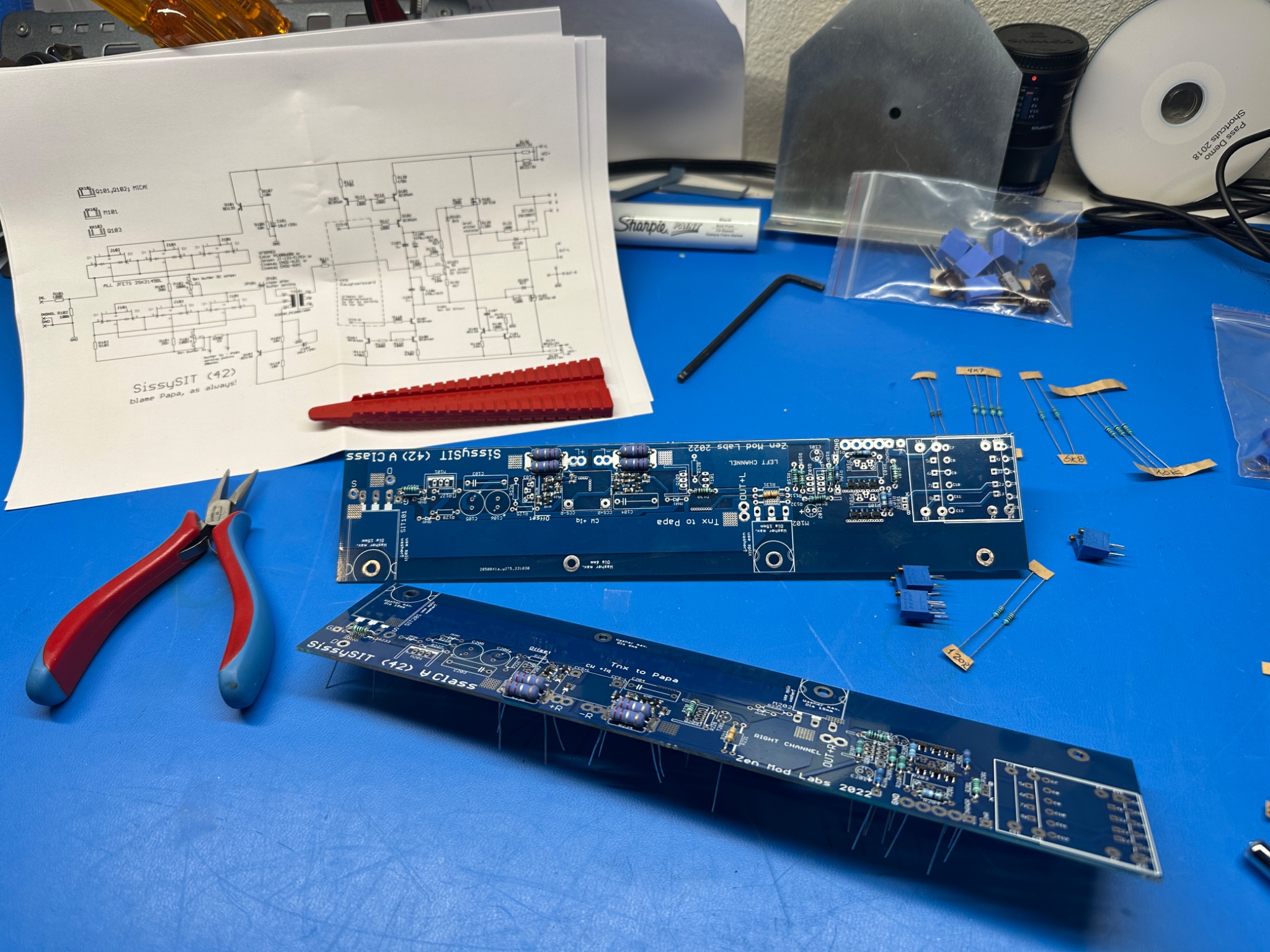

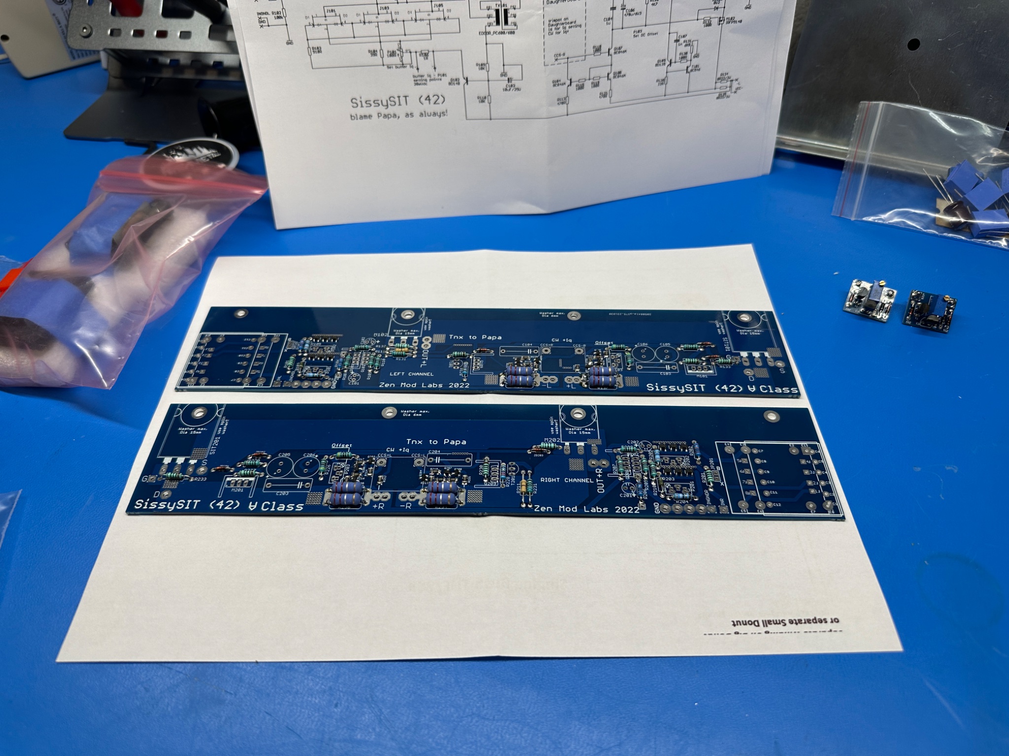

Quick build notes: Keratherm sourced from Amazon, the piece big enough to handle a few pairs of THF-H1S, traced and cut, punched out mount holes with hollow punch. The shoulder washers identified by Ben Mah from Mouser fit perfectly, though must trim length easy with a utility blade. @ZenMod great hint to use M4 studs to mount faceplate, 20mm stainless. Hardware assortments are nice, I like Belleville washers with grippy radial texture. 80mm M4 standoffs to hold up the PS boards above the chokes from eBay, had to slightly hog out the mount holes on the PCBs. Used dead old MOSFETS as main board standoffs, carefully measured depth of the live IRP devices stacked with Keratherm and matched that figure with thick paper shims on the standoffs so the boards are hung perfectly parallel to heat sinks. Chassis sourced from an excellent member of this forum, 40 year aerospace machinist did the drilling and tapping super accurate on the 5U 500s. Also, small eyeglass screwdriver works well to adjust trimpots. And I got the funny book:
