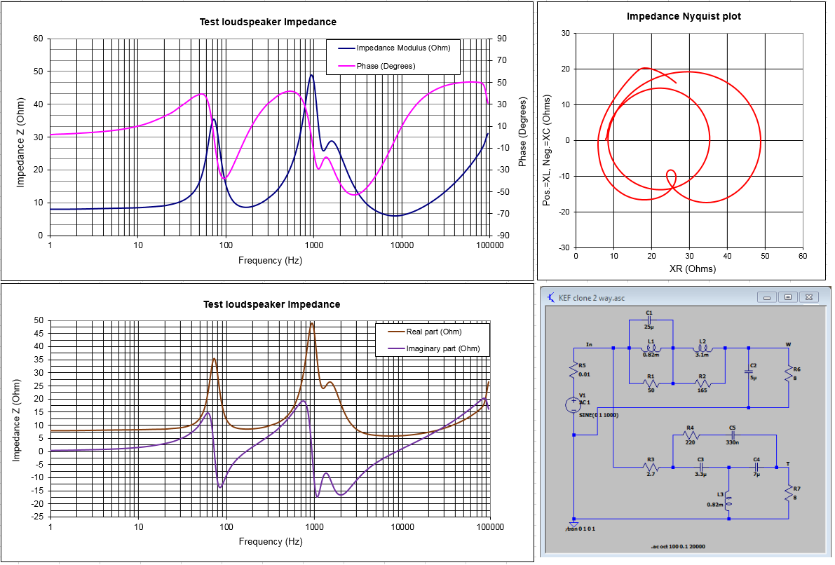

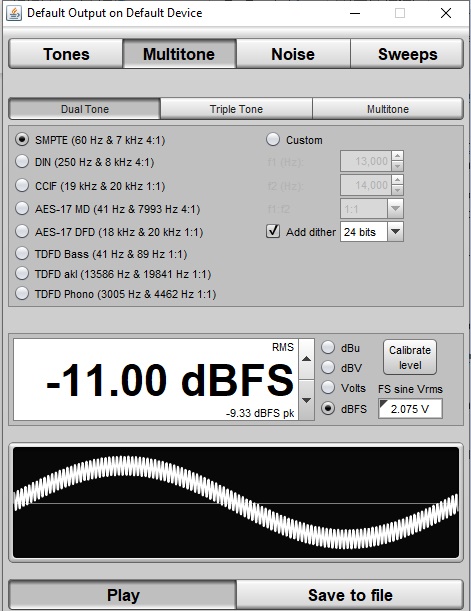

at which end of the wiring do you suggest I should probe for IMD, amp end or load end (or both)?
Also what IMD test of those REW provides (plus custom suggestion) for this loudspeaker?

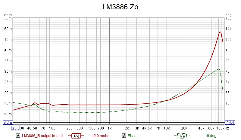

Amplifier will be an inverted LM3886 with low output impedance.
Pout (electrical) at 0.1W or 1W for the IMD test?

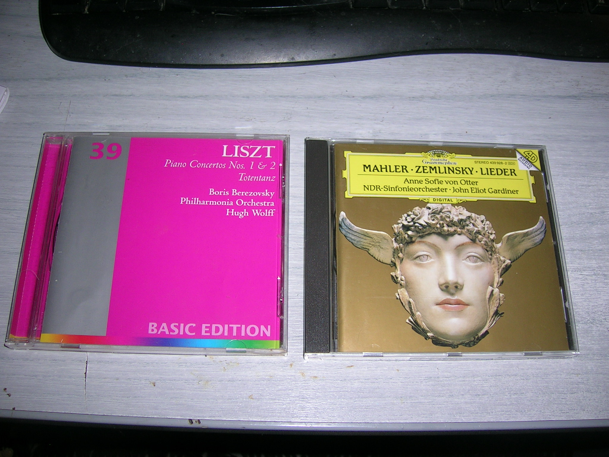

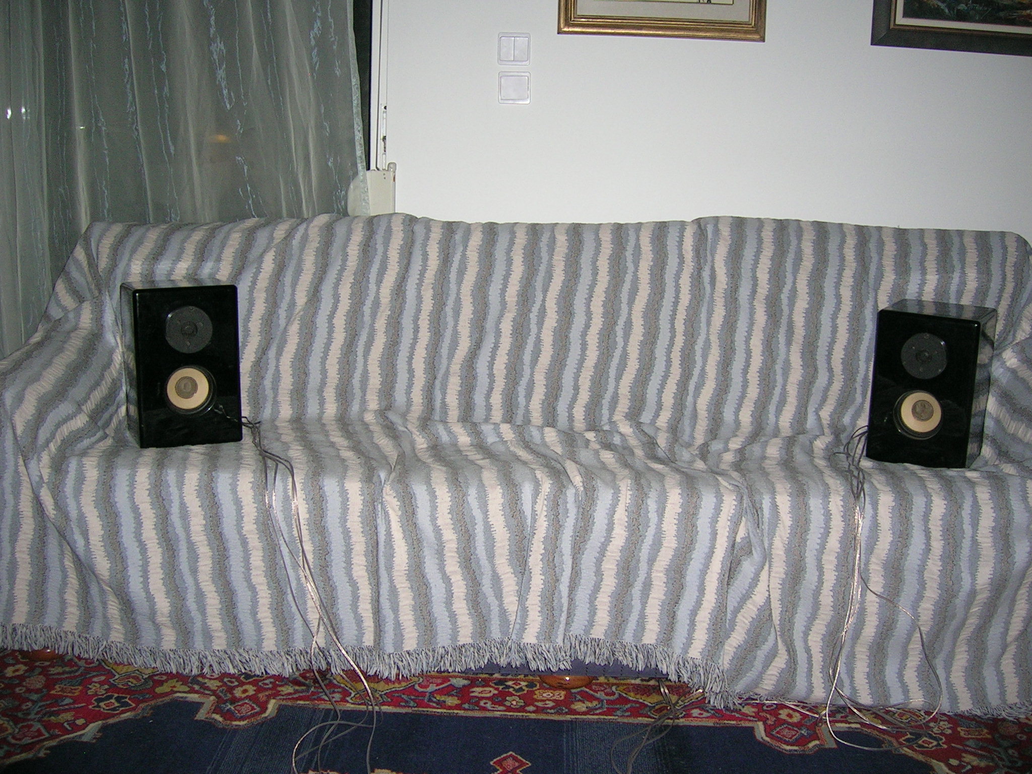

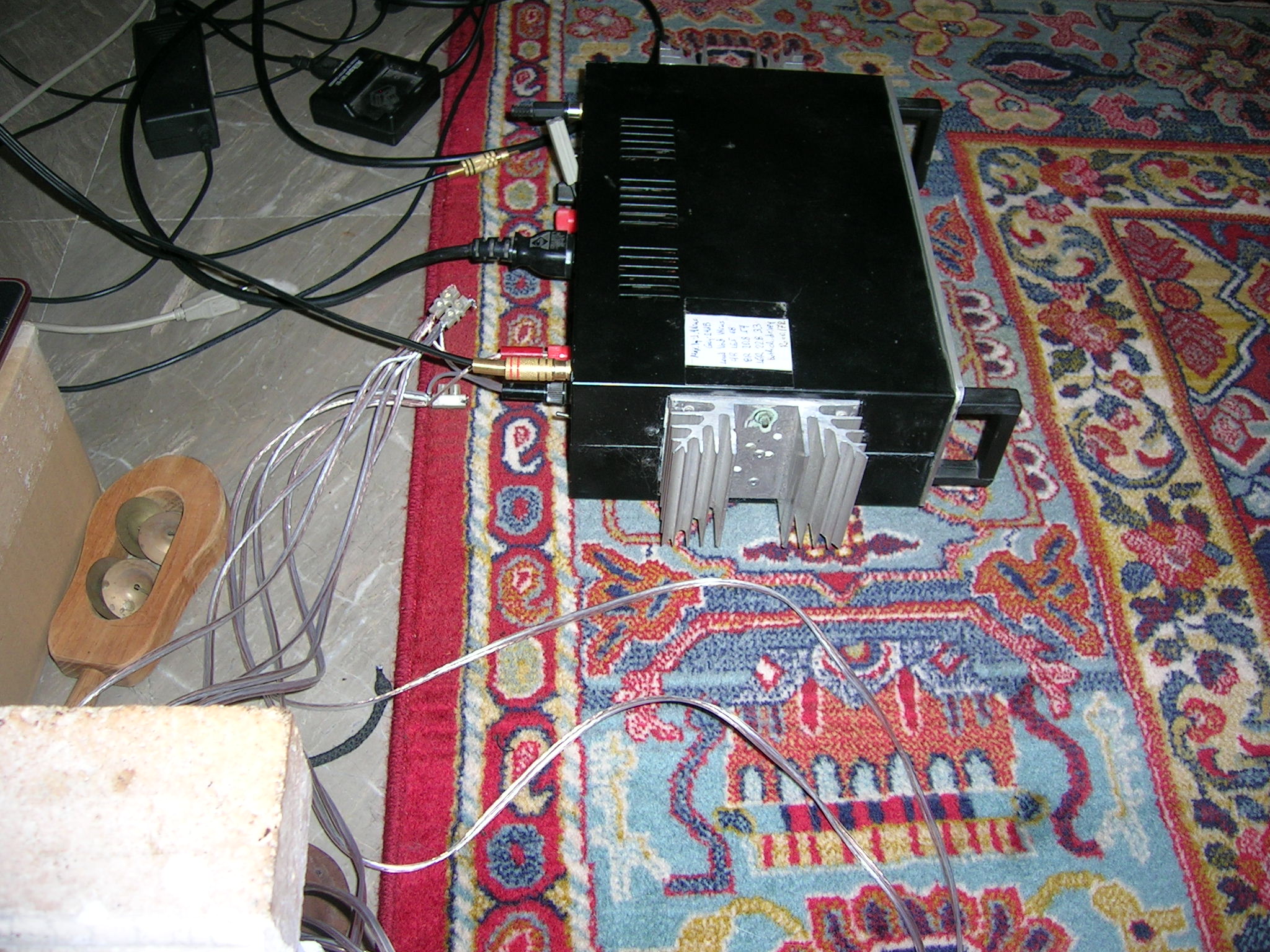

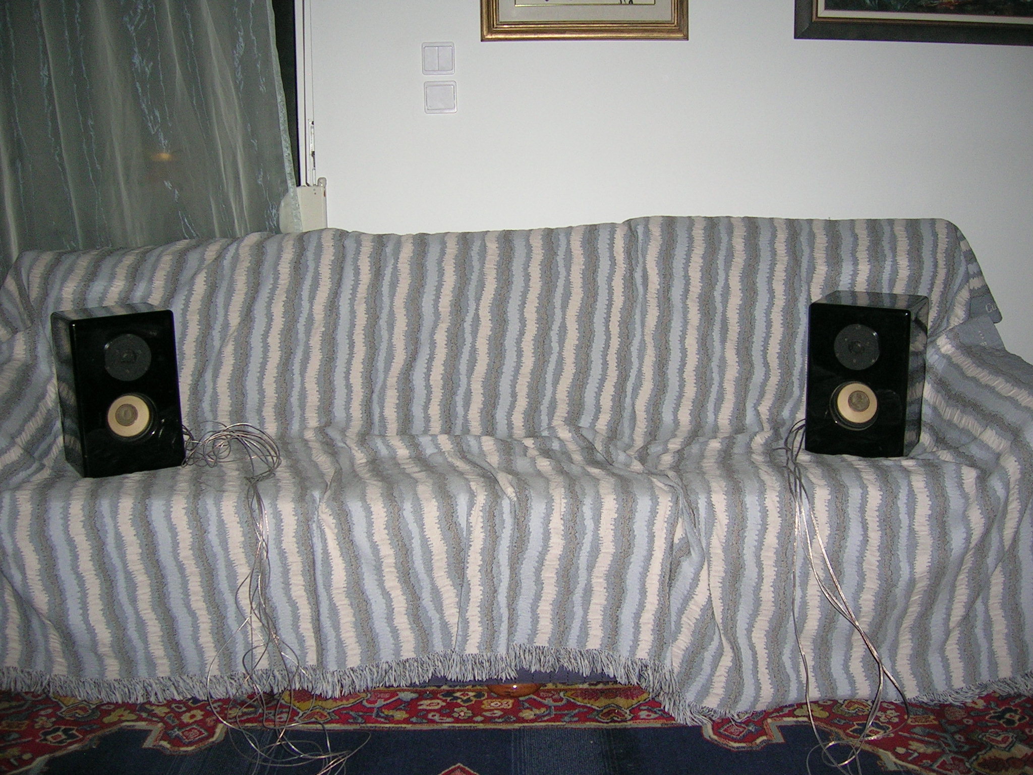

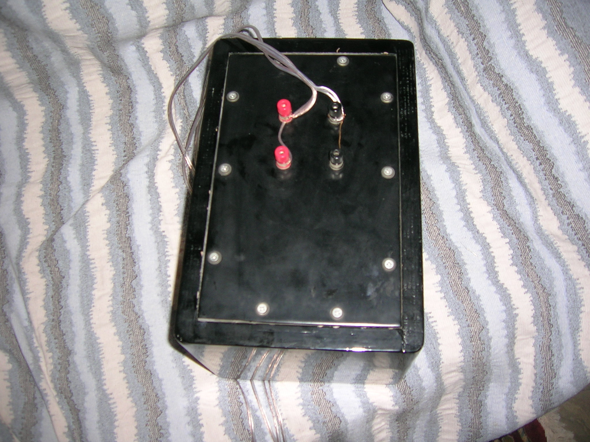

This afternoon I run the image centering listening test.
L and R speakers connected to the same channel of an amplifier.

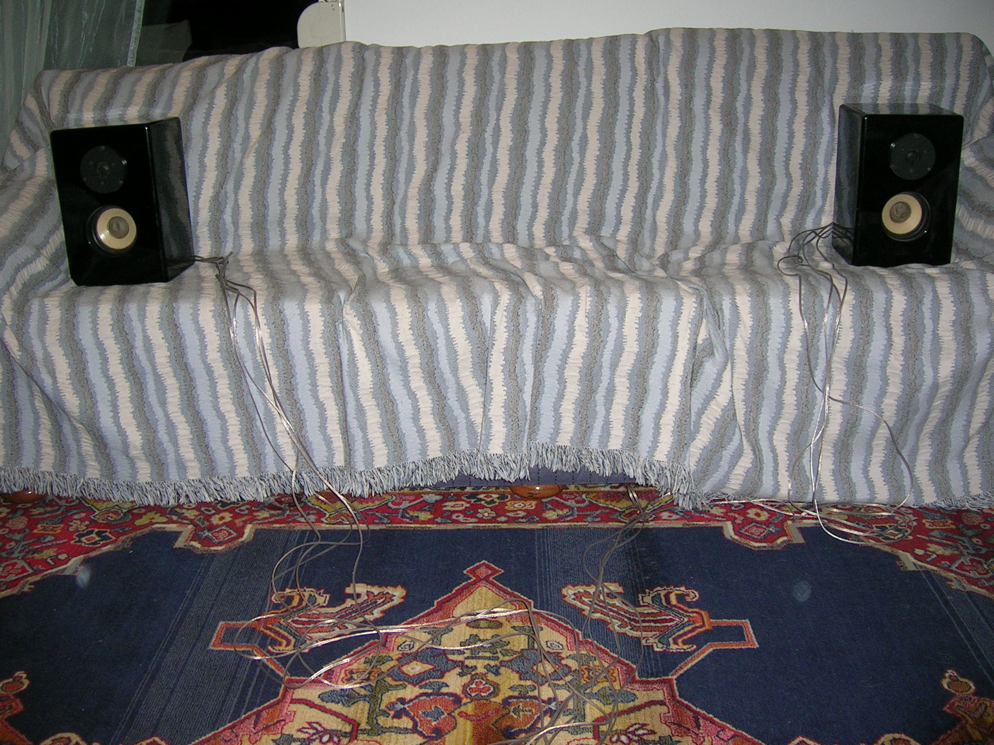

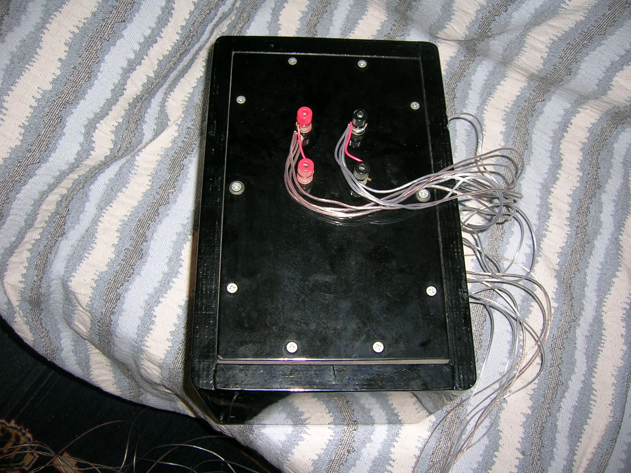

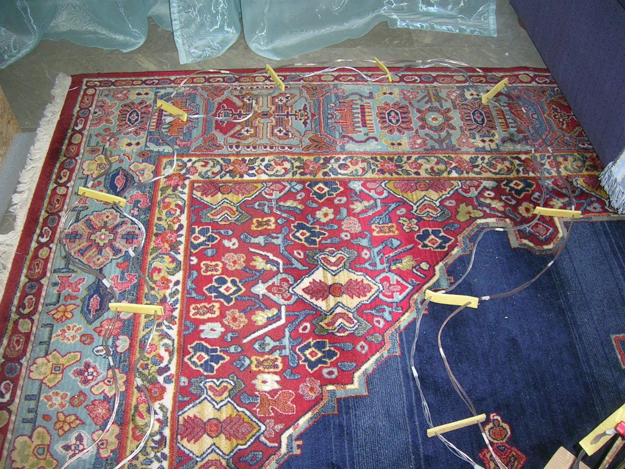

First run: Each 5m speaker cable bundle was four zip (2x0.5mm) cables parallel connected (all plus together, all minus together)

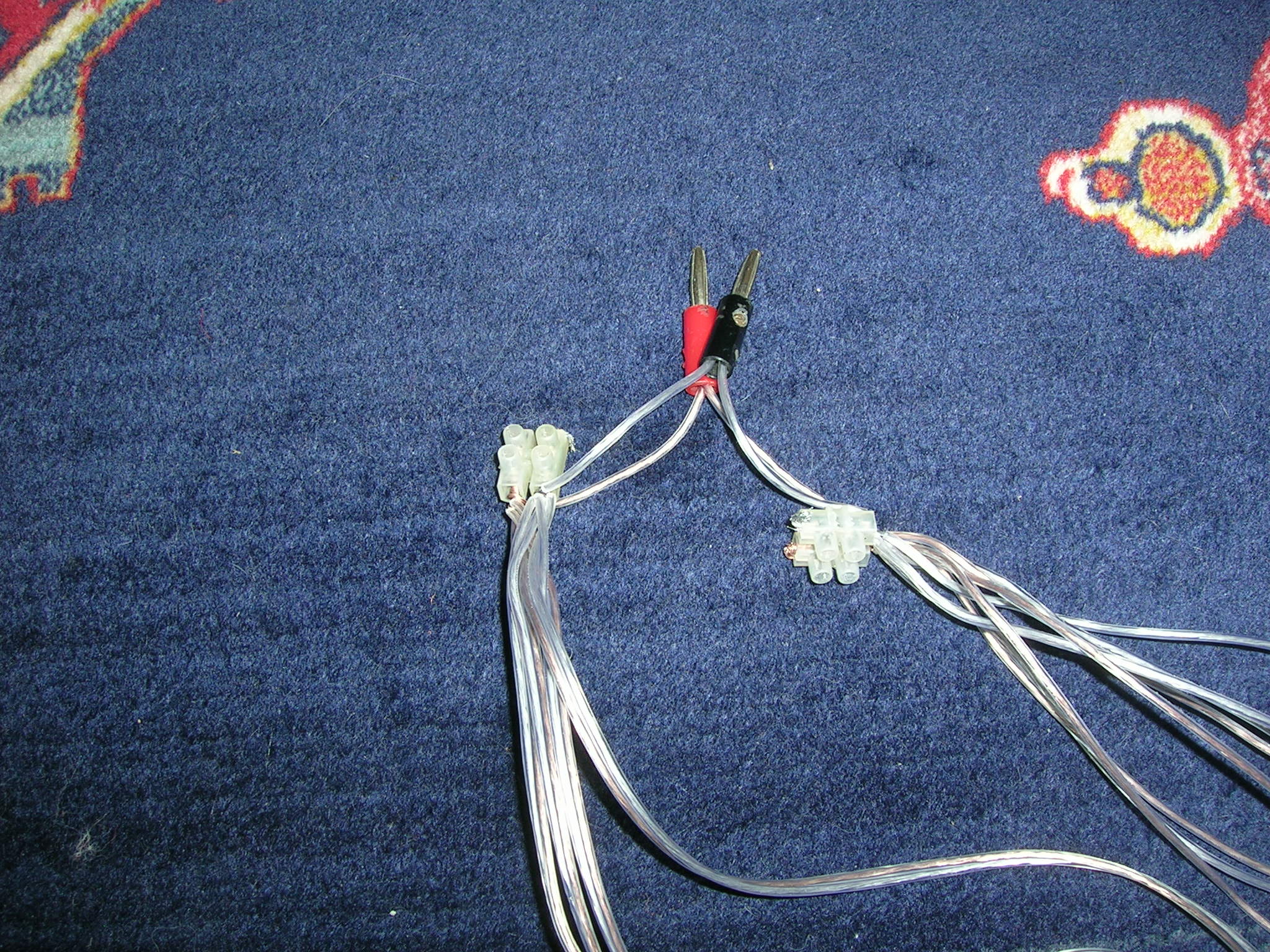

Second run: On the L speaker the four zip cables were split apart.

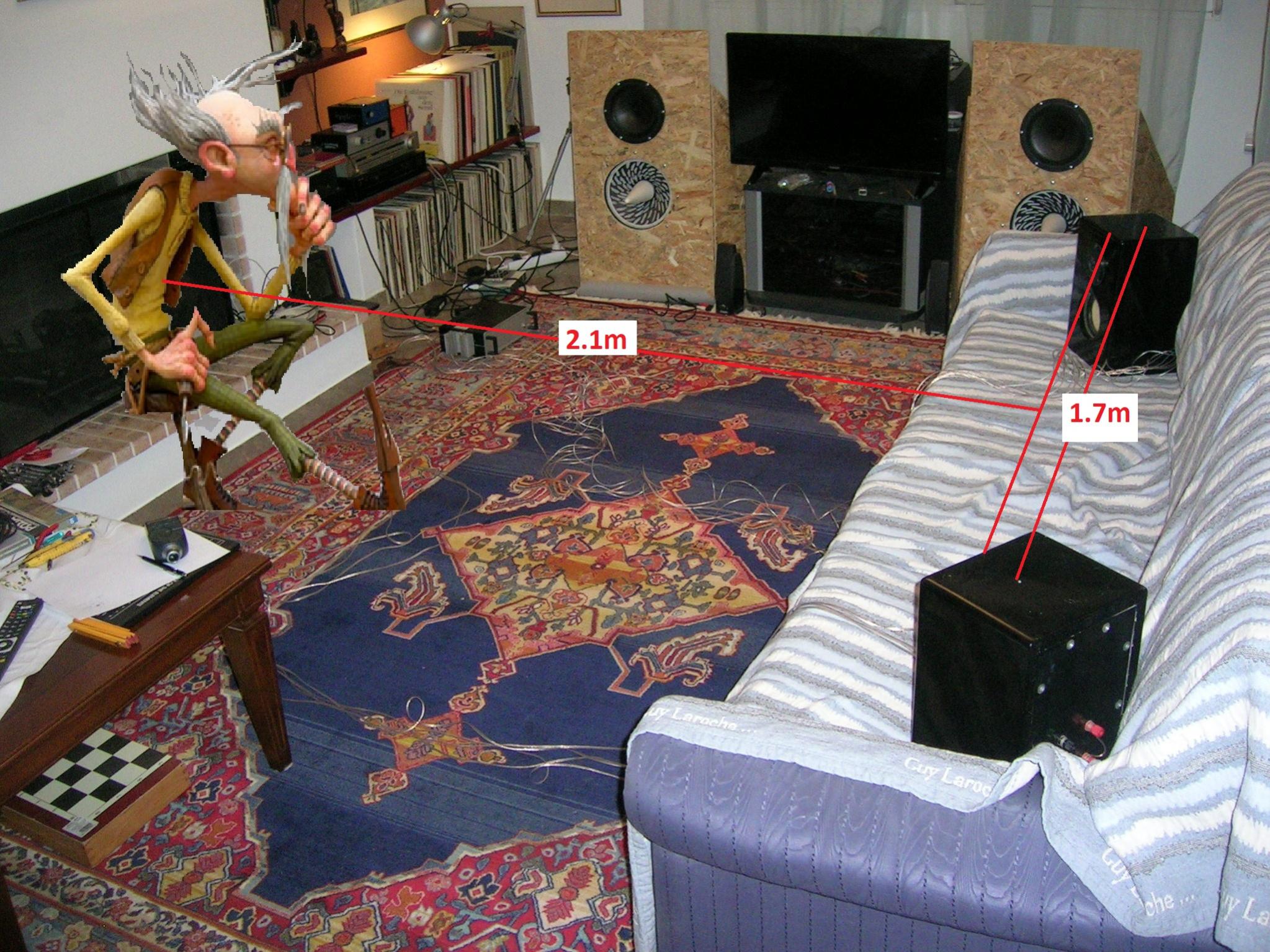

I had to toe in the speakers just in front of me for to narrow the center image in the middle. With a bit of practice I managed to bring my spatial sensitivity limit to +/- 5cm from center. After that I listened to the music for an hour on each run at two SPL levels. The low at 86dB max peak, the high at 92dB max peak
Unfortunately I couldn’t discern any difference btn the zip and the split cable bundles. Center image remained stable in the middle, same with zip and split cabling

Hi George,
Thanks for sharing your results.
Looking at your hair blown behind your head in the first picture, SPL must have been at hurricane level 😀 😀
Nevertheless, no differences could be heard between the two configurations, so this test did not reveal what I was hoping for.

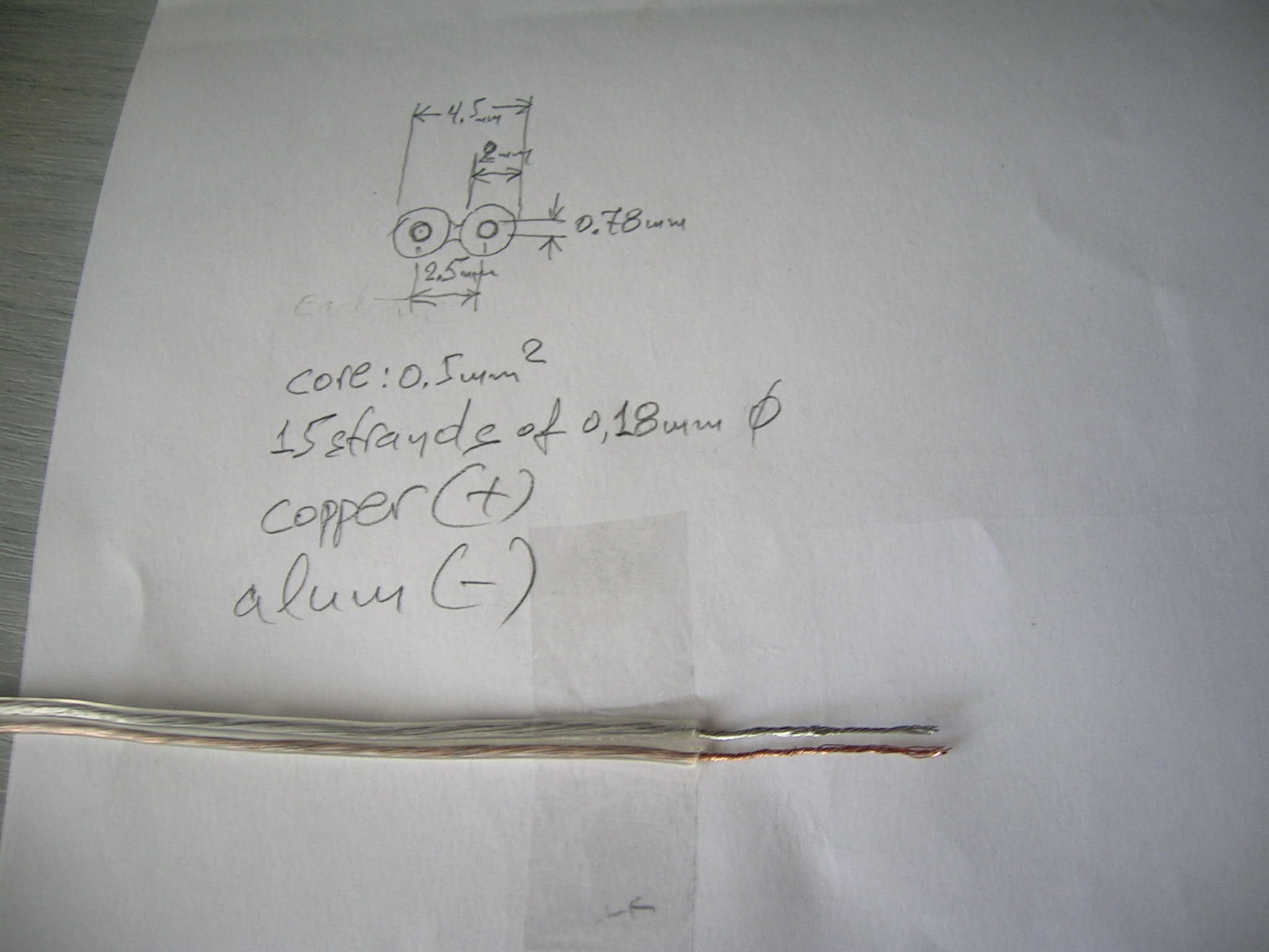

George,
What exactly did the zip cord look like that you used, diameter, number of individual wires and distance between the two conductors.
I will do a VNA test to get the characteristics when I have the exact cable details.

You will not get proper imaging with speakers on a couch. Too much recoil.
For small box speakers I have used small but stout wooden tables with these things between the table top and speakers: Recoil - Primacoustic
Don't mind their theory write up, the things just work.

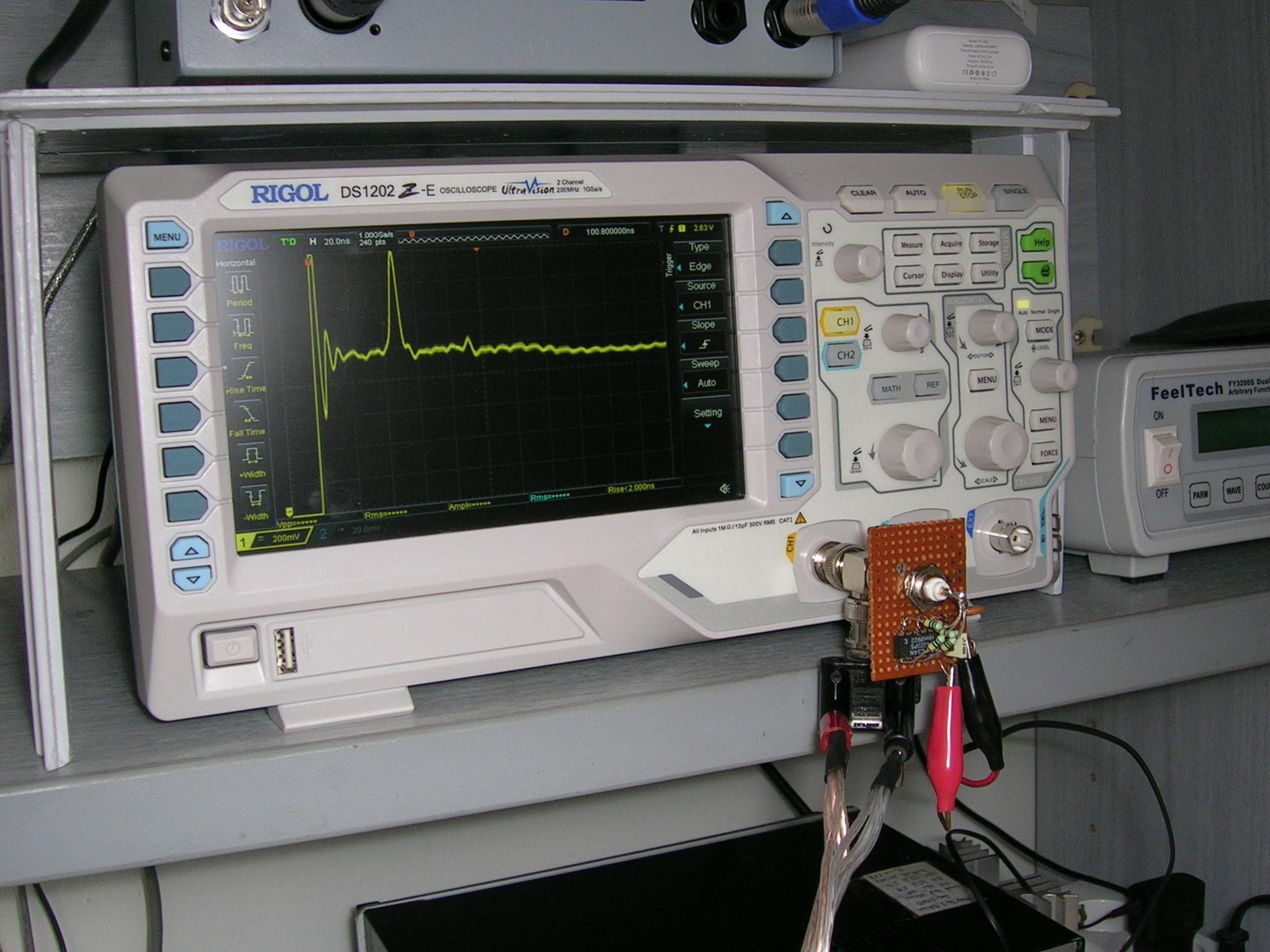

Hans, please see first attachment.
Using home brewed TDR (fast pulse generator, an oscilloscope, a potentiometer for cable termination and an Ohmmeter), I checked for characteristic impedance of cabling
Each zip pair shows 155 Ohm.
The four paralleled zip pairs show 38 Ohm
The four split paralleled zip pairs show 100 Ohm.
Little to no variation in those measurements while moving the cabling around.
Next I will use the DE-5000 LCR meter and an impedance sweep with REW for data up to 100kHz.

The four split paralleled is odd. Bundle the positives together, the negs together, and keep them at least 3-4 inches apart. You should be well over double the native zip.
The test is most sensitive when the speaker has a 20-30 ohm impedance in the 100ish hz range where we localize IID only, and a drop to 6-8 ohms in the midband where we localize ITD. If your speaker is flat through the entire range, there is nothing to see here...
And no need to apologize if you find nothing....it's just a test..
