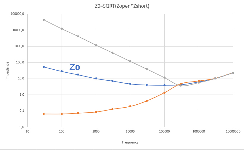

O.K. As long as it may help to trigger new ideas, here is part one.
With my VNA I measured Zo of my LS cable with Zo=sqrt(Zopen*Zshort).
Image below shows that Zo is quite a bit different when comparing it to coax or Zip cord.
At LF Zo is significantly lower, quite comparable to my ESL63 in the Audio range and at HF Zo keeps rising.
Tomorrow I will show the ESL's impedance for the same FR and try to calculate the Reflection coefficient rho=(Zl-Zo)/(Zl+Zo).
Hans

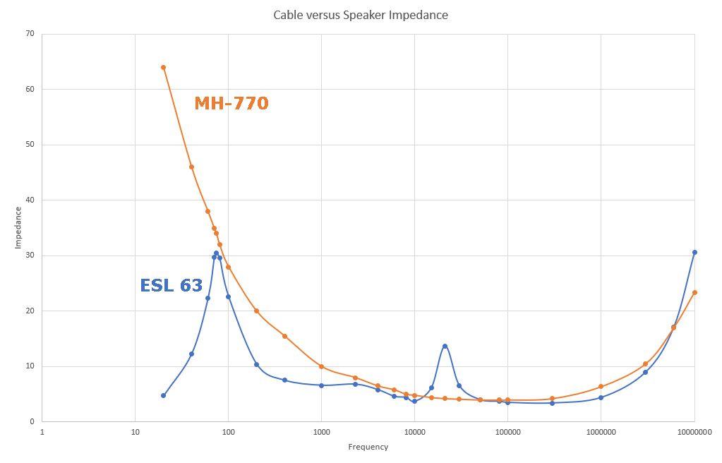

Here's the second part with measurement results.
First image shows the Impedance of my ESL63 speaker together with the cable impedance in one plot.
When matching impedances is important, they look as being made for each other.

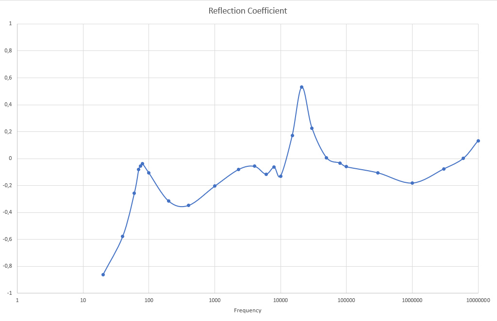

The second image shows the reflection coefficient, where Cyril Bateman found the cause of amplifier destruction in specific cable/speaker situations.
As can be seen, no Zobel network at the LS side will be needed where from 60Khz to 6Mhz the Refl. Coeff is slightly negative meaning harmless minor reflections in opposite phase, where in Batemans paper it was almost +1 without R/C termination.
Since I subjectively prefer the sound of my LS cable above a simple Zip cord, it could be that matching impedances between cable and speaker is more important than I ever thought.
So if true, reflections must be playing an important role.
Hans

Ah, MIT-MH-770, I couldn't find "LS", so had no idea. That cable has that bol on the end, I'm sure it is a high capacitance cable set for low impedance in the audio band, and a zobel on the end to prevent the amp from seeing a capacitive load when the speaker climbs to high impedance.
Seems the high capacitance reading thing is solved.
Thanks Hans :up: Can you explain how you measured the impedance of the ESL and the cable? You are able to measure very high in frequency. Can you also explain the reflection coefficient?

It is both. If you examine Cyril Bateman's papers, you see that he has done both, calculated the coefficient for a speaker line and a speaker load, and measured it by use of a reflection bridge.
Hans used a VNA to measure.
If you look at the high frequency reflection coefficient he posted, note that it doesn't stray too close to +1 at very high frequencies. If remained high positive at a frequency where the amplifier gain goes through unity, the amplifier could oscillate. A zobel is used to keep that reflection coefficient low, as close to zero as possible at the high frequency.
jn

Hi Pano,
Basically a VNA puts a resistor R in series with a the DUT with impedance Z.
When the voltages on both sides of the resistor R are called resp. A and B, then B=A*Z/(Z+R), or Z=R*B/(A-B), that’s how the impedance is measured for resp open cable, shorted cable and LS.
Cable impedance is then calculated with Zo=Sqrt(Zopen*Zshort)
The reflection coefficient is calculated from the first image, being Rho=(Zl-Zo)/(Zl+Zo)

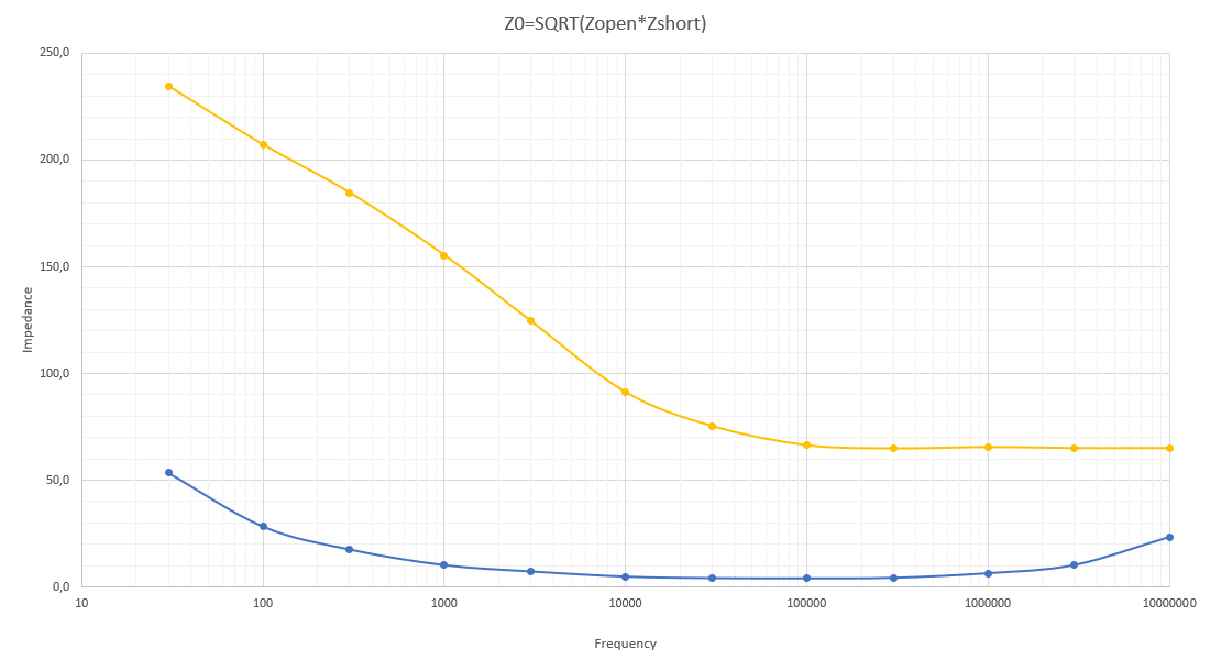

Just for completeness, the image below shows in yellow the impedance of the Zip Cord that I used for the test in #30 with two different cables connected to one main amp.
The Blue line is the impedance of my LS cable.
Hans
