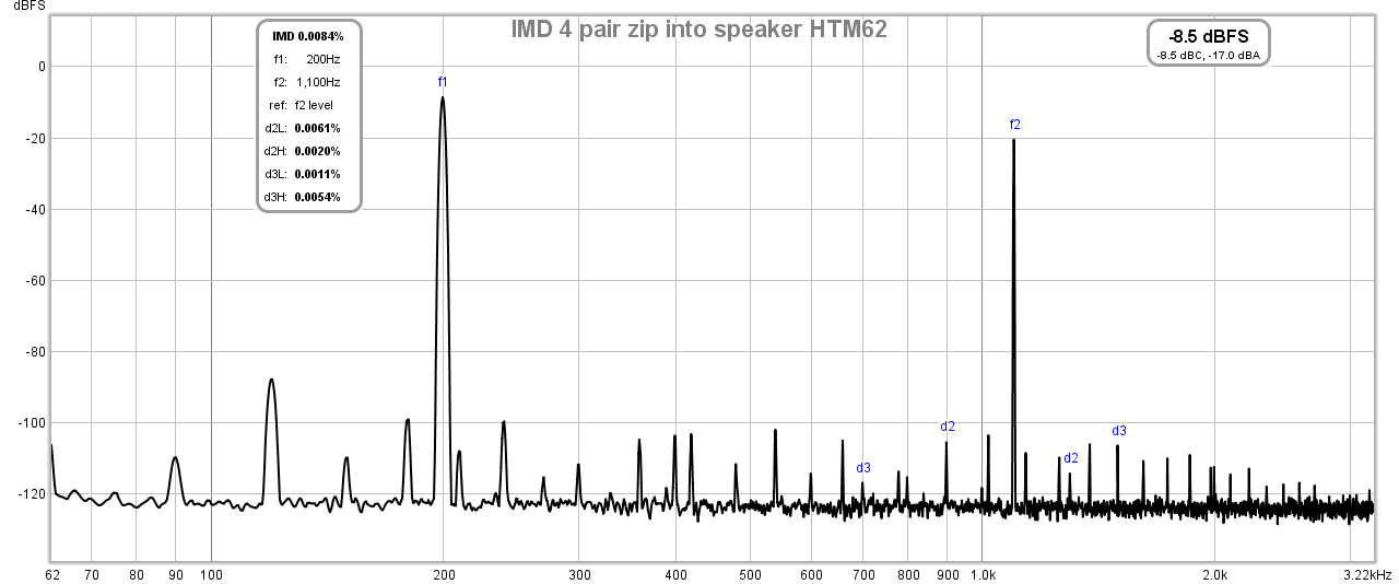

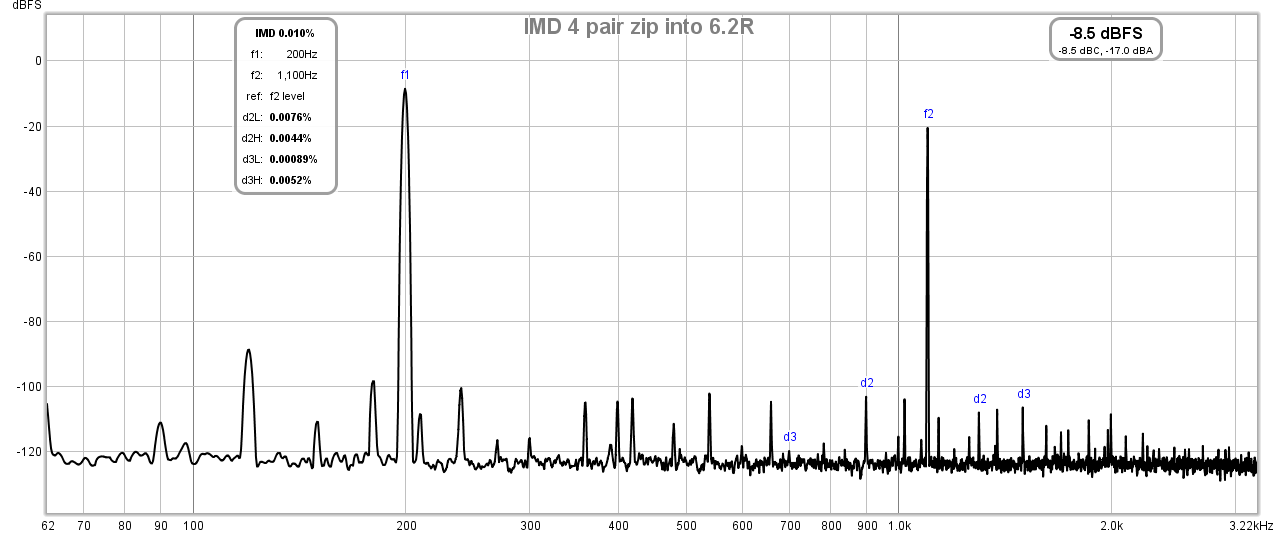

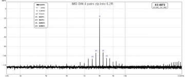

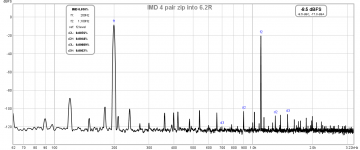

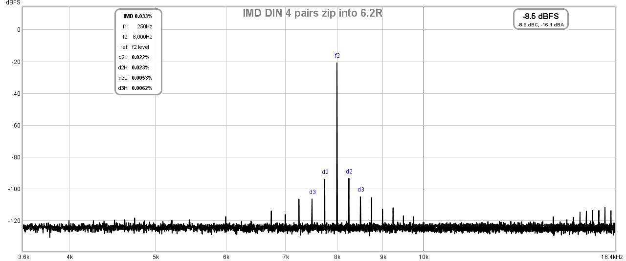

Here is a first attempt at IMD. I had to dig out an old M-Audio Fast-Track USB card because the IMD of my Behringer card is so high - typical Behringer analog circuit. 🙁
Here you'll see the IMD of both DIN and a custom frequencies played thru the 4 pairs of zip wired and into a 6.2R resistor and into the Bowers & Wilkins HTM62 speaker. The Amplifier is a Yamaha V-2700 receiver in bypass mode. Please let me know if this is what you're looking for.

I couldn't find the crossover freq for that speaker, do you know what it is? To have any effect on IMD, the two frequencies have to go into the same driver.
What is being used to measure the IMD, the speaker doesn't seem to have any IMD beyond a pure resistor.

I assume that the crossover is at the ~2.2K impedance peak. That's typical of slightly underlapped filters.
I do have two of the fullrange and also two of the small B&W that go with the center speaker.
For measurement I am using an USB audio card. It is the M-Audio Fast Track. I also have a Fast Track Pro if I can find it. RCA line level out of the card into the Yamaha left channel. Thru the 4 zips to the speaker. The picked up into the 1/4" line input of the M-Audio.
Interesting, it isn't picking up any IMD from the speaker...

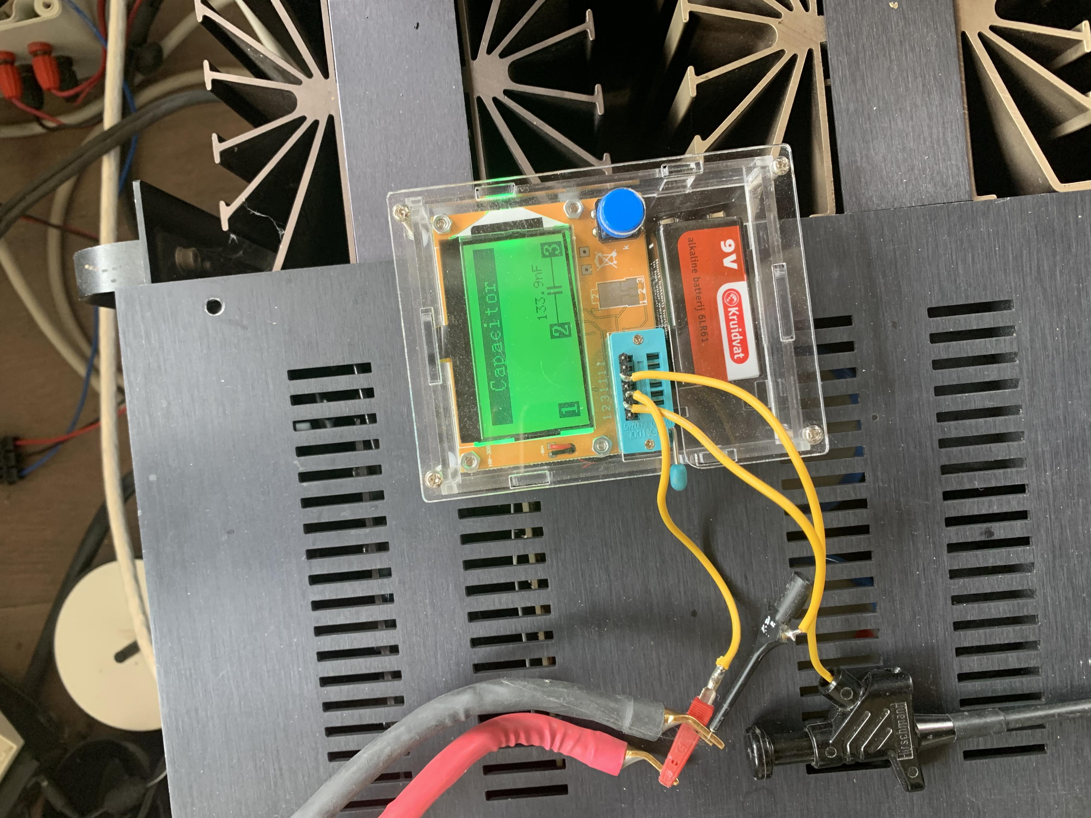

Because I promised to do a test with different cables connected to one amp driving in this case two ESL63 speakers, that's what I just just did with two different cables, both having the same length of 3 meter.
One zip cable with 2*1.5mm^2 having 986pF and the other one being my standard speaker cables with 134nF each.
Probably some will declare me to be mad, but I heard a big difference, although at my age the last thing I want to claim is to have golden ears.

Thanks Hans for that. Did I read it right that one cable is over 100nF? That seems very high to me, is it?

I can only agree that 100nF seems insane, so I could measure the cable impedance with resp. open ended and shorted from 100Hz to 10Mhz.
I measured the capacity in two different ways giving the same result.
Hans
P.s. will also measure the impulse response on both sides of the cable.
