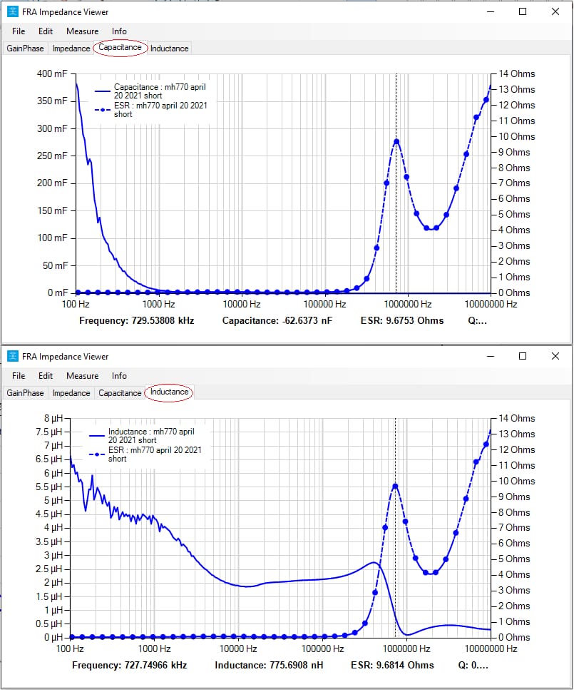

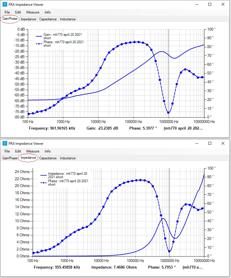

Hi Hans
Apologies for not responding so far.
I try to think of ways to make use of imported V1, V2 data from a soundcard taken using the std impedance jig
The SW works fine with your test file (Log Freq, Gain, phase), see attachments (Question. What is it that you have measured there?)
George

Glad to hear you got it working.
The file I sent you was the shorted LS line that I showed in orange in this posting
Zip cord for speaker test
Difference is that Imp Viewer has a linear vertical scale versus the log scale that I used.
Succes wit this tool. As long as you offer a .csv file in the right format, you can use it for anything else as long as the series resistor is connected to the source and the DUT between the resistor and gnd.
The topology you once used with a virtual gnd connection will need different algorithms.
Hans
P.s. Have you seen that when moving the cursor over the image, the line below the image tells you exactly the details in the image. Very helpful.
