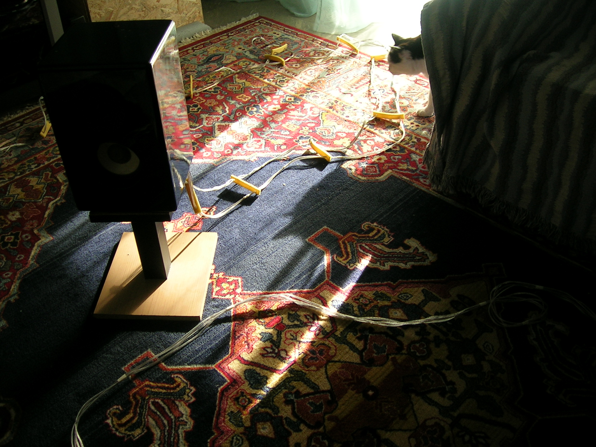

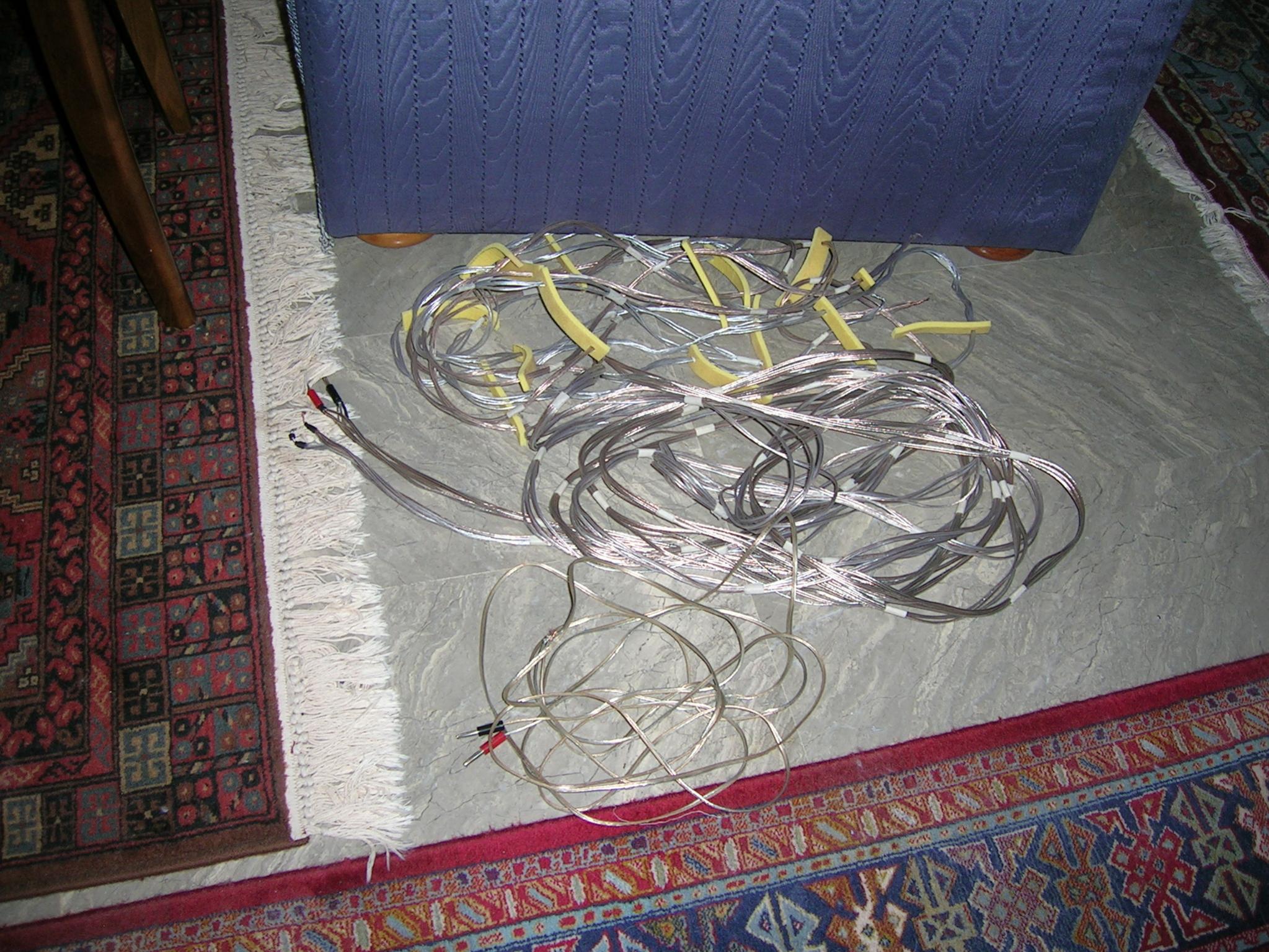

Zip cord for speaker test
Waitaminute.....
And don’t you ever again call my wife’s precious (*) carpet a ‘rug’
Persian carpets are well known for their vibration damping and antitriboelectric properties, the perfect Hi-End cable lifter.
Then the 3 inch spacers are made from a space-age material, direct out from secret labs. I painted it yellow for not to attract attention from the intelligence community.
Hans, the other bundle is 4 zip cords unsplit
George
(*) it smells wool when it comes in contact with the soldering iron

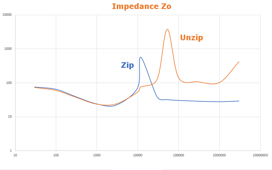

I tried to determine the char. impedance Zo for the zip cord that George used.
Results below are for 5 meter 4 parallel zipped- and unzipped cords.
Doesn't look like the best solution to connect your speakers.
Hans

Hans, how did you produce these Zo traces? They look a bit strange

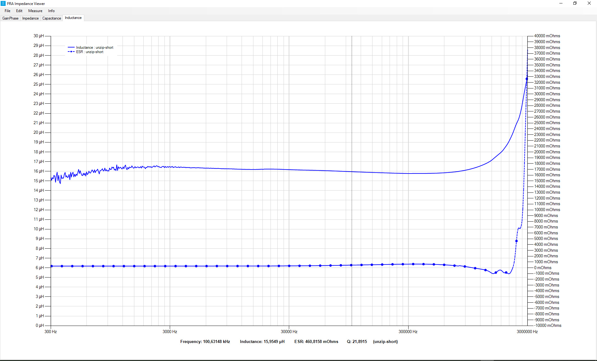

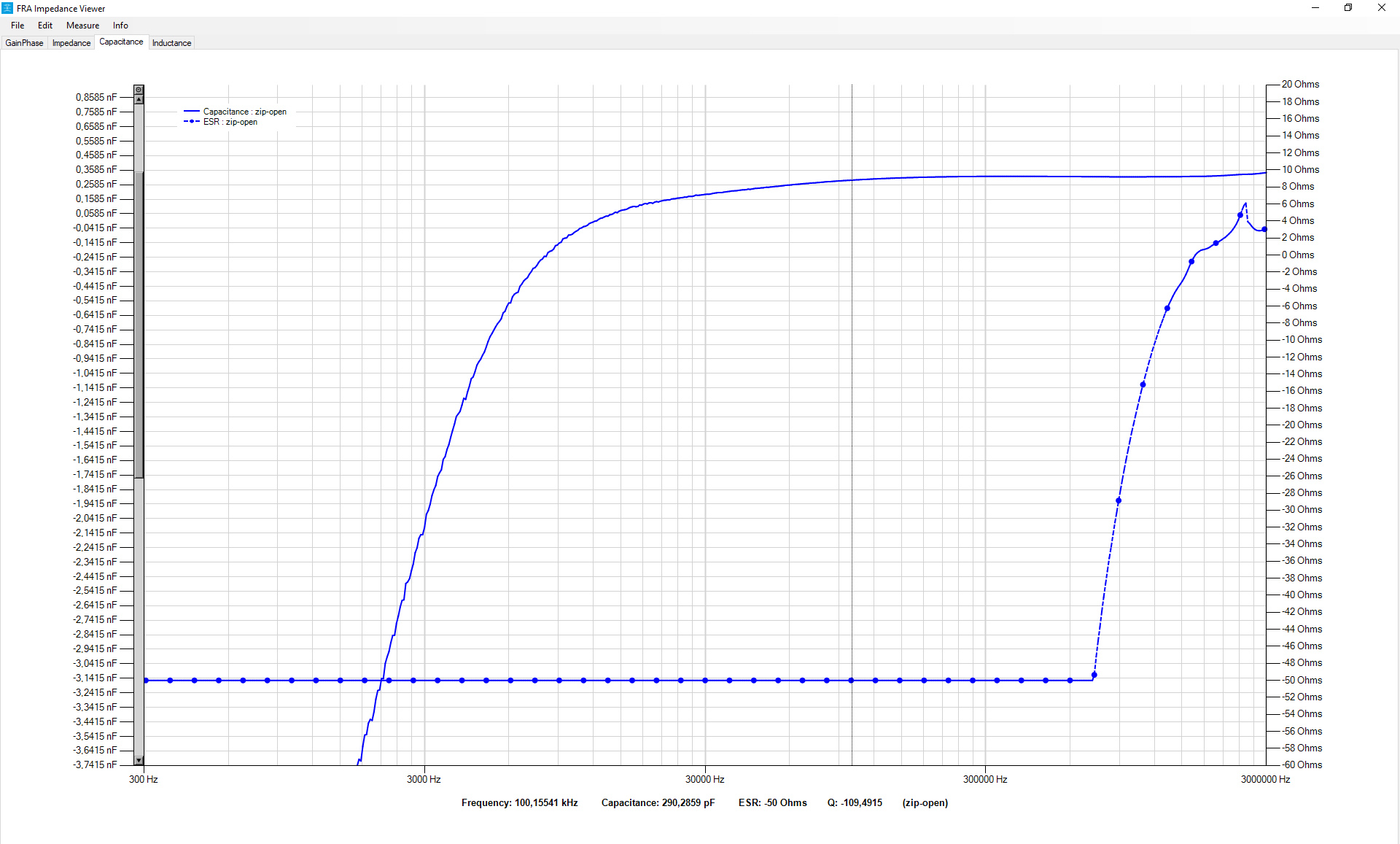

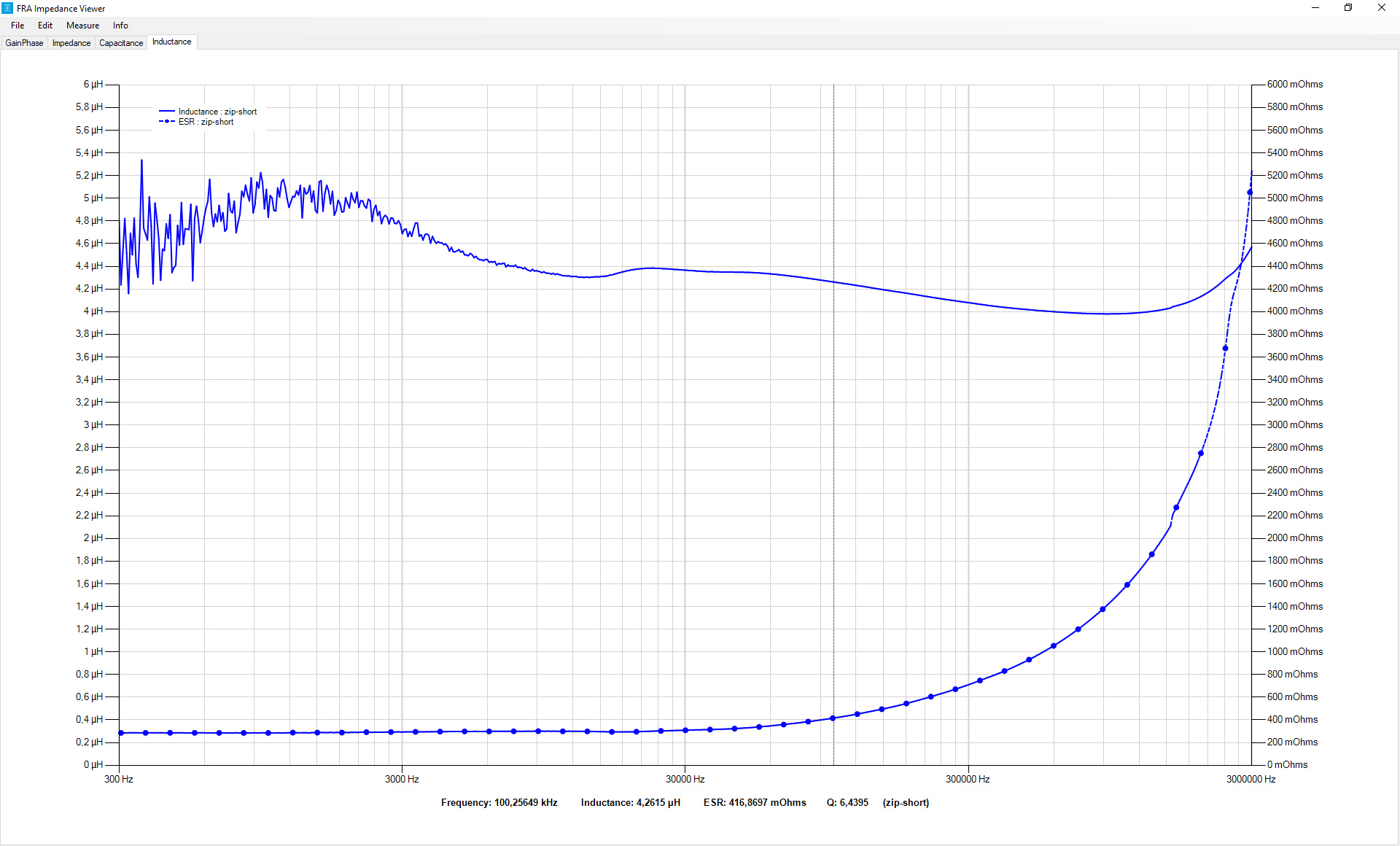

I agree that the traces are looking weird, but that's what my VNA setup returned.
Zipped at 100Khz: 4,3uH+275pF resulting in 31R for 4 zips, close to your result.
Unzipped at 100Kz and spaced far apart: 16uH+34pF resulting in 171R for 4 unzipped.
The 275pF and 34pF being already corrected for the 15pF probe.
But that is just for one single frequency, and taking Zo=sqrt(Zopen*Zshort) gives an exact result because it also takes into account the R and the G of Zo=Sqrt[(R+L)/(G+C)].

George,
Looking at the above images:
At 12Khz for the zip version, L=4,3uH and C measures 0pF.
Same for unzip at 63kHz, L=16uH and C measures 0pF.
So taking Zo=sqrt(L/C) leads in both cases to infinity.
Only G is preventing this from happening, but still results in a high impedance, as can be seen here
That your unzipped impedance is so much higher, means that you are closer to the point where C measures 0pF.
Hans
I thought the Z plots were a result of simulation.
The discontinuities are a result of calculation. I agree that the later formula is the one to use.

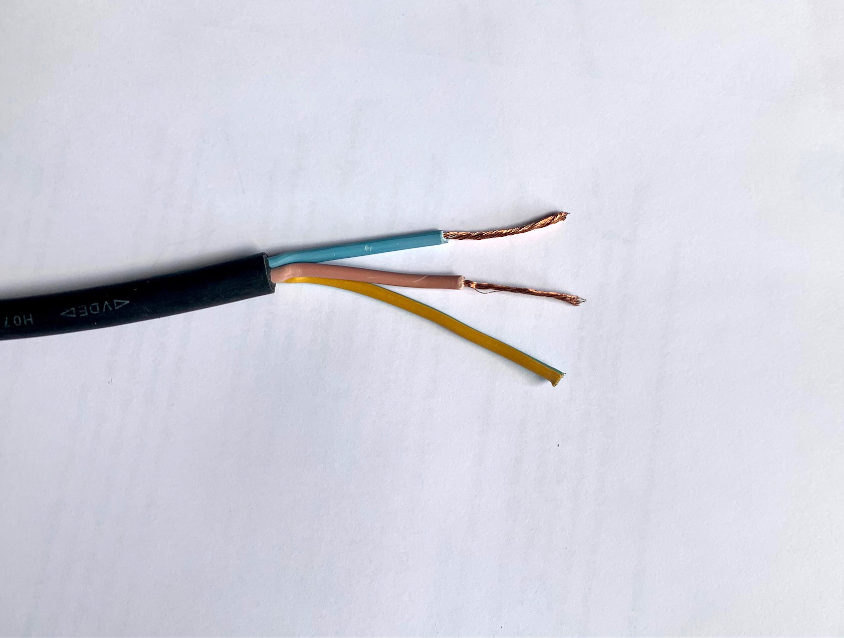

Hi George,
I'm rather surprised by the odd characteristics of this zip cord.
The cable that I showed here with the yellow trace
was a 45*0.2mm or 1.5mm^2 power cord, internally twisted, of which I only used 2 of the 3 conductors, see image below.
This cable obviously has a "decent" char. imp. gradient versus frequency without the large peaks of the zip chord.
However, since this cable subjectively produced inferior sound to the MH-770, it would probably be a complete waste of money to repeat John's test with this cable.
Hans
