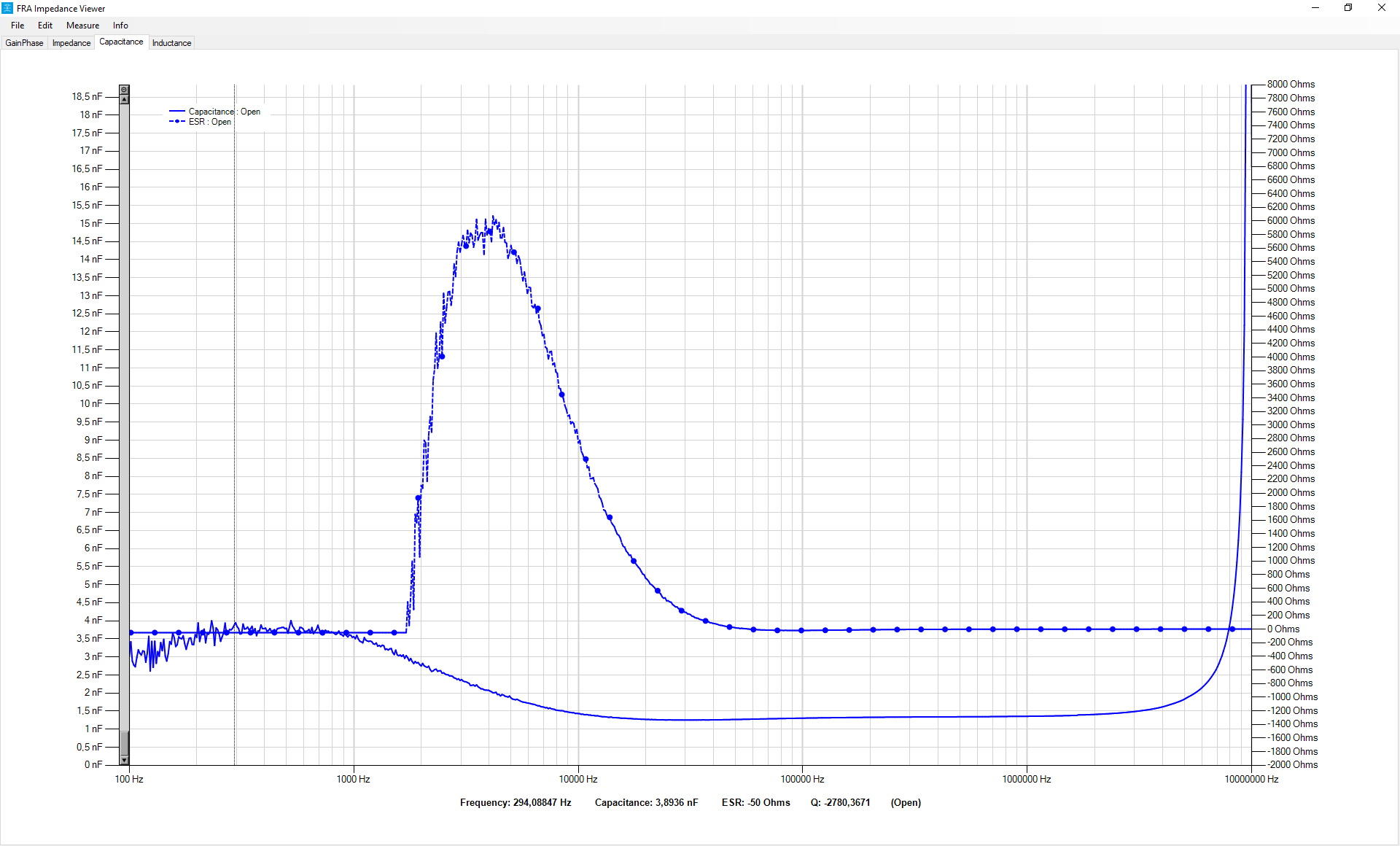

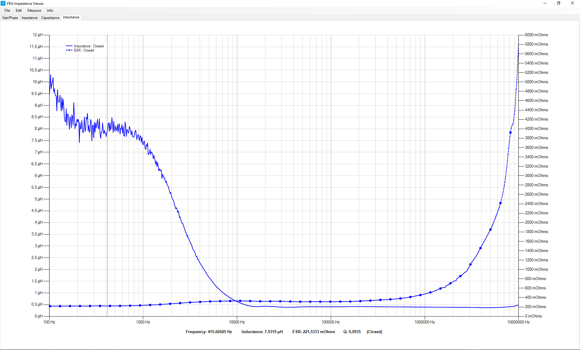

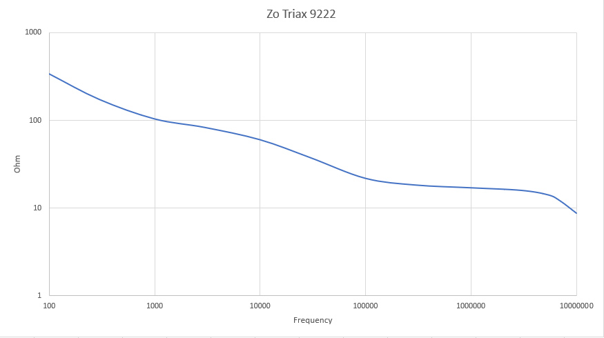

Here are resp. the Char. Imp, the Capacity open ended and Inductance with end shorted for a 3 meter 9222 Belden Triax cable measured between the two outer shielding layers.
Doesn't look like the ideal speaker connection to me in this form.
Hans

John,
Neither did I, because so far I was never interested in the so called superior technical aspects of a speaker cable and only trusted my ears.
But after having recently measured my own LS cable, I was astonished how close the Char. Impedance matched the impedance of my speakers.
Perhaps I fool myself, but to my ears the sound of my cable is far superior to zip cord or whatever other simple type of connection.
So it could be that impedance matching is much more important than I ever thought.
In that case this triax cable does not have the right impedance form. :D :D
Hans
Luckily I can confirm that the calculations I used for finding the Char. Impedance were correct after all because I used the impedance measurement of the used FRA Imp Viewer.
However the images showing capacitances are wrong most of the time, because of a simplified calculation that may give erroneous results in some cases.
But the impedance calculations are fully correct, so all the images relating to impedance and Char Impedance in this thread still hold.
Pfffff.....
Hans
Still frustrating is that I couldn’t convince the author of the program of his wrong calculation.
When Z = A + JB and you want to calculate the capacitance, then
1/jwC= A + jB
His aproach is in that case to say jwC = 1/jB or C = 1/wB
Because j are in the numerator and in the denominator, this is wrong.
Correct is: jwC = Im( 1/(A + jB)
Solving this gives jwC = jB/(A^2 + B^2)
or C = [B/(A^2 + B^2)] / w
When A is very small, both formulas give equal results with 1/Bw.
So sometimes the result is o.k. but most of the time it’s not.
Hans
