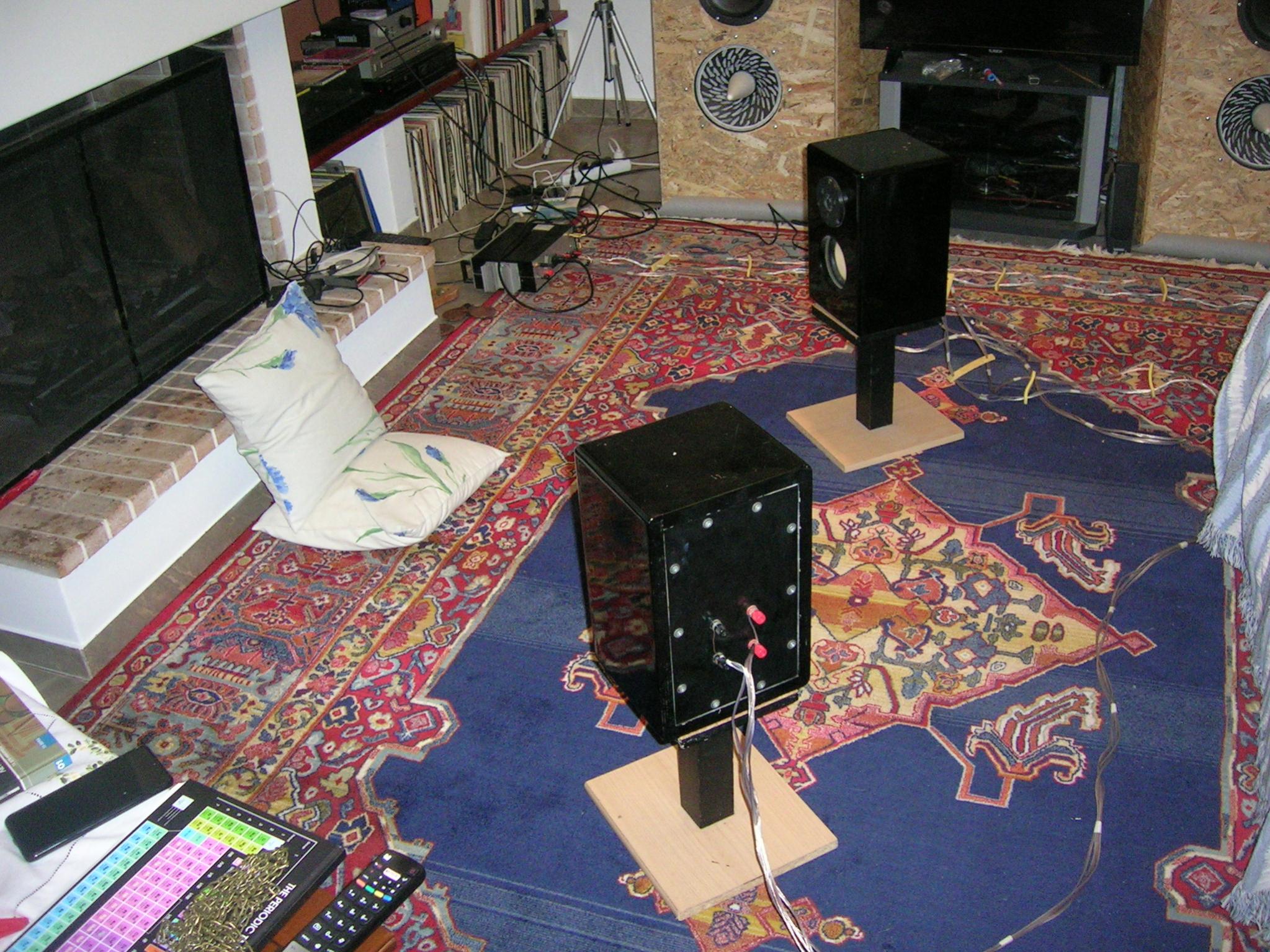

Zip cord for speaker test
How do we get on from here ?
I’ve done impedance sweeps on loudspeaker alone and on loudspeaker plus the cables.
I’ll see what I can do by subtracting the sweeps in Excel (I need some time).
Then IMD tests
And center image listening test.
On this, I followed Mark’s recommendation Zip cord for speaker test
In my case it helped a lot by reducing room influence due to close speaker positioning. Thank you Mark!
Please let’s all try to keep this thread focused on the specific technical issues
George

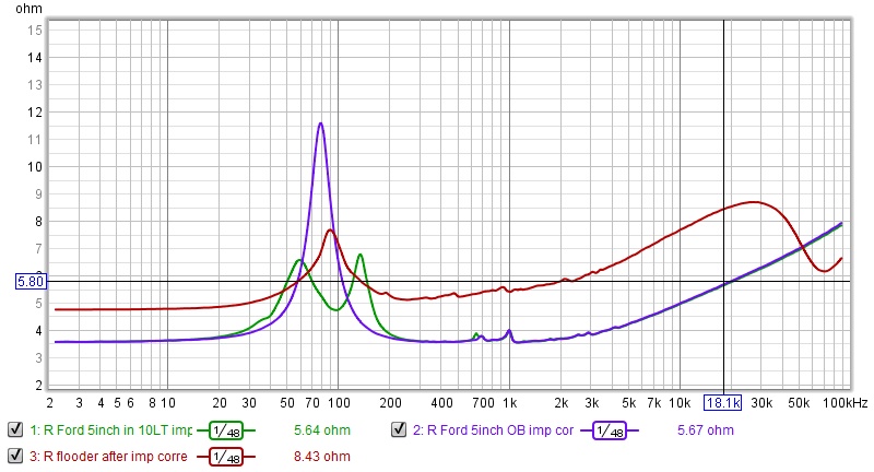

Please tell me which of the three impedance profiles is a good candidate for the test speaker?
After choosing the one, which two test frequencies for IMD test on it?

George,
Purple looks best as it has a LF impedance peak and a long valley in the human ITD sensitive range.
Choose a freq at that peak and one at the lowest point in the valley for IMD.
John
