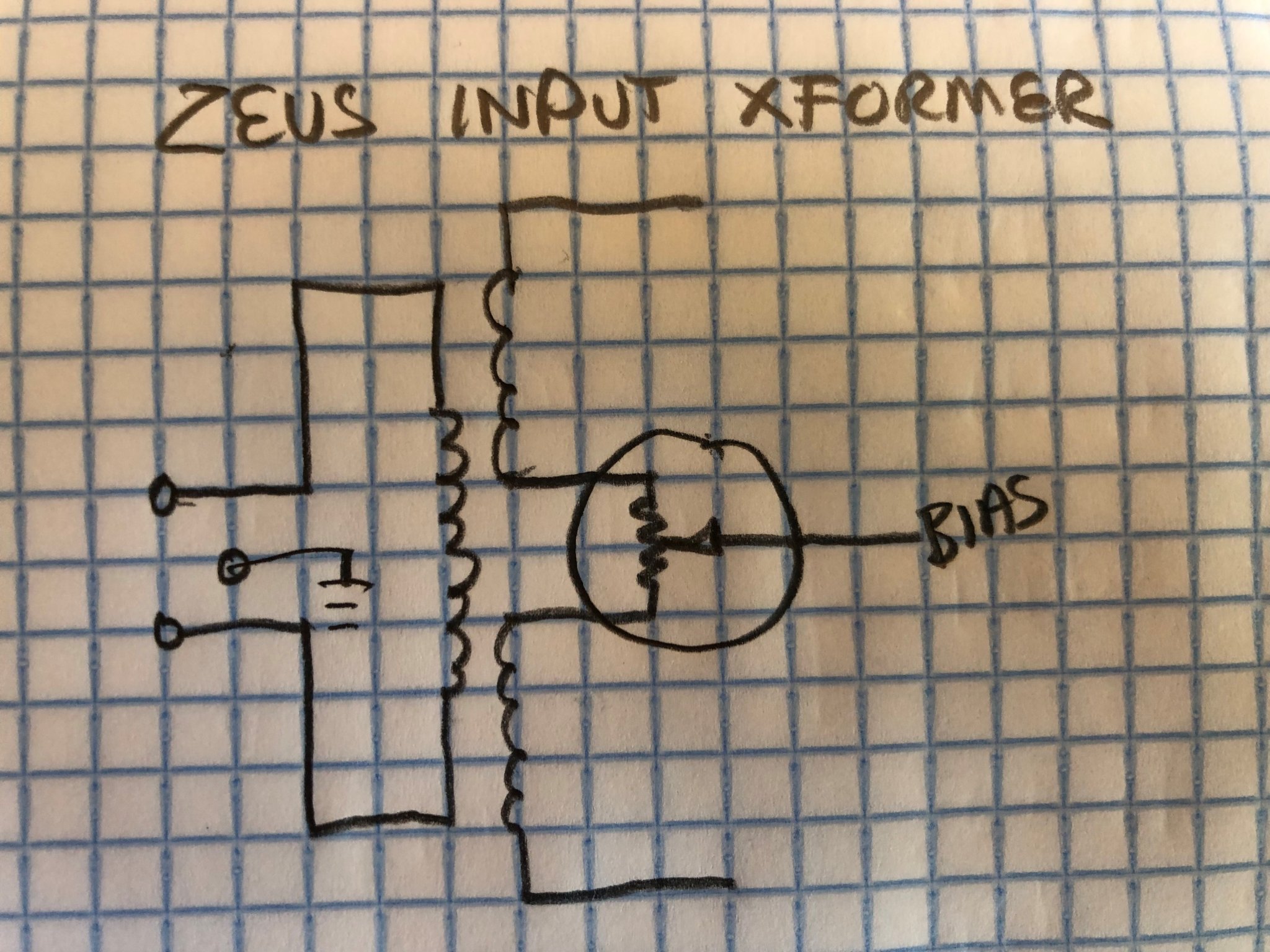

Do you think I could add in a balance pot like this to compensate for device and xformer wire length differences? You mentioned that maybe you had some issues with trying methods to force balance? Any suggestions on R value?
The pot value compared to the impedance of the windings is tricky, and you are not necessarily going to balance the biasing but more likely to make an asymmetry between the MOSFETs operation. Guessing, increase the even-order harmonics?
All these things are open to experimentation though, and there is no reason not to try.

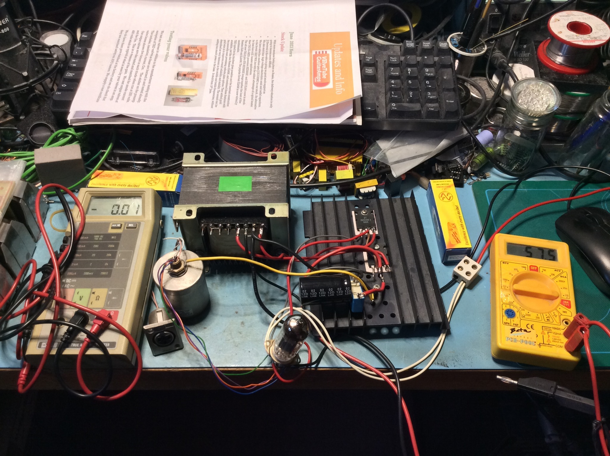

Here is a quick pic of setting up to do some basic ECC99 testing last weekend.
The meter on the right is reading mA, most of that is through the bipolar-transistors not the tubes.
Input transformer is a Sowter 9063-E, output transformer is a quad-filar wound on an EI-96 core with approx 1.4 ohm DC resistance per winding.

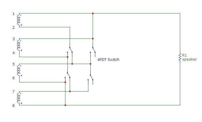

As for the output transformer, am I correct:
4:1 1-3-5-7
2-4-6-8
is 4 ohm
and
2:1 1-3
2-6
4-7
6-8
is 8 ohm

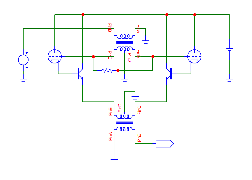

And for the primary side I assume this is the correct schematic, independent of 4 or 8 ohm:
And last but not least, I drew a schematic to switch between 4 & 8 ohm.
I think it works but when looking at your amplifier it seems you used a simpler switch, DPDT?
But I couldn't find how to draw it without 4PDT
