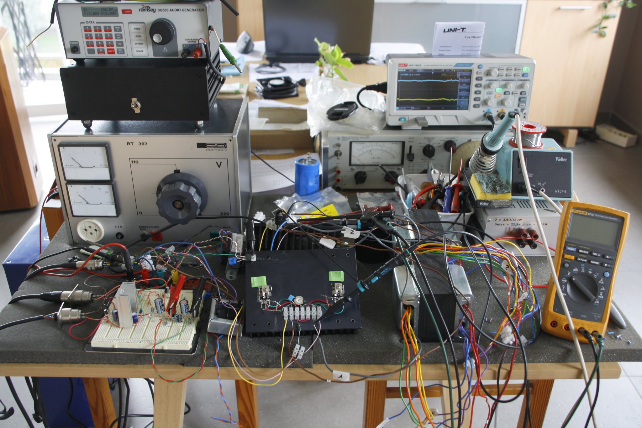

Here's my kitchen table bench with soon to be finalized Zeus.

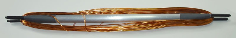

You deserve a proper winding machine.I have been testing out a new output-transformer, this one wound using an amorphous toroid core (one of a set of four I got some time ago).
Sadly I now know how long it will take me to make the second one!
3 layers of bifilar wound 0.80mm magnet-wire, by hand sitting on a sofa and dropping the two wire-spools through the centre hole without getting them too tangled up each time (that was the aim anyway). Each layer took 2 hours, so I wound one layer per evening after getting back from work.
Many thanks for all the comments 🙂
One point to make is that I am winding bifilar i.e. two wires at once; I am also "perfect winding" so the two wires do not cross over at any point.
This is very difficult to achieve when machine winding, especially for toroids with the circular-shuttle winding technique.
I do have some ideas as to speed things up a bit, but it will still take time. This first toroid was in effect a pathfinder mission!

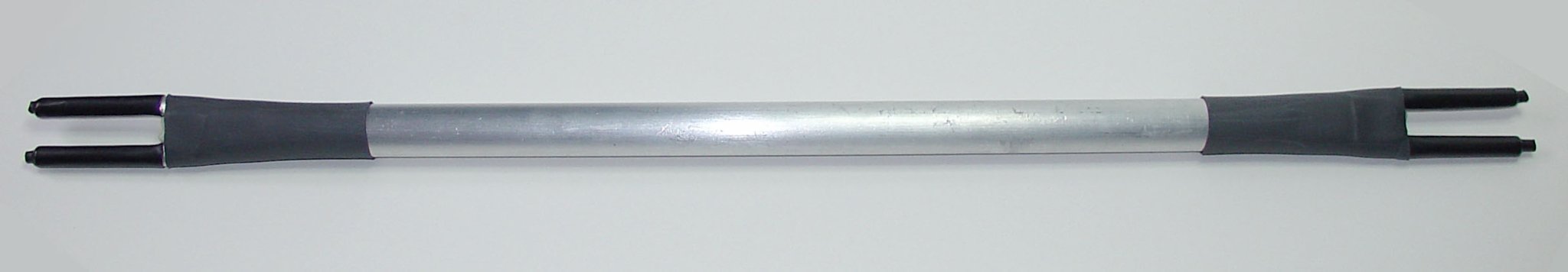

I have made myself some winding spindles, but they are not necessarily easier to use in this case when I am trying to get the best layering of the wires.

Very impressive, many thanks for sharing.Here's my kitchen table bench with soon to be finalized Zeus.
For each heatsink, if you set up a 12V fan with it up against the fins, but running off a lower voltage so it is only turning slowly (but not stalling), to actively move the air it will disperse a surprising amount of heat. Helps with testing and enables a higher bias to be used with these small heatsinks 🙂

Nice 'forks' you made. Without them it would be impossible to tame those wires I guess.

I will soon build the mosfets on the big heatsinks for the final assembly and I hope they will disperse enough heat. If not, I'll lower the bias for I don't need all that massive Quad Fillar Powered Iron and Steel Juice 🙂

I didn't use the spindle for this toroid - I literally had the two 500g spools of 0.80mm wire in my lap and flipped the core over and over and at every turn dropping the two spools through the hole in the middle.Nice 'forks' you made. Without them it would be impossible to tame those wires I guess.
I kept track of which spool was nearest to me and which further, untangling as I went, and hand forming the wire onto the core.
I also wound a layer of Kapton tape onto the finished layer to hold it in place and make the next layer more easy to see as I was winding - otherwise all the wires tend to blur into each other.
It's quite demanding work, even sitting on the sofa listening to music, so I did each layer on successive days.
