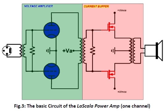

Have you seen the LaSCALA power amplifier?
(https://www.canever.engineering/shop/la-scala-power-amplifier/)
Is it possible that your basic idea was taken from your work?

Even if they were aware of my work, my experience in the past is that it would be dismissed as having had no worthwhile contribution or merit to their own designs.
It also shows what one can do with proper funding, as it take a substantial amount to set up and run an audio business making product. I have never had any funding - and found out the hard way that one needs such a thing - hence I have never been in a position to make my ideas into a "real" business.
https://www.monoandstereo.com/?p=8569
They quote 70kHz bandwidth, whereas my system runs at over 200kHz.
I also don't think much of their distortion figures around the 1W mark, looks like c. 0.035% just for the power-amp.
My full line-level input pre-amp/line-driver and power-stage does 0.0054% THD at 1.1 watts (2.89 volts into 8 ohms) - 1 kHz FFT
But who am I to nitpick, I don't have any sales whereas they are selling kit so relative performances are irrelevant. 🙂

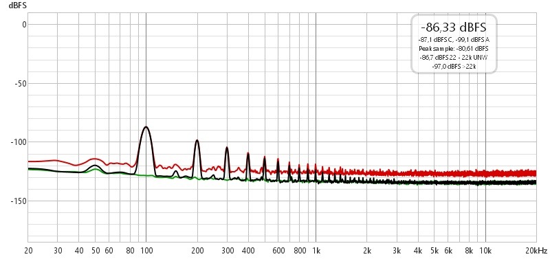

The input preamp / buffer did suffer from poor PSRR. I build a small cap multiplier as seen here in figure 2.1:
https://sound-au.com/articles/cap-multiplier.htm

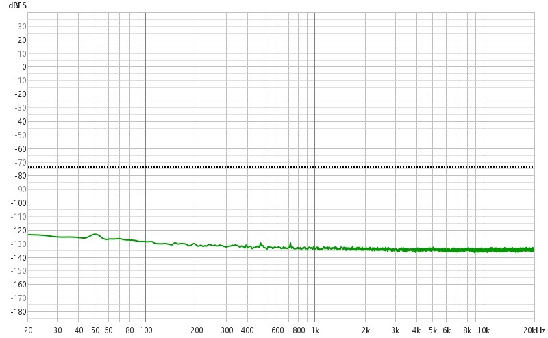

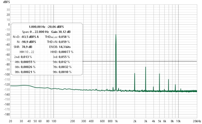

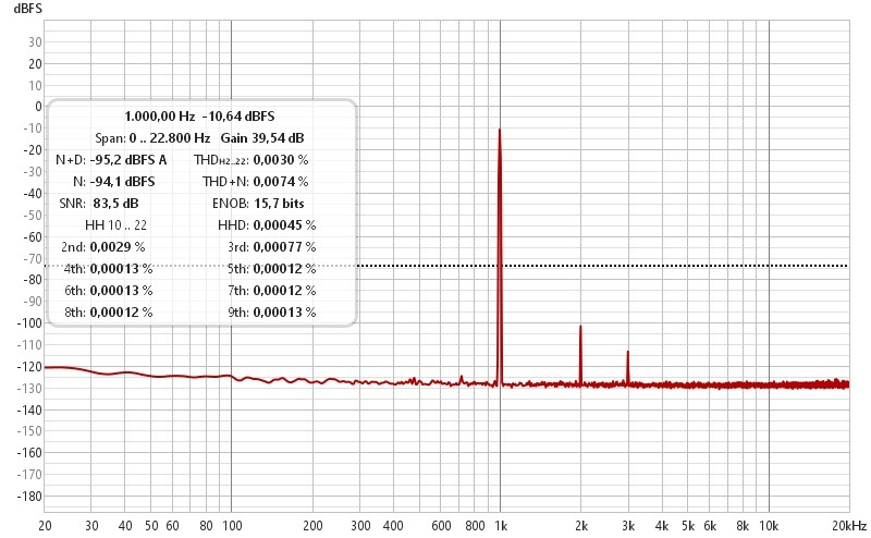

Some measurements:
Buffer amplifier alone:
Amplifier with 8 Ohm load:
Distortion:
Noise floor:
Hugo

Yes, SE Class A amps need a cap multiplier or other ripple eater device. I am able to get ripple down to 1mV rms under a continuous 3.5A load for my cap multiplier (follows 15mF/0.2R/15mF CRC). Makes a huge difference.
Sinclair PZ5,6,8 regulated power supplies had a very useful fold-back protection feature. That's a long time ago but well suited for this application.
http://diy.torrens.org/Sinclair/P80/index.html
This was an easy one to tame. Without the input emitter follower, which only draws 120mA, the amp is dead quiet.
Hugo
Hugo
Same here.I am able to get ripple down to 1mV rms
With +/- 1.5A total load (*) I get 0.16mV rms on one speaker terminal and 0.08mV rms on the other.
* 1.4A for the 34V unregulated rails of the power mosfets and 0.12A on the 15.5V rail for the buffer amp and bias circuit with cap muliplier.
Before I added the multiplier I measured +/- 280mV rms.
Hugo
I meant 1mV rms ripple on the power supply rail going to the amp, not speaker output.
I am not happy unless noise on speaker outputs with inputs grounded is below 0.2mV rms, ideally, 0.1mV rms.
The regulated supply has 0.26mV rms, the unregulated 500mV.

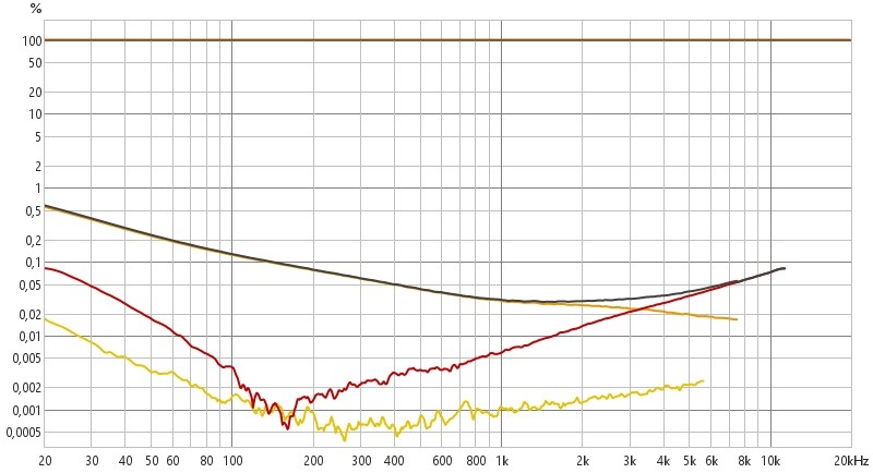

What distortion orders are the colors of the distortion plot in post #1886? There is an orange line that starts seprating from the dark gray line at about 1.8 kHz. I suppose the gray is THD and the orange HD2? If correct, THD is a lot more than 0.005% at 1 kHz unless this is for a much higher output power than 1.1 W.
The black line is THD, the red is HD2, the orange HD3 and the yellow HD4.
THD at 1kHz is about 0.03% in that graph, I believe.
Please bear with me, I'm only just learning REW and frankly, I think some of these measurements are a bit too optimistic, so thanks for the feedback. One thing I can't figure out is the weird phase response although a scope in XY mode shows a near perfect line. Once I get more grip on the system I'll post more detailed results.
