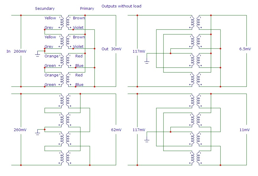

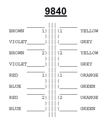

No matter what combination I try to wire the output transformer, I can't make it work.
For a given input of 25mV from the DAC, I either get 260mV or 117mV at the output transformer and the speaker side is attenuated.
This is the color code from Sowter:

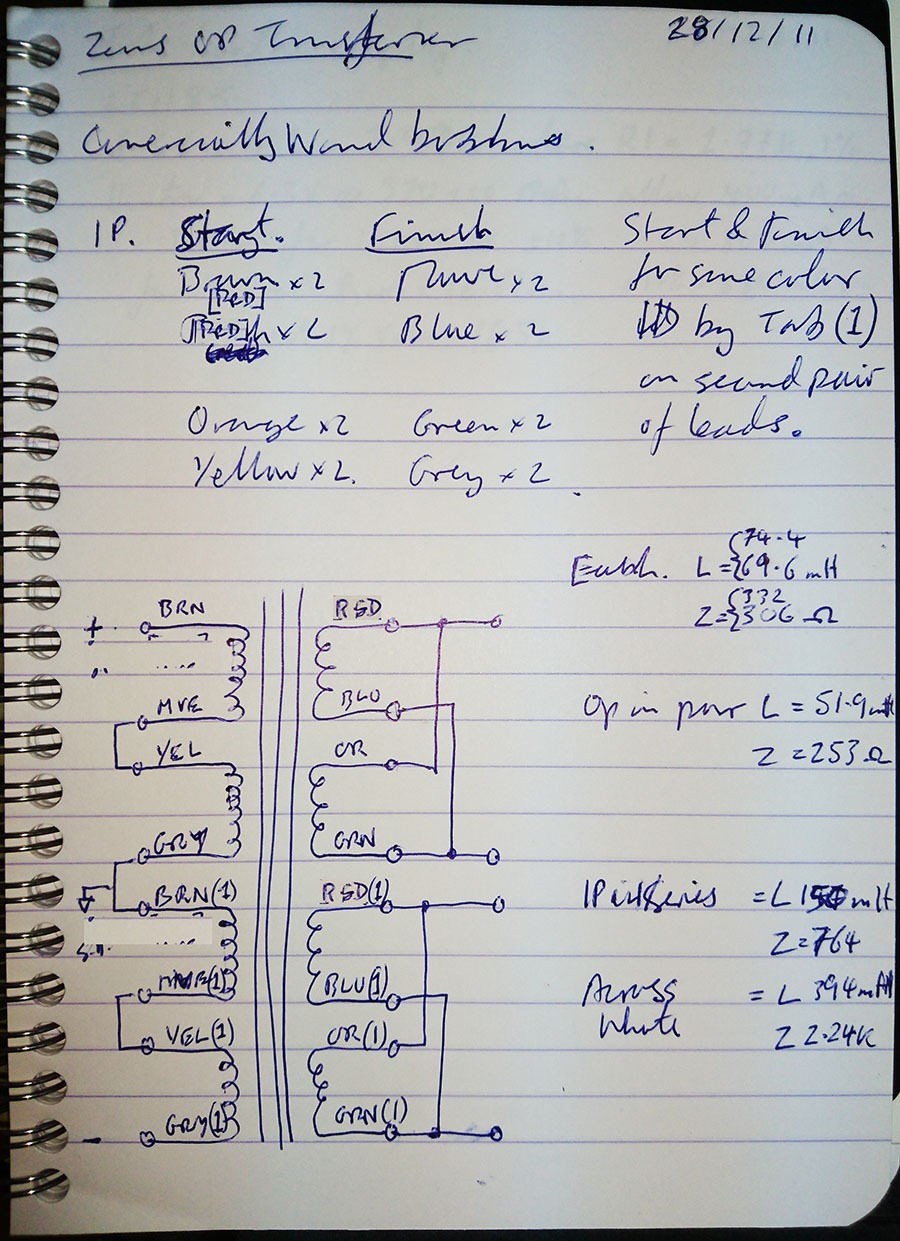

Note that for the dual chamber output transformers, it is important to have each primary winding using one section from each bobbin section.
Also each secondary is one pair of windings, one from each bobbin section. These secondaries can be connected either in parallel or series, depending on load (I normally use all in parallel).
It's important to get the phases right, otherwise they will cancel out!
Here's a pic from my notes.
Yes, primary side is how it should be.And for the primary side I assume this is the correct schematic, independent of 4 or 8 ohm:
Secondaries all in parallel or series-parallel.

I'll try to find out about the windings but its strange that I need to put more power into the amp than I get out of it.
For the moment I'll connect the speakers to the primaries, at least these give me some output.

If one follows Sowter's color code in a logical order, it won't work. With Susan's notes it works.

The Sowter is confusing (for me at least) because Sowter's color codes don't match with your notes. The connections flip from top to bottom and from primary to secundary. I still don't get it but hey, it works.
Hugo
That is a real puzzle, and no colored wires at all...Winding in a more conventional method
Hugo
I will have a look at this when I am feeling better - nudge me if I forget! 🙂The Sowter is confusing (for me at least) because Sowter's color codes don't match with your notes. The connections flip from top to bottom and from primary to secundary.

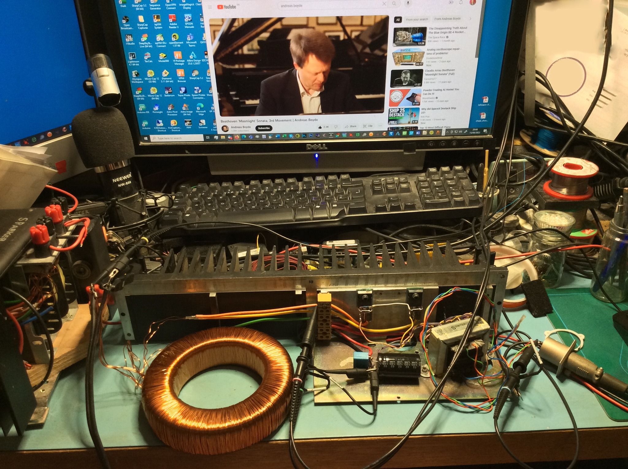

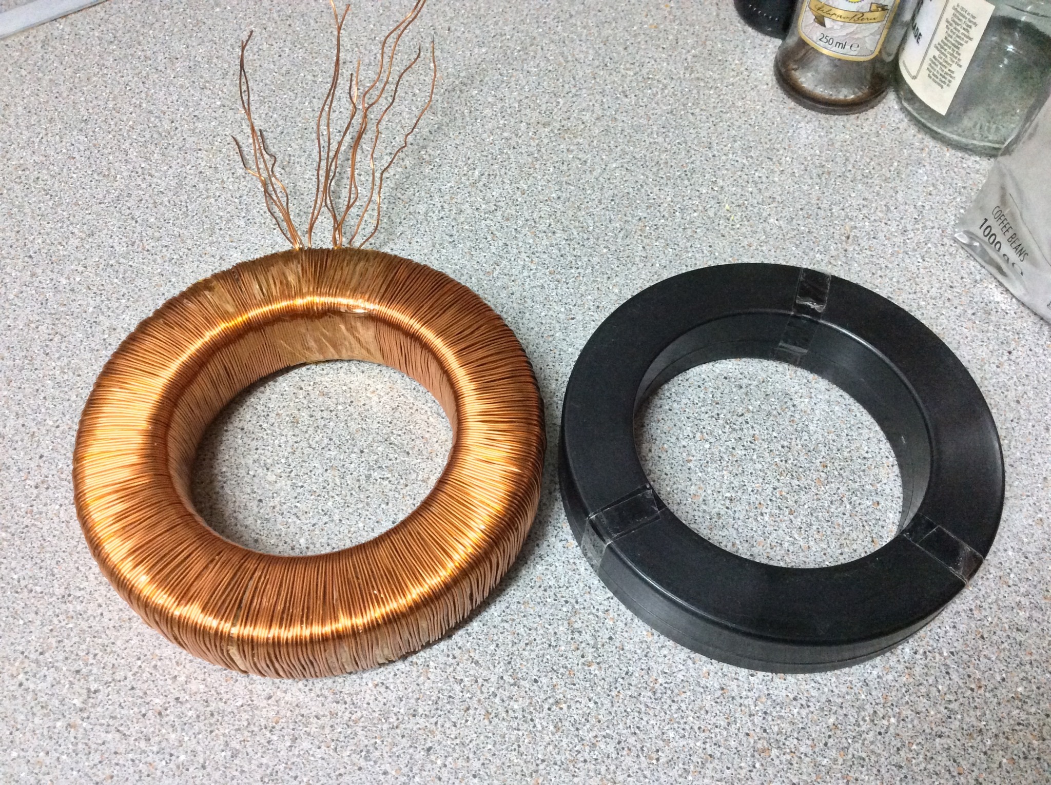

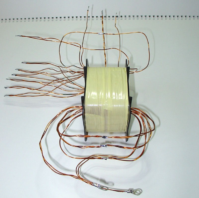

I have been testing out a new output-transformer, this one wound using an amorphous toroid core (one of a set of four I got some time ago).
Sadly I now know how long it will take me to make the second one!
3 layers of bifilar wound 0.80mm magnet-wire, by hand sitting on a sofa and dropping the two wire-spools through the centre hole without getting them too tangled up each time (that was the aim anyway). Each layer took 2 hours, so I wound one layer per evening after getting back from work.
Completed transformer and the second core waiting for it's windings! The core (in its case) is 143mm OD, 96mm ID, and 30mm high.
And the test setup...
Playing music - source is a MOTU M2 box.
With a quick test driven from a Sig-Gen's 50ohm output it goes from below 10Hz to over 150kHz.

Looking at the winding... six wires in, six wires out, huh?
Does it make any difference if the layers of winding start/stop at the same place on the core? Would it be better to spread them out, in this case spread the layers like 120 degrees apart around the core?

Winding toroids is always a thundering pain in the bottom. If you have an idea as to how much wire you need, you can decant it onto an improvised shuttle made of PCB material. Otherwise, it's pain all the way...
