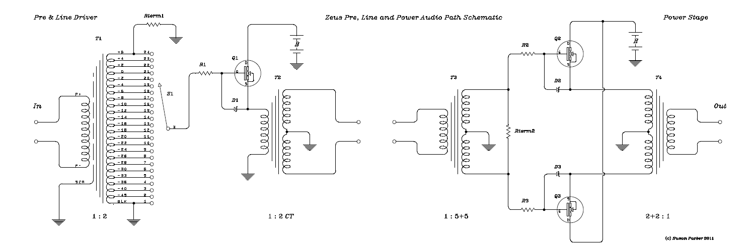

Schematic is the complete audio-path for one channel, features a minimal number of components and NO capacitors.

Because of the totally interleaved nature of the windings, the PP output stage (T4 and MOSFETS) itself goes up beyond a MHz and becomes limited more by RF impedance load mismatching and the bandwidth of the MOSFETS. I think that is probably high enough.
The bandwidth "bottleneck" for the power-stage is the T3 step-up, depending on the construction.
As drawn, the audio-path does 20Hz to 200kHz.
T1 is a +6dB (max) gain/attenuator; Rterm1 provides a flat impedance to the audio-signal source. Unterminated the audio levels would change with frequency and there would be a peak at the top end from resonance (it's an inductor thing).Does it break down like this?
T1: volume control; unsure how it affects input impedance, differential to single ended conversion. Unsure of the role of Rterm1.
T2: pre-gain stage of x2(?); going from single ended to differential; the is a source follower so it has less than unity gain, it’s more of a high input impedance/low-output impedance thingy? They provide current gain? Is that the point!?
< is something intended to be connected between T2 and T3?>
T3: single ended to differential to drive push pull output stage; gain of 10.

T2 is SE to Balanced, as you correctly identify. Yes, it's all about current gain with transformers.
The two parts are separated: The volume/line-driver sits next to the source, and the power stage can sit right next to the loudspeakers they are driving. This saves many thousands of $$$ for exotic speaker cables. The two are connected with 100 ohm twinax cable (Belden 9207) i.e. the space between the two halves, not flimsy phono or mic cables. And yes, this DOES make an audible difference.
T3 is balanced input, a single phase to dual phase splitter. It has an effective gain of 5.
T4 is a balanced gain of 0.5 (0.45ish as a follower).
The point to note is that everything here is ground-referenced, BUT T2 and T4 self-generate their own imaginary negative power rails when compared for example to a conventional solid-state amplifier with a pair of output devices and positive and negative power supply rails. Which is where the confusion comes as to the the gains. Basically if one configures T4 as single ended transformer by swapping the second primary leg to be in the same phase as the first which maintains the same overall winding ratios, one gets the same gains.
If you look at the big EI162 transformer in post #1,746 this is what is happening. Small transformer on the right T3 is configured to give 2 in-phase signals which drive 2 MOSFETs in-phase onto two primary windings in-phase. The use of two 1.0mm magnet wires wound as a pair improves bandwidth (skin-effect current is smaller) as well as hand-winding ability. The larger magnet wire diameters get very difficult to manage very quickly over 1.25 mm or so.
In summary, T3 and T4 can be configured to operate as either SE or PP using the same transformers and same winding ratios, to give the same output levels. This could even be implemented as a multi-pole switch for test-comparison purposes (with power removed). The resultant volume from either mode should be the same, so would side-step one of the issues when doing conventional A/B comparisons.
