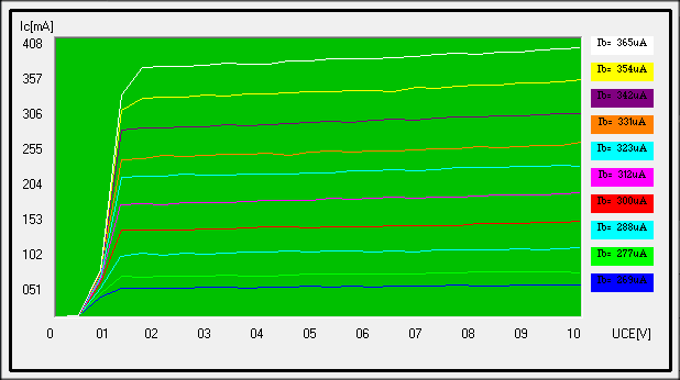

Noticed the IXTH20N50D is only a tiny bit depletion.

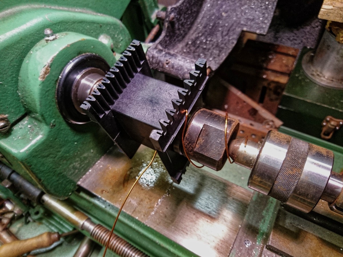

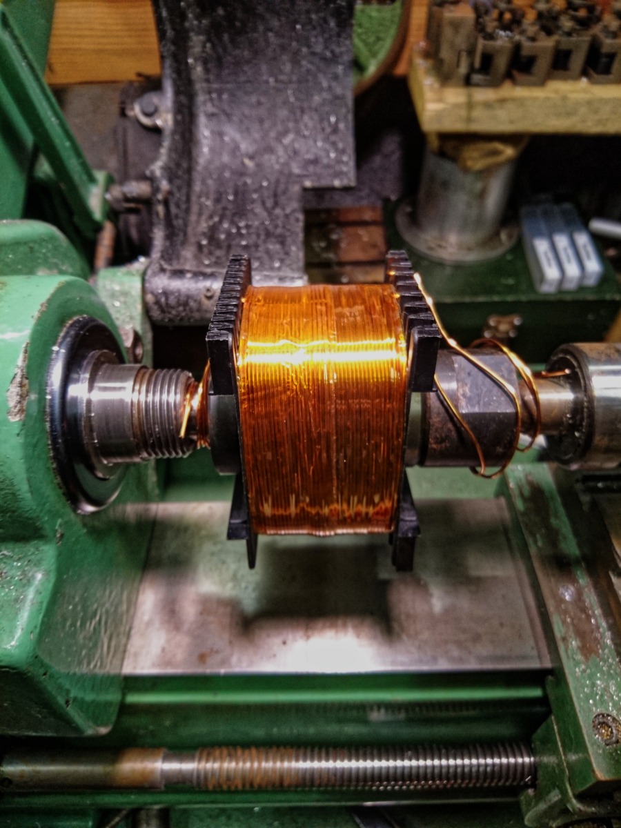

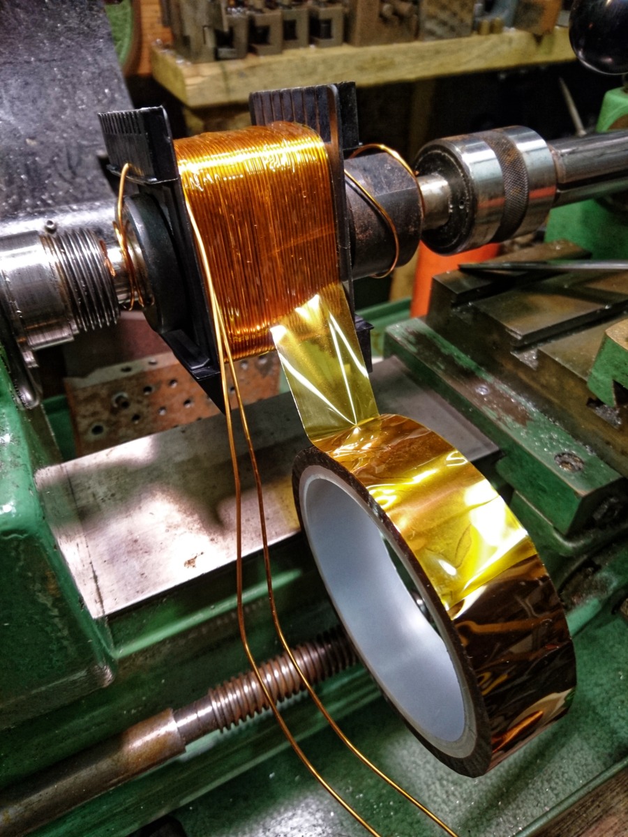

I am reminded that I have not posted here for a while... 🙂
So here are some pics of me hand winding a single-ended 1.5 to 1 output transformer with 1.0mm magnet-wire on my lathe.
First and last layers are primary only, the eight intermediate layers are bifilar wound.

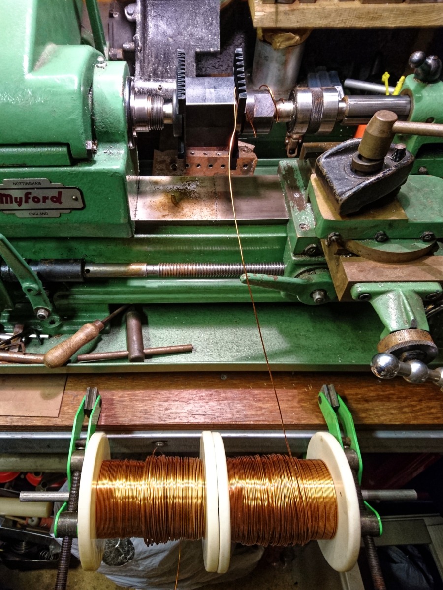

Winding setup.
Ready to start.

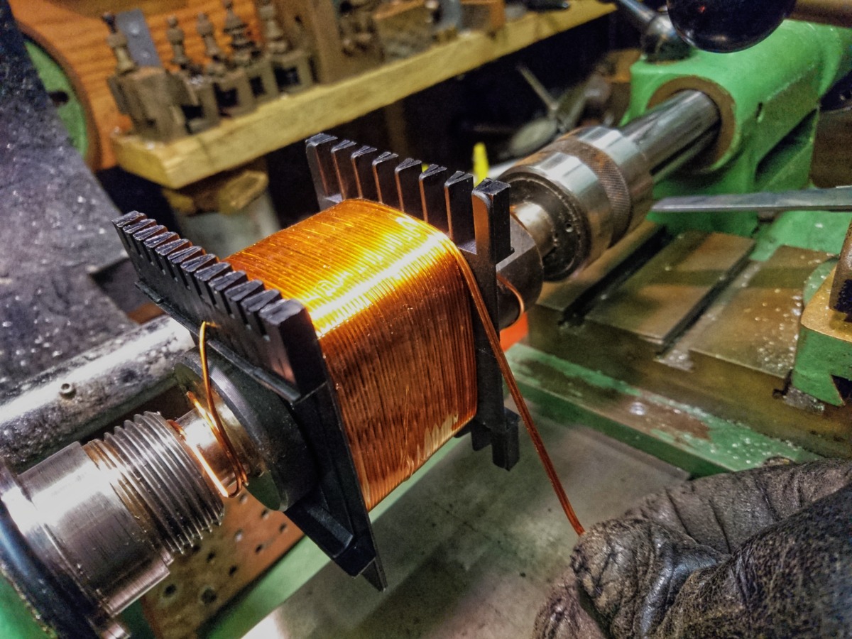

First layer wound...

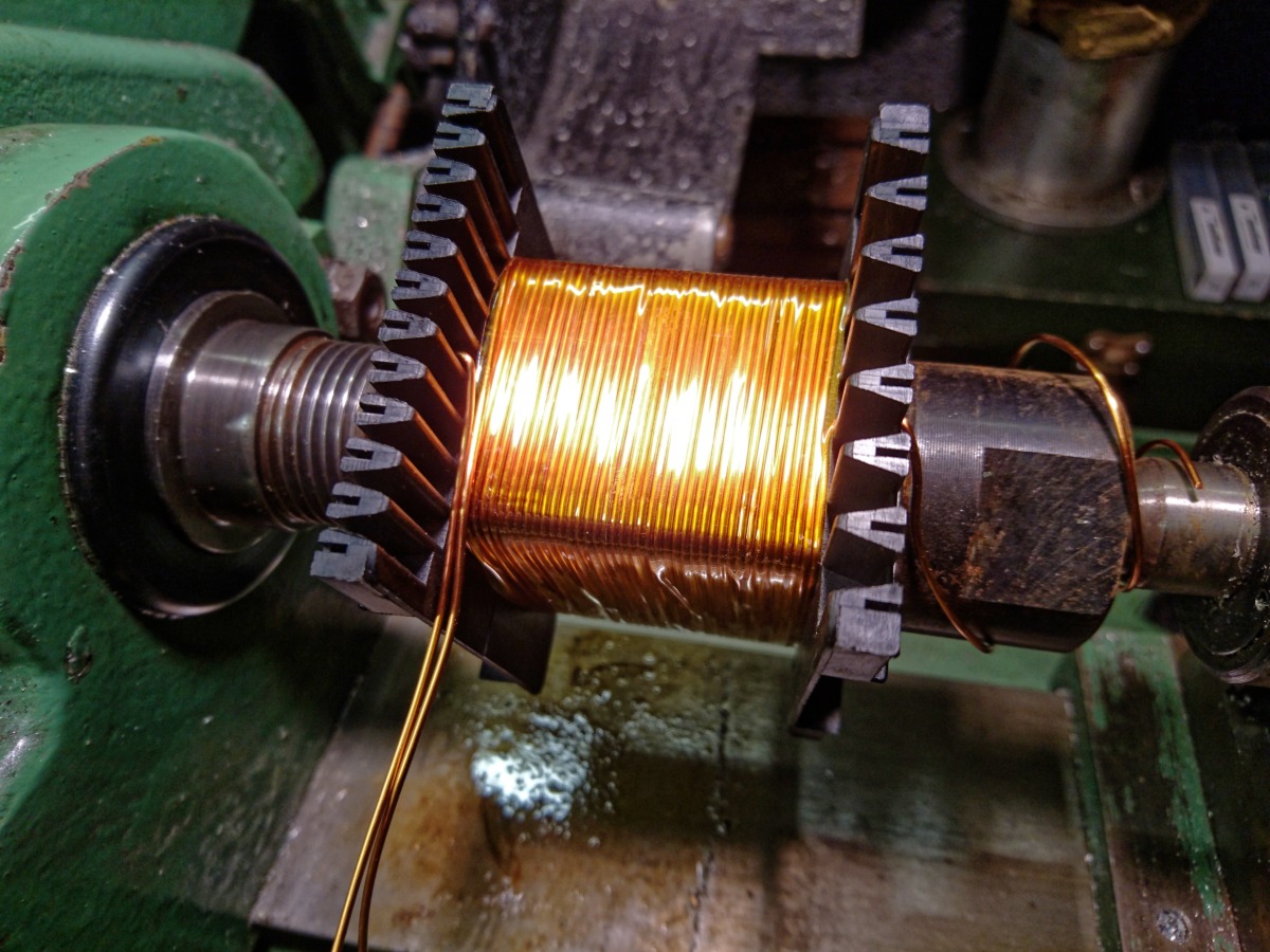

Dynamic bifilar-winding method, with bio-feedback tensioning and traverse.
Applying Kapton tape per layer

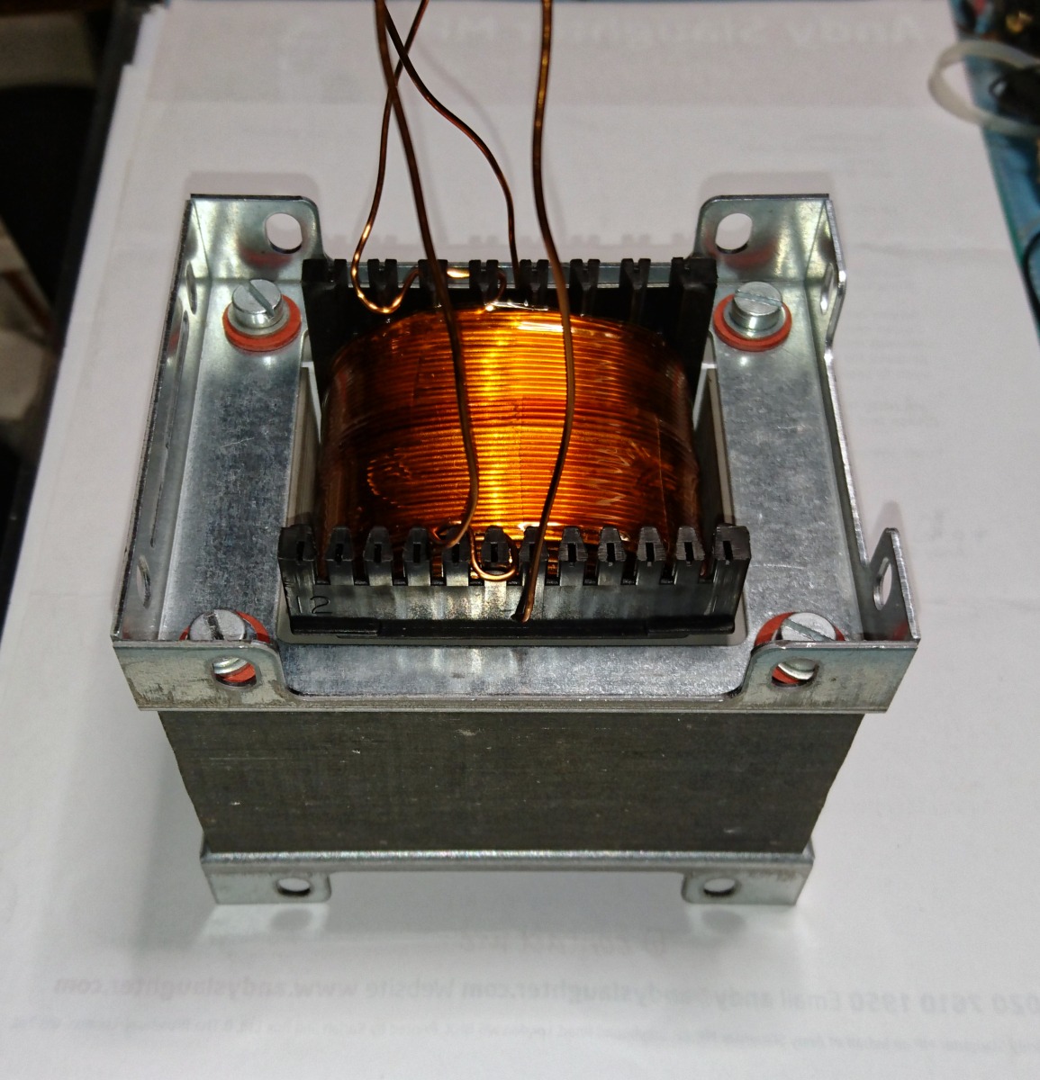

Finished winding. The slight bump in the middle is from the overlap in the Kapton tape I have put on each layer.
Finished transformer.
