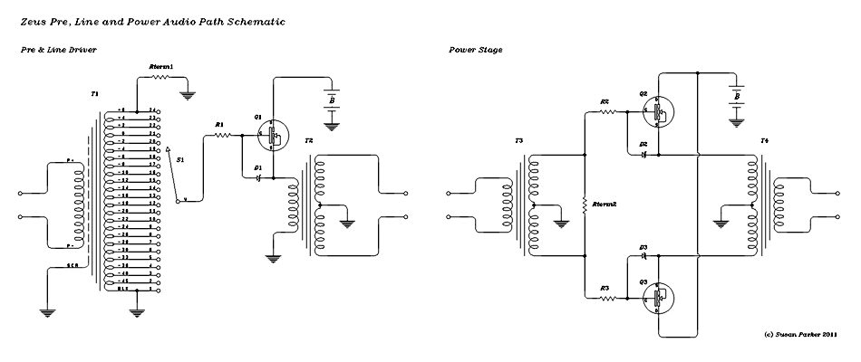

Current Schematic

Dear Susan,
I have been referring to the same elegant circuit.
The insulated gate can hardly be characterized as anything other than a considerably doped, high impedance, nonlinear electrical interface that is in need of stabilization by resistive elements. The very thin dielectric layer is indeed vulnerable, but such hostile voltages can barely at all arise. For more common MOSFETs, a low value gate-source resistor is a natural part of the biasing arrangement.
Bandwidth is dependent on biasing and loading. Measurements data made under no load conditions are of little relevance.
Confusing information? I am not urging you to make changes to your working amplifier.

Hi Anthony,
I sort them by the current flow through a 1 ohm resistor, to get the best match to minimize the DC in the transformer. They need to be all on the same heat-sink as the values will change with temperature.
A few tens of mA difference isn't going to hurt with an EI transformer, might be a problem with a toroid.
You could gap EI transformers with a thin c. 0.1mm shim of copper without killing the bass-response too much as a "lets see how this works" measure.
I have hundreds of the parts, as they were going to be made obsolete in 2011 so I bought a lifetime supply.
For my daily use pair of PP amps and the SE line driver I got close enough matches from a tube of 30 but the variation between individual devices is large; I got a min/max spread of 512mA to 876mA.
I am NOT a seller however I have enough to do some matched sets if people are interested since it is now very unlikely that I am ever going to be able to sell my amps commercially.
This is what I refer to a 2:1 mode, when needing more power for driving bass speakers. All transformer windings are the same number of turns.
I recommend 4:1 for general use, which is substantially lower distortion. The transformer secondary output windings are half the number of turns as the input primary windings. It is technically 2:1 ratio, however I am referring to the amplitude between the PP primary windings which are +ve and -ve and the voltage across the output.

Thanks. This is drawn in DxDesigner and the curves and hop-overs are pass-thru components so the original is actually a live schematic and can be net-listed.
What value of Rg-s to try?
Is this considered current dumping?
This requires more robust mosfet driver?
Susan,
I meant to say that 200 MHz for a sine wave is not a valid practical value. Bandwidth falls off rapidly with energy level. Signal transformers typically suffer from insufficient bandwidth.
The IXTH20N50D can withstand high gate-source voltages. Zener diodes do not protect against transients.
Regarding your preamplifier: a DC blocking capacitor produces lower distortion than a transformer. Have you considered an autoformer volume control instead of the transformer volume control?

TonyTecson,
the reverse transfer capacitance is much more harmful than the gate-source capacitance. The reverse transfer capacitance is always present, increasing with the drain-gate voltage / drain-source current, adding to the gate-source capacitance, and impacting transconductance. The low distortion of voltage followers stems from small amplitudes, low saturation and wide bandwidth in spite of a very large gate-source capacitance.
I personally don`t use voltage followers.

Did you mean that Cgd decreases with increasing Vgd?The reverse transfer capacitance is always present, increasing with the drain-gate voltage / drain-source current, adding to the gate-source capacitance, and impacting transconductance.
Did I say that? The reverse transfer capacitance (Cgd) increases with overall energy level. An increase in capacitance directly means an increase in current (mass). An increase in current also means an increase in voltage (amplitude), impedance, frequency and a decrease in bandwidth.
