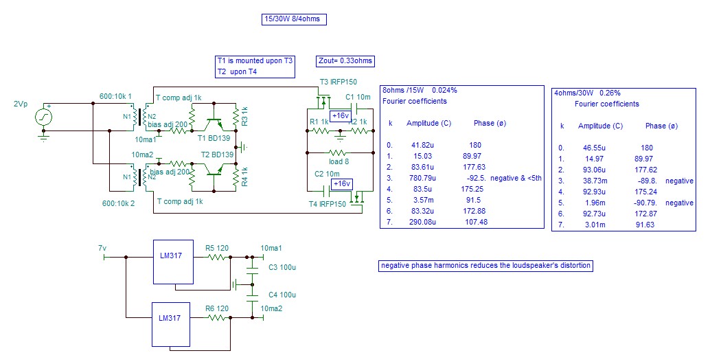

Transforming the class A Zeus to class B circlotron I got the following result.
Can someone of knowledge for both circuits advise me which to choose?

As far as I understand I can see you are using a 1:4 step up transformer. You need at least 12K input source impedance to drive IRFP150 to ~22KHz -3dB at the gates. In source follower Ciss 2800pF Crss 280pF and S 13 give Gate input capacitance of about 616pF.
For 50Khz you would need 5K input at the gates. As you step up four times 5K/16= 312 Ohms

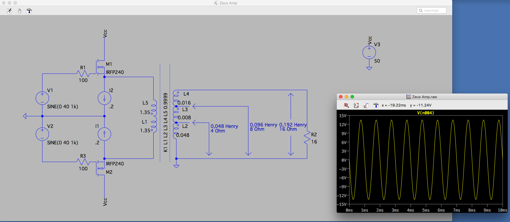

Something like this?
Nice simulation.
The point about the centre ground tap is that the two primary halves are coupled and so the one going positive couple to the other which goes negative.
Without this coupling, the negative side of the input transformer secondary will attempt to drive the gate negative, and thus may drive the gate outside the input V limit; which is followed by a bang, or clamp which just gives distortion.
Overdriving the gate input will result in pain and misery, as I can personally attest.

Hi: I am not concerned with the secondary at the moment. The common drain is called anode in valve circuits. The gates and grids are supplied by an alternating signal which produces an amplified output. The two N-type mosfits in this configuration have to be connected to the centre tap transformer to work. What else is in this that I don't get.
Yours truly, Ampman
Yours truly, Ampman
This is a pair of complementary followers, not common source/cathode amplifiers as you would see in the typical push-pull tube output stage. I’m sure someone made a push pull follower with valves long ago. Revisiting it with lower voltage mosfets (and with it lower drive requirements and a lower ratio output transformer) is what I believe people see as novel in this approach.
