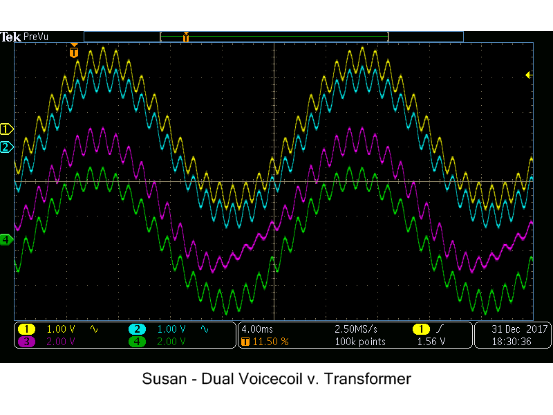

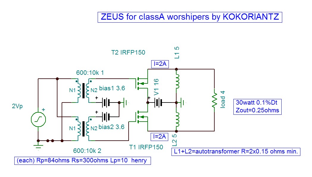

Direct Drive using a Dual Voice Coil Loudspeaker
Best 2018 New Year seasons greetings.
In answer to your question:
Post # 1 of this thread shows T1 power output transformer. The attached schematic suggests using a dual voice coil woofer instead of T1. Maybe this approach is already buried in one of the 1600 posts!
Basically it doesn't work because the speaker voice coil inductances are too small and so don't couple or store enough energy to work outside the narrow watt or so of PP Class A operation from the biasing.
Attached is a scope grab showing Direct Drive and Transformer 1:1 Drive for comparison, as can be clearly seen (and heard) the 1KHz tone gets crunched by the LF one.
At low levels it sounds really great... 🙂
Best,
Susan.

10k:600 is some 4:1 voltage (winding) ratio.
Reading the description, I'd have my doubts:
Quote:
Permalloy 10K:600 audio step-downIsolation transformer: mark the measured value on the transformer.High quality audio step-up transformer, imported permalloy material, can be filtered to eliminate AC noise interference,Digital killer. For a variety of high-end professionalsHIFI front stage, audio signal boost use.
It can also be used upside down,Impedance 600:10K.
The measured voltage ratio is1 to 0.6.That is to say, 10K The input voltage is 1V, and the output voltage of the 600Ω winding is 0.6V,The signal is attenuated.
But, regarding price, you can take the chance.
