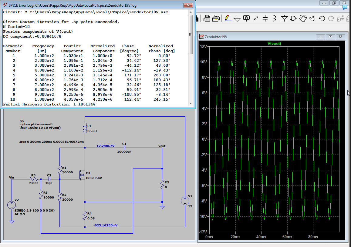

You would need better heat sinks (a fan?). Here is a simulated version with 19 volts and 1,65 Amps from the powersupply. The mosfet dissipates 28,4 watts of heat, and the amp seems to hit 1.1 procent simulated THD at 6.6 watts (8 Ohm load). And it seems to hit about 10 watts at the first onset of (very soft and gradual) clipping.

Thrilled to see that a 10W version can be made with a widely available 19V power supply.You would need better heat sinks (a fan?). Here is a simulated version with 19 volts and 1,65 Amps from the powersupply. The mosfet dissipates 28,4 watts of heat, and the amp seems to hit 1.1 procent simulated THD at 6.6 watts (8 Ohm load). And it seems to hit about 10 watts at the first onset of (very soft and gradual) clipping.
