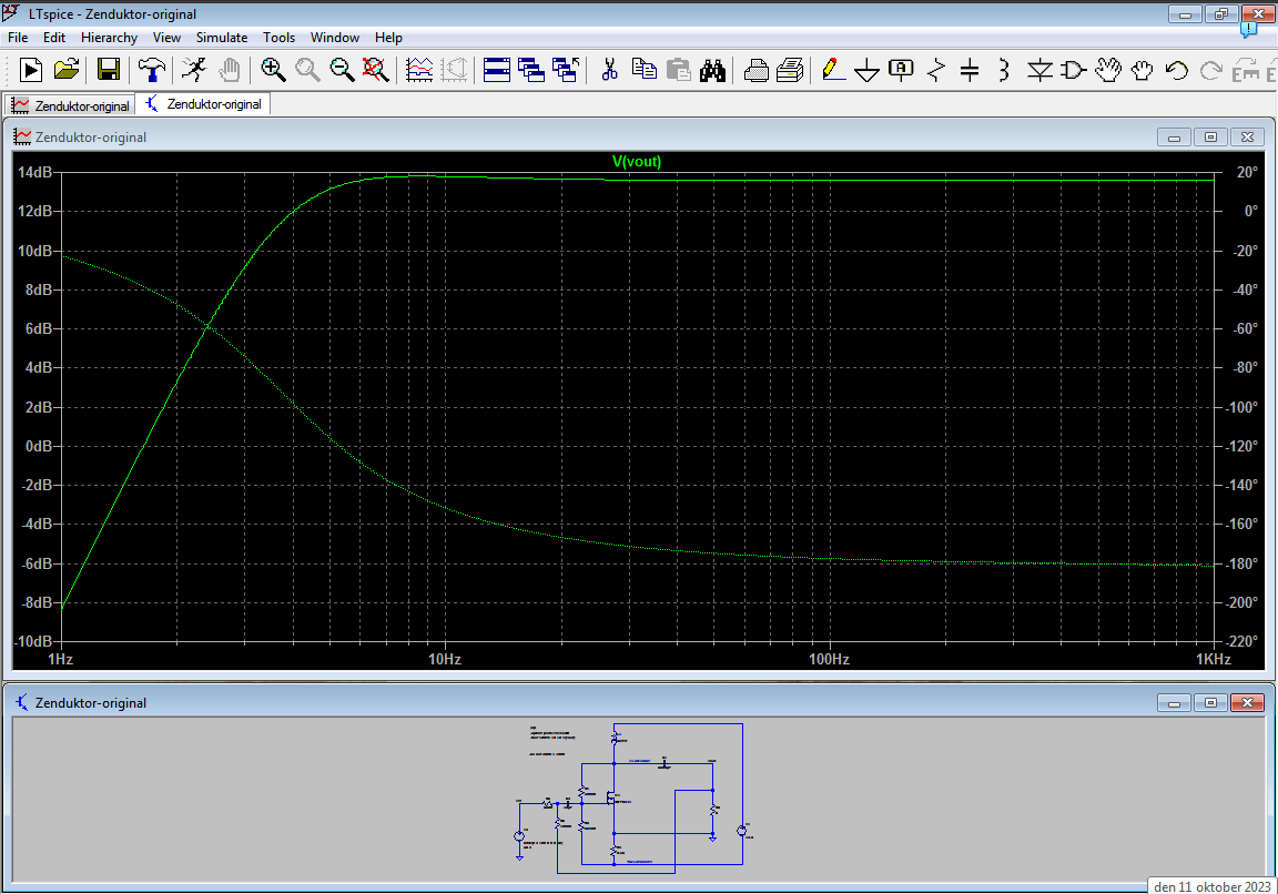

In Spice it seems to work. But the proof shall be in the pudding.
Below a Spice simulation based on models found in a different thread. My apologies and thanks to the author for using his intellectual property.
Looking forward to comments

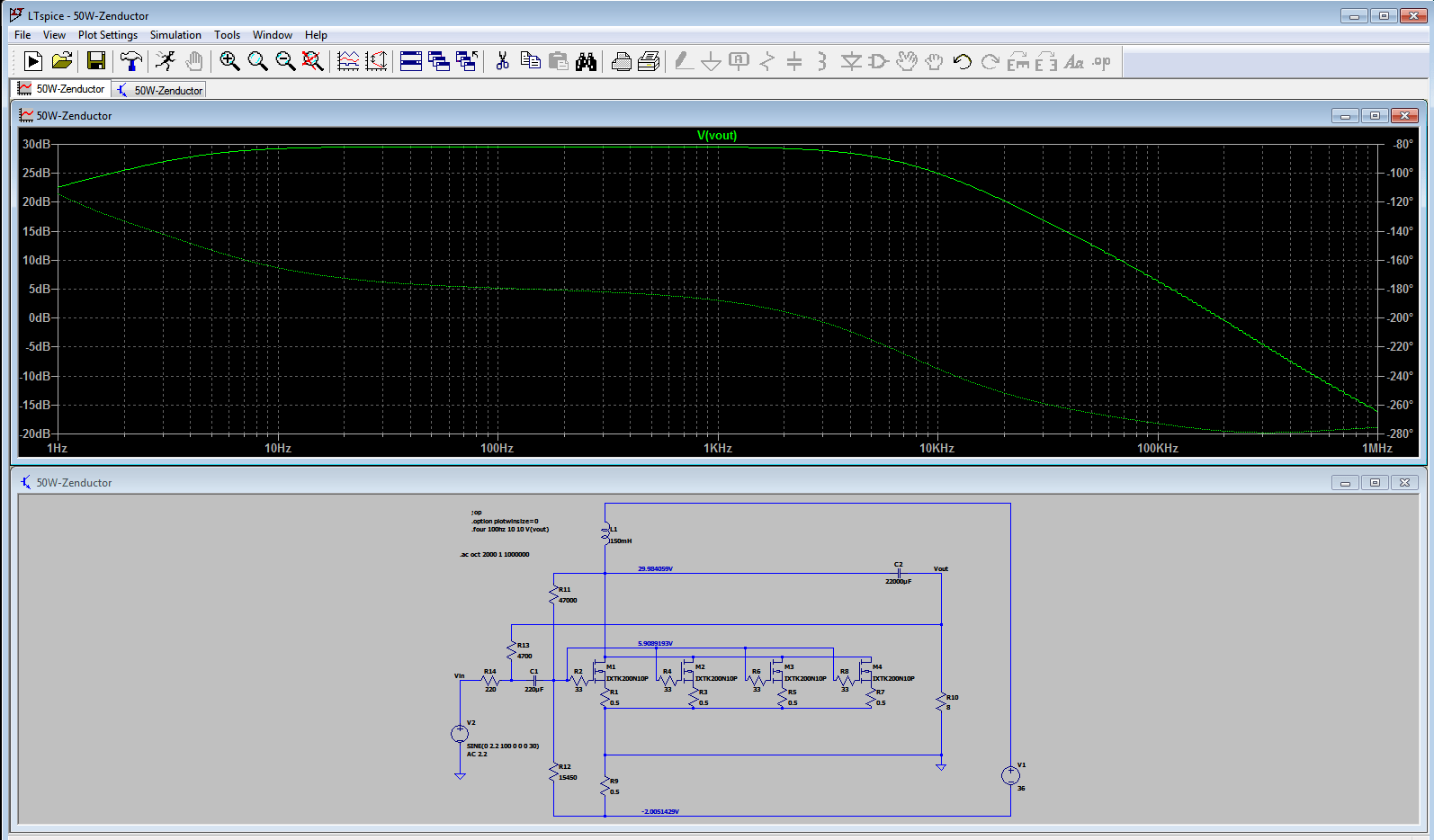

A 50 watt Zenductor amp should be doable based on some ideas from Nelson Pass previous BAF projects. It does take a much beefier Mosfet, inductor and heatsink though.
50 watts into 8 Ohms, 1.07 percent simulated THD at first onset of clipping (see the lower part of the waveform). It takes a huge inductor that can take a steady 4 amps of current (at least) and 36 volts powersupply. Each Mosfet dissipates about 30 watts of heat, so the heatsink should be up to the task.
And either the preamp must be powerful enough to drive this load or the amp needs an input buffer of some kind.
The same "single end triode" respons curve as the original Zenductor. I would go for an input buffer to get a little better top end respons and increase the input impedance of the amp.

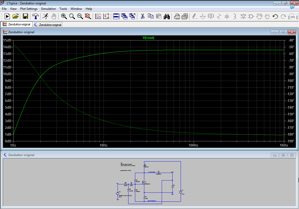

I would argue that the inductor in the Zenductor is to small. 35 mH makes it roll of below 100 Hz. Use a pair of large Hammond if you want better (and more) bass.
With 10000 uF C2.
With 3300 uF C2.
My bad. I should have used the exact values in the Zenductor schematic in my simulaion. Yes, the inductur is a bit on the small side but Nelson Pass and Mike Rothacher have solved the problem in a very clever way. I used a 10000 uF capacitor (C2) on the output in my sim, but they used 3300 uF. This trades some negative feedback and damping factor for a bit of bottom end boost. Very clever! And I guess this will sound very nice on a lot of fullrange drivers and/or back loaded horns.
With the parts I have on hand I would be looking at 70 mH inductor and 4700 uF capacitor.
Those are fairly common values for those of us experimenting with MOT transformers and MoFo amps.

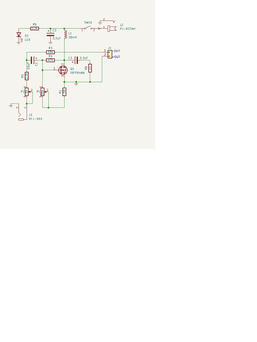

After taking six months off to explore other things the Zenductor has inspired me enough to fire up KiCAD and tinker over the winter!
