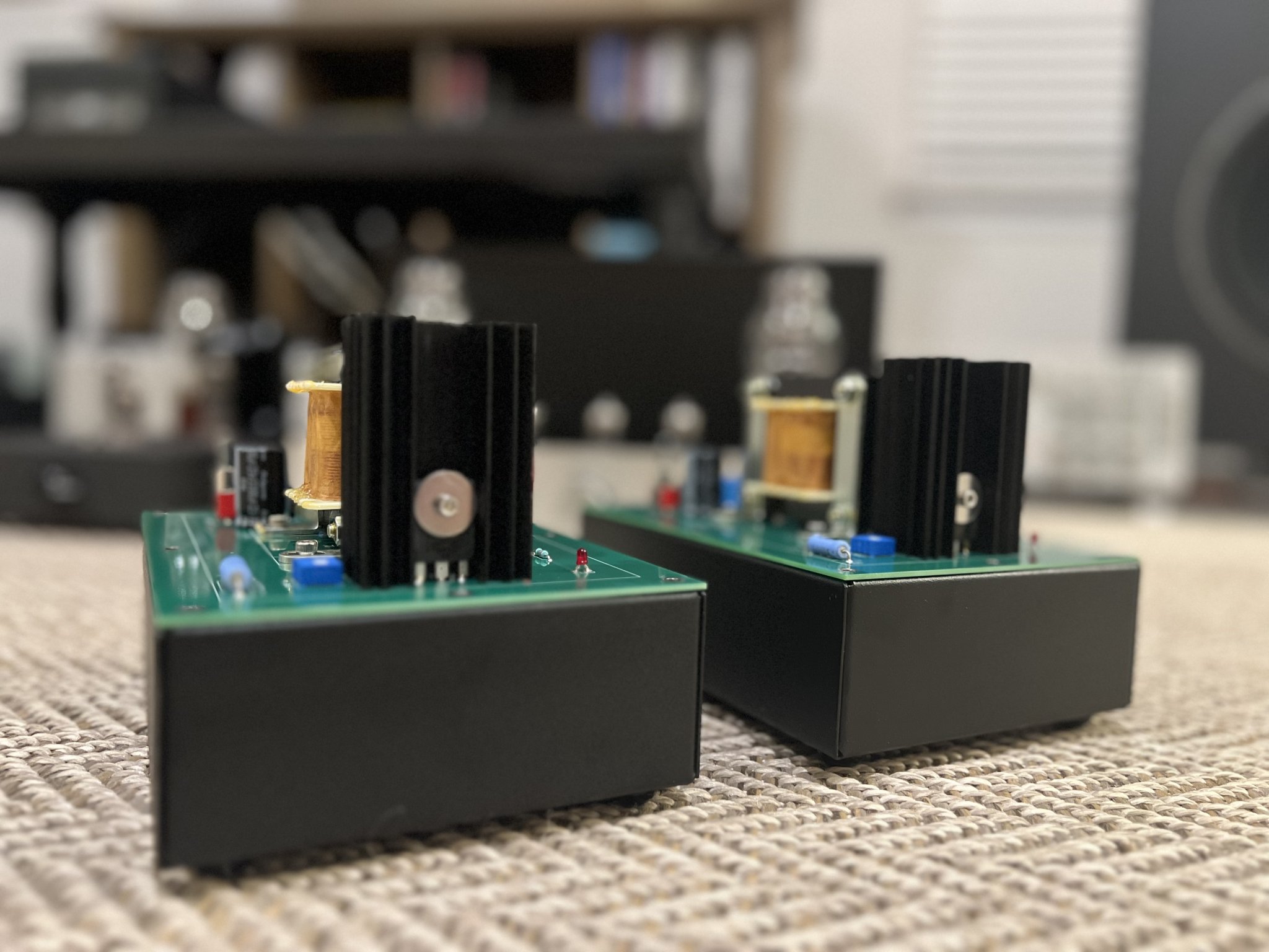

zenductor-jpg.1215963
Beautiful pair of amps built by Mike Rothatcher sitting on the optional chassis pans.

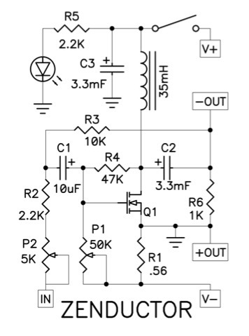

fat zen single mosfet amp with choke and caps, 24Vdc brick, common drain (so gain)

'twas a typo, I meant common source , so gain
yeah, indeed, more brainfart than typo, rhyme pulled me
:rofl:
though, for 5W only, I can see Pa using any of common drain / common source, but with Zen in title more likely common source - as original Zen was
truthful rhyme is common drain (so no gain)

The PCBs are 5x7 and can be built up several of ways, even mounted atop a BUD 5x7 chassis if you want a more finished tooby look later. Each naked monoblock would fit in a cardboard box perhaps 8x6x4 with room for some bubble wrap around. Maybe I could stick around Petaluma on Monday and take a few to the UPS store for the far-travelers. :)
