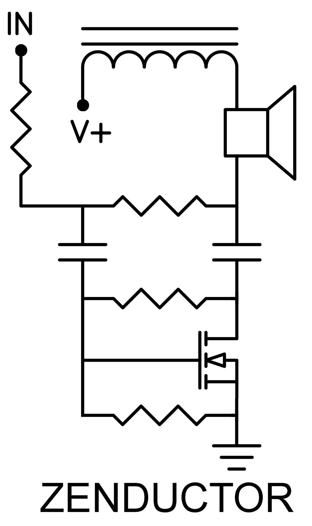

have named it "Zenductor", single channel, single-stage, single transistor,
single-ended Class A that comes in at 5 watts. Closest analogy would be a
solid state version of the Zen Triode from DecWare.
"That transistor will be a New-Old-Stock IRFP048 Mosfet, and Build Campers will be building a pair of naked mono-blocks.
In other news it looks like we will be able to do a Zoom event on Sunday."

Ah... I've used so called zero bias triodes, zero bias fets is new to me though. The heatsink requirements should be minimal...........😀
Raising his hand from the back of the class: Excuse my ignorance, Dr. Nelson, but this looks sort of crazy.... does the input ever go negative? What happens then? What would happen then?
You both get the prize. The prize is a pair of these channels (the ones that work).
Don Nelson.... thanks for the prize, but I already paid for one seat... IMHO, the true prize is if you explain what this thing does? The way yo do so well in FW. Yeah, we know about capacitor lives and the Sun goes super nova. ;-)

I think it has to do with all of them resistors and the gate being at a different (higher) voltage than the source... but then the speaker is in line with Vcc and I figure the load is gonna affect the amplifier.
Wait, I think I got it....

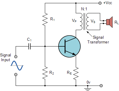

Transformer coupled speaker?. Is Nelson Pass playing games with us? Or am I just not seeing it?
I know Ben..but I LOVE the Pa simplicity as in tube ampSo not quite the same thing. 🙂
