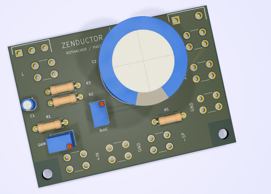

The schematic is available and published. Everyone can feel free to lay out their own personal PCB implementation, including allowances for different / better / more expensive / trendy avant garde components. Don't like the rectangular shape? Change it!! Want an EMI shielding ground plane and a 4 layer board? Make it!! Want different I/O connectors? Install those PCB footprints. Prefer XLR balanced input? Circuit design an appropriate implementation and plop it in.
After you build it and verify that it works well, you can upload your design here and let other DIYers try a Zenductor modified exactly your way.

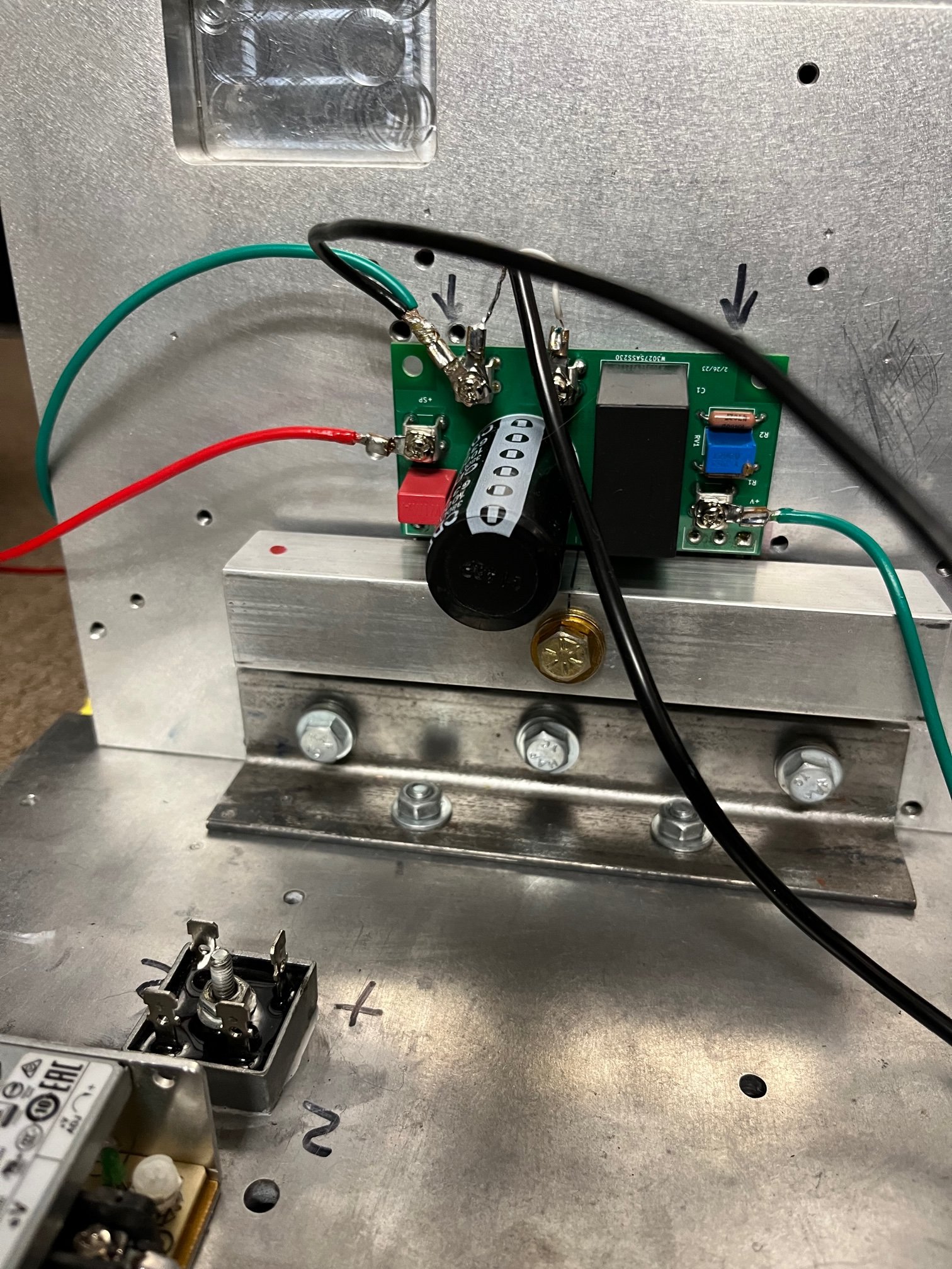

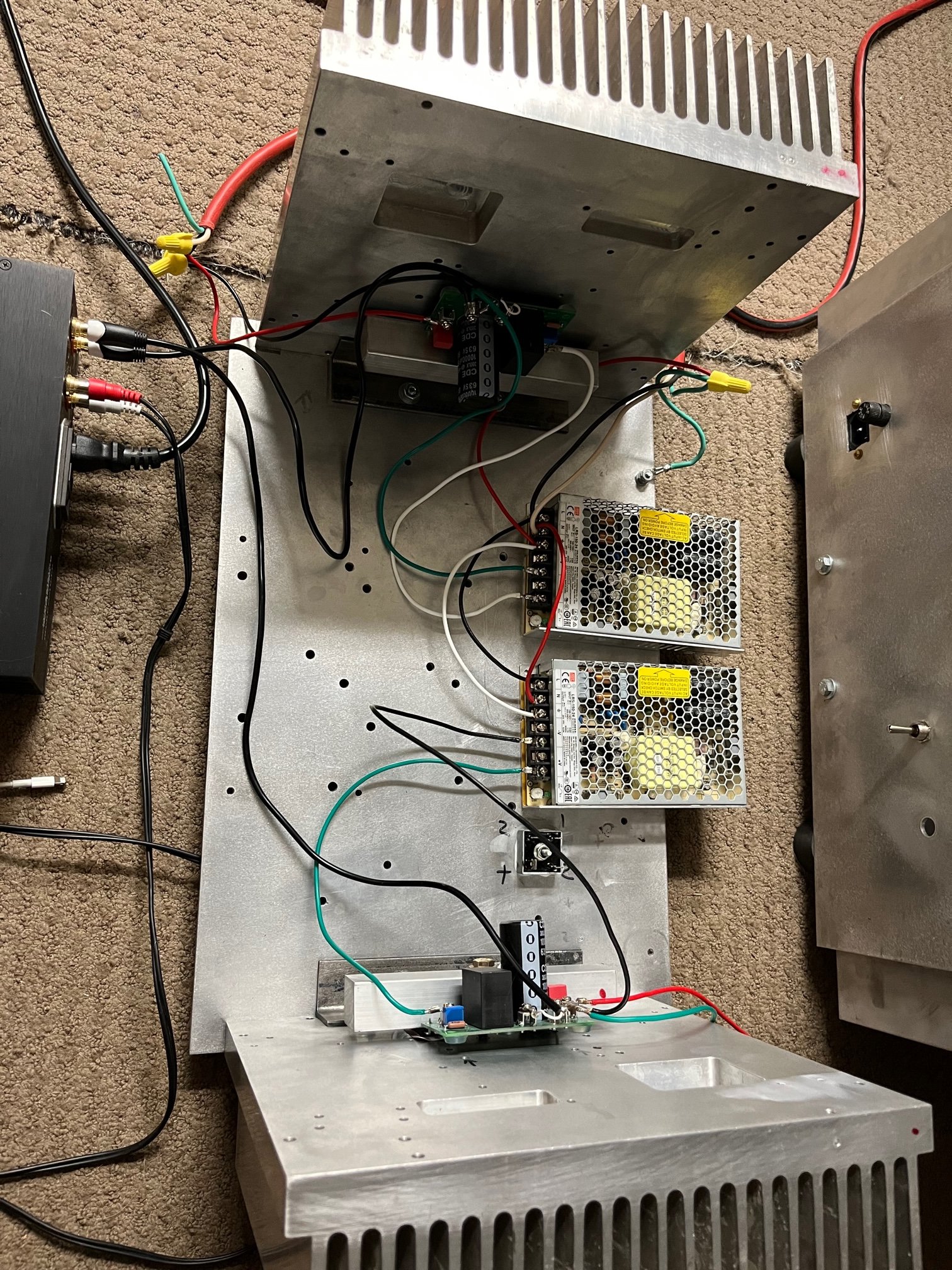

Exactly!! just whipped these up, should be here shortly. Went with 6800uF for the output cap, and a 0.50R/100W source resistor (ease of mounting). I use a 1"X1" alu bar with a single bolt hole for mounting, gets the fet and resistor in one shot. Looking for 24V (smps) and about 2.5A with a 193V inductor, I think the sinks will keep it alive. Pics attached are an FAOW running at 24V/2A I've been dailying, keeps it cool. Thanks again NP/Mike/Jim! I'd be happy to share gerbers, once I verify it doesn't blow up.
John
John
I can't quite find the Triad inductors in those photos (post #288); are they out-of-frame, connected by flywires?
The photographs are of the FAOW, I believe.
https://www.diyaudio.com/community/threads/faow.325037/
The render of the proposed board for the Zenductor on the far right shows pads for the inductor in the upper left, if I've understood correctly. So they'd be connected with flywires, I believe. I think the boards are on the way, and the Zenductor hasn't yet been built in this configuration.

exactly. Was just showing an alternate way to mount it (or how I do it), makes testing various designs easy. Yes, a 100W source res is beyond overkill, but it aids in mounting and its non-inductive....so I got that going for me, which is nice.The photographs are of the FAOW, I believe.

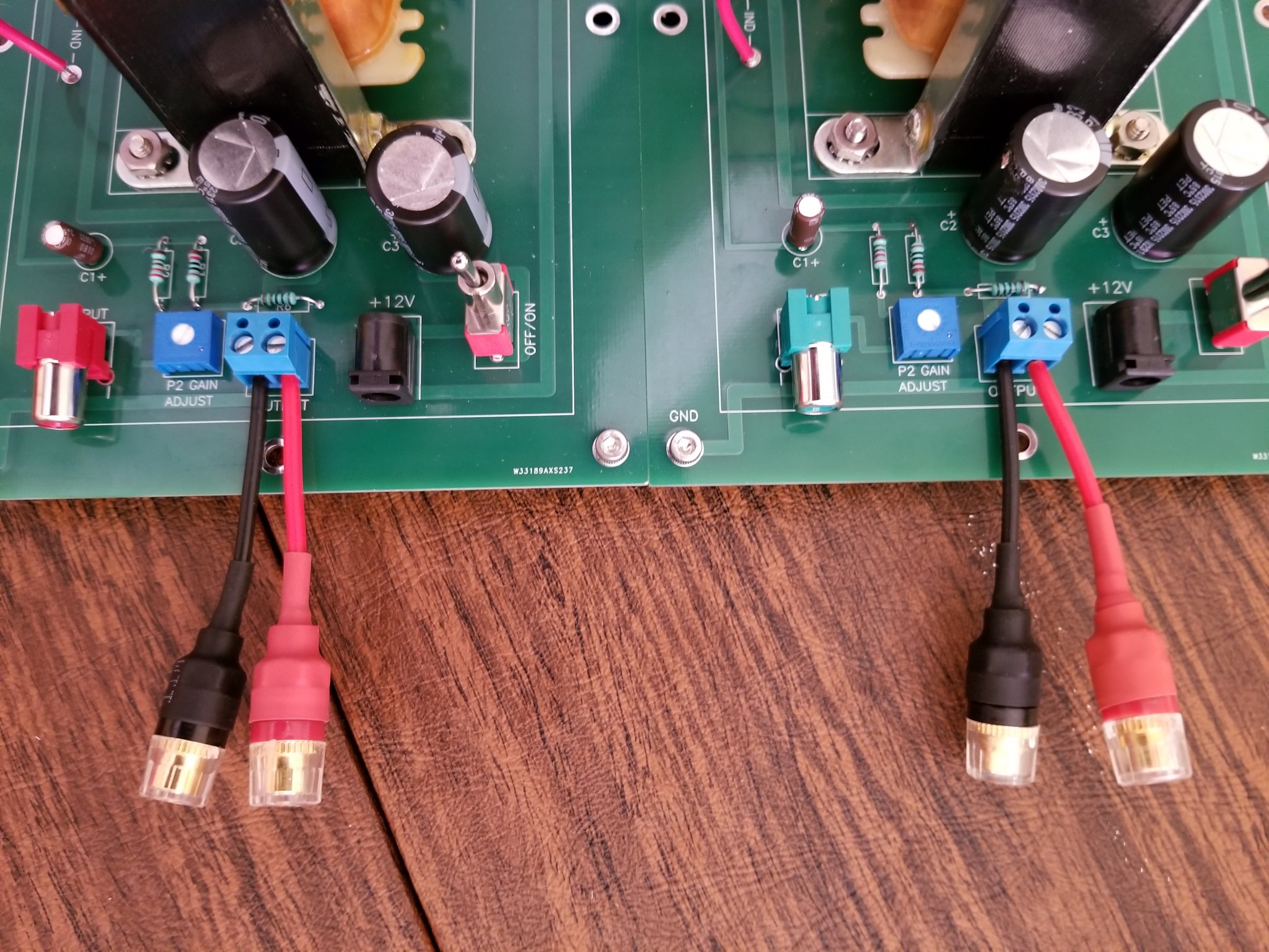

I finally got around to powering up the Zenductors at home. Let them burn (figuratively) for three hours. After about two hours they settled to a nice and very steady 500mV. The house is hot ( trying not to run the AC) so it's about 80F inside. The heat sinks were at 78C. I set it up so the gain was about a quarter of the way up.

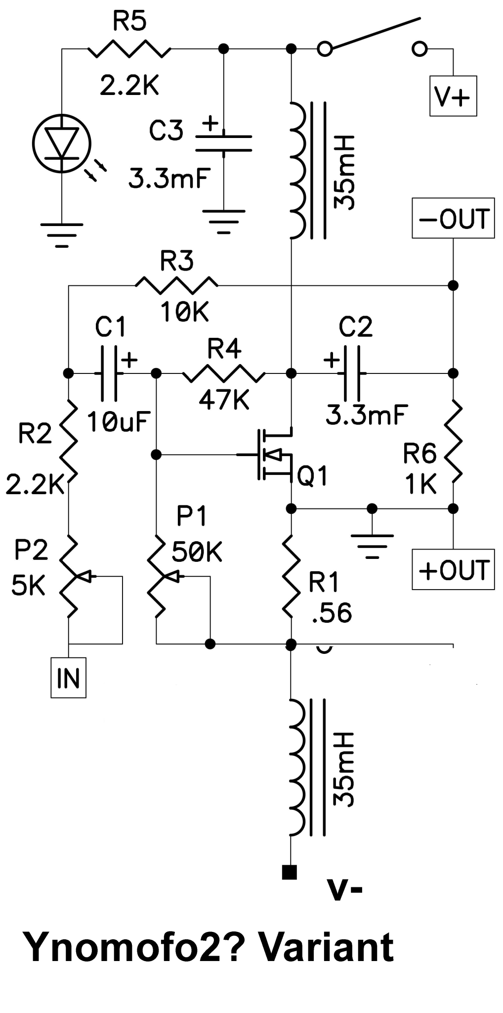

Ynomofo2? Variant
This may be the silliest post of late but I'll bear the embarrassment.
Might this work with the new V- set to match the dc voltage drop across the added lower inductor? The result, in my imagination is a differential output, big swing on top, smaller on the bottom, but inverse phase symmetrical. Might not be worth the effort. I just like the "Super-SymmetriDuction" feature name.
Thanks to you both!, the notion that the inductors would cancel the current between them was nagging me, but I couldn't see my way clear there. And, of course, putting the circuit into LT Spice would have pointed that out almost instantly. I've resisted getting more deeply involved in one area or another, concentrating on system building. I'm also cautious about specific rabbit holes given my age. Nonetheless, every once and a while, I find some concept compelling.
As I stared at the posted modified shematic, I also noticed that the P1 negative end would have to go to the V- below the lower inductor. I'm sure there are other issues in this already remarkably quiet design.
Thanks again.
Thanks again.
