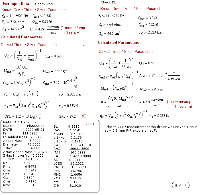

I found two sets of specs out on the net.
Re 7.45 [ê ]
Fs 106.04 [Hz]
F1 81.75 [Hz]
F2 137.25 [Hz]
Zm 50.34 [ê]
D 0.00 [mm]
Qms 5.23
Qes 0.91
Qts 0.77
Bl 0.00 [N/A]
L1K 0.62 [mH]
L10K 0.23 [mH]
Ms 0.00 [g]
Vas 0.00 [l]
dBSpl 0.00 [dB]
Cms 0.00 [mm/N]
Ma 0.00 [g]
FsMa 0.00 [Hz]
and the second
Fs 104 Hz
Qms 5.021
Vas 3.27 L
Cms 0.721
Mms 3.2 g
Rms 0.421 kg/s
Xmax 1 mm
P-Diam 84.85 mm
P-Vd 0.00565 L
Qes 0.915
Re 6.9 ohms
Le 0.58 mH
Z 8.3 ohms
BL 4.0 Tm
Qts 0.774
1-watt SPL/m 88 dB

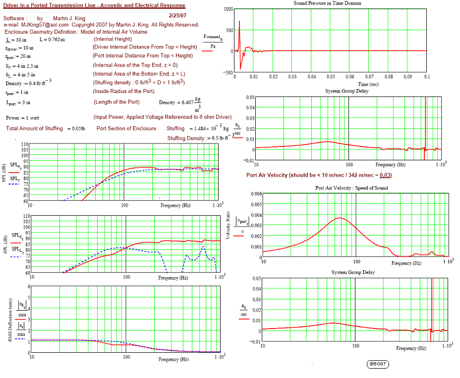

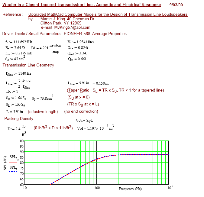

I've had a look at the NSBs in MathCad and frankly, they're not going to suit open-ended TL loading at all well. A closed line will do a decent enough job, but neither open or closed will get you anywhere near 80Hz, unless you're planning on using Roger Russel levels of Eq -given the sheer quantity of NSBs you must be planning for an 8ft tall enclosure (about 20?), that might be worth exploring as 80Hz isn't unreasonable. FWIW, I'd make life easy for myself and stick them into a sealed box, possibly with some mild aperiodic venting to recuce the impedence peak a bit.
Scott
stick them into a sealed box, possibly with some mild aperiodic venting to reduce the impedance peak a bit.
Agree and this can be extended to a small volume MLTL and for array application, but it seems that nothing is gained with a MLTQWT or classic TL approach.

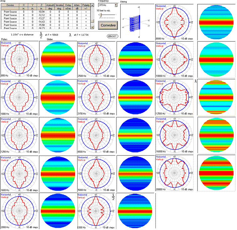

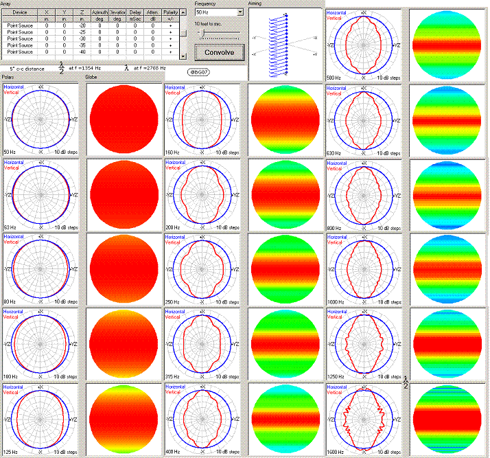

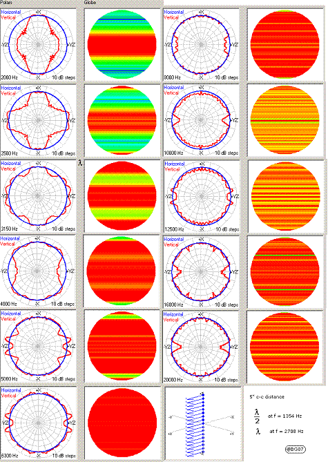

I'm planning on line arrays because of their very large sweet spot and ability to reach reference levels without strain…..But I hope this relates to the topic since ultimate HT is for me line arrays (opinion only). Would be interesting to see if some of the experts here would recommend full floor to ceiling line arrays for the surrounds or if half height built as a dipole would be better…
First FYI, look at the polar pictures and draw your own conclusions…you may find differences to what’s earlier claimed in the tread above.
For surrounds I rec. you to try 5 element NSBs Bessel arrays in closed boxes, used in pairs, two or more, preferably 4 at each side placed differently for both Ls and Rs lateral use (solves the impedance problem).
Place them at the floor close to the sidewalls, aiming at the ceiling, hide if possible, they are real omni in dispersion and there is no need for any extra tweeters.
There is no gain using full-length arrays, as Ls and Rs mostly are placed at the rear azimuth of ‘cone of confusion’ and 5 elements Bessel arrays work also well as rear placed surrounds.
But for this later mentioned purpose, I prefer 25 elements Bessel arrays in the rear corners or one placed as a rear center, horizontally placed and almost covering the whole length of the wall at the floor or the at the ceiling level.
My opinion is also, that the use of besselarray types for all surrounds sounds guarantees a more natural experience when music is performed and when a DVD movie is played the only way to hear the location of any bessel surround speaker separately is when you place an ear within a feet or at max two, in front of a driver baffle.
I have never heard complaints from anybody attending a DVD movie session when using Bessel arrays for all surrounds in a HT set-up except for the frontal speakers.
However, I have not heard, (all my friends agree), a HT setup in a normal living room, large or a small, with conventional speakers that hasn’t got complaints from all attendants but the one who’s is lucky enough to sit in the sweet spot.
When using short Bessel arrays for surrounds, this never seems to occur.
