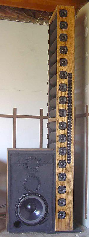

Just in case anyone would actually like to see my line arrays in my partially finished music room:
What XO point are you using -- those mids are spaced awefully far apart... and what tweeter to get down low enuff to meet them?

Dave,
I'm sure you will disagree with my statements herein since you have with everything else I said. Someone who believes that the finest speaker system in the world is a one speaker device running on 10 watts of power is surely not going to see any use in the "monster" system I use. But then again you will not be able to play Little Feat's DIXIE CHICKEN at full normal concert volume without any distortion at all on your system, and seamlessly switch to Michael Murray playing Bach's Toccata and Fugue in D minor on the organ, and close your eyes and believe that you are actually in the church where it was played. Unbelievable Realism.
So, the proof is in the pudding, and I'm eating to the pudding.
The lower crossover to the woofers is at 165hz. The upper crossover to the tweeters is at 2600. The center to center distance is exactly 5 inches. This sets the upper limit to: 13560/5= 2712hz as the maximum crossover to avoid THE BEGINNING OF comb filter distortion. I'm under that limit. There are other theorists who may suggest other limits, but this one works in practice.
The midranges are designed by Sammi of South Korea. They were designed to sell for about 16 bucks a piece, but Sammi could NOT find anyone to buy a three inch widerange speaker at that price. They have copper voice coils, paper-fabric composite cones, and 3.3 Xmax and are pretty flat in FR in the range that I use them. Sammi unloaded them in the buyout market for quite a bit below market value. In the large group, they only have to handle 5.8 % of the total midrange volume per channel. Additionally they are placed in separate 4 inch by 23.5 inch PVC closed tubes stuffed with 4 lb/cu ft fiberglass. Closed tubes have some unusual features which augment clarity in speakers that I won't go into now, but I tested them in boxes and in my tube design, and verified the clarity myself and with to audio observers. This also makes a difference.
I am using Dayton Neo 20FA's. These tweeters are the only dome tweeter of any quality that I am aware are available in the USA which by cutting the flanges can get the center to center distance below 1 inch and closer to .9. This has to be done, and if you look closely at the photos you can see the tightness. The keeps comb filter distortion in the tweeters above an inaudible(for me) frequency of about 15,000hz.
The normal crossover for this tweeter when ONLY one is used is 3500hz. However, this is a generalized number for a 2nd order crossover of 12 db/octave slope. Mine is a 24 db L-R electronic crossover. And instead of letting just one carry the load, 30 of them are carrying the load. Discussion about this tweeter on the Parts Express Audio forum(Dayton is the brand name for PE), puts the tweeter as low as 2200 for a 48 db/oct slope, and easily do-able at 2600 for a 24 db slope when each one is only carrying 3% of the total frequencies. And of course, my crossovers are stable since they are electronics.
This is a fairly well established 1/2 wave TL. Probably the most prominant example being the B&W Nautilus. These work best if the damping gets progressively denser as you approach the end of the line.
You tubes are, in theory anyway, a little short for their XO point, but probably sufficient given the high stuffing density -- did you also try them open ended (that would take the tuning down an octave and resuce the pressure in the line.

Dave,
The tubes were designed to reinforce the frequency of about 150-160, not as a TL line. I looked at TL's but I really don't understand King's spreadsheets. I don't have a math degree like you(My son does in fact have a double BS in both math and physics, and is 1/2 way to a PHD in nuclear particle physics at Notre Dame University, and he gets his math abilities from me, not his mother.)
I wanted them as a sealed design. But you are right about the intensity of the Fiberglass stuffing---very dense, as per Vance Dickason research recommendations in his 6th edition book.
I never had any intention of using them open ended since I didn't want to lower the extension anywhere near the FS of 100.3. The system is designed as a three way with two woofers not a two way with a sub woofer. I don't believe in two way line arrays, and thus don't care much for those with 7 inch woofers and ribbon tweeters arrays. I don't think their transient response is a snappy as my combination 3 inchers and domes---my opinion of course, and they also have to put their crossovers right in the middle of the range most sensitive to the human ear---300-3000, which makes no sense at all to me(in this sense single speaker systems make some sense.)
I've even used the woofers up to 300hz and they do great, but the 34 mids do a nice job with really tight mid bass down to around 165hz. Much below that they start to get sloppy. I knew that ahead of time, so I haven't checked for sloppyness, i just set them above it.

I listen at about 8.5 meters to stay within the nearfield for the tweeters. This is also the distance we need to be to see the 50 inch Plasma TV that will go in the center early in August. The room is 12 x 16 x 8 feet high.
Something doesn't add up there 🙂
8.5 m ~ 28 ft which would have you listening from another room.
I haven't bothered to measure yet, but when I do I will be using a calibrated Apex 220 mic with Fuzzmeasure on my Mac.

Zarathu said:
sorry.... a little less than three meters---about 8.5 feet.
I did a bit of analysis myself... with ~1" tweeter-tweeter spacing, the tweeter array is pretty close to 3/4m high which, by Griffin's chart, gives a nearfield transition of ~10.3 ft at the XO so 8.5 ft gives you room to consider that the tweeter array doesn't have an infinitely fast rolloff.
