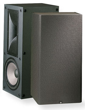

Surrounds I'd do something similar to the jbl synthesis dipole surrounds.
