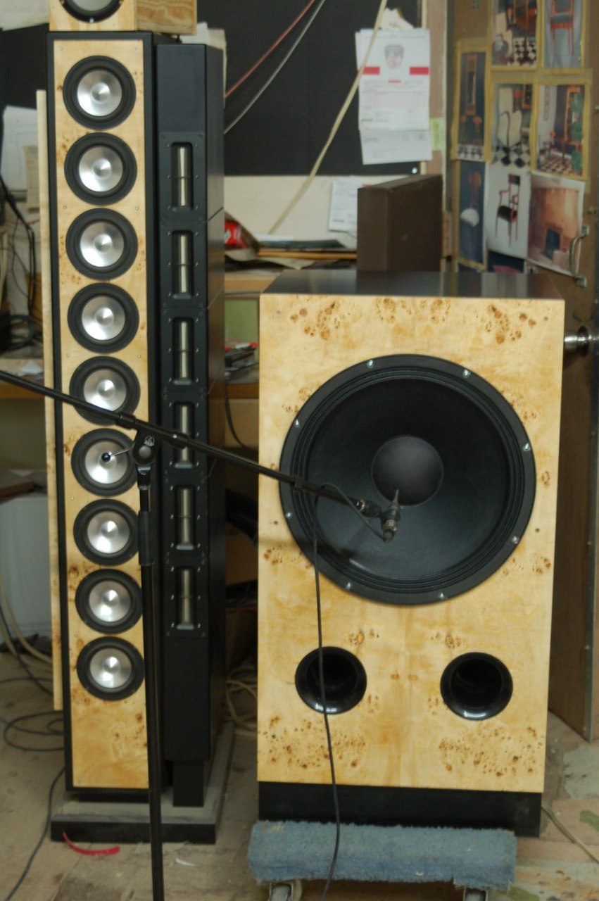

This one is mine.
Back to passive crossover.
Tweeter is Fountek NeoCD2. It's crossed around 3k with the third order electrical and a bottomless notch at 1600hz. Actually, it's the most problematic element in the array because it's so hard to beat in to submission.
I am waiting for custom tweeters from Viawave to replace these.
If you look for "dead spots" in the projection between the tweeters you can spot them near the array, however 5-6ft away I don't think anyone can. My listening chair is about 7 ft away and the array create wonderful dynamic immersive presentation of the recording.
I mean the driver characteristics. What's in the pass band and what limits the pass-band. CD2.0 has a resonance at 1300hz and it's fairly hard to suppress in terms of crossover design. Requires lots of parts and careful work. I was addressing particular driver, not the general use of tall ribbons in the array design.
Isnt the point that the CD2 has resonance at 1300Hz and it is advised to crossover at least 1 octave above it?
Besides the peak, the CSD shows the temporal effects
The CD3.0 and H variant, which I use, has similar issues at a similar frequency. Crossing high enough and at least 3rd order knocks it into submission, pretty well.
Adding a coil across the shunt element, might help by turning the filter into an elliptical type, except that the lack of attenuation below the notch could cause issue.
The same technique applied to a low pass, the drop in attenuation is at least countered by the VC inductance, to some extent.
