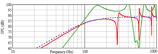

Here is a plot of the comparison of open & closed pipes 23.5" long, 4" diameter (using TB W3-871S since we didn't have the Sammi data). Note that the line has no damping to better show off the harmonics the line produces. As well the pipe is not necessarily optimum in either configuartion, particularily the open (quarter wave) situation -- the purpose is to see where the harmonics fall.
You can see in the case of the closed line we have twice as many resonances in the line as in the open case (ignore that the open case it is larger -- as can be seen be the deviation from the blue line it is far from optimum). So while it is true that the closed tube only resonants on the even harmonics, becasue it is half-wave there are twice as many. You can also see that the primamry resonance in the closed pipe causes the 1st null, and in the quarter wave pipe the bottom peak. Further the dip at just over 500 Hz is going to be a lot easier to damp than the one an octave lower.
I'm thinking that an appropriate size hole(s) drilled in the back cap of the pipe might have some real positive benefits and allow more progressive stuffing... At the density used it is going to be somewhat reflective at higher frequencies causing some time smear.

How big a hole?
I think I understand your diagram. But if the even harmonics are just greater or doubled, it doesn't change my reasoning that evens introduce clarity(which in too much sounds like screeching) which, again in my reasoning, would augment the clarity of the speaker as a whole.
Since I've experienced this with the tubes, perhaps you could suggest another scenario if this one doesn't work for you.
Actually I have it wrong, its the odd ordered harmonics that are produced in a closed tube. I can never remember this for some reason.
Zarathu
No, you had it right first time. A closed line produces even-order standing waves, while an open-ended line produces odd-order.
I'm not sure I quite follow the reasoning that even-order harmonics introduce clarity though. Assuming that the harmonics (which we surely don't want in the first place) are supressed by proper driver placement in the line and judicious damping, it shouldn't make much difference if they're positive or negative. FWIW, I've never experienced it myself at any rate, though as ever, YMMV.

Do keep in mind that due to the density of your stuff -- assumming it is uniform, the highest frequencies are going to see it as solidand bounce back much sooner,
If you can give us the parameters of the Sammis it would be possible to see if the existing tubes could be turned into ML-TLs that work... without that info any suggesttion as to what size holes in the end would be SWAG.

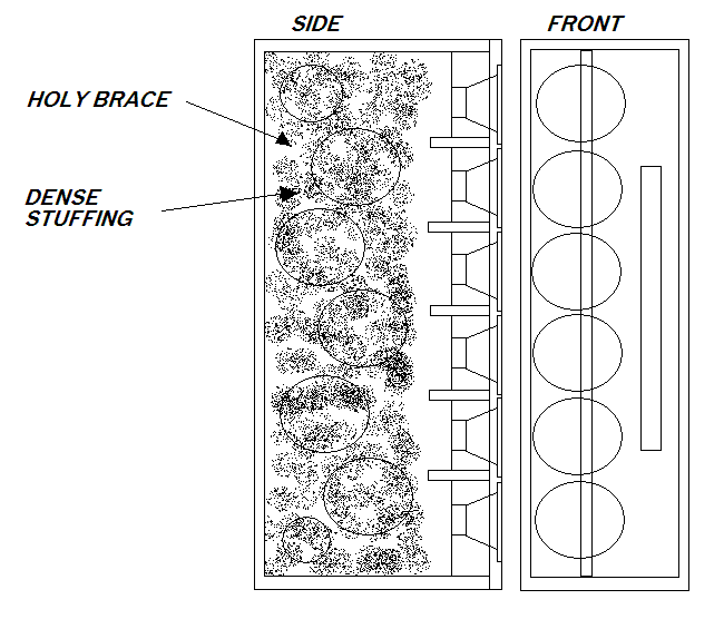

Zarathu & Dave: I know diddly squat about line arrays, but my interest is growing. Could the same effect of the stuffed pipes be had with the following plan. Scaled down for clarity:

Actually, they are TLs. They entirely supress and damp the rear wave of the driver, and will present an ~flat impedence curve to the amplifier. By definition, that's a TL. I don't think Dave was suggesting turning them into MLTLs for you though -he's just interested in the drivers, and other ways they can work.
With 4lbs ft^3 of stuffing, the tubes will be doing very little as that back wave will be completely eaten -that's the heaviest damping I've ever heard of. The highest I've ever used, for a completely aperiodic TL was 0.75lbs ft. As Dave pointed out, in general terms, you have to be very careful at very high densities as the material will be near solid, and behave like one.
