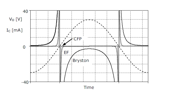

Yes Pavel, see attached, from the upcoming (first!) Linear Audio book:
Power device current of emitter follower, Bryston and CFP output stage low-frequency crossover. Output voltage dashed. Transistor currents zoomed to show crossover region. Solid = Bryston, dotted = emitter follower and solid grey= CFP.
CFP is very sharp, leading to a spray of higher order harmonics.

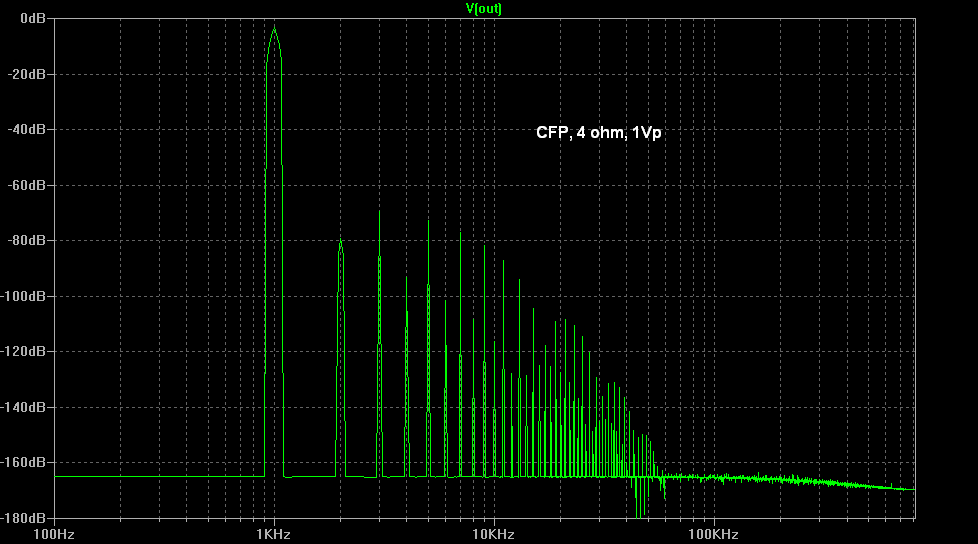

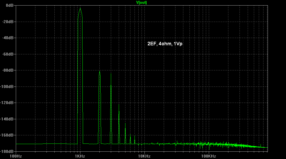

Hi Jan, please let me show FFT view to the same problem. We can see it very clearly at low signal level. Attached are spectra for 2EF and CFP output stages, loaded with 4 ohm, at 1Vp output voltage. Re is 0.1 ohm in both cases. V(Re) is 23mV for 2EF and 3.2mV for CFP, values close to 'optimal' according to D. Self book.

Only in case you would build class A CFP. CFP seems appealing for class B (AB), as it requires lower bias current (= less power) for 'optimal' THD. For output amplitudes like 10V, yes, overall THD is lower than for 2EF. Spread of harmonics remains always almost to infinity, but they are seemingly lower in amplitude for higher output voltages. But, for lower amplitudes about 1V (which is the level where you normally listen at room level for most time), high harmonics for 2EF output stage almost disappear, though for CFP they become dominant. Then you have only a NFB to suppress them. IMO, and I am pretty convinced about it, this is the reason of 'sterile' sound of amplifiers with class B CFP output. I use the term 'class B' for 'optimally biased' AB according to D. Self.

I'm having trouble understanding your graph. Maybe I'm being dim, but it seems to show the device currents shooting up at the voltage zero-crossing, rather than dropping to zero.

Jan, output stage from which Bryston amplifier? any idea why one polarity drops to near zero current and the other does not?

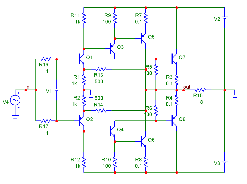

Not sure what Jan has simulated, I know something like this:
Your diagram shows the configuration I know, though the resistor values are different. (see APAD6 p248)
To my shame I have not so far been able to find the time to simulate or build it. Bryston say that it is made fom "hand-selected parts" which may mean beta-matching (though that would be automatic in simulation) or possibly something more subtle.
