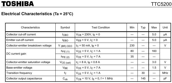

...about a practical view: two 1A 2SC4793/2SA1837 driving 8 pairs of 2SC5200/2SA1943 at +/-70V is a joke from a drivers SOA and even max current perspective.
You need much stiffer drivers (like another pair of 2SC5200/2SA1943) and then there goes your high ULGF.

Ummm... is very late here, will take a closer look tomorrow. However, correct me if I'm wrong, is in simulation the 2SC4793 driver maximum collector current (bias plus output devices base current) about 0.2A? That would lead me to the conclusion that in your simulation the output devices would have a beta of 32A/(2*0.2A)>80 (at Ic=32/8=4A). That's about double what the 2SC5200 data sheet guarantees as a minimum (35 at Ic=7A). What is your 2SC5200 model, and how good does it sustain beta with Ic?
As you said, in practice it's probably the power supply collapsing that is protecting your drivers. I still believe that 8 pairs of bipolar output devices, driving 2ohm at +/-70V supplies, as a design target, need a much stiffer driver.

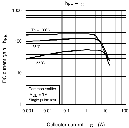

The models BF value has been set to 79. Minimum beta of 80 is guaranteed for a current of 1A. Minimum beta of 35 is guaranteed for a current of 7A. Output current protection of amplifier starts at about 35A. 35/8 ~ 4.4A. So the minimum beta is far higher as 35.
Thank you for confirming my findings. Designing by the data sheet curves is not a good idea, since they usually show typical performances rather than the worst case (which should be considered when it comes to delicate things like SOA).
Could you please post the 5200/1943 models you used in simulation? They may have unrealistic sustained beta at high currents. Few free models for power devices are implementing correctly the beta drop.

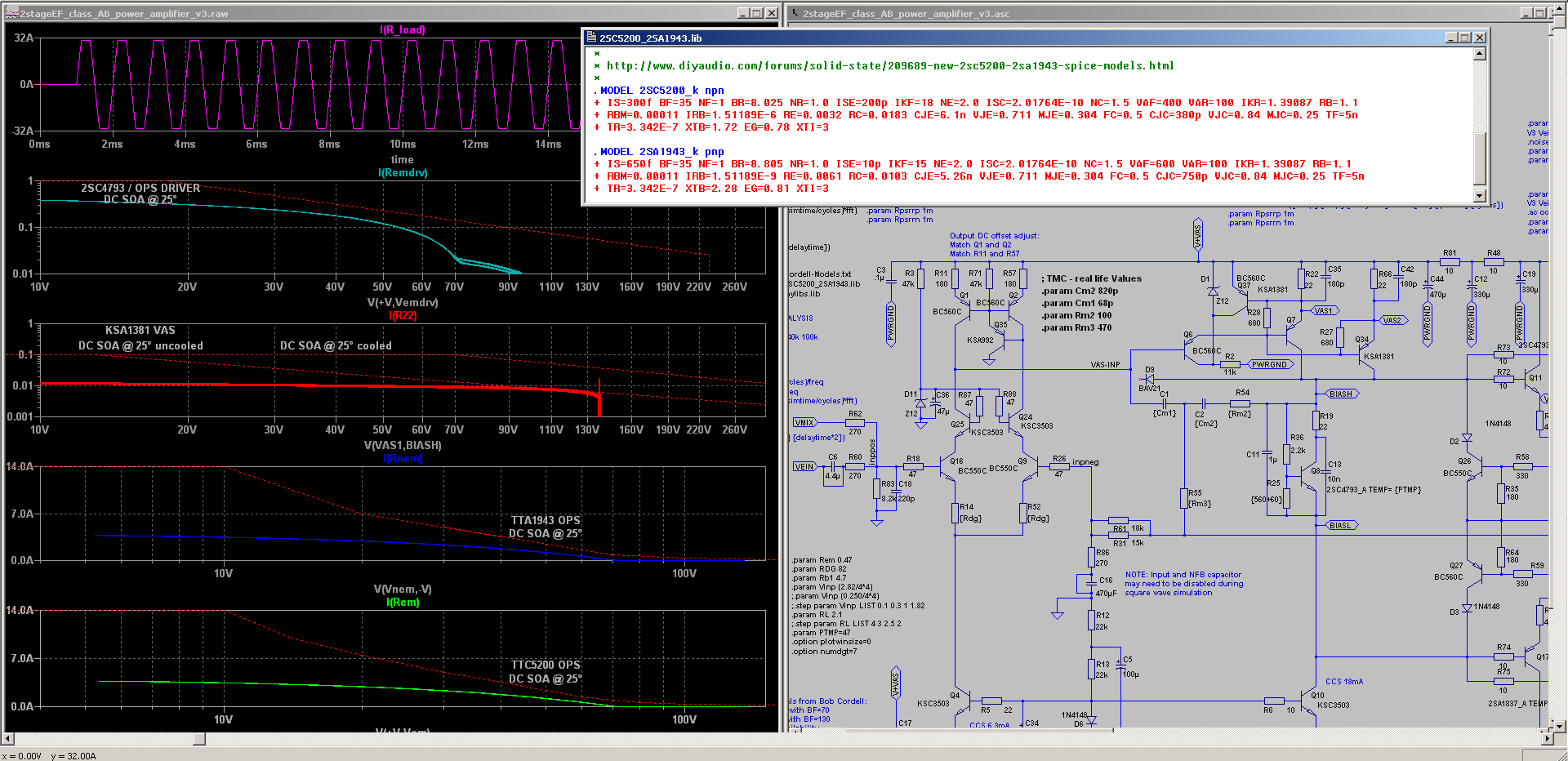

Attached SOA simulation using BF=35 for 2sc5200_k and 2sa1943_k.
Thank you. These are at 25 degrees. Now derate the SOA curves for a realistic operating temperature (say Tc=75 degrees) and see where your driver SOA stands. You can't rely on 25 degrees at those high powers as a design target.
Even this has been taken into account. Don't forget we have more as the minimum BF=35 as the max current per ttc5200/tta1943 can't exceed 4.4A due to current protection.Thank you. These are at 25 degrees. Now derate the SOA curves for a realistic operating temperature (say Tc=75 degrees) and see where your driver SOA stands. You can't rely on 25 degrees at those high powers as a design target.
Even this has been taken into account...
Not to mention that your load lines are DC, some extra factor for the transient nature of excursions.
At worst, just don't use bottom-of-the-bin transistors.
Best wishes
David
... also to be noticed: if junction temperature of ttc5200/tta1943 rises they have increased beta ...
