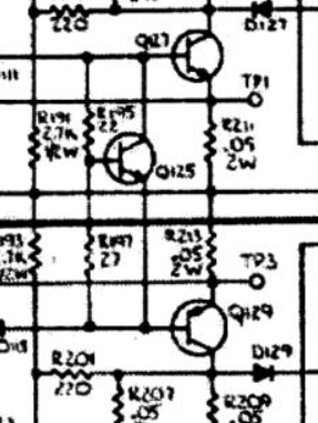

That's the second time in a couple of days I've encountered the term "common mode lockup" and "common mode conduction", the first being on a Carver amp that has a strange transistor added between the bases of the final output devices. Apparently it is to prevent "common mode conduction", and certainly a technique I have not seen used before.

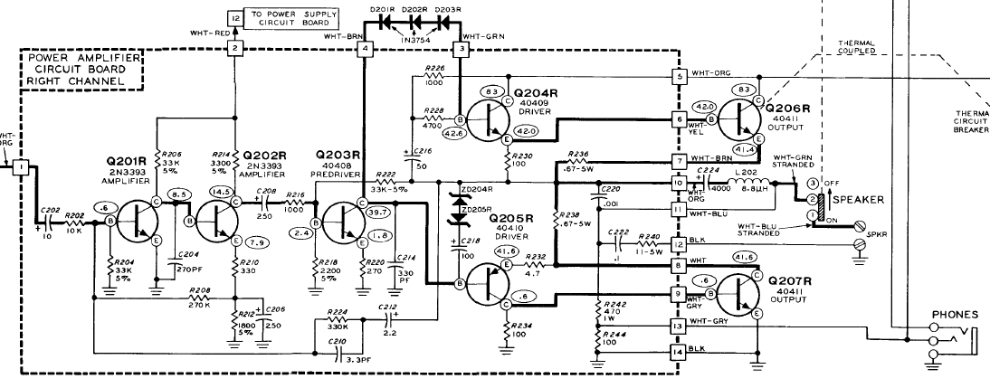

Schematic attached. Circuit from the VAS forward is almost the same as an RCA document from maybe 1967.
I don't think the VAS went out, just drivers, outputs, and emitter resistors. It was rebuilt and has been working for over 40 years.
You are correct, not a high priority for research. I looked at redesign several times but this unit also has a single supply and capacitor coupled output and with no center tap on the transformer, there is no way to redesign into anything worthwhile. Thanks for looking but don't spend too much time on this.
Well, there's certainly a fairly big resistor in the VAS emitter that may have kept it safe. Hard to say.
Many thanks for showing us the schematic. It looks like an early 4-stage amplifier, which is fairly unusual. There is no sign of Miller compensation, which is also unusual, and several components whose purpose is rather hard to fathom. It would be interesting to analyse it, but I can't say it would be my first priority in advancing the state of the art.
I've never seen an input stage like that. The RCA circuit this was taken from uses a more typical differential IPS.
C214, lag compensation, may have been the order of the day.
You are probably looking at the Zener diodes. That was an early, ill fated attempt, at short circuit protection. I believe they are 4.7 V.

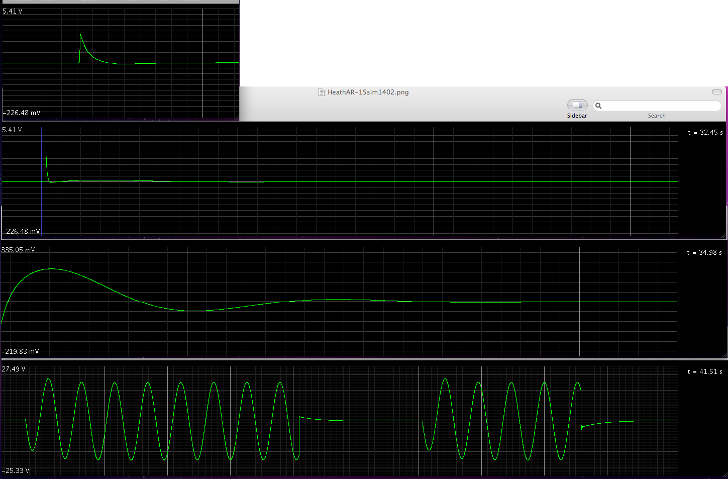

Quite correct. I often wonder about those that restore some of this stuff without doing some redesign. Again, being single supply, this is not worth the effort. I have a simple Java simulator (Circuit Simulator Applet) and entered the schematic. Due to charging the output capacitor, there is a 5 volt pulse to the speaker at turn on and a very low frequency decaying oscillation. Additionally, this oscillation appears on application or removal of a large signal. It's inaudible but obviously is not good. This analysis has turned me against any capacitor coupled output which includes a number of highly regarded Fisher receivers.
The 3rd trace is after the 5 V spike so the vertical scale is expanded. The 4th trace shows the DC shift with a signal.
