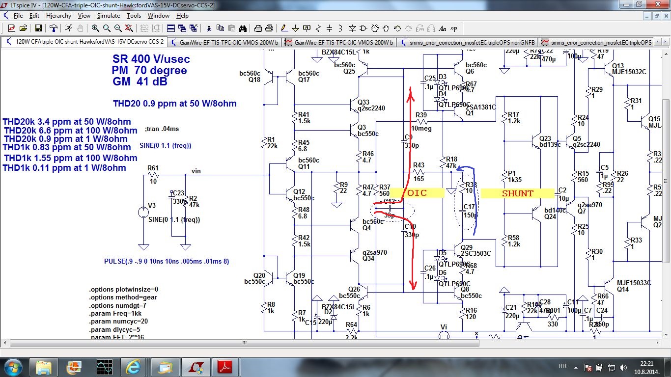

It would be helpful if you could point out the relevant components implementing this in your schematic.
Output Inclusive Compensation (OIC) , output via C12 and C9, C10 to the VAS input.
Shunt C17 and R38.

Phase margin of 70 degree and Gain Margin of 41 dB looks stable to me.

C17 looks far too small to implement shunt compensation, though it might be useful against parasitics. When I replaced a 100 pF Miller capacitor, I needed 44 nF of shunt capacitance to get the same o/l gain roll-off. That was using a single-ended VAS, but I doubt if the properties of the circuit we are discussing here are that radically different.Output Inclusive Compensation (OIC) , output via C12 and C9, C10 to the VAS input.
OK, I would say that C17 and R38 help the main OIC to get better Bode plot.
I did not simulate VAS output impedance, but it looks that it is quite high.
Yes, but it is only a simulation. Have you actually built that design?
Yes this is only simulation, I did not built it yet, but I am quite confident in the simulation result.
I have built my TT TMC amp(showed some pages earlier) and simulated values were very accurate, amp is stable and in use for two years now.

In the past we have already discussed this matter. Now you are giving the same answer again. C17 (together with R38) is not meant as a replacement of the traditional Miller compensation cap and is not meant to stabilize the global FB loop (as for the latter, these caps are located elsewhere). Instead, the purpose of C17 is to stabilize the Miller loop itself. Obviously, the value of this shunt capacitor should be much much lower and certainly not a huge 44nF.

Dear Mr Self,C17 looks far too small to implement shunt compensation, though it might be useful against parasitics. When I replaced a 100 pF Miller capacitor, I needed 44 nF of shunt capacitance to get the same o/l gain roll-off. That was using a single-ended VAS, but I doubt if the properties of the circuit we are discussing here are that radically different.

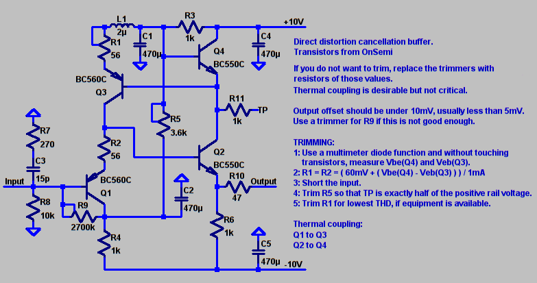

More schematics :Adrian-Kingston.com - Technics SE-A5
Joachim I was thinking along the lines of SAE 5000 series, these have a more complex vas and probably lower distortion than the example you posted. I didnt find figures for SAE 5.

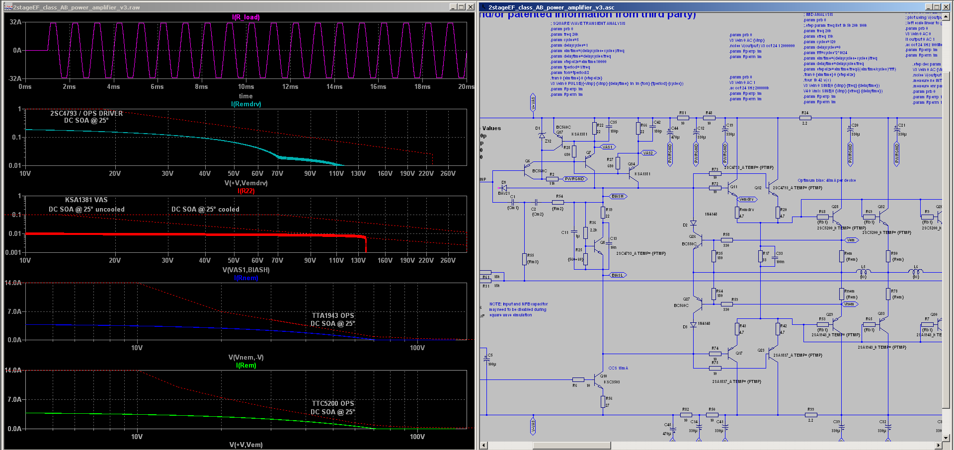

I'll check it out in detail, but speaking about a practical view: two 1A 2SC4793/2SA1837 driving 8 pairs of 2SC5200/2SA1943 at +/-70V is a joke from a drivers SOA and even max current perspective. You need much stiffer drivers (like another pair of 2SC5200/2SA1943) and then there goes your high ULGF.
Attached the joke driving 2.1R during heavy overload just before current limit starts. The PSU would not be able to deliver such high currents.
