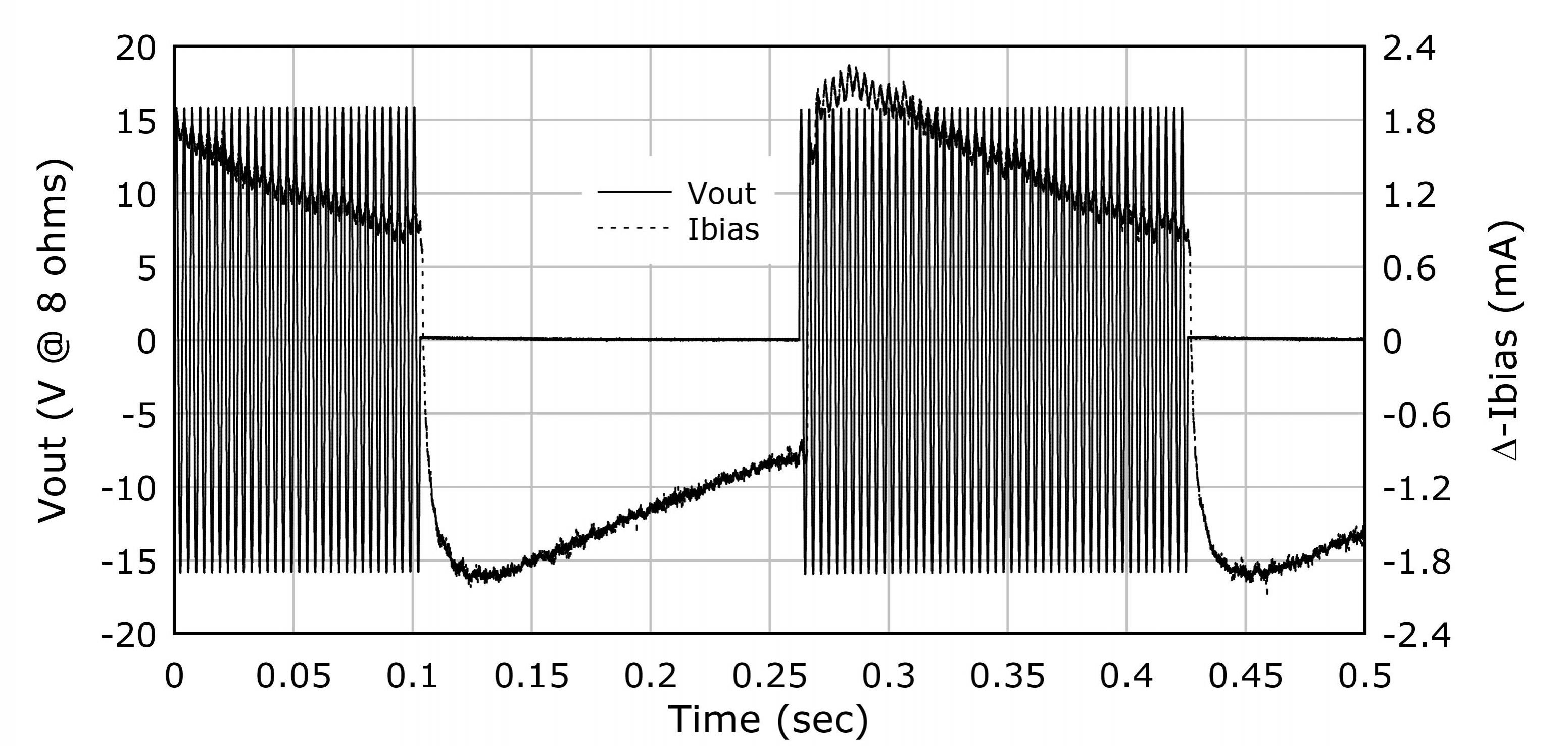

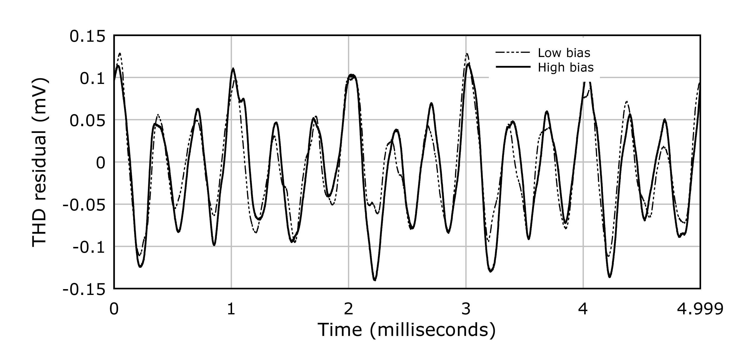

The other approach is to prepare time domain distortion residual measurement with notch filter tuned at specified frequency, differential amplifier and oscilloscope. Then just turn on and turn off the sine wave and look if the distortion residual wave on the scope remains the same. It does not, and what you see is the changing bias with transistor temperature. It is almost impossible to build a thermal compensation that would be fast enough to follow and compensate sudden Vq/Iq thermal transients.
Pavel see attached, just what you mention. This is residual with two bias settings, +/- 4% of nominal (which is what I found a typical thermal shift due to signal dynamics).

I agree Edmond, the 'thermal' way doesn't get that far. In my tests I went from heaksink-mounted TO-3 to 'air-mounted' TO-247 and the difference is very small - in each case you see the thermal delay from dissipation even to the diode on the ThermalTrak devices. Not sure I understand the exact mechanism though.
OTOH, with a few % transient shift in bias, should we worry anyway?
