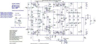

"Against my expectations the SuperTIS is a very stable and rugged Frond End - even with a horribly fast OPS, slight capacitive load and OPS-rail switching. Unfortunately I haven't saved the oscilloscope screens but you can find two pictures of the SuperTIS board attached to this E-Mail."
Cheers, E.
PS1: Normally, people contact me if they have troubles with my designs. You are invited to do this as well.
PS2: The schematic of the front-end can be found here:http://home.telfort.nl/data.odyssey/Super_TIS.html Fig. 6

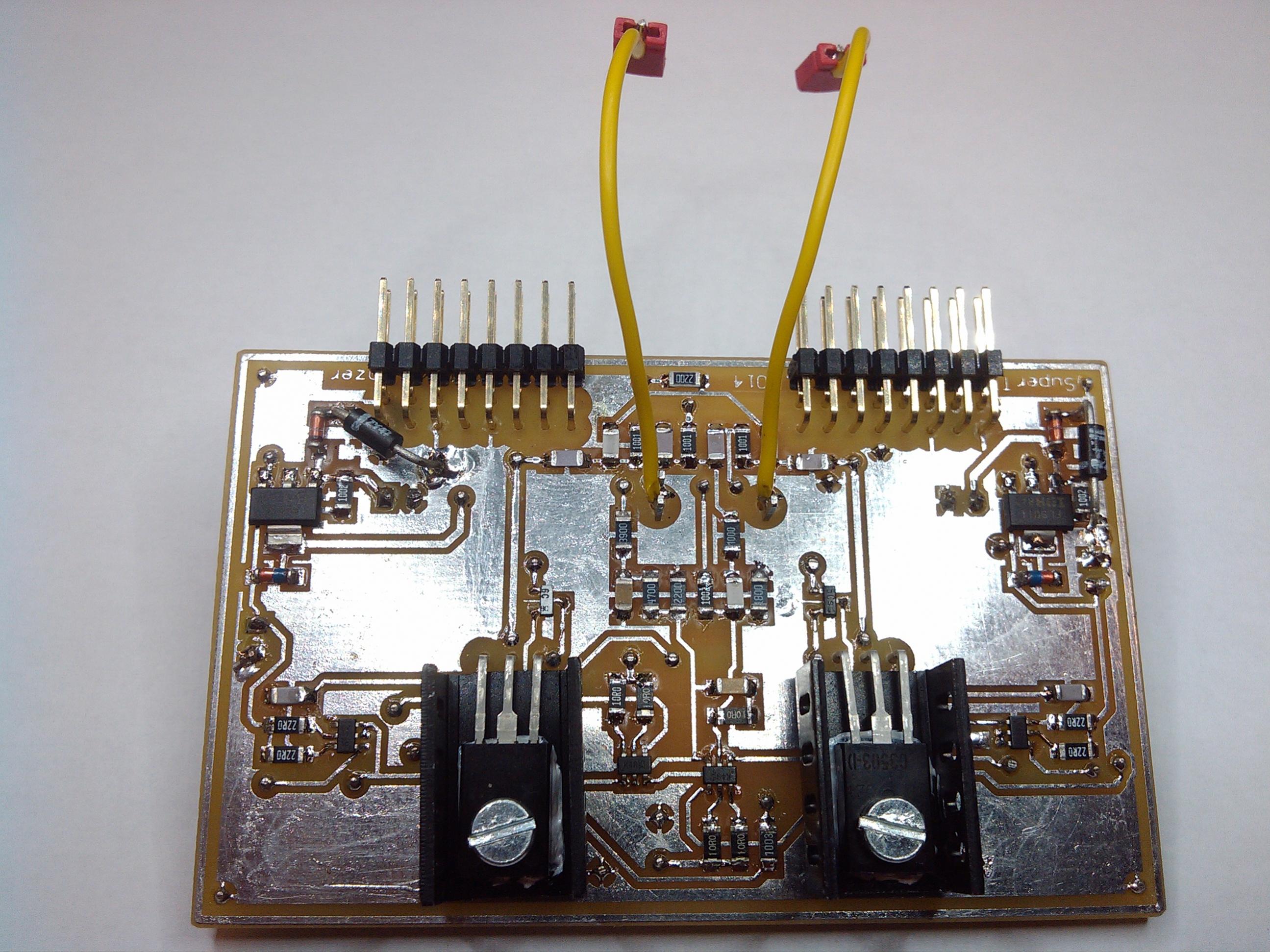

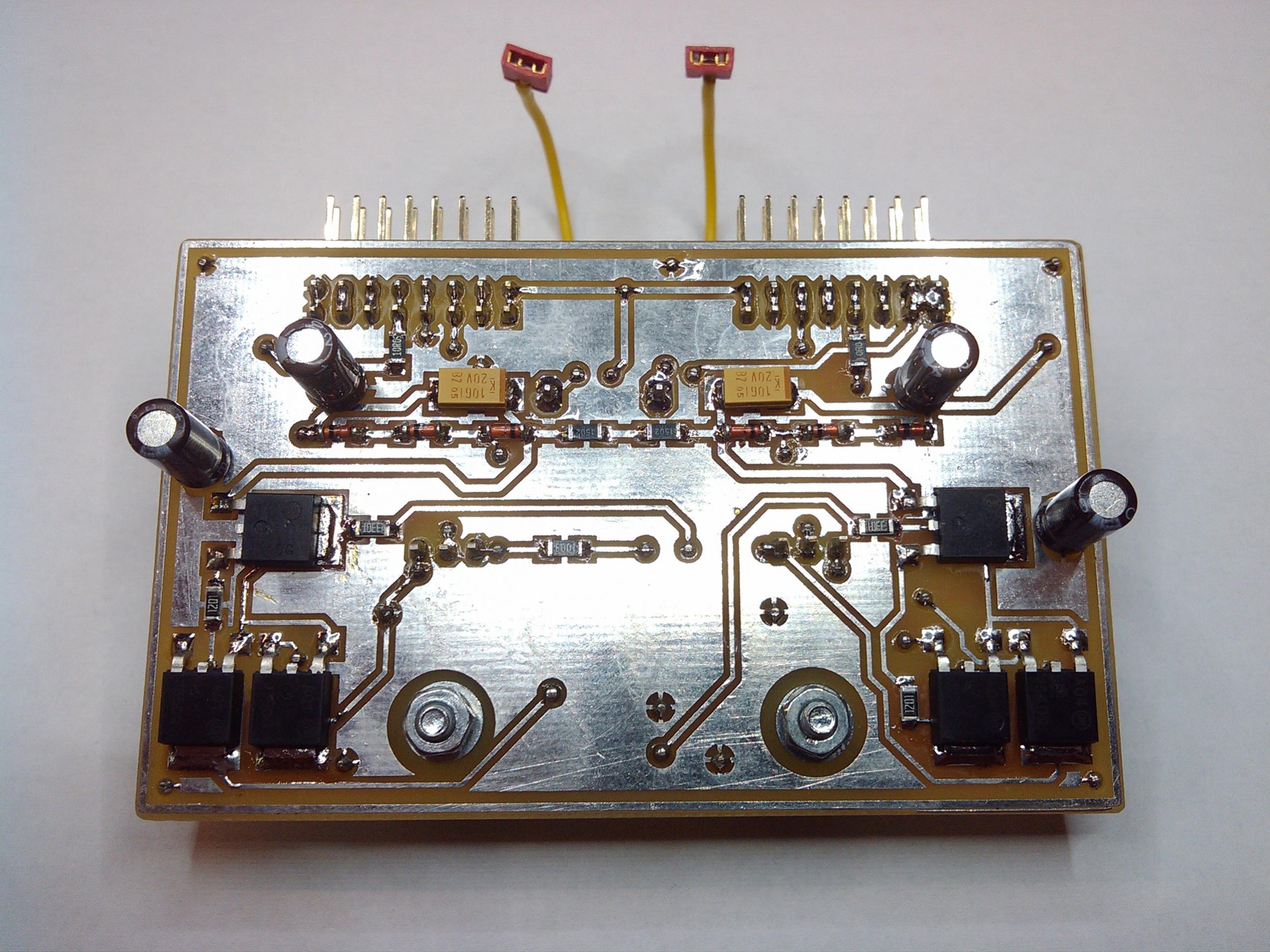

The SuperTIS has been built and tested by Philipp Gutknecht (see pics). I'm still waiting for a full report of his findings. In the meantime he wrote me:[..]
This is the first time you told us this. Have you just simmed it or really built it ? If just simmed, (I'm sorry to say so) it not the first time you have produced erroneous result. If built, please show us the details (schematic, list of components, PCB and measurement results).My experience with Edmond's auto bias was a disaster (in terms of stability), so I take all his extreme designs with a big grain of salt.
Cheers, E.

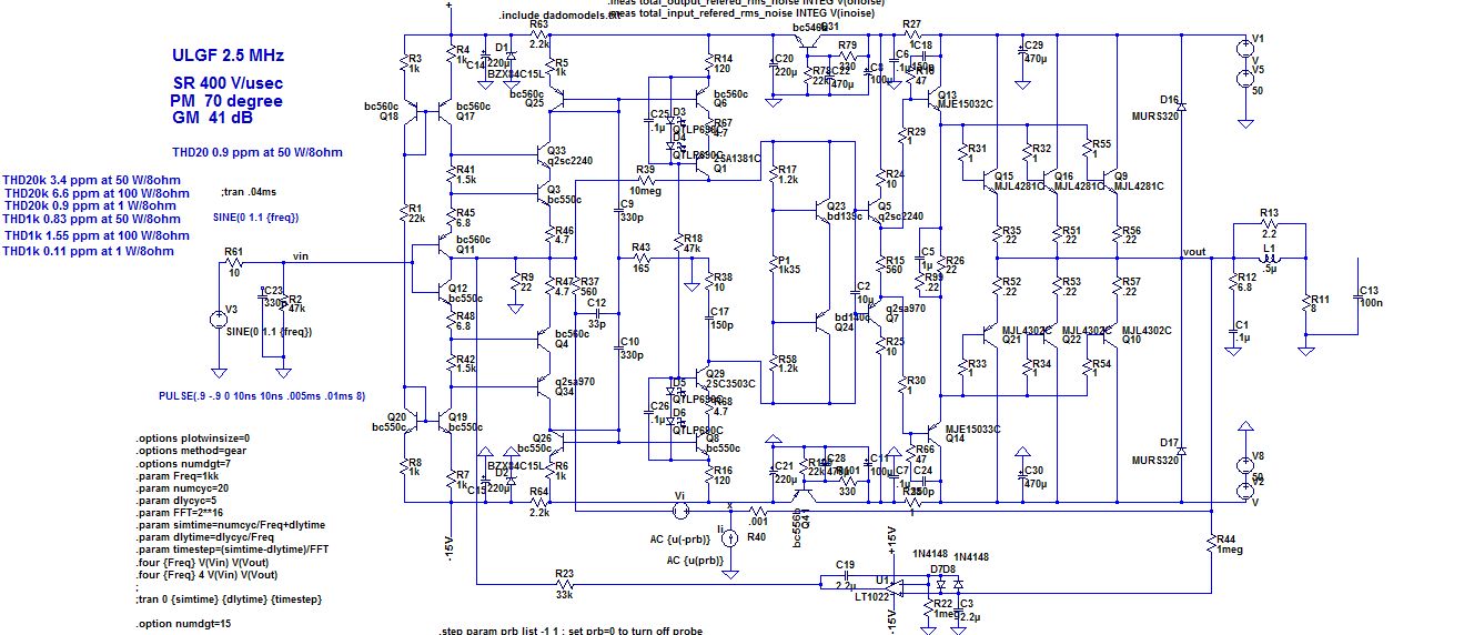

Waly,

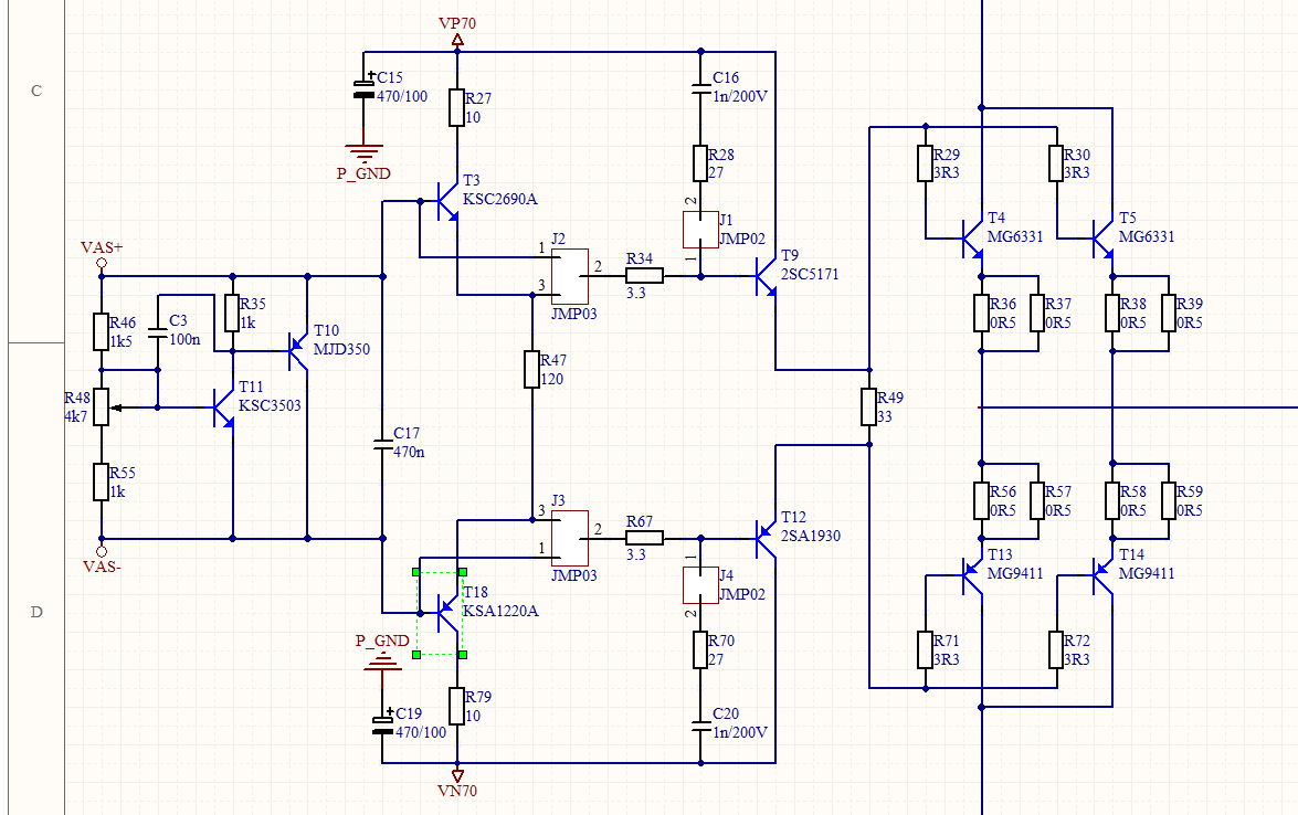

Which of Edmonds Autobias designs did you try? Only asking as I am preparing to prototype an amp using a modified version of his AB2ECV4. May save my sanity if I know in advance if it's going to be "fun" to get working.
Seems to work ok in sims...
AB2ECV4
Paul
Hi Paul,
Which trannies are you planning to use? For Q3...Q10 you will need matched trannies anyhow, that is, PNP to PNP and NPN to NPN (e.g. THAT300 resp. THAT320).
Cheers, E.
Cheers, E.

Hi Edmond,
Plan to use the suggested transistors (THAT300, THAT320) for those positions.
Expensive but saves matching transistors.
As usual my stumbling block is analysing the loops... But have found that omitting R6,7 makes things more stable. At least in sims.
Paul

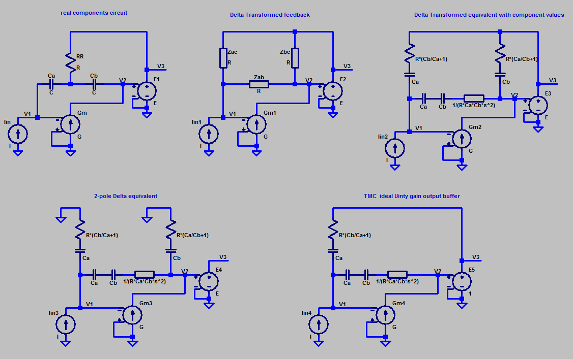

the Y-Delta Transform is useful for simplifying analysis by changing the equivalent circuit's topology to only have simple, nonintersecting loops
the Delta equivalent only has separable loop feedback branches
for the split C, R "T" used for both 2-pole and TMC the FNDR appears in the transformed Y circuit regardless of the connections at the ends
TMC/OIC only differs from 2-pole by the connection of the R to either the output or gnd
the FDNR appears in exactly the same circuit position in both - in the single series local feedback branch across the VAS
with the same VAS local feedback branch both are very similar, the local feedback defines a region of 2nd order VAS stage gain in both cases
2-pole does have Zac,bc shunt loads on VAS input and out dragging down the gain a bit vs TMC with the same component values
TMC with exactly unity gain output stage bootstraps away the Zbc branch across the output reducing VAS loading vs 2-pole
the VAS in TMC has the same local feedback, provides the same 2nd order gain to the output stage
the Zac becomes a outer feedback from the output stage back to the VAS input, giving the "single pole" appearance of TMC's nested loops when viewed as global open loop gain

Adding a zero

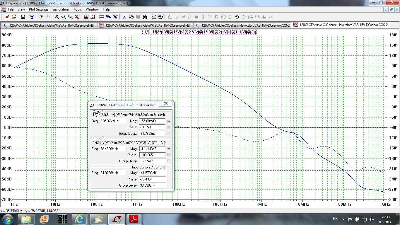

I read and enjoyed one of your poweramp books a few years ago (borrowed from a friend). Not sure which edition. I loved your emphasis on dealing with crossover distortion with the push-pull output stage. I find that many conventional tube type P-P output stages will have substantial crossover distortion when pushed into clipping, which I don't like. I use tubes for my guitar amps and use overdrive distortion for effect, and crossover distortion isn't good distortion IMO. I know of one topology that appears to do that much less. I've always thought that a really good poweramp should have a compressor/limiter that keeps it from ever clipping (very fast attack time), and is completely inactive below the half or quarter power point. Also a passive Rf filter at the input (you probably had that - can't remember - so many amps don't).
I would say that my Fig 1C is attempting to be output inclusive compensation- but it will almost certainly be unstable because of the extra phase-shifts in the output stage.
In spite to be rejected again, I think that Inclusive Output Compensation, in this case in combination with shunt compensation, could be used and be very stable. This amp is with Phase Margin of 70 degree and Gain margin of 40 dB. This is so called CFA with not so low distortion as with a VFA with less components, but looks very stable at least in the simulation.
BR Damir

Please define "TMC can work better".
Lower distortion at similar stability or better stability at similar distortion, for the same complexity. Or some trade-off of these criteria.
...sounds like Mr. Zan caring about audio amplifiers being non-minimum phase systems, because of the bipolar beta RHP beyond Ft, at some 500 MHz. Come on...
You seem to have misunderstood me. In our earlier discussion I pointed out some non-minimum phase behaviour but it had no connection to bipolar beta RHP beyond Ft.
It was caused by Miller compensation capacitor feed forward, a quite different effect.
I am reluctant to reference Bob Cordell's book for a second time in Mr Self's thread, but there is a succinct explanation there on p 176.
It is possible for this zero to move sufficiently low to make some difference if the transconductance of the IPS and the transconductance of the "VAS" are both simultaneously set to values that are atypical but feasible.
