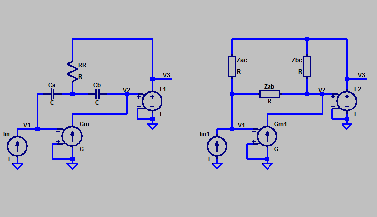

At the risk of embarrassing myself, is this what you're describing? I'm afraid I'm struggling to see what Z1 refers to in the output-inclusive case, other than infinite impedance?Draw the VAS as a gain stage of transconductance -Gm and load Z (which, in this case, you may assume is resistive) and the output stage as an ideal voltage amplifier of gain +1.
Not sure I follow the question. Z1 is a capacitor in the output inclusive compensation network. Fig. 1C is not what we call "output inclusive", or TMC, herein
Ah, that explains my puzzlement. Found my answer here:. Fig. 1C is not what we call "output inclusive", or TMC, herein

Fair summary, but there is an important subtlety that needs to be understood.
Your reference provides all the formulae in terms of R, by implication resistances.
Once you include (mathematically) complex impedances the calculated equivalent networks may not be both equally physically realizable.
In particular, a realistic star network of capacitors and resistors may have a equivalent delta transform that contains non-physical components like -ve resistors.
So there are implementation issues that are not trivial.
More details in Linear Audio to come, this was actually the topic that caused me to write the previous articles, just to lay the theoretical foundations to cover this properly, unfortunately could not finish it in time for the 8th issue.
Yes, hence my earlier comment that we need to separate the terms "TMC" from "output inclusive"

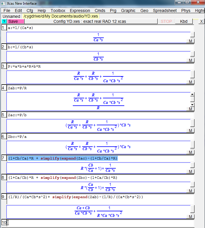

started on a free SW based update of the equations that could be shared - still fighting with how XCAS works
but this should give the flavor - and show the Zab element has the nonphysical FDNR Frequency Dependent Negative Resistance element - which can be considered as "explaining" the "extra" gain from splitting, bootstrapping
in the last 3 lines I resort to some hand entry to massage the symbolic results for near readibility
Exactly! I planned to keep that bit for Linear Audio, now you've spoiled the surprise😉 Luckily, I think we're alone here.😉
This is, I suspect, the explanation for why TMC can work better than TPC, despite the "mathematical" equivalence that is often expounded.
Another way to look at it is that TPC has a "lossy" shunt to earth, TMC is "lossless" in some sense.
