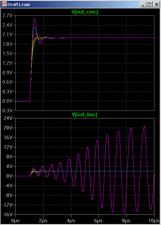

if you want to come to an understanding shared by Bob Cordell, Dave Zan as fellow authors papers on audio amp theory...
(assuming you are dismissing the rest of merely competent EEs on this site such as Syn08, megajocke, that have put up substantive analysis here or on other websites, and a larger number of others that have followed, made intelligent comments on the discussion)
try understanding these 2 pics that are sim plots comparing dominant pole Miller and TMC/OIC with the same loop stability "challenge"
stepped increasing delay added to the output stage, inside the loop(s) - the cleanest illustration/test of "phase margin" I could come up with
the responses are very different when the compensation is the only change - even though the gain probe test source is just cutting the outer global feedback loop in both plots
TMC/OIC is not "as safe" as Miller dominant pole compensation - it has to be designed to the same standards as 2-pole compensation
the links to my attempt to clarify, educate have have been pointed out to you a few times now http://www.diyaudio.com/forums/soli...-6th-edition-douglas-self-28.html#post4014173

try understanding these 2 pics that are sim plots comparing dominant pole Miller and TMC/OIC with the same loop stability "challenge" stepped increasing delay added to the output stage, inside the loop(s) - the cleanest illustration/test of "phase margin" I could come up with. The responses are very different when the compensation is the only change - even though the gain probe test source is just cutting the outer global feedback loop in both plots
I think I see what you mean- the added delay with OIC causes peaking in the gain plot, (I assume that is the straight line in the upper plot) which makes sense. However it does not look anything like the gain peaking you get with two-pole compen, in which the gain continues flat to a much higher frequency, does a little peak and then falls at 12 dB/octave. (See p343 of APAD6)
Many thanks for posting that example.
