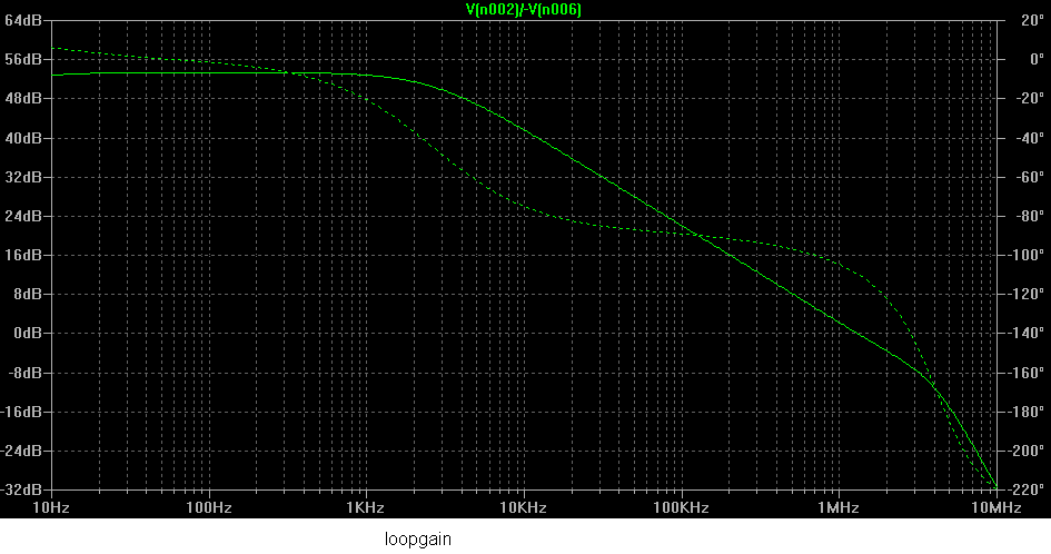

How about this loopgain plot (stable enough, in a real world).
Pavel, I suppose you used ltspice. Please try this:
Place another voltage source between out and the feedback network, - to out and + to feedback. Label the nets 'out' and 'fb', respectively. Set the voltage to 0 and AC to 1. Set the input voltage source to AC 0. Run the sim and plot '-V(out)/V(fb)'. Post the result here

I think you use Middlebrook method. Why do not use Tian Probe?
To measure loop gain you can use ltspice_instalation_folder\LTspiceIV\examples\Educational\loopgain.asc and ltspice_instalation_folder\LTspiceIV\examples\Educational\loopgain2.asc
ltspice_instalation_folder is folder instalation of ltspice, something like "C:\Program Files (x86)\LTC"
my reason for using the "less accurate", single test source is because Tain/dual injection is a pain due to the complicated equation involving stepped traces which makes it very difficult to move, copy, duplicate in a side-by side comparison
effectively prohibits stepping any other parameter in the sim
when the single Vsource injection conditions for adequate loop gain measurement accuracy are met it is much simpler and more flexible in application

Yes, this method is accurate enough for the VFA amp simulation, but not for the CFA amp where FB current is quite higher.
The loopgain simulation

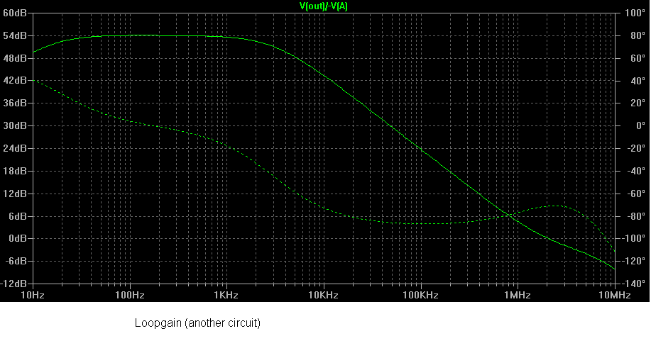

This is another circuit, by Middlebrook method. And another one.

Is it enough "accurate" to use Middlebrook method (assuming we make good layout)?
The loopgain simulation was done almost the same way that Preamp has described. For a comparison with real world, I measure open loop gain and closed loop gain and make a subtraction.
