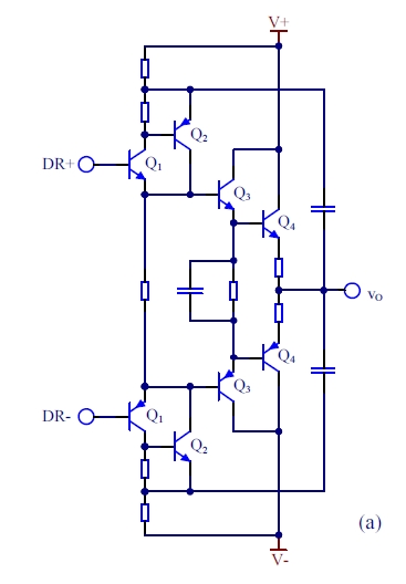

It struck me that using a CFP compound driver stage for an EF output might be a good notion, but in sim I could find no improvement in either crossover distortion or Large Signal Nonlinearity. (LSN) What circuit configuration did you have in mind?
Here's one possibility (CFP is bootstrapped).

My version had CFP drivers driving the output EFs directly. I would call your circuit CFP pre-drivers.
The 303 output was different- output triples with local NFB round all 3. (APAD6 p247) Not easy to keep stable, with modern devices, anyway.

I used CFP driver for single EF in my TGM3 - essentially a Triple but I thought at the time it would give less phase shift than a triple EF and more efficient use of power rail headroom?
Contrary to Doug I find improvement in LSN and in case one uses a setup such as Lin amps the LSN is apreciable better especially at higher frequencies.

Theory implies this should work well but when I tried it I also found no improvement at first.
The theory is pretty well based so I was quite surprised and curious.
I did some study and research to find out what factor(s) I had overlooked.
Turns out the output impedance of what drives the OPS is a major complication.
Easy to have zero in a Spice simulation but it varies in a complicated way in a real "VAS".
This also interacts with the output base stopper resistors in a non-linear way, to further complicate matters.

CFP has the potential to be excellent but it is not simple to beat an EF.

Harmon Kardon used the CFP driver followed by an EF in a few of their older amplifiers. Transistor choices are finicky, and with poor choices can lead to much more phase shift than a triple. Having the negative loop of the CFP within the global negative loop requires some more care in compensation, when I tried this arrangement it would only remain stable with a slower slave device and 10r from collector of the slave to the emitter of the pre driver.

That surprises me, I was under the impression that the CFP as a (pre)driver in class-A presented a nice linear load impedance to the VAS/TIS. Was this with the CFP in class-A?
It surprised me too, that's why it's so educational!
I think of it as the source impedance that the OPS looks back into, rather than the load impedance presented to the VAS/TIS.
The CFP was in class-A.

I suspect that the CFP stage Zo is ok up to a point and then increases rapidly with frequency as the EF OPS Zi drops off at HF and the result is a very difficult animal to stabilize. This might explain the fact that the practical results don't quite meet expectation.
