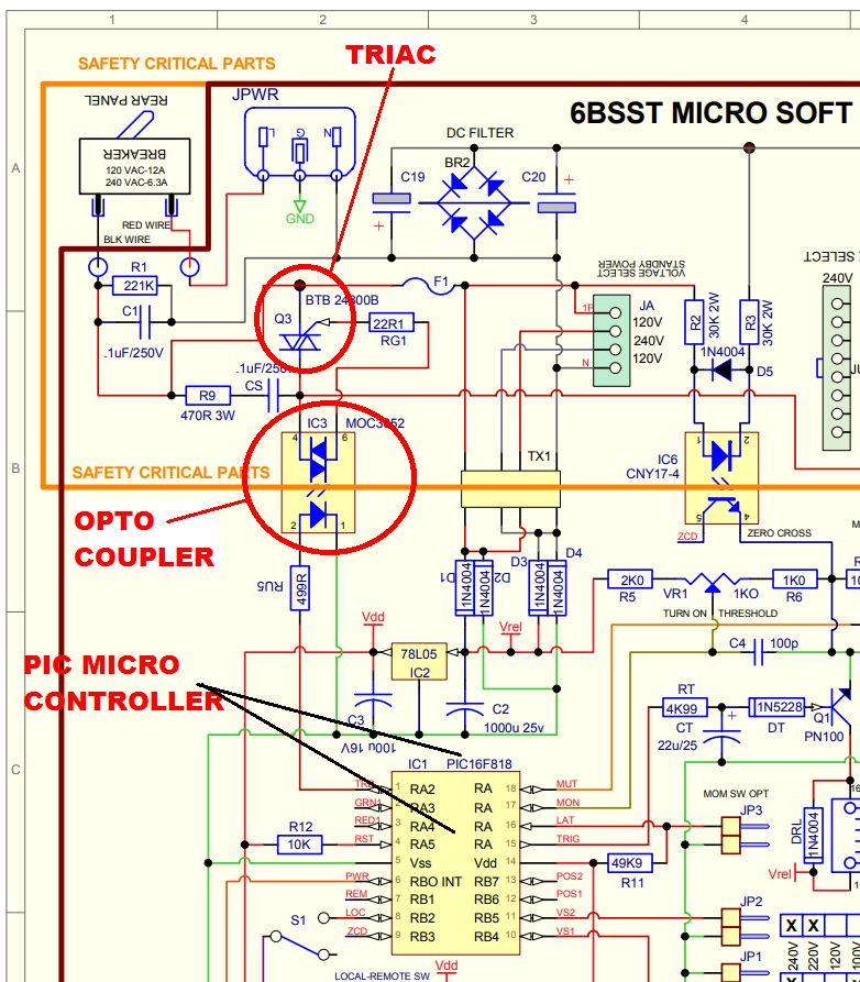

Normally used a small wall AC transformer to feed the Arduino and also use it to get the zero crossing pulses to fire the traic. You need a full rectifier to get the pulses for the neg/pos side of the AC. I fired the traic on both pos/neg of the zero crossing of the AC to get smooth voltage at the secondary. Also if you do no want to use the transformer option you can get an opto coupler to get the zero crossing pulses no matter if your input AC voltage it is 120/220 AC volts. The one you can us it is the H11AA1 it will give you a pulse in the neg/pos of the AC. It is a simple concept to eliminate inrush current. Maybe people do not see the concept that what you doing it is slowly controlling the incoming voltage from a low to high voltage feeding the primary and at the same time you controlling the secondary output voltage. It is like you use an auto transformer to vary the input voltage of a transformer. The schematic it is in the #26 of this thread. Like I said before been using this concept for almost 6 years with no problems. Also you can control the voltage ramp by triggering the triac few times at the same angle of the AC.
... Like I said before been using this concept [triac + uC for phase angle control] for almost 6 years with no problems.

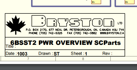

Bryston has been using it for ten years: from March 2010 to today. No reported problems that google is able to find.

For you information attached it is a timing drawing showing how I control the firing of the triac to ramp the AC as it is done when powering an amplifier ON/OFF. The triggering of the traic it is done using the zero crossing as a sync to fire the triac on. As shown in the drawing the firing of the triac start at 90 degree and it is fired in both side in the positive side and in the negative side of the sine wave and moving the firing pulses that trigger the triac toward the 45 degree of the sine wave. At 45 degree the triac it is turn on full time.This also it is done in reverse when powering the amplifier off. Also if you want to slow down the ramp them your fire the traic 3 to 6 times at the same angle. I used in my system 3 times. In other word your are slowly ramping the AC to prevent the inrush current at the same time slowly charging the capacitors in the secondary side. The more you firing the traic at the same time the slowly it is the ramp. Hoped this clarified and have an idea how using a micro and the zero crossing the ramping of the AC can easily be done. As you can see your are using the micro in the same way you are using a dimmer to control a light bulb or to control the speed of a fan. I have been using this method for almost 6 years without one single problem or break dwon.

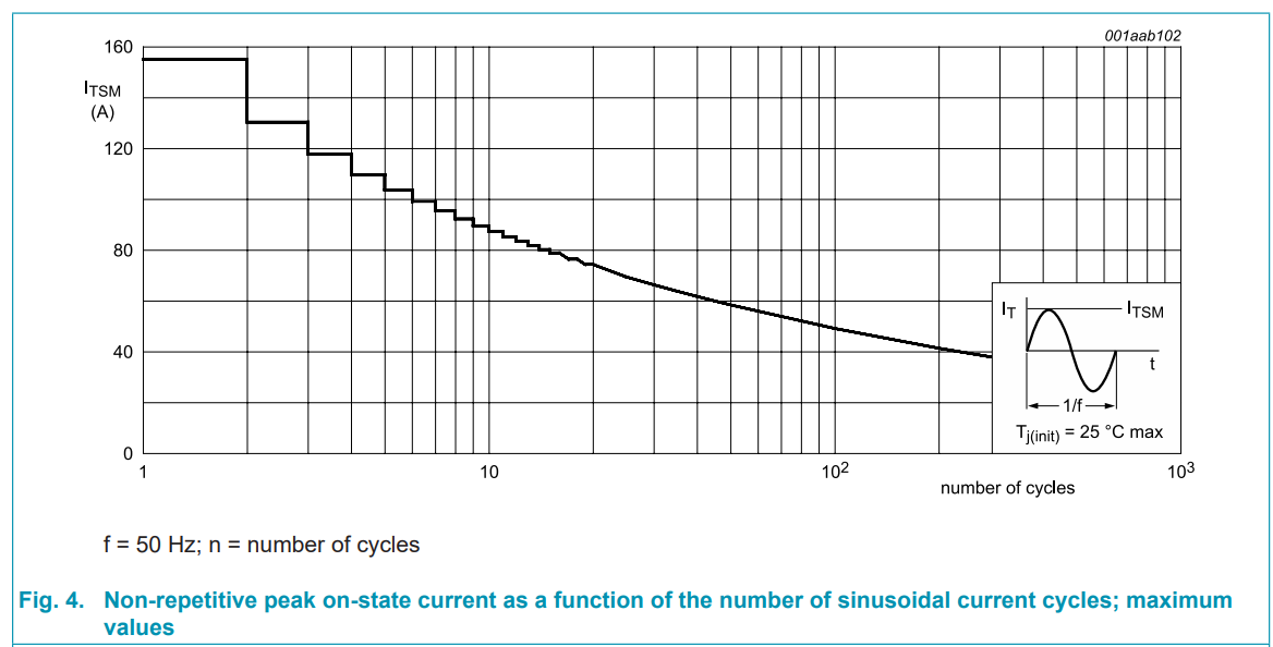

I think you'll be just fine if your triac's "IT(RMS)" datasheet specification, which is the maximum rated continuous current, is significantly higher than your transformer's max continuous primary current. In practice, this makes us very confident that the triac's "Non repetitive peak on-state current" will be waaaaaay higher than the soft start protected inrush.
  • Max continuous primary current = (transformer VA rating) / (mains RMS voltage)
So, for example, if your transformer is rated at 1000 VA and if you live where the mains voltage is 115V RMS, then
  • Max continuous primary current = 1000 / 115 = 8.7 amperes
So if you choose the $0.87 BT139 triac (datasheet), whose "IT(RMS)" specification is 16 amperes, you'll be fine, since 16 amps is much greater than 8.7 amps. The BT139's Non repetitive peak on-state current is shown in datasheet Figure 4, reproduced below. It certainly has plenty of safety margin for a soft start protected inrush.
