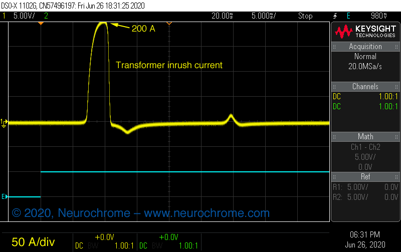

the current and voltage are 90º out of phase.
Yes, you're right, it's more like 90degrees and not 45. My mistake.
In reality though, since the transformer isn't alone and unloaded, the current profile over time would be some combination of the cap bank charging and the transformer's magnetization, so the sweet spot needs to be found for best result. It's very unlikely to be something like 90degrees...
This means that if you turn the current on at the zero crossing, you get the worst case inrush current.

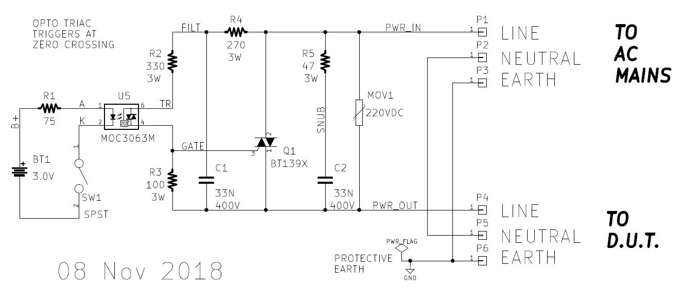

Exactly! But detecting something other than the zero crossing is really not practical, but it's quite easy with those opto-couplers, so the zero crossing detection is the obvious best choice of thing to do, but then the program needs to apply the appropriate delay after that.
For testing purposes you often want the maximum possible inrush current so you can make worst-case measurements. Certainly I did, when I built and used this inrush current tester. So I intentionally designed the circuit to turn on the triac ("Q1") right at the zero crossing ... as per "ELI the ICE man" . Click the image to see it full size

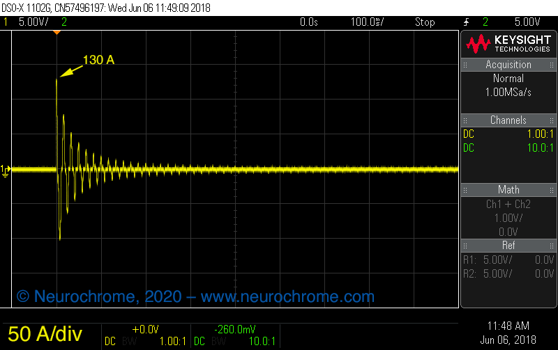

True. In measurements of the inrush current of an 1 kVA toroidal power transformer, I saw currents of 200 A peak with the transformer unloaded and 130 A peak when the transformer was loaded by a 2x45000 uF cap bank.
I've attached the plots here. You can read the rest of the story here: The Ultimate Guide to Soft Start Design – Neurochrome
I used a circuit similar to the one Mark showed above to turn the power to the transformer on at the zero crossing for the measurement of the transformer's inrush current.
Needless to say, I fully support the use of soft start circuits. Even smaller transformers draw significant inrush current. Just make sure you design the inrush limiter such that it can handle the energy of both the cap bank and the energy needed to magnetize the transformer.
