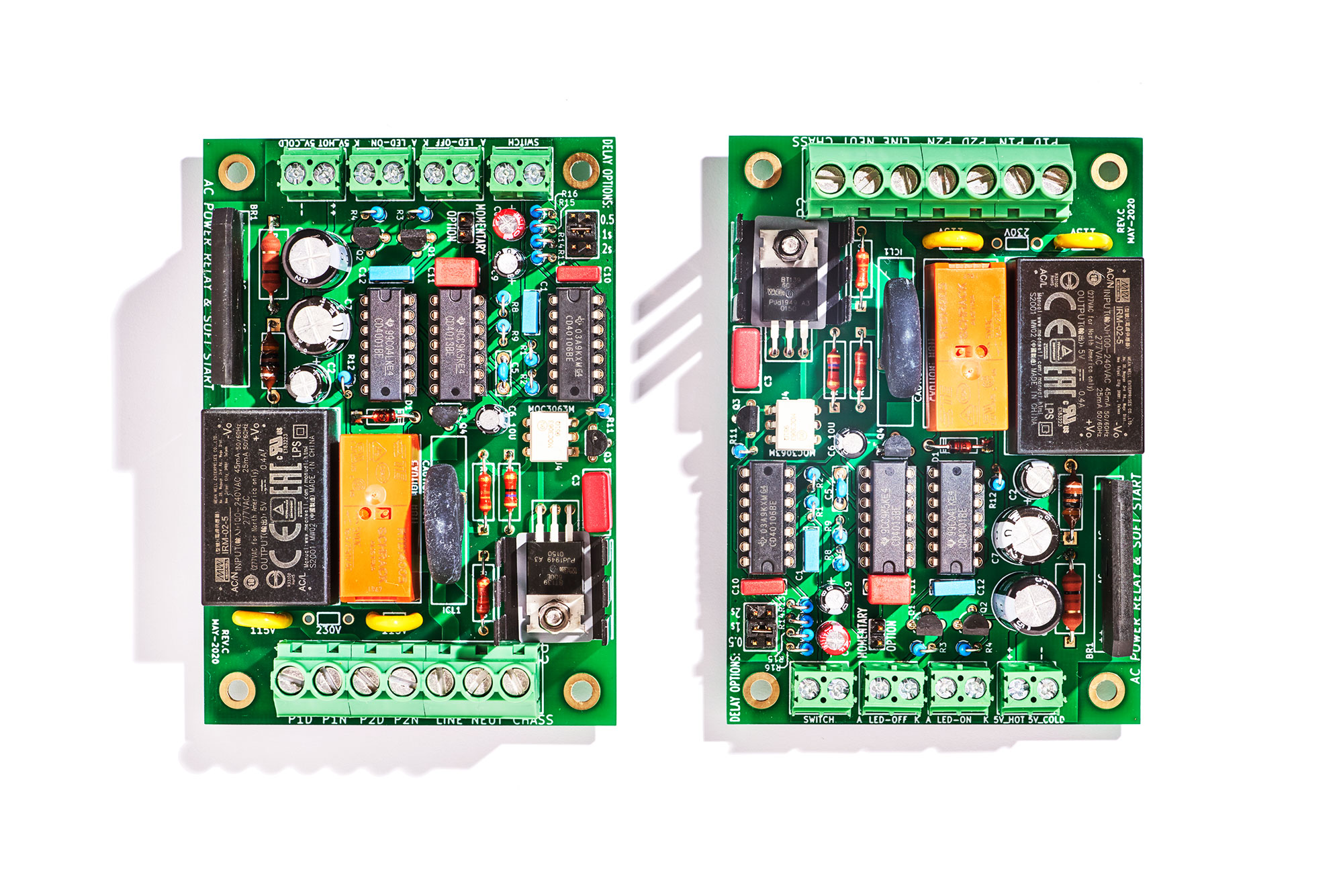

After looking at a bunch of soft start circuits I decided to design one according to my beliefs as to what is the best way to do it. It may be completely different from your beliefs but there it is.
I wanted a separate power supply for the soft start circuit so it could be used to turn the amp on and off and the powering up of the amps large transformer would not interact with the circuit. The transformer has a dual primary so it can be used for 115 and 230 VAC. There is a surge suppressor, R1, across the transformer input as well as a small high voltage capacitor to filter out RFI on the line from coming into the amp. The power supply always draws a few milliamps, it powers a multicolor LED that emits red with the amp in standby.
The on/off switch only switches 15 volts DC at very low current so you don’t need a switch that can handle large AC current in-rushes. When switched on, the DC power is sent through a regulator for consistent voltage and time of circuit operation. Relay K1, a small current relay, pulls in and turns on a triac, AC current flows through a couple thermistors in series to limit in-rush current, two 5 Ohm parts for 115 volts to limit the current to no more than 12 amps, or two 10 Ohm parts for 230 volts also limiting to 12 amps. There is a current limiting resistor, R2, at the triac gate and a RC network,R3/C2, over the triac for some protection of the triac.
The circuit uses a voltage comparator, U2, to delay turn on of a relay, K2, which bypasses the thermistors, I do not like to have a current limiter staying in the circuit or the heat they generate inside the amp. The voltage comparator has a voltage divider, R8/R9, to set the voltage at 10v as the reference voltage on the positive input. That voltage is compared to the negative input which has an adjustable resistor, R7, which limits the current charging the capacitor, C6, and the rate of charge therefore voltage ramps up quickly, a couple seconds to more than 10 seconds, for the delay. When the voltage on the negative input matches the positive input, the output is turned on. There is a diode, D4, across R7 to give a quick discharge path for C6 so the circuit can reactivate quickly, as in the case of a temporary power loss. R2 limits the current through the comparator which drives the gate of a small MOSFET through a gate resistor, R11. The MOSFET pulls current through a large relay K2 to bypass the thermistors and another small relay, K3, which changes the LED from red to blue to show status ON. There is a Zener diode, D5 and a small capacitor,C7, at the gate of the MOSFET to protect and stabilize it, probably not needed but cheap insurance.
So far, the circuit has been very reliable in a couple power amps with 2400VA and 4000VA toroid transformers with .78 farads to 1.2 farads of storage caps. In small part quantities the soft start board costs around $34 USD.
Attached is the Schematic, BOM and Gerbers. Enjoy.

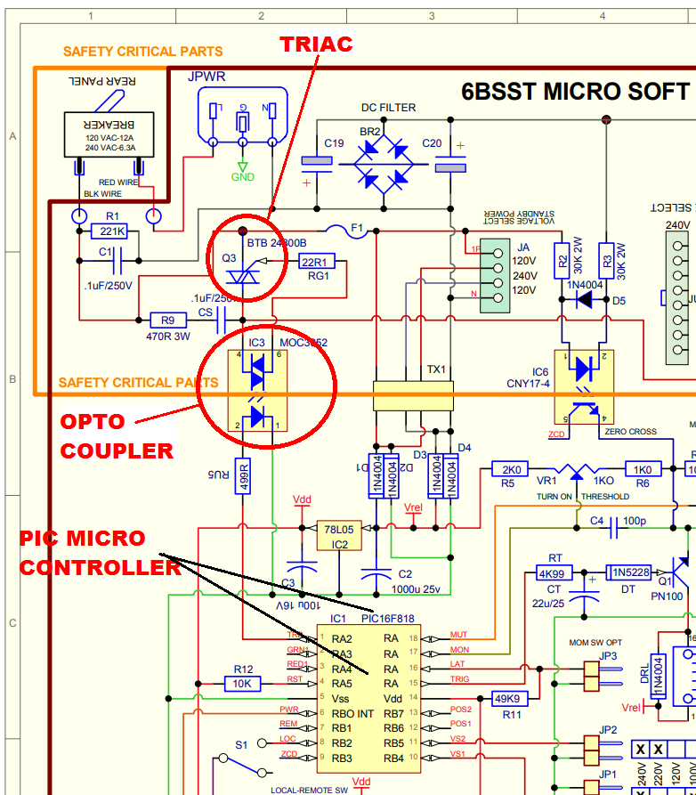

I have a doubt can anyone clarify it? In the above circuit does the Triac starts at zero crossing point by default no matter when its triggered?
With no load at all on its secondary, a transformer shouldn't start up on zero crossing.
That's pretty much when it would cause the highest level of inrush current.
I think if there was only a transformer to power up, alone, it should probably happen at about 45degrees from zero crossing, which might have just about zero inrush current.
But reality isn't always perfect, but there is a best compromise to use.
However, sine a transformer is never "alone" in a power amp PSU, the load on it comes combined with the transformer's behavior and it gets complex.
With such a complex profile, it's very unlikely that powering up on zero crossing will be best, so there should be a delay after zero crossing before doing any power up.
There must be a sweet spot, where the inrush is minimized, within reason, and still the big cap banks in the PSU get charged up...

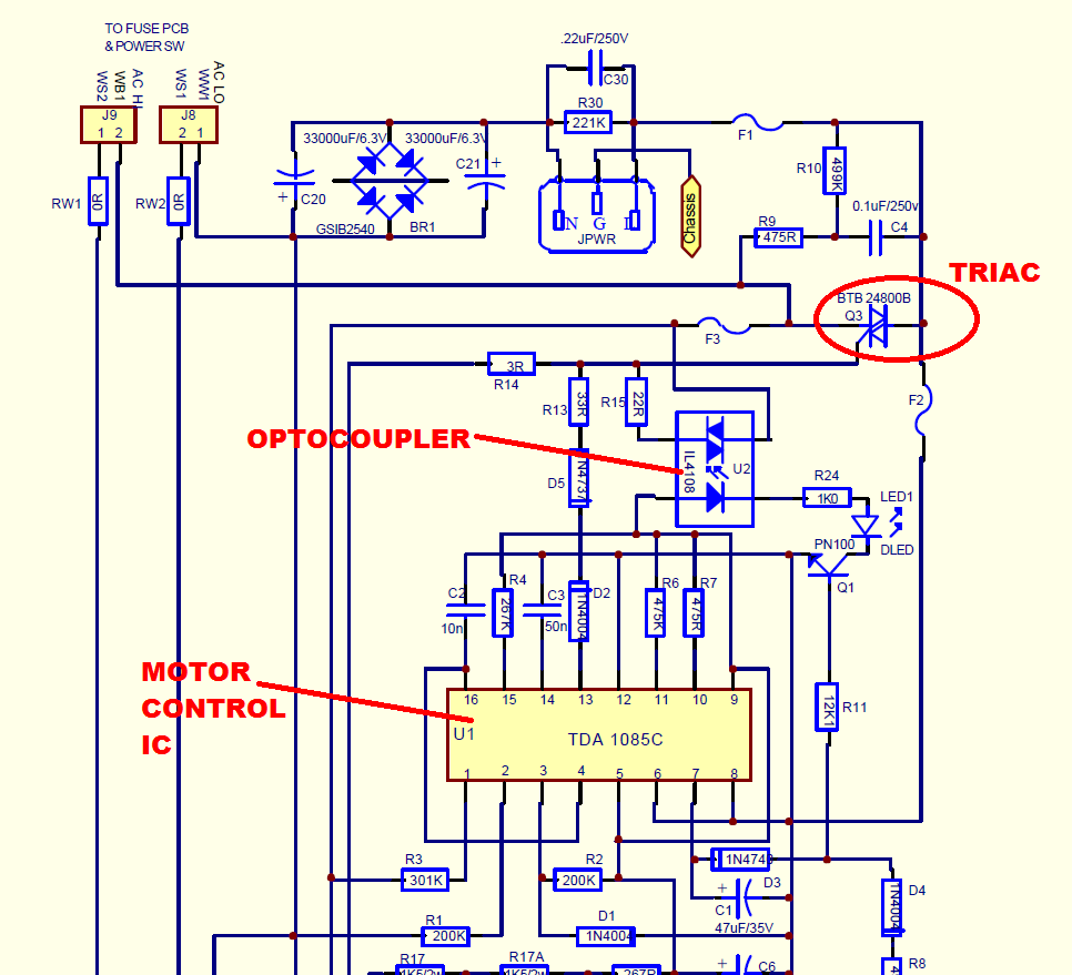

Those clever devils at Canadian high-end amplifier company Bryston, implemented soft start using a Triac and PWM. But, here's the clever piece, they piggy-backed upon the hard work done at Motorola (now ON Semiconductor), soft-starting big enormous electric motors. Yes, Bryston really did install a triac in their model 875 power amp, in series between the AC mains and the transformer primary. Yes they really did control the triac using a dedicated, special purpose motor controller IC called TDA1085C.
Bryston schematic attached below.

This is old stuff already. They continued since and pretty much all their power amps have something like this, improved.
And they put DC blockers and ground lifters as well.
This is basically what I'd like to do as well. In addition to other things, using the same PIC, like DC sensing, short sensing on the speaker line, over-current sensing, etc...
To answer whether a triac starts when a gate signal is present or does it start at the next zero crossing, from what I have read it starts at the moment the gate voltage is applied. The zero crossing situation is a red herring for a soft start, no matter where the sine wave is when you start, with discharged caps it will still have a large in-rush current. You need something to slow it down whether you PWM the gate of the triac or use NTC varistors, or some other method.
optocoupler like MOC3049 fires right just above the zero crossing the wave. Hence the inrush will be minimal. I think that can be a better move than complex programmed PIC. Well I dont deny using PIC or any controller but the application is just to start hence even when used with pulse triggering the Triac there will be considerable amount of noise getting modulated isnt it?
Triggering the Triac right at the zero crossing is unlikely to minimize inrush current, as it's not at zero crossing that the current is low. For a transformer alone it would be more like some 45degrees "after" zero crossing.
Now the transformer being loaded with something having a very different behavior (cap banks), the combined behavior will be different, and there is a sweet spot to find, a certain delay after zero crossing, to use before triggering the Triac, to minimize the inrush current.
Then after that, pwm will keep it going but under control. The pwm can be done in a way to give the transformer less turn on time at first, and then progressively over time to give it more and more, until it's fully on.
That is what would keep inrush current under control.
And one more thing about that opto-coupler detecting zero crossing, it can also be double used as a "loss of mains" sensor, for double duty, handled by the PIC.
Finding ex-techs from bryston is a tall order. I have no idea how I could do such a thing.
But we have a pretty good idea of what's being done. We don't know which time delay would be optimal for first turn on after zero crossing, but I suspect bryston did more than just calculate, they must've done some experimenting to fine tune that delay, which is all part of the PIC programming. Once this is known and properly applied, then it should all be running smoothly and fully controlled by program.

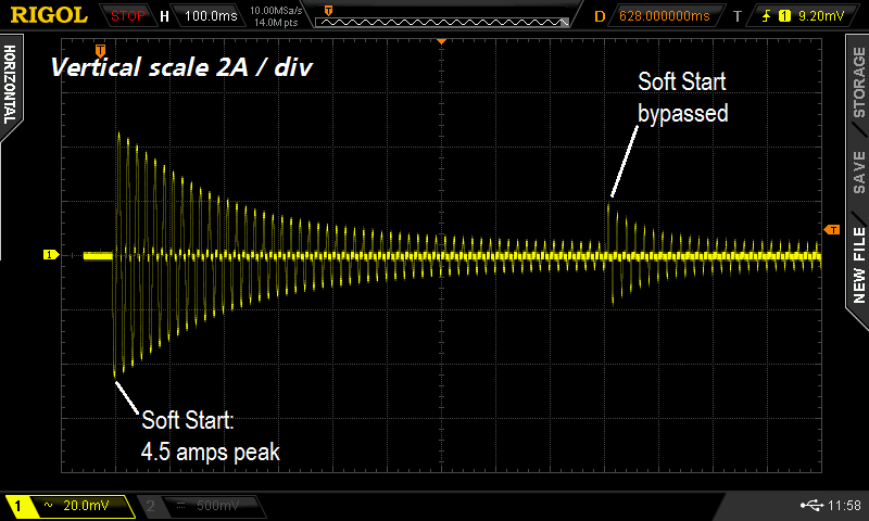

Joined 2011
When you begin to actively experiment with soft start circuits embedded within large audio power amplifiers, complete with heavy power transformers and enormous banks of electrolytic filter capacitors, I think you'll enjoy the work tremendously. The number of possible options to explore is large, with many opportunities for innovation. To name one example: soft start bypass. Bob Cordell's power amp textbook discusses this in section 19.8, and Douglas Self's power amp book discusses it in Chapter 26. Pictured below is an experiment performed using US mains (115 VAC) and a 125 Joule Inrush Current Limiter device (P/N SL22-20007). The bypass event is clearly visible!

Mark what happens when you try to turn on at zero crossing point. Do you have a graph for that?
A graph would be great to have. But this is highly likely to be different pretty much every time for every situation, with different cap banks, etc...
But if it was the transformer alone, with nothing to load it, it would be about 100% inductive and the core magnetization profile, which would mean turning on at zero crossing would be at the worst time, with maximum current.
Having cap banks at the other end though, changes things quite a bit, so the actual profile would be quite different from a simple transformer's.
A typical graph would still be nice to have to get a rough picture of how it works.
Yeah. The transformer presents an inductive load at inrush when its magnetizing inductance needs to charge. In an inductor, the current is the integral of the applied voltage, so the current and voltage are 90º out of phase. This means that if you turn the current on at the zero crossing, you get the worst case inrush current.
