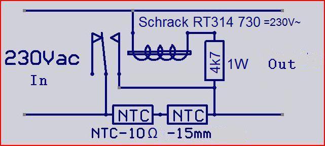

Two things here do you see the filament glowing bright for a short duration once you turn on the tube amp?
If so its called as filament flash what you need to do is to add a series resistance for the filament for about 15secs just to warm up and then trigger a relay after that.
Considering Primary V is 230VAC Coming to the total VA is 150VA which is quite low and you still need an inrush even for 150Va nothing wrong to have one.
You need to have a NTC in primary with about take 40ohm Joules will be min 10Joules capable if you have more cap take 20 or even 40J of NTC in primary.
Now why 40ohm is that as per primary voltage DC/ 40ohm will give 8.1Amp as max inrush which happens in primary. The main challenge for you is to identify the Energy in Joules that you need the NTC for.
Now if you want to increase NTC cold resistance value you can still do to 60ohm but usually 40ohms falls under the CE standards of max permitted inrush so they should be fine.
Now check your ckt with NTC in series and check if any of the classic bulbs dims badly after putting such NTC in series if its blinking without much dimming then you have got the right value.
As far as I know 40ohm NTC with 50J should be fine for your application.
Replying to your first quesite, no I don't appreciate an alteration in glowing for the filaments....It looks like there is a sort of "blocked" voltage at pass, maybe I have to check if I assembled the circuit well.
The B57236S0800M EPCOS from datasheet has a Ipk=1.6A, and based upon your indications seems to be a too much low value. Anyway I chose it because the CL60 or CL80 (frequently used in this kind of power supplies) are not easily available here.
Then I'd like to bypass that with a relay (like in the Elliot's circuits), it's OK for me also using a power resistor bank or maybe I'll try dimensioning my psu.

Actually, I know I don't really need an inrush current limiter for my amp's VA, but I'd prefer to have one since I like the idea to have a kind of soft start. I have already made the choice of the fuse based on my parameters (1A), that of the thermistor I think is to be calculated as follows:
E = 1 / 2CVp ^ 2 = 0.5 * 324 ^ 2 * 0.00022 = 12J (thus a 30J NTC for safety could be ok)
Rmin = Vp / IL = 324/4 = 81R
Imax = Pout / efficiency * Vin = 150 / (0.95 * 230) = 0.7A
So, if my calculation is correct, the choice of a 80-ohm NTC isn't far fetched. Yesterday I attached the B57236S0800M alone in the hot line: from an initial voltage of 20Vrms falling rapidly to to 7-8Vrms final. The NTC seems to be lukewarm.
PS: for johnhenryharris, if you like to post the relay circuit with comparator it would be appreciated (it would be doable with NE555 too?). Thanks
trobbins - you make good points. I limit the in-rush current to 12 amps, the NTCs are rated for 16 amps continuous, more for surge, once the initial in-rush is over the transformer and rest of the power supply draws 5 amps for the mains so even if the by-pass relay were to fail to pull in the NTCs would live fine, very warm but fine.
indaco - 80 ohms for the NTC is excessive, you want to limit the in-rush not strangle it. :) The schematic, BOM and gerbers are in the first post.

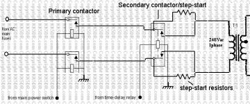

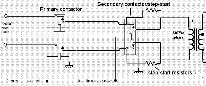

This morning I stumbled across yet one more Soft Start Circuit (link) . The unique (in my opinion) features of this one are
  • It's a completely free, open-source project with freely downloadable schematics, Gerbers, BOM, and software. Hosted by PCBWay.
  • microcontroller based
  • includes two relays with 30 amp contacts (!), one for on/off and the other for soft-start bypass
  • inrush current limiter device is a 20 watt, 27 ohm power resistor; no mention of different resistor values for 115VAC versus 230VAC
  • the temperature of the resistor is continuously measured by firmware, using a bead thermistor in contact with the power resistor. If the temperature of the power resistor crosses above a "too hot" threshold, the microcontroller declares "FAULT!!" and opens both relays, thus cutting off all AC power to the load
  • quite a few voltage isolator slots, cut in the PCB
Disclaimer: I have no data and no opinion about whether this is a "good" or "bad" or "dangerous" or "safe" or "economically reasonable" design. You'll have to make those decisions yourself. I'm just pointing out that this project exists, and might be of interest to some readers.

For a transformer up to a few hundred watts a thermistor is a good, simple choice. But at higher powers you run out of suitable choices and are forced to use resistors.
In that case, your best choice is a wire or, even better, band wound GLAZED type with a short, thick and heavy body because those offer the high heat capacity needed to cope with a short time pulse of high power. If you use one of those metal cased they need to be rated many times higher than a glazed ceramic one because they have almost no heat capacity. A thick heavy body ceramic can take up to 10 times the short time power compared to a metal cased of the same power rating.
So, from the safety side of things, if the relay that bypasses the resistors doesn't then the resistor wattage has to be so over sized to handle the heat they can be expensive. Also is the resistors stay in the input line path they restrict the current to the transformer. The Thermistors decrease in resistance as they warm up so if the relay doesn't bypass them there is no harm to the circuit and sound, other than a bit more heat inside the amp. The thermsistors must be sized for continuous duty as a safety factor. I took all that into account in my design.
Joined 2011
... if the relay that bypasses the resistors doesn't then the resistor wattage has to be so over sized to handle the heat
Or, some kind of fault detection can sense failure-to-bypass and take corrective action. The PCBWAY open hardware design linked in #171 uses a temperature sensor to detect excessive resistor heating and shuts everything off. Other circuits simply place a thermal fuse in contact with the resistor, which again shuts everything off if a fault occurs. A cute implementation uses two power resistors in series, placed side by side with the thermal fuse between them and in contact with both.
