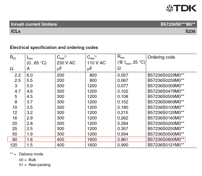

The B57236S0800M EPCOS from datasheet has a Ipk=1.6A, and based upon your indications seems to be a too much low value. Anyway I chose it because the CL60 or CL80 (frequently used in this kind of power supplies) are not easily available here.

Perhaps a little more attention to NTC datasheets is worthwhile. There is a joule limit that the NTC can pass safely - so you need to estimate that initial surge joule level. One contributor to the joule level is charging the secondary side caps. Another contributor is heating up heaters - both for 5Vac and 6.3Vac - as they conduct significantly more current initially. Another contributor is transformer primary in-rush, although that is suppressed somewhat by including the NTC for starters.
The choice of NTC may well need to cope with a long delay for any relay bypass, or even a failed relay, so the amp's operating continuous current should be somewhat below the NTC max current rating, and also somewhat above about 30% of that rating.

Actually, I know I don't really need an inrush current limiter for my amp's VA, but I'd prefer to have one since I like the idea to have a kind of soft start. I have already made the choice of the fuse based on my parameters (1A), that of the thermistor I think is to be calculated as follows:
E = 1 / 2CVp ^ 2 = 0.5 * 324 ^ 2 * 0.00022 = 12J (thus a 30J NTC for safety could be ok)
Rmin = Vp / IL = 324/4 = 81R
Imax = Pout / efficiency * Vin = 150 / (0.95 * 230) = 0.7A
So, if my calculation is correct, the choice of a 80-ohm NTC isn't far fetched. Yesterday I attached the B57236S0800M alone in the hot line: from an initial voltage of 20Vrms falling rapidly to to 7-8Vrms final. The NTC seems to be lukewarm.

trobbins - you make good points. I limit the in-rush current to 12 amps, the NTCs are rated for 16 amps continuous, more for surge, once the initial in-rush is over the transformer and rest of the power supply draws 5 amps for the mains so even if the by-pass relay were to fail to pull in the NTCs would live fine, very warm but fine.
indaco - 80 ohms for the NTC is excessive, you want to limit the in-rush not strangle it. The schematic, BOM and gerbers are in the first post.
