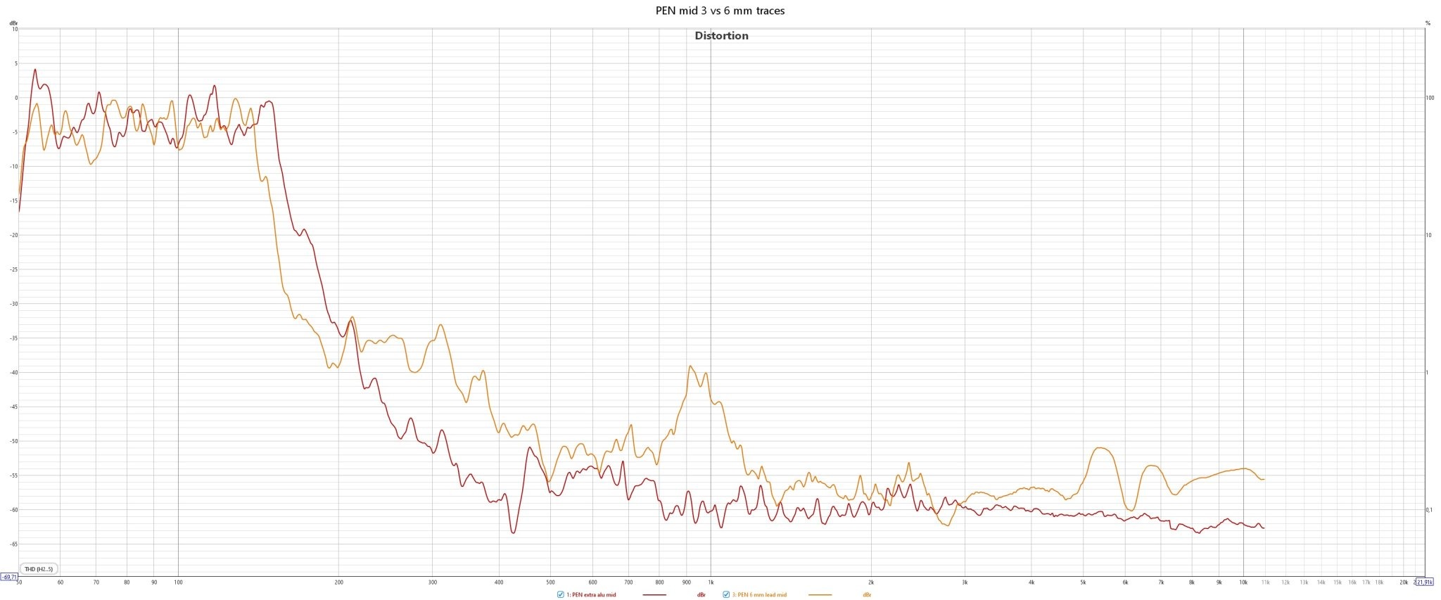

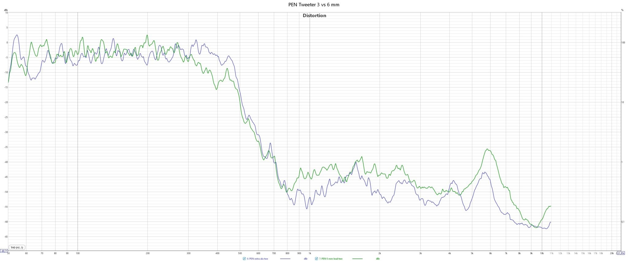

Here's some PEN membrane distortion measurements with 3 mm and 6 mm wide aluminium traces.
Quite a difference I would say.
The mid membrane with 3 mm traces (red) THD is at -60dB; goal achieved!
At THD -50dB (blue), the tweeter is almost there. There's still some bumps to sort out though.

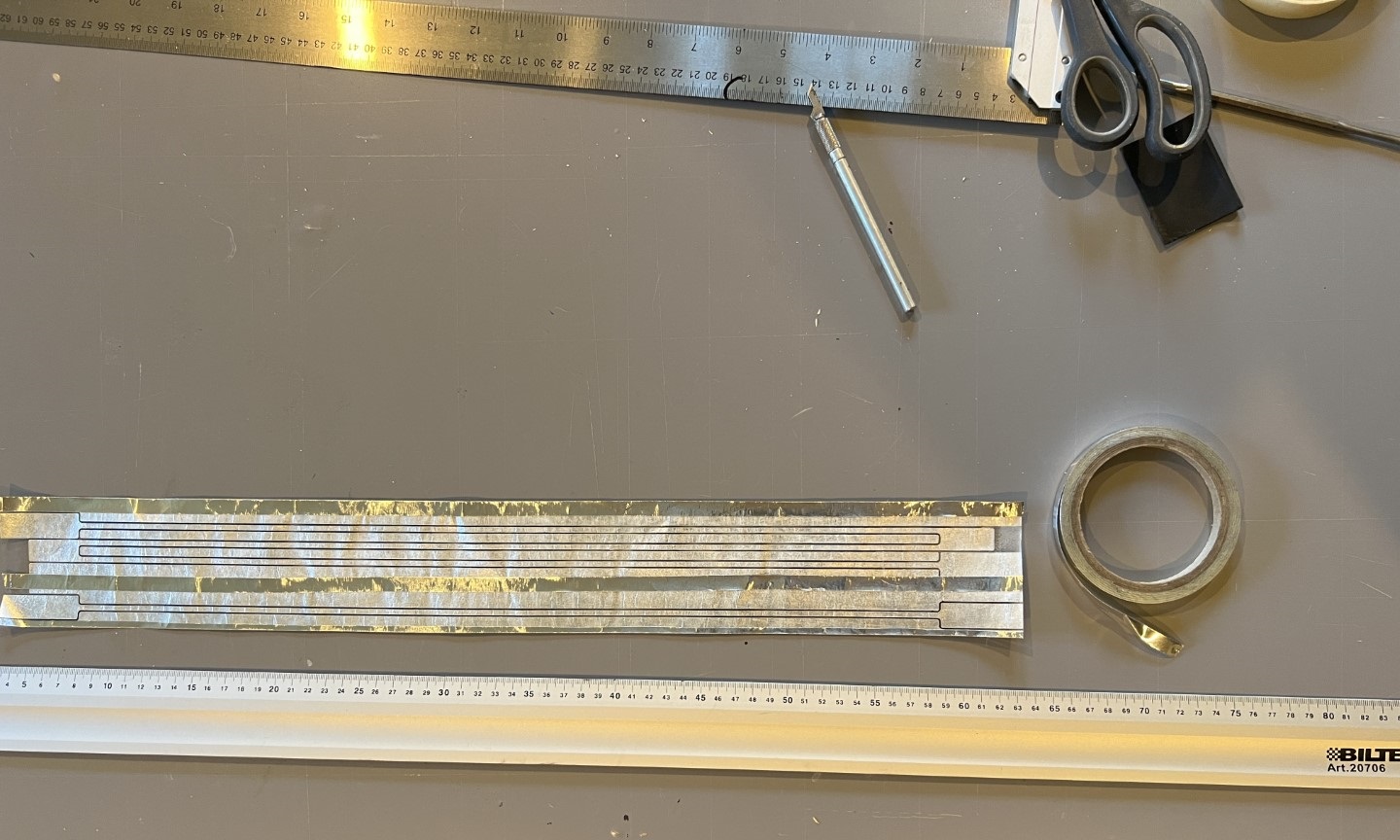

I did the the weeding a little different for these membranes; instead of weeding before applying the 3M 77 spray lim, I weeded after.
By doing so it's a lot easier to remove the backing paper afterwards. On the downside the weeding is a lot messier.

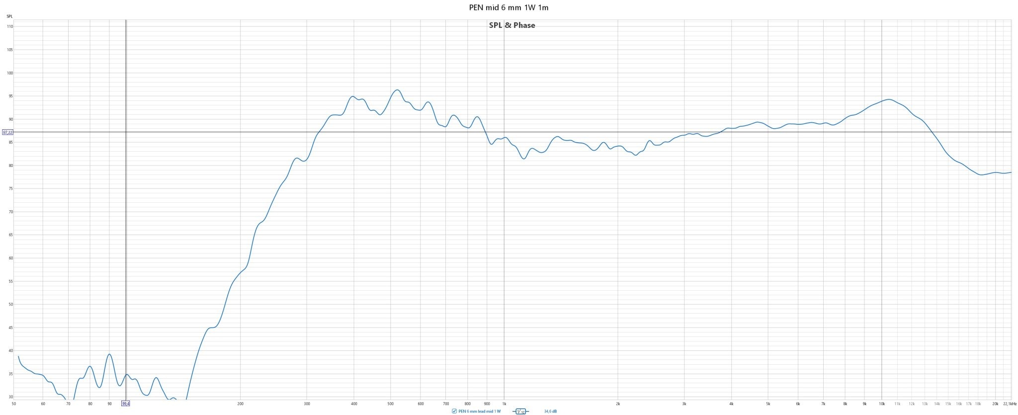

Congratulations on reaching your target goal of -60 dB THD!
Have you measured the efficiency in dB @ 1m / 1W?
And interesting that you got a distortion reduction with the 3mm wide traces. I got a distortion increase but that might be because of how heavy my membrane is compared to yours.

Thanks, OllBoll.
As I'm only measuring on a less than a fifth of the complete SMAPPP, it's hard to predict the sensitivity.
As an indication however, here's an SPL measurement on the mid membrane with 1 W at 1 m. The membrane had a 4 ohm resistor in series:
Yes, there could of course be other reasons other what you might expect.
I can make a 6 mm BOPP membrane as well, just to be sure.

I just remembered about the distortion increase in 3 vs 6 mm.
I think I had reduced distortion for the 3 mm at low levels but when I pushed it to higher levels then the distortion was higher on the 3 mm than the 6 mm wide traces.
In your -60 dB test, I assume you tested at your target SPL or close enough / 5?
I remembered another reason why you probably will have less distortion: yours will be taller and run full power along the whole length where mine is shorter and will be shaded, so I need to push mine harder. Hence I will need to test at higher power levels where you can optimize for lower and most likely end up with less distortion overall.
Then perhaps there are different reasons for the distortion.
The 3 mm trace shows lower distortion as long you are within the linear part of the gap, exceeding that and you'll get high distortion.
The 6 mm trace has higher distortion at lower levels compared to the 3 mm,
but at higher levels the 6 mm trace doesn't have to travel outside the linear partion of the gap at any comparable output.
This as the 6 mm trace is more efficient.
I think it was around 4 watts. I haven't measured the distortion at any higher wattage but I did a compression test.
Using pink periodic noise and REW's RTA, I increased the input by 3dB and the output was 3dB higher all the way up to 0 dB.
Yes, we have different use cases.

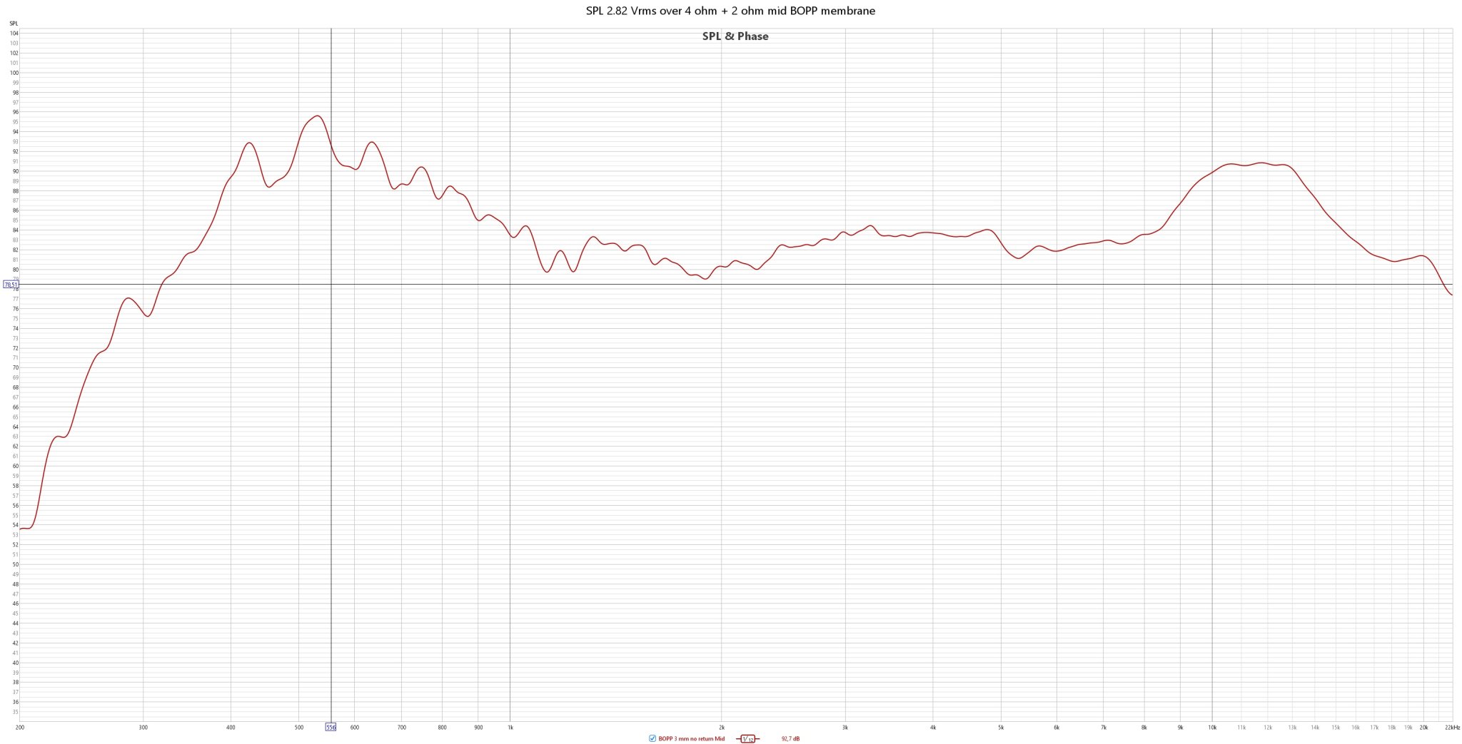

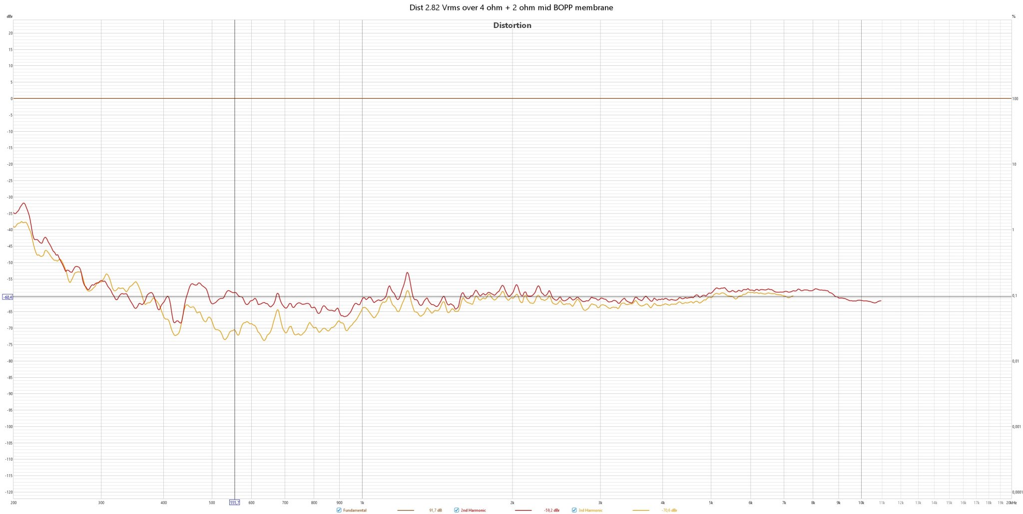

Some measurement with 20 µm BOPP, 3 mm traces. Three traces for the mid (about 2 ohm) and one for the tweeter (about 0.7 ohm).
This is how it looks before corrugation:
To keep the corrugation, the long side edges of respective membrane parts and between them has be enforced with 60 µm aluminium tape.
I have done some test with return leads in the aluminium foil, but they measured as well as having outside return leads
Both membranes has a 4 ohm resistor in series during measurements.

First the mid membrane:
Perhaps 1dB over all lower distortion compared to PEN, but it's a lot calmer at the low end!

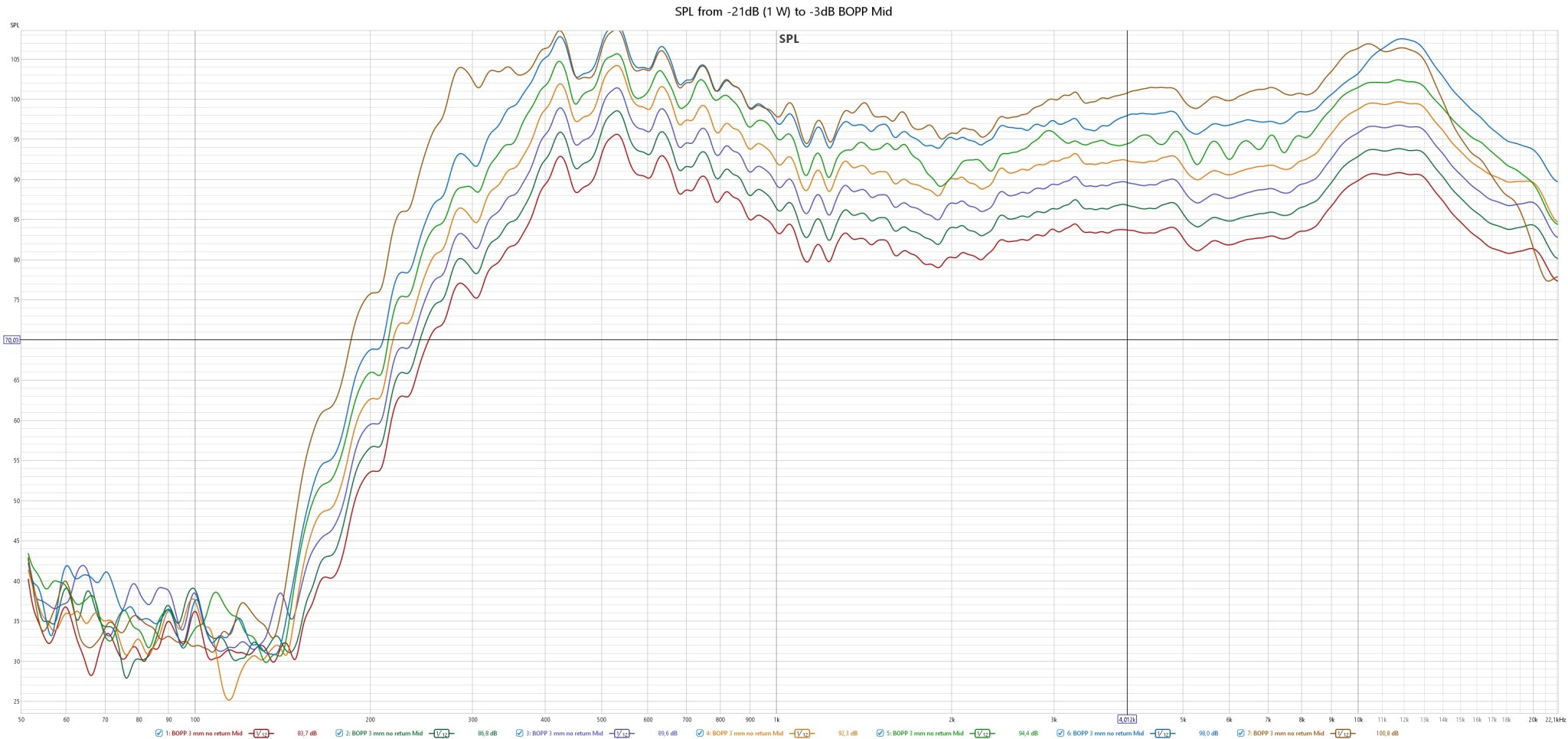

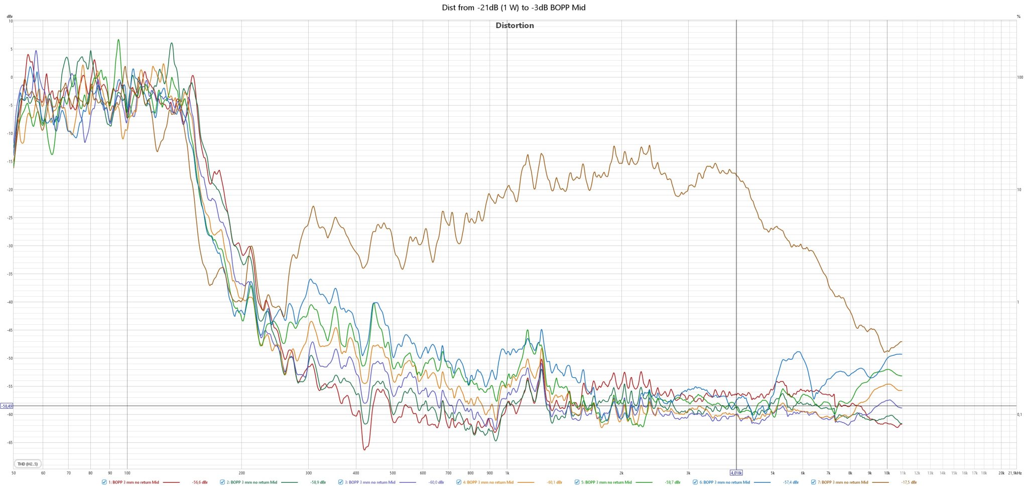

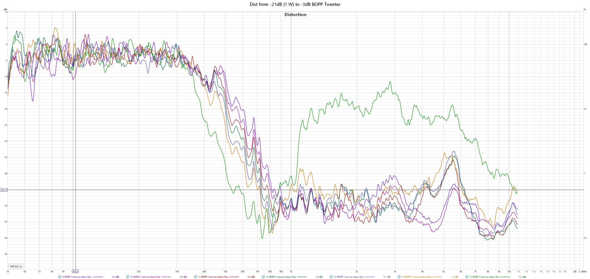

So what about compression? Here's the mid membrane again from 1W (-21dB input level) to around 50 W (-3dB input level) in 3dB steps.
At 50W, brown trace, the amplifier distorts.
As I see it, there's no compression.
Distortion rises with increased input level, until 50W that is!

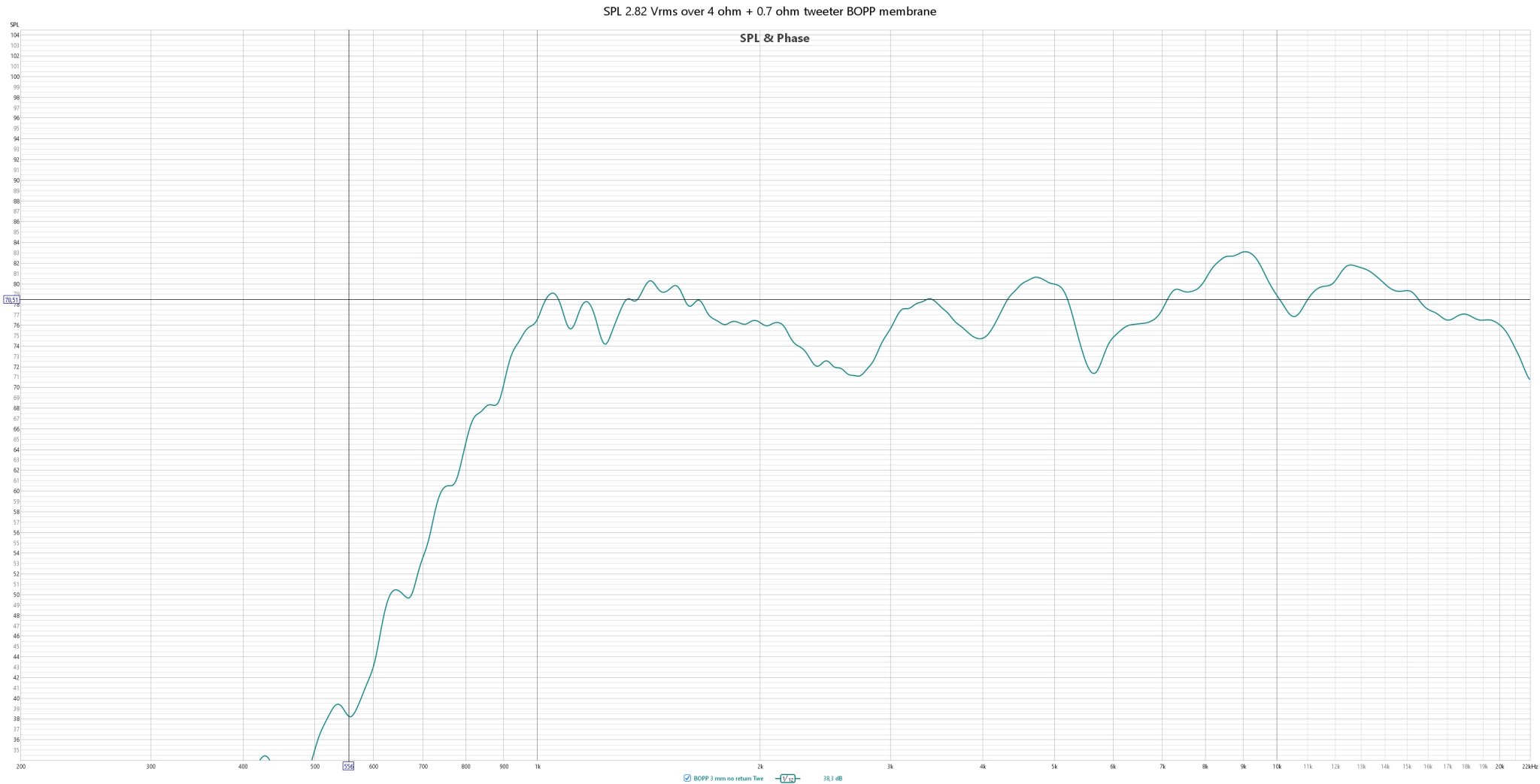

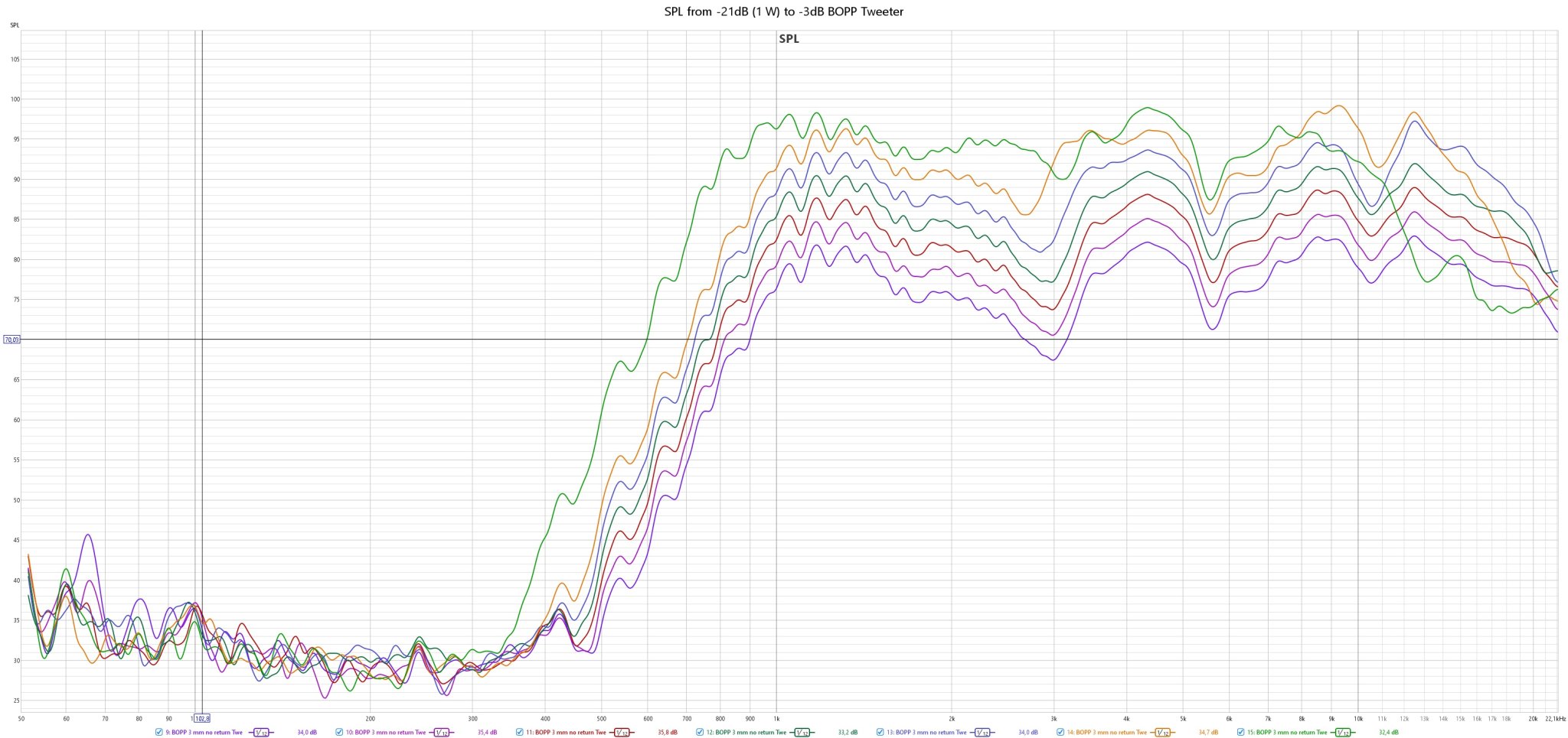

Compression for the tweeter:
Light green is the 50W trace.
I'm not so happy with the higher distortion levels between 5 and 6 kHz.

My conclusion is that BOPP is a keeper for the mid membrane, but I need to work on the tweeter membrane a little bit more.
First I need to have two separate membranes, and the tweeter membrane needs to be a lot lighter to get the a better response level.
Having only one trace, it's 5dB lower than the mid membrane if they are of the same material.
I have some very thin PET that I can test...
