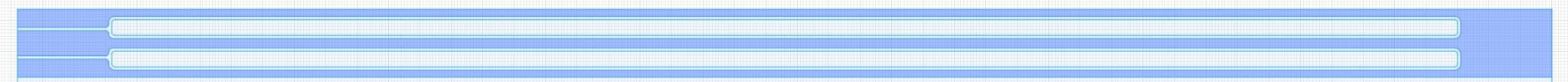

i dont know the magnet motor of these. but i guess magnets are like a planar magnetic ? not like a ribbon (magnets only on the sides) since then it would be reversed (field would be stronger near magnets on the side, hence wider foil to tame them) i always had trouble thinking about it since the first thing i would think is thinner traces is less output (since they can handle less power). but the wider traces are fed by the thinner ones. so they can never exceed the thin traces.. it feels counter intuitive 🙂 but the wider ones have the same power as the thinnest traces in the circuit. but spread over a wider area. hence lower output.The darker blue area is the conductive aluminium foil, the white areas in the middle are the non-conductive aluminium foils.
we might had the same thoughts in your drawing but t depends on the magnet motor used 🙂

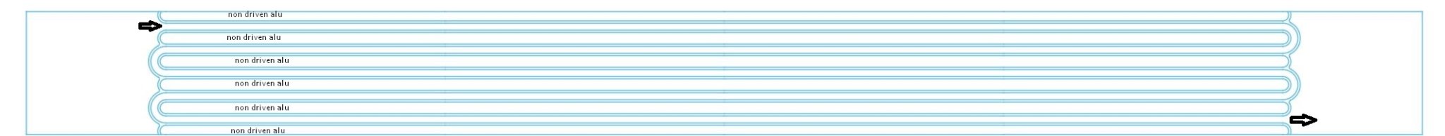

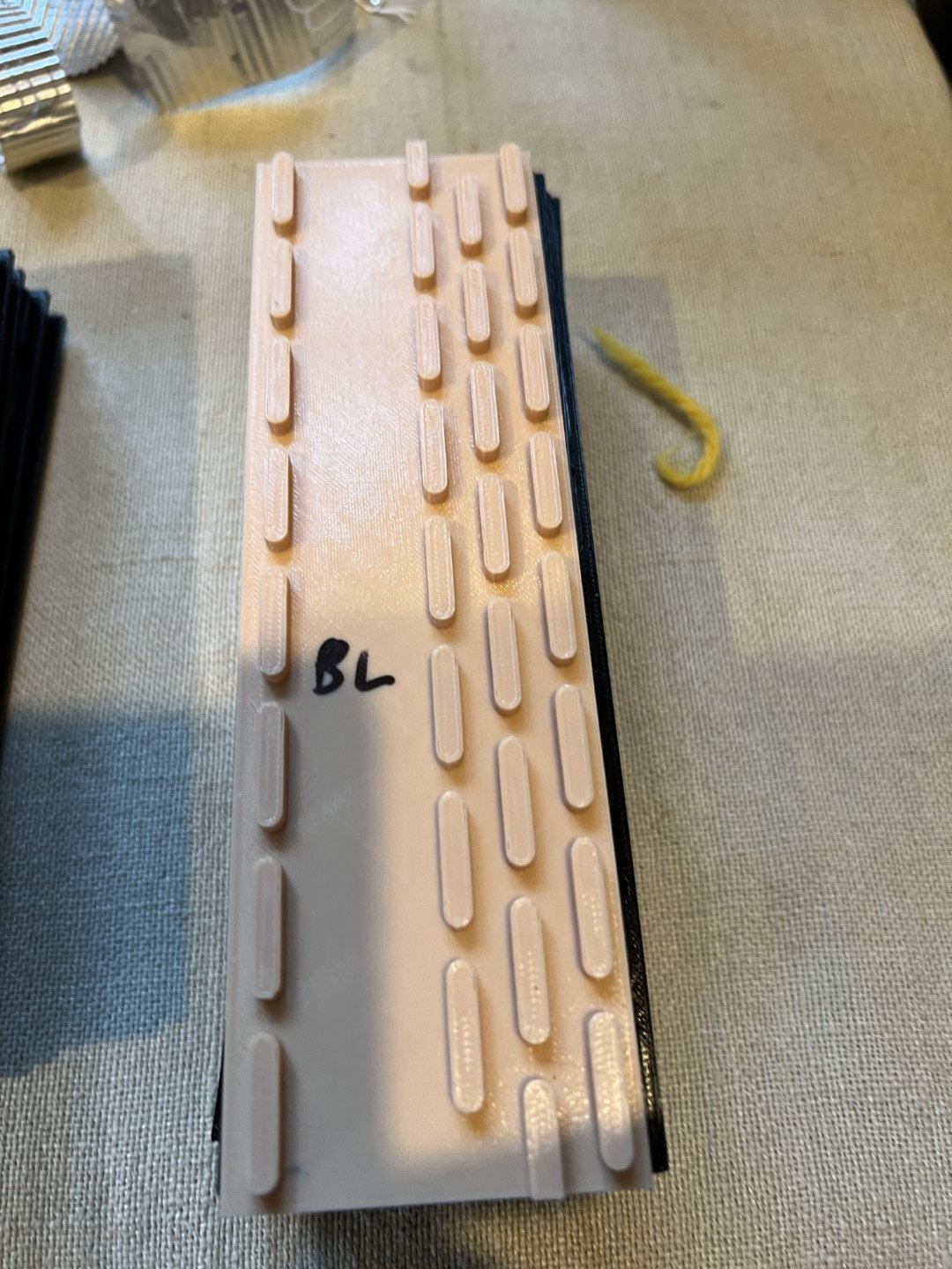

Here's a top view of the motor and other stuff:
Dark blue squares are the magnets. The conductive traces are 3 mm wide in between each magnet column.
As you can see, it is a push-pull configuration.

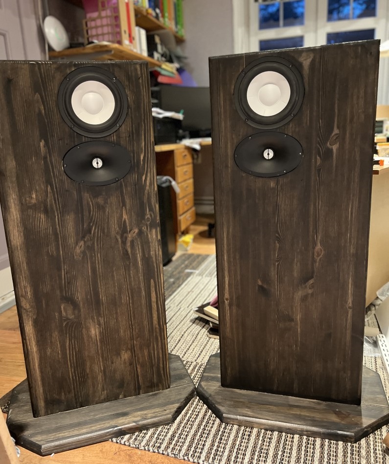

The drawing is actually one view of the SMAPPP in Fusion.
To me, low distortion levels are paramount; at the least -60dBr.
SMAPPP now has to be at par or better than:

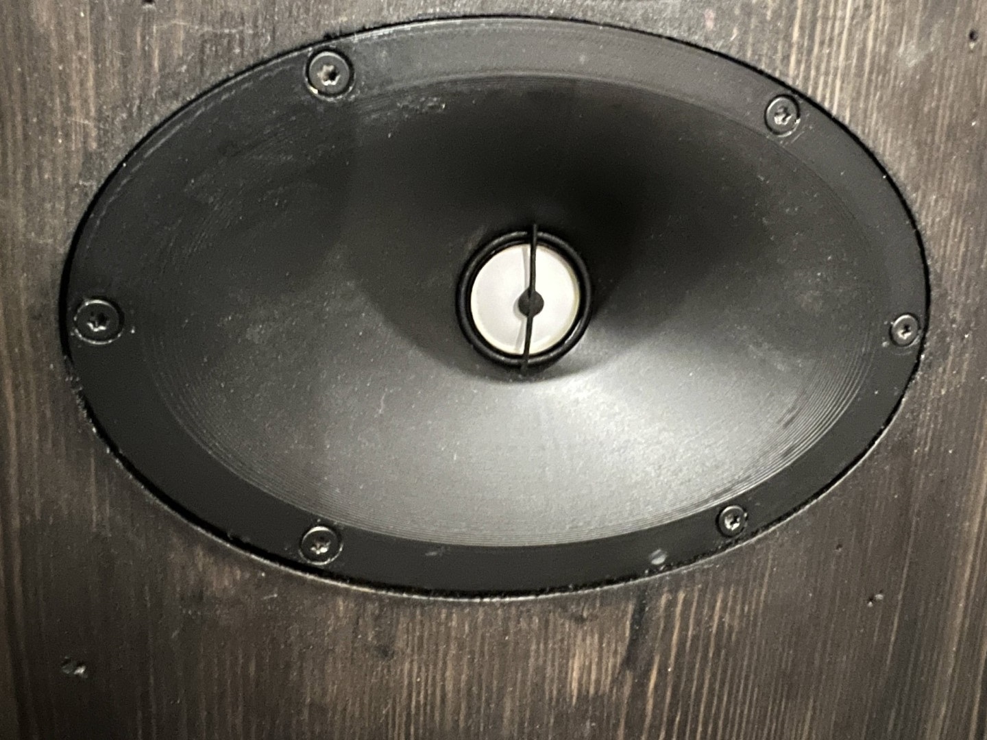

This is SOB, Solhaga's Open Baffles (Swedish site, but you can always look at the pictures.). They have SB17CAC35 as mids and SB26CDC as tweeters with one tweeter firing back.
I've printed the waveguides from Soma Sonus.
They have distortion level sub -60dB; they are now my references.

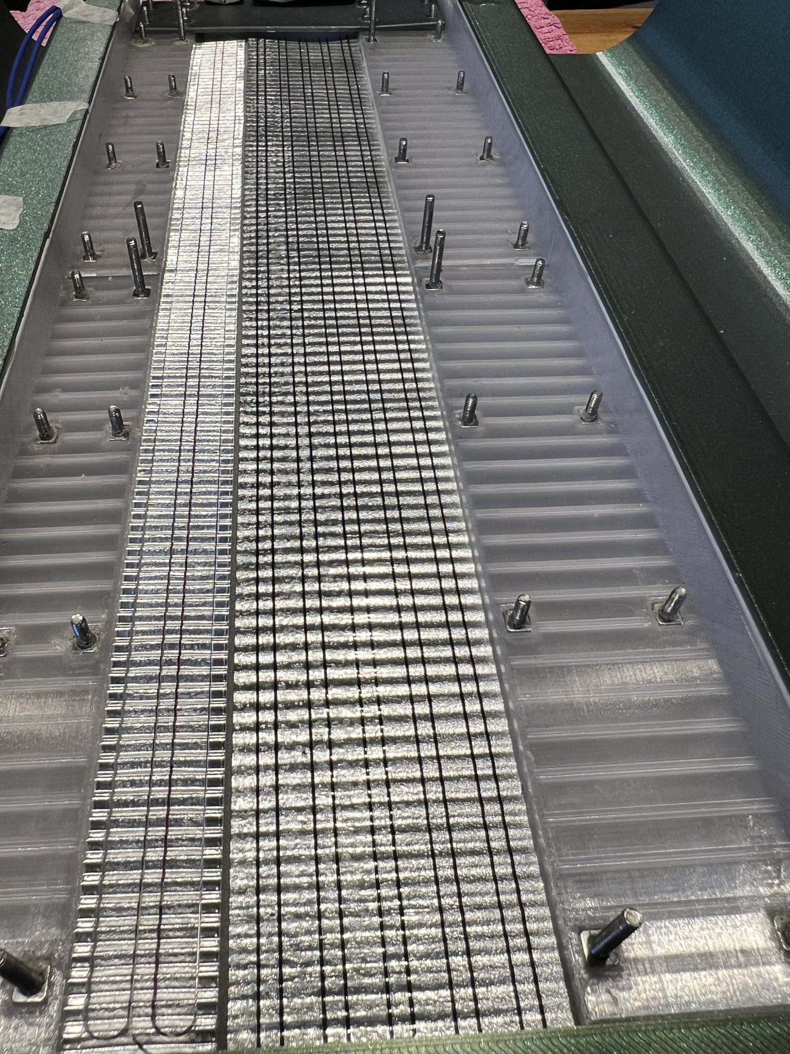

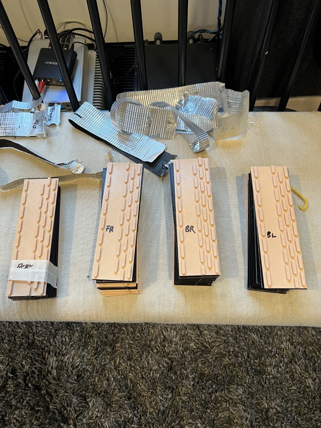

Some measurements on a 12µm PET membrane. The aluminium foil is the same; 7µm

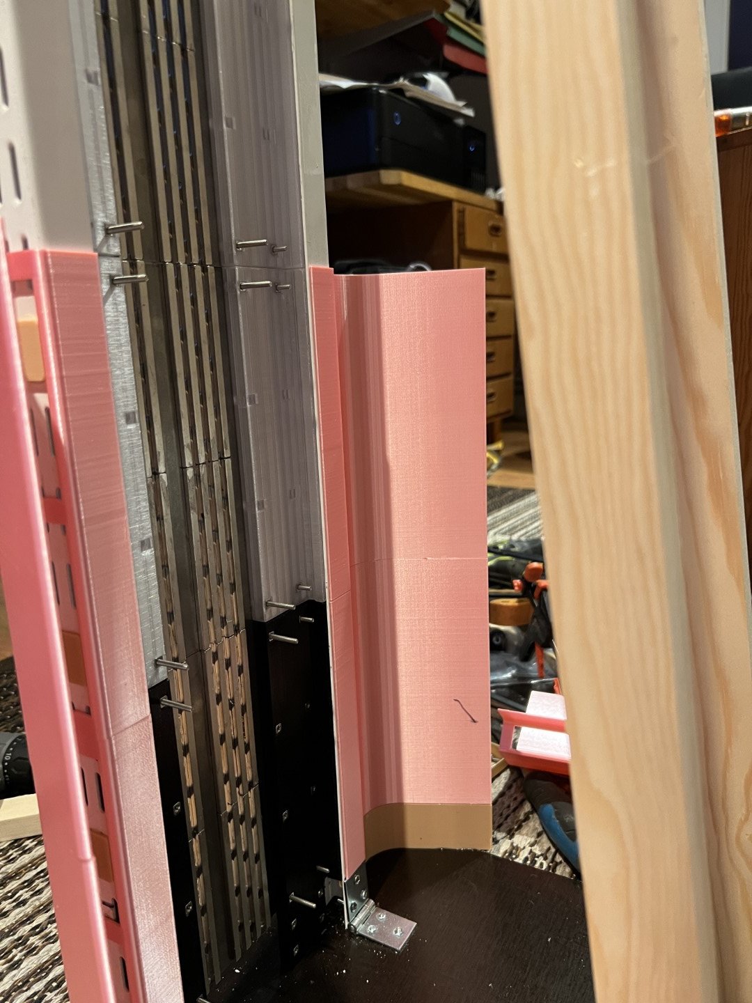

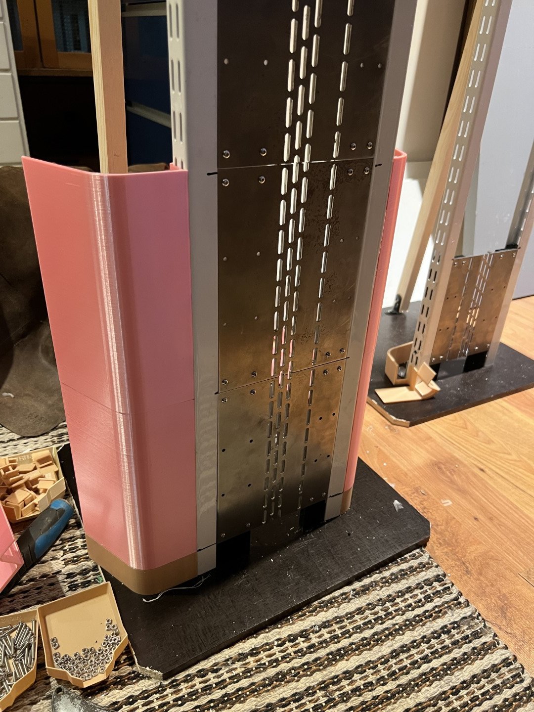

I have now seperated the mid and tweeter membrane and reinstated the conductors outside the magnet column.
They are not return leads.

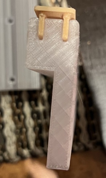

The mid membrane now has five traces and the tweeter three:
The traces have no direct coupling to any hole in the panel, but helps move the membrane as a whole.
For the tweeter, they also increase the compliance as they are in the foam surround.
I've simulated the placement of these traces and concluded that the best positions that gives the least variation of the force on the traces are where they would have been if there were more magnet columns.
External cables closes the circuits.
To keep the corrugations I've added narrow 60µm aluminium tape on the outer edges of the membranes.
I also added 60µm aluminium tape to the mid membrane's middle part. A somewhat rude measure, I must come up with something better.
I have earlier concluded that the mid membrane measure a lot better with as much non driven aluminium as possible, see non driven alu legend above,
but I have yet to compare it for the tweeter membrane.

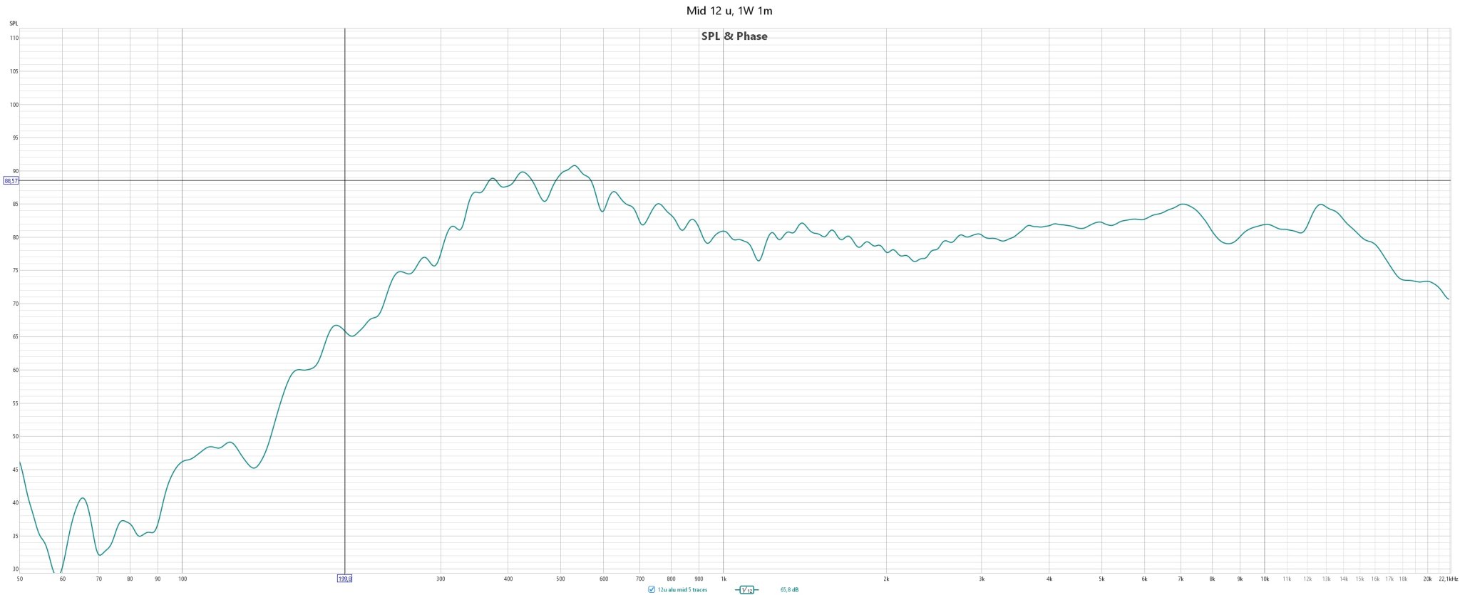

Mid SPL 1W 1m:
Distortion 1W 0,2m:
The relative high distortion between 300 and 400 Hz is probably because of the hefty middle 60µm aluminium.

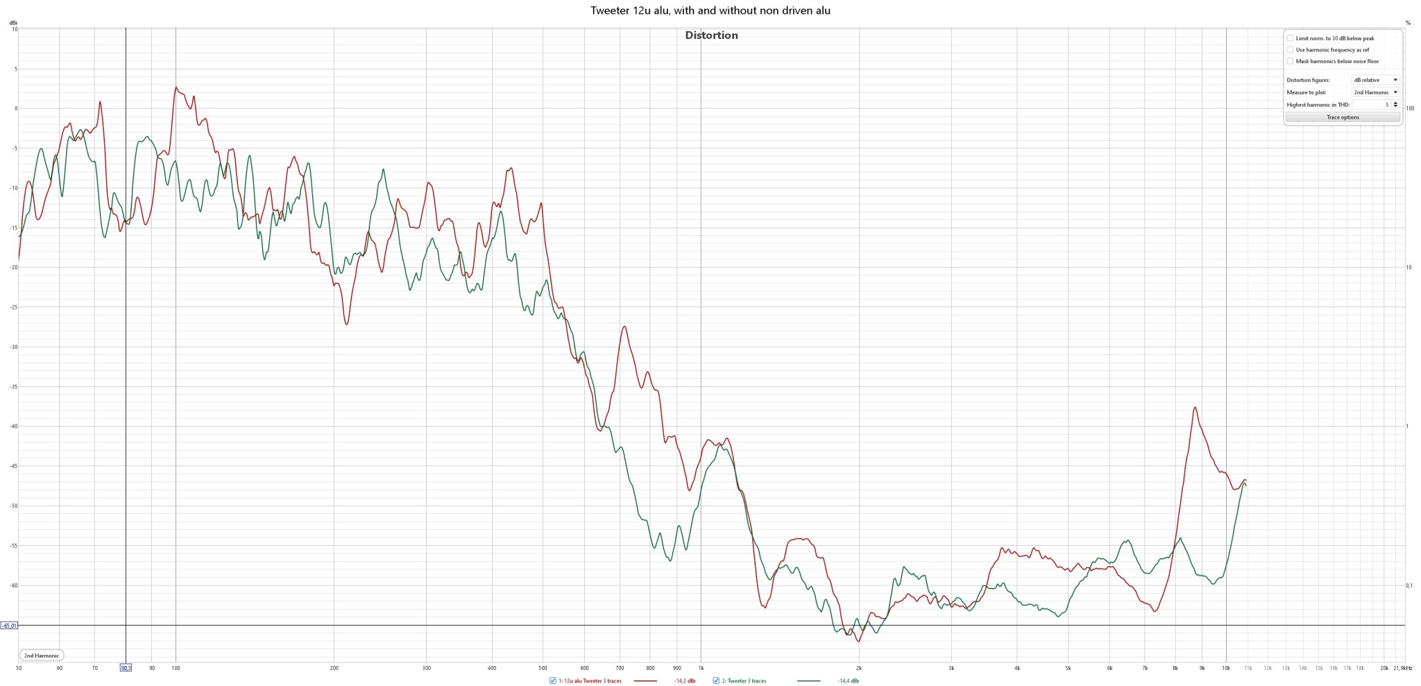

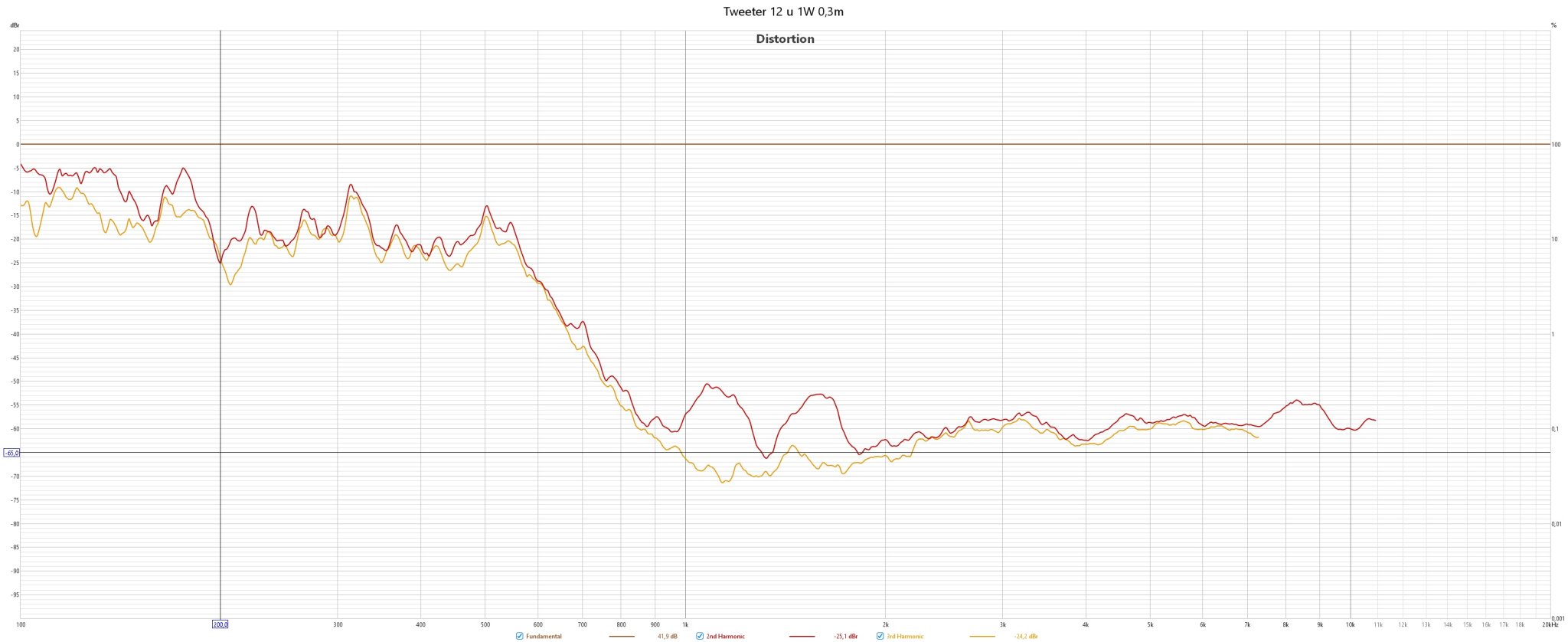

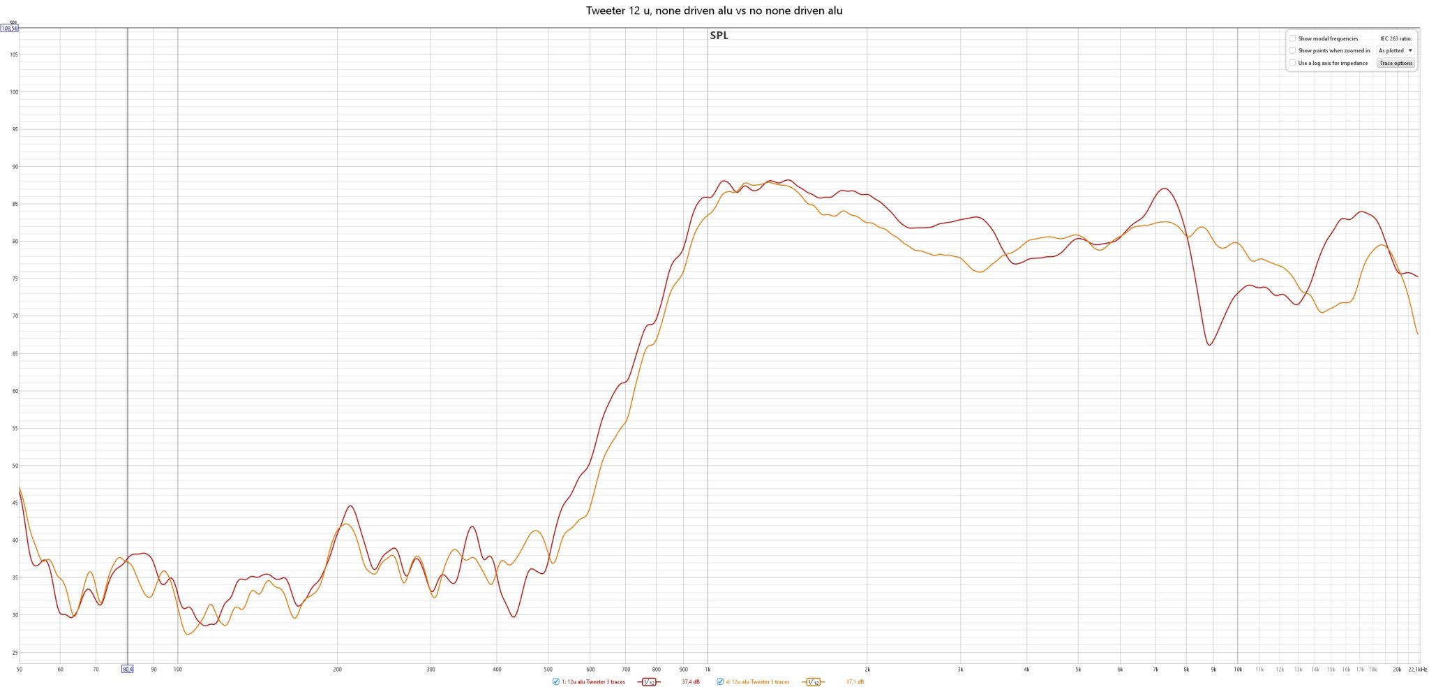

Tweeter SPL 1W 1m, without non driven alu in red:
Distortion 1W 0,3m, without non driven alu in red:
Same conclusion as for the mid membrane.
Something to improve is to have 0.5mm between the aluminium parts instead of 1mm.
2HD and 3HD or the tweeter with non driven aluminium:

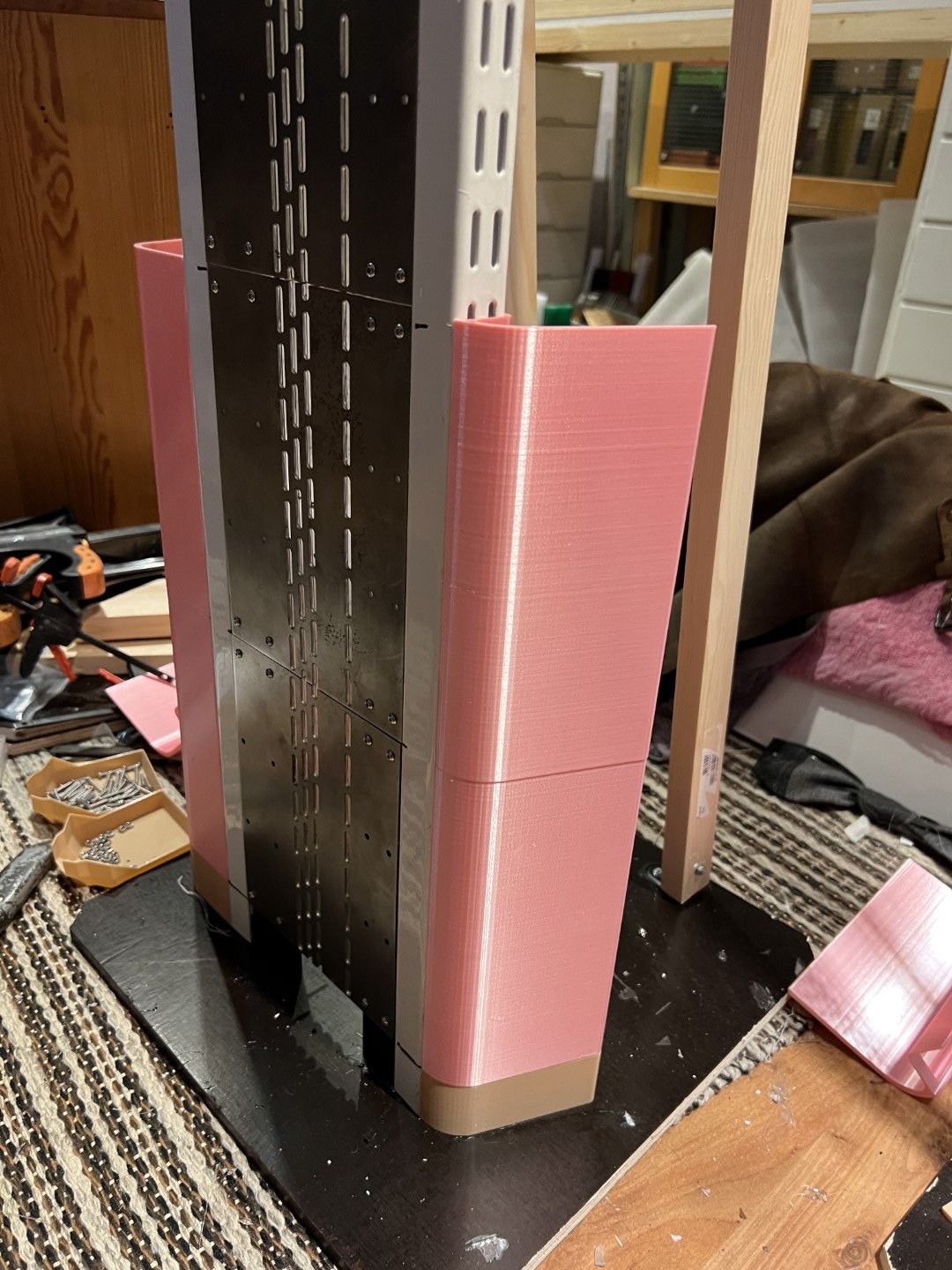

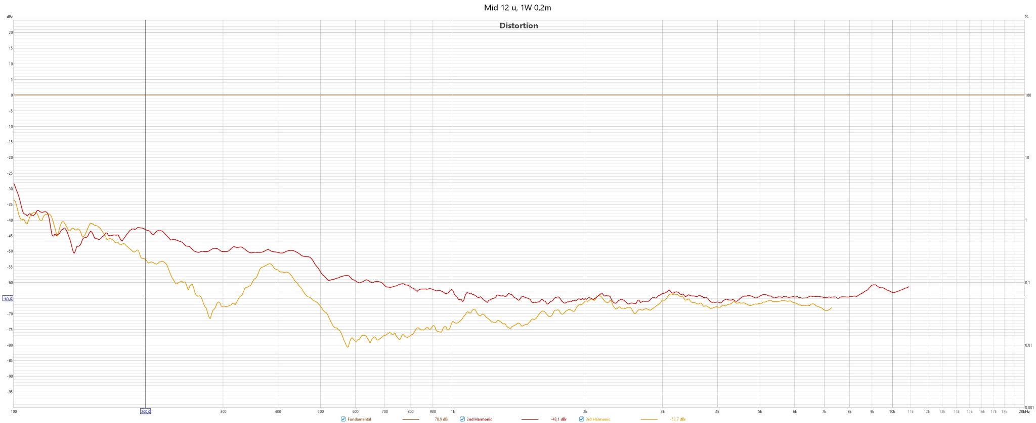

Mid SPL 1W 1m:
Distortion 1W 0,2m:

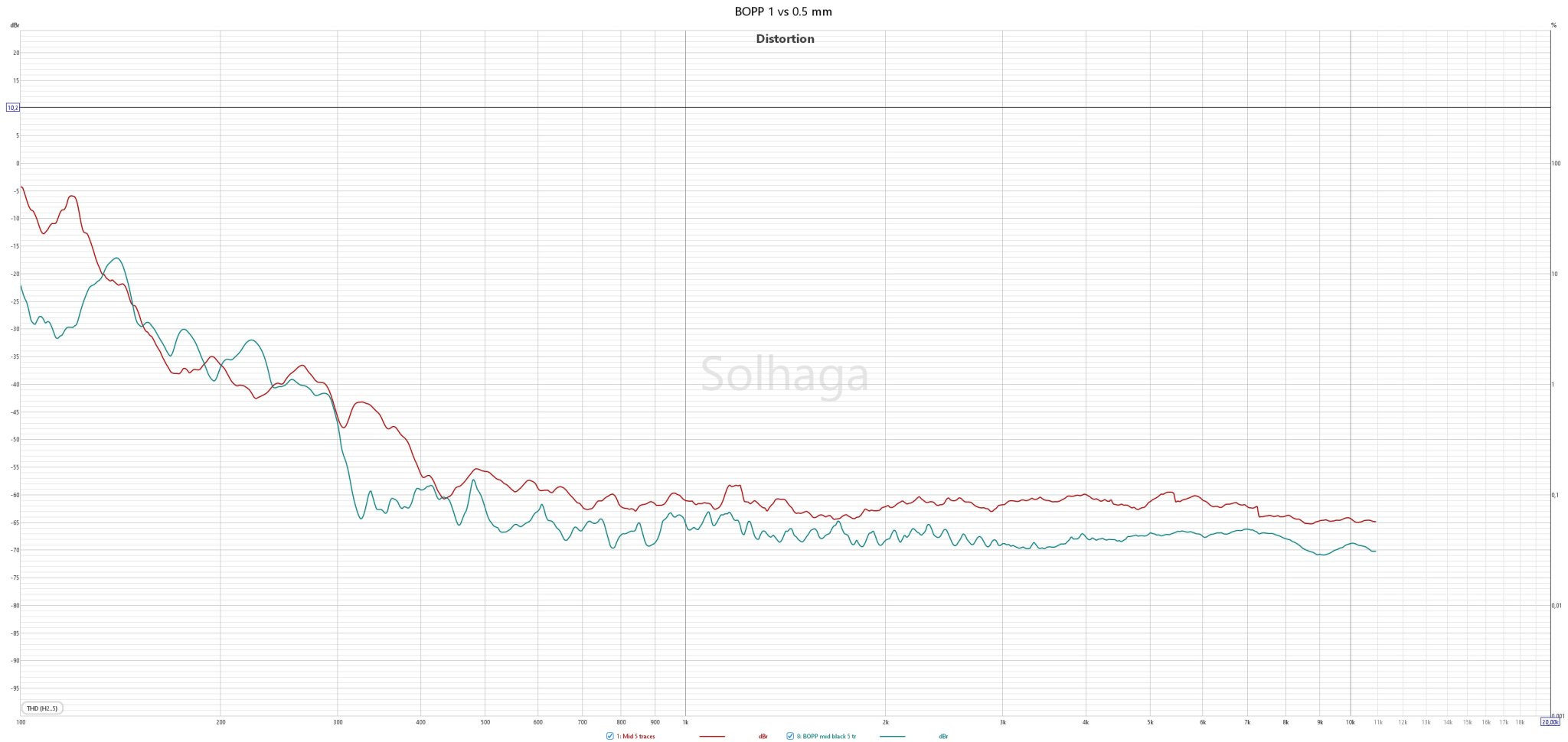

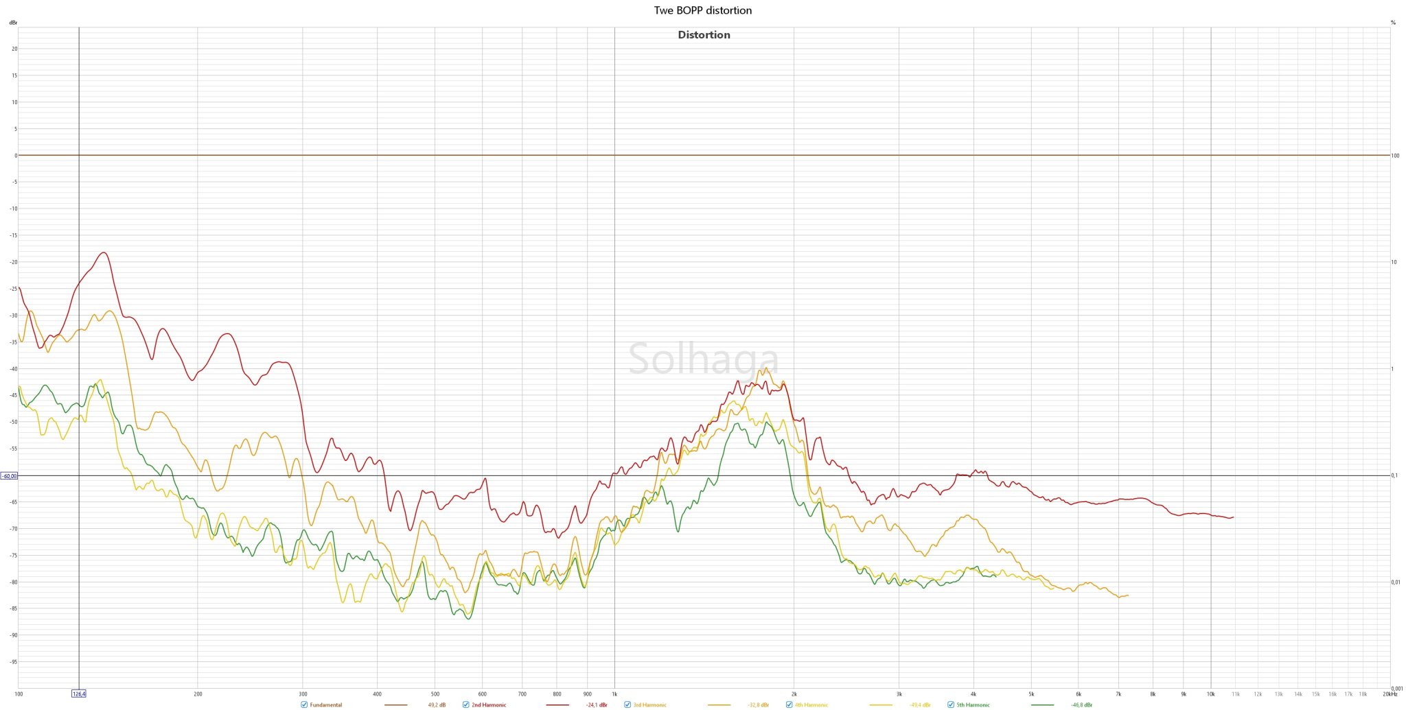

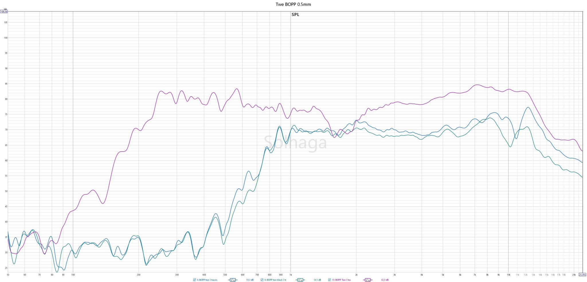

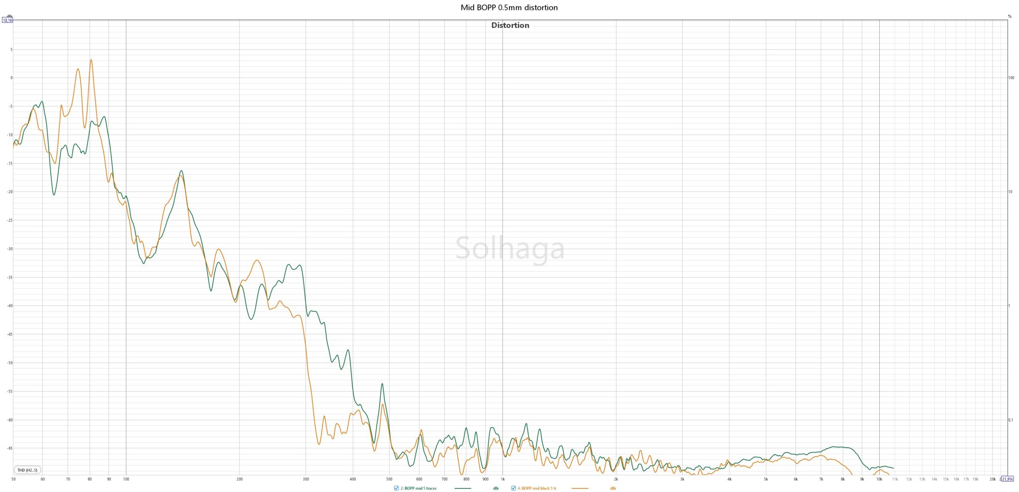

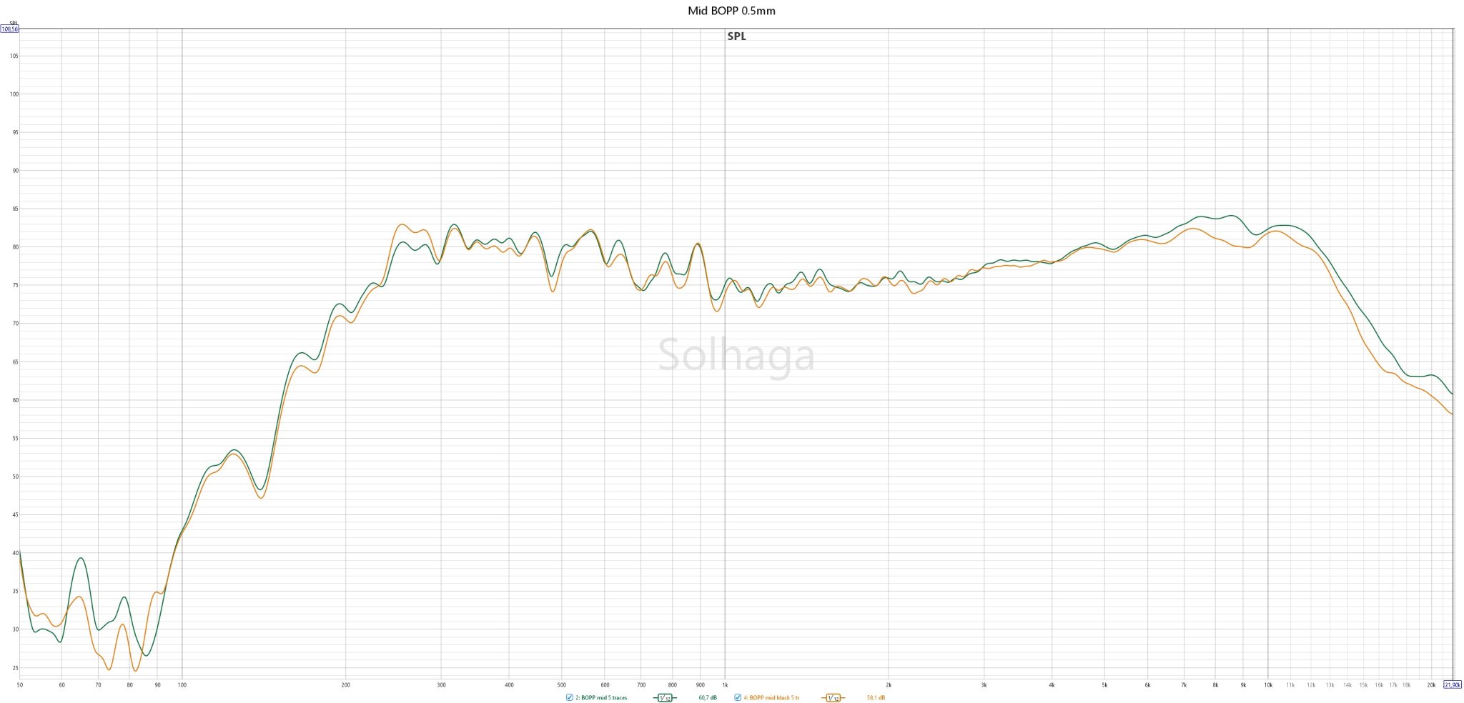

So here's BOPP (20µm) with 0.5mm spacings.
I've also tried to spray paint the mid membrane.
Not much difference in SPL but lower distortion from 300Hz.
Here are more HD distortion for that one:

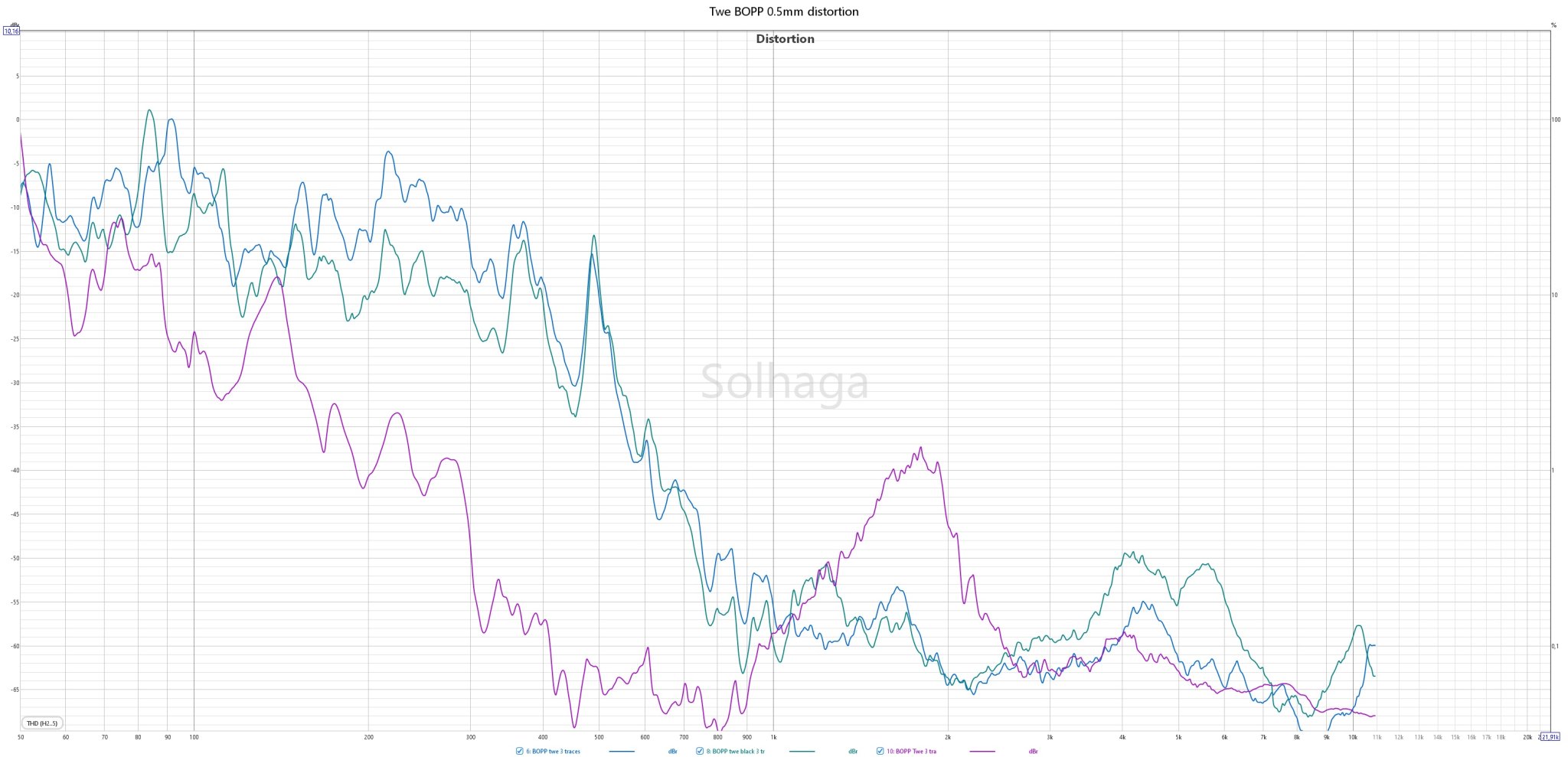

For the tweeter it looked a lot worse, so I tried 3mm aluminium tape on the edges to get better corrugation:
And that helped, at least from 3kHz (with tape is purple):
More HDs for the tweeter with tape:
I will now test the 12µm PEN with 0.5mm spacings.

Hmm seems 0.5mm and 1mm is a rather huge difference when talking non driven mylar or other type of backing !
Yes, for BOPP it's -60dB from 400Hz (red) compared to -65dB from 300Hz for 0.5mm painted black (teal):
For the spray painted membrane I took a run of the mill spray paint, the same I've used to paint the speaker's front.
I only sprayed one layer.
But perhaps I can use a more suitable kind of for example spray able varnish or coating to stiffen the membrane.
Any suggestions?

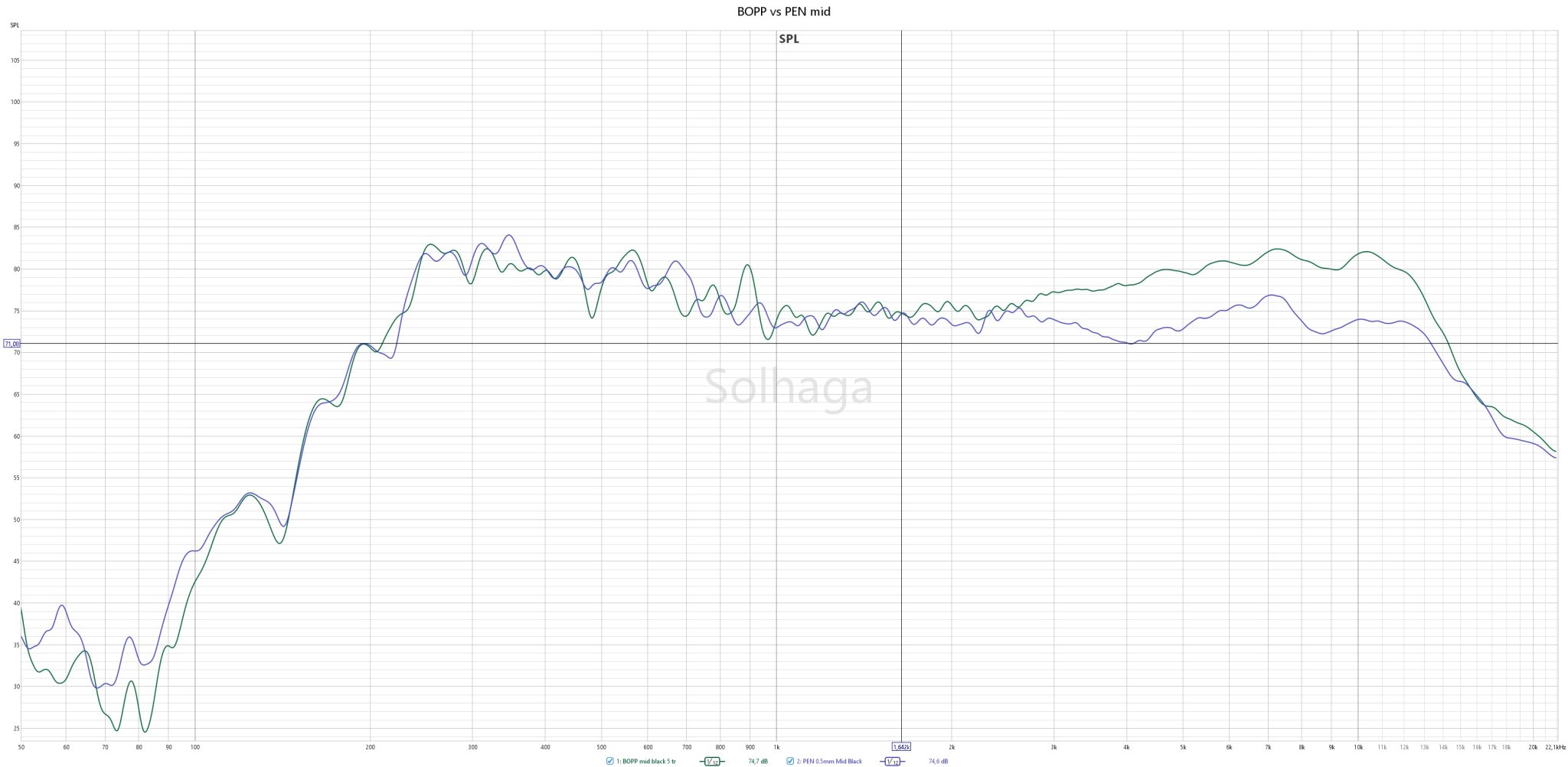

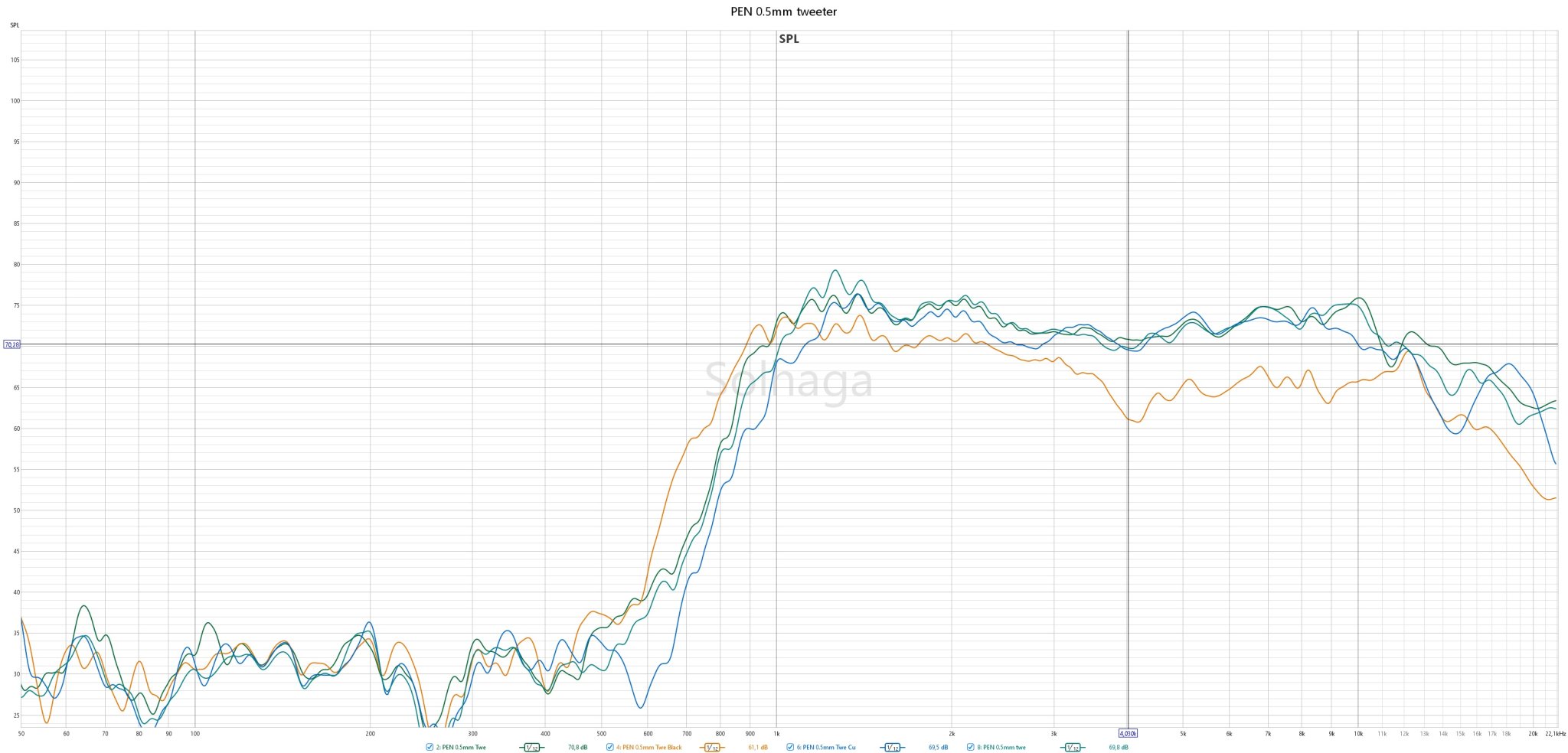

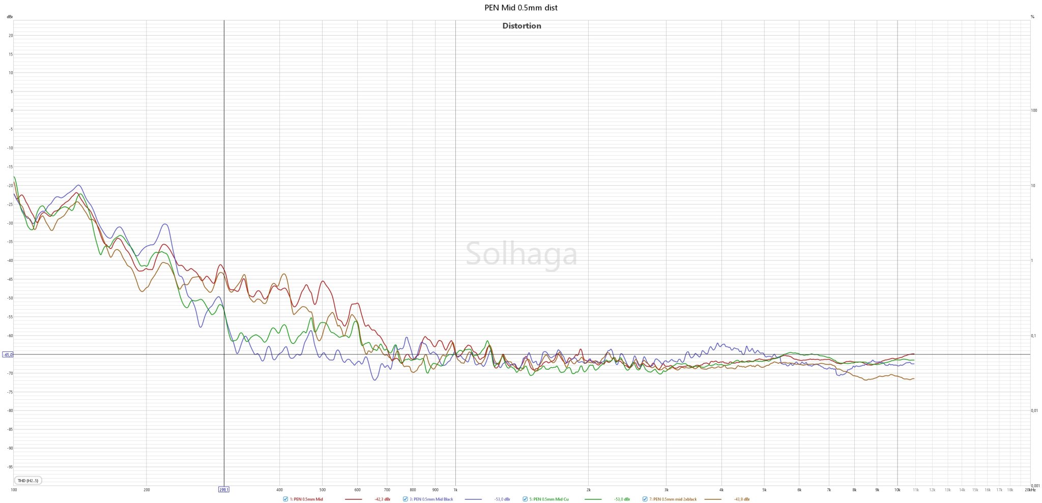

12µm PEN with 0.5mm spacing, the same membrane designs as above.
Mid:
Plain corrugated membrane (red),
Spray painted membrane (blue),
2 mm copper on the edges (green) and
Multiple layers of spray paint (brown).
SPL:
Distortion:
Also with PEN, the spray painted membrane (blue) is the winner with usable SPL and low distortion from 300Hz; -65dB (0.06%) is okay don't you think?
I noticed that for that membrane, the SPL is down at 4kHz and the distortion is up.
It is worth investigating further even if the mid's range from 300Hz to 3000Hz.
I also reckon that multiple sprayed membrane just got to much paint in the pleats or it partially dissolved the PEN.

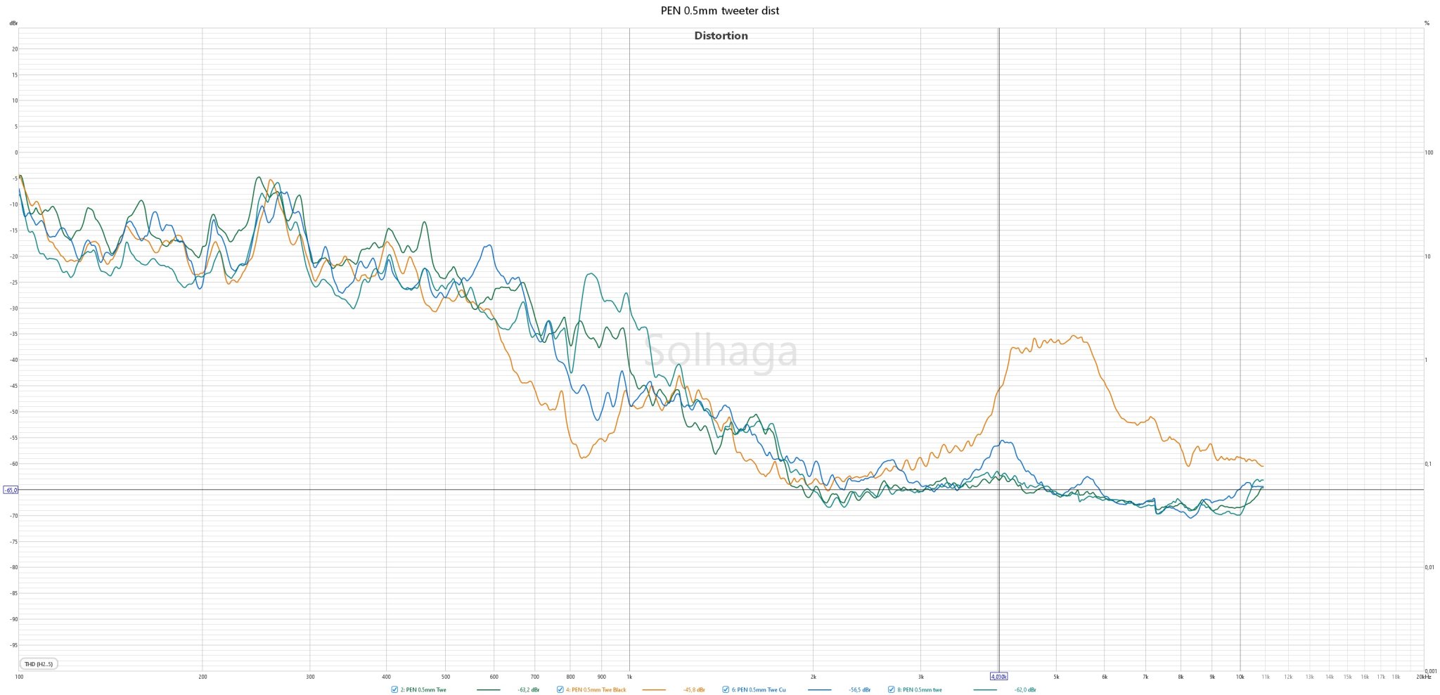

Tweeter:
Plain corrugated membrane (green),
Spray painted membrane (orange),
2 mm copper on the edges (blue) and
Plain corrugated membrane again (teal).
SPL:
Distortion:
For the PEN tweeter membrane it's the plain corrugated that is the best; around -65dB from 2kHz and up with as low as -70dB around 10kHz.
I did two sets of measurements of that membrane, the last one after having removed the copper tape.

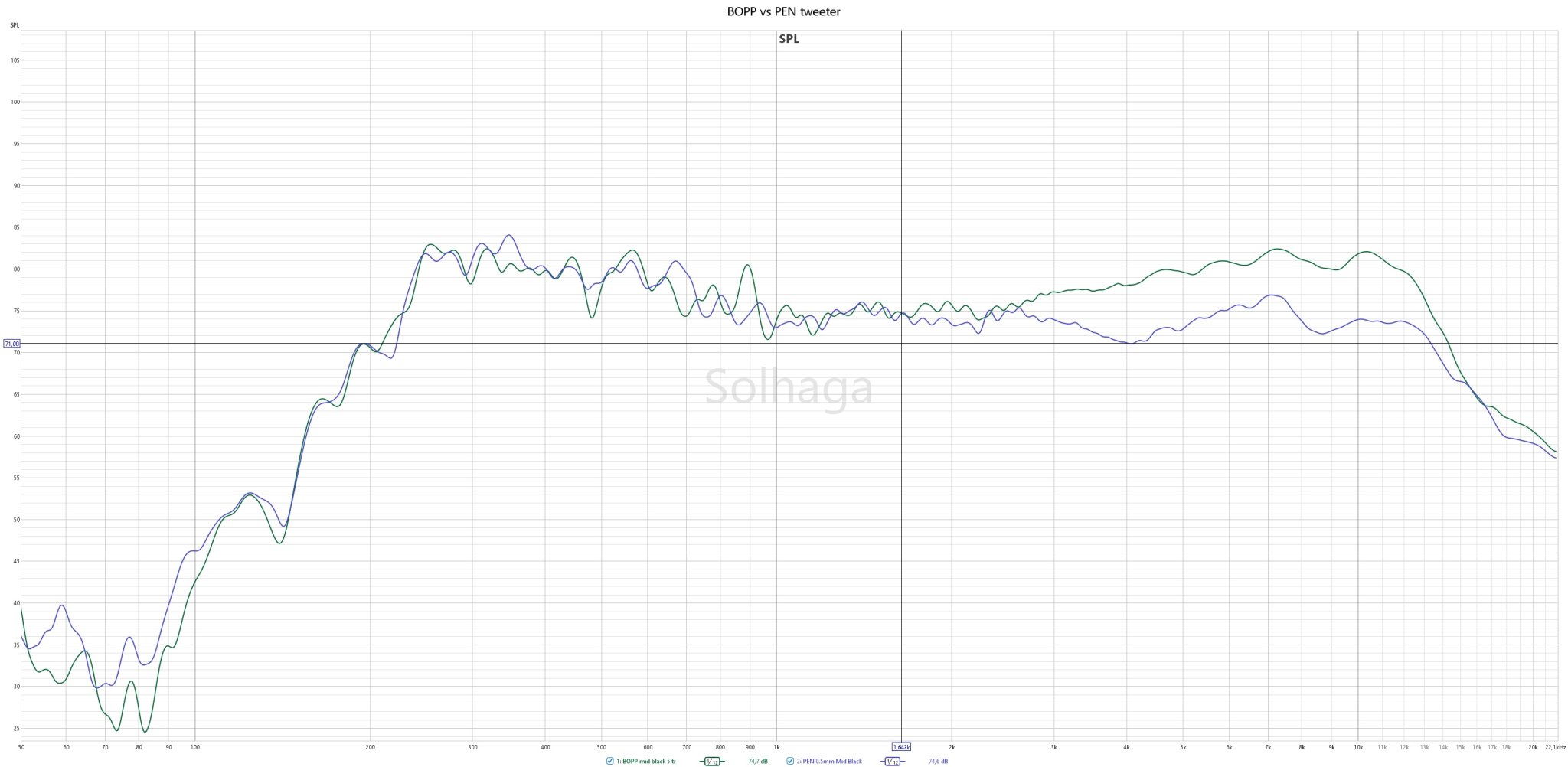

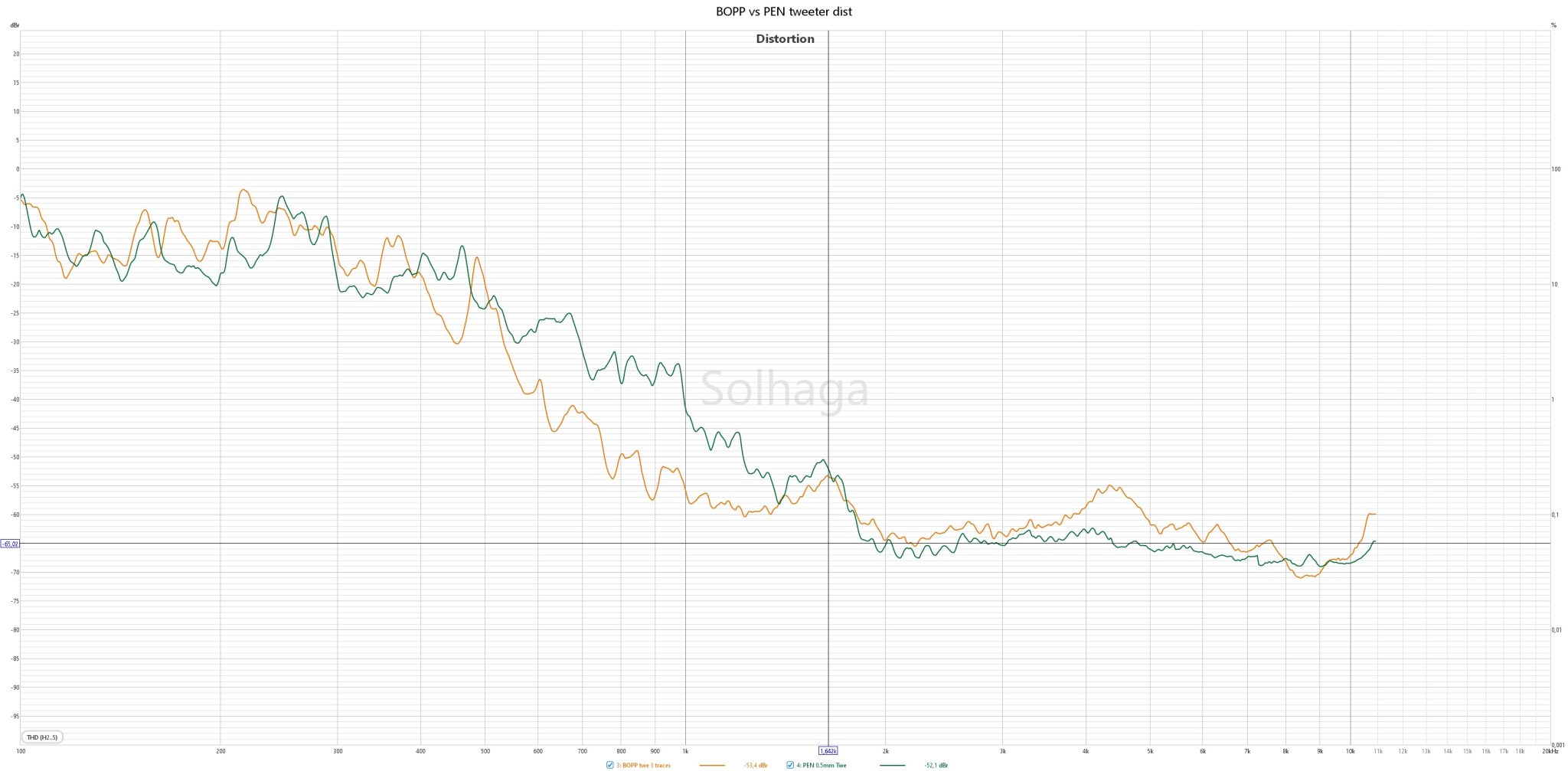

To summarize this:
For the mid it's spray painted BOPP and for the tweeter it's plain PEN.
Mid best BOPP vs PEN:
Distortion:
Tweeter best BOPP vs PEN:
Distortion:
So with that settled (please tell me if I'm wrong!), I can finally get out of this rabbit hole.
But it comes with a huge downside; the resistance for full lenght membranes will be too high.
I'll have to have two tweeter membranes in parallel and three mid membranes in parallel.
I then have to design retainers where the intermediate membrane ends can be connected.
Mid:
SPL:
Distortion:

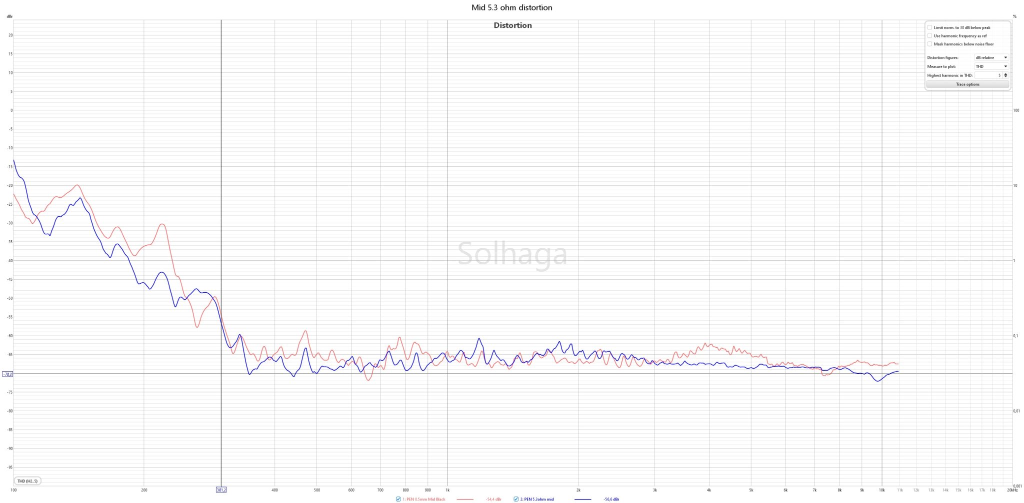

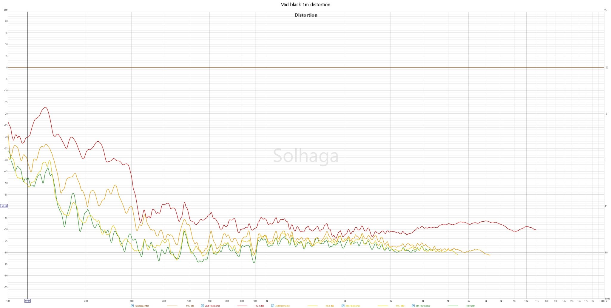

Let's look at possible combinations of the five and tree traces of the mid and tweeter membrane aluminium traces instead of having multiple membranes in parallel.
For the mid membrane I can then let the inner traces be in series and the outer in another series.
That will give 13.2Ω and 8.8Ω respectively. Those two circuits are then coupled in parallel, that gives 5.3Ω.
The current for the outer traces will then be 50% higher than for the inner traces.
But the magnetic field density is lower there, so it should all even up.
Comparison between ordinary mid (red) and as described above (blue), both are sprayed black paint:
Not much differences, so the new configuration will be the final membrane.

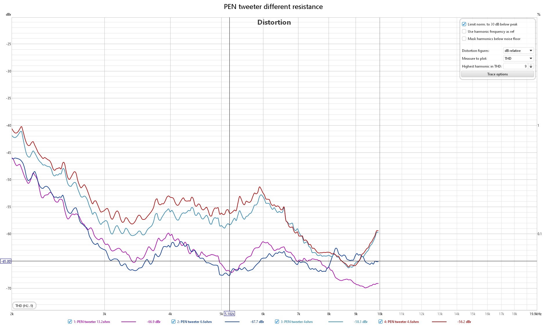

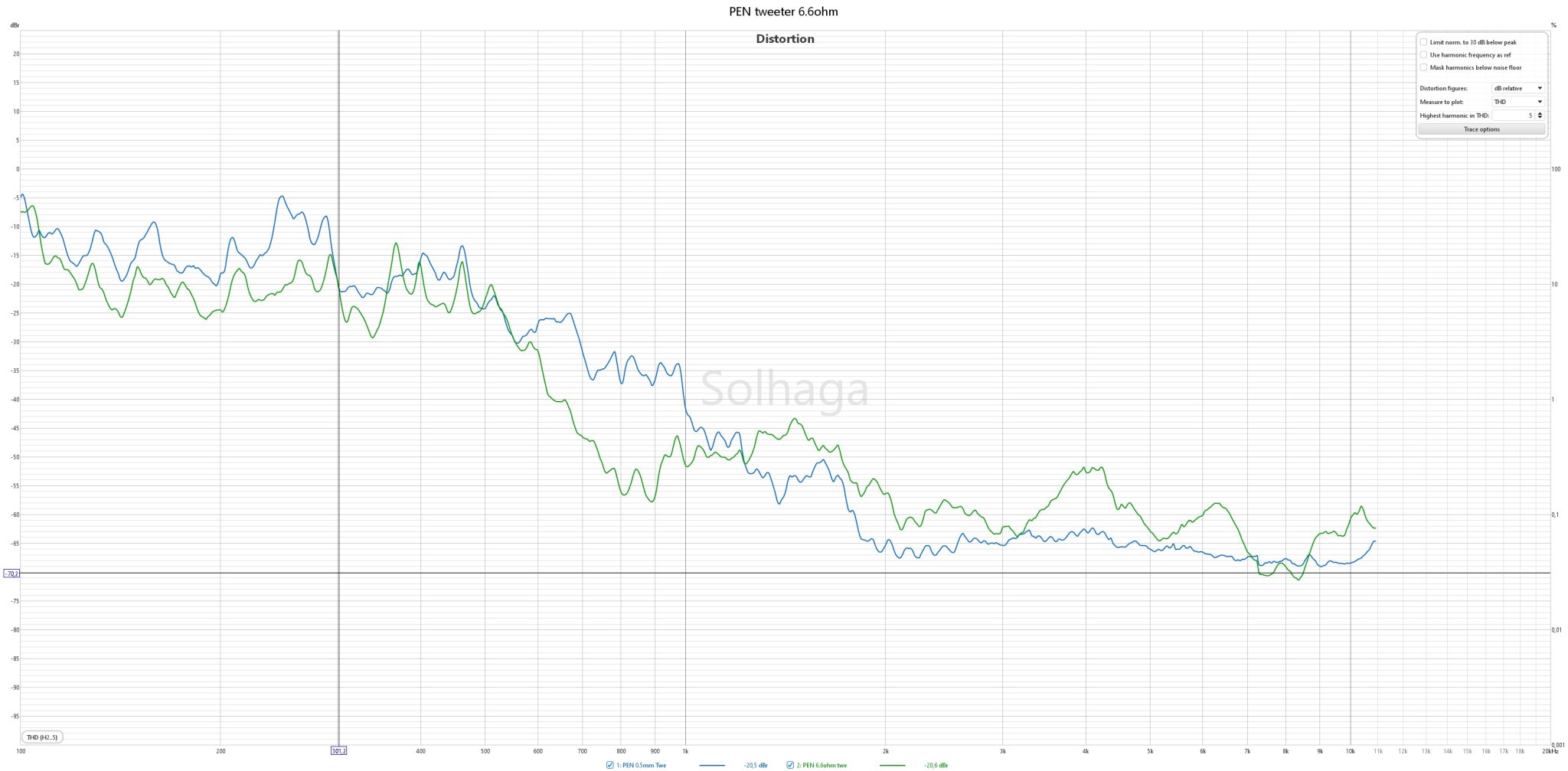

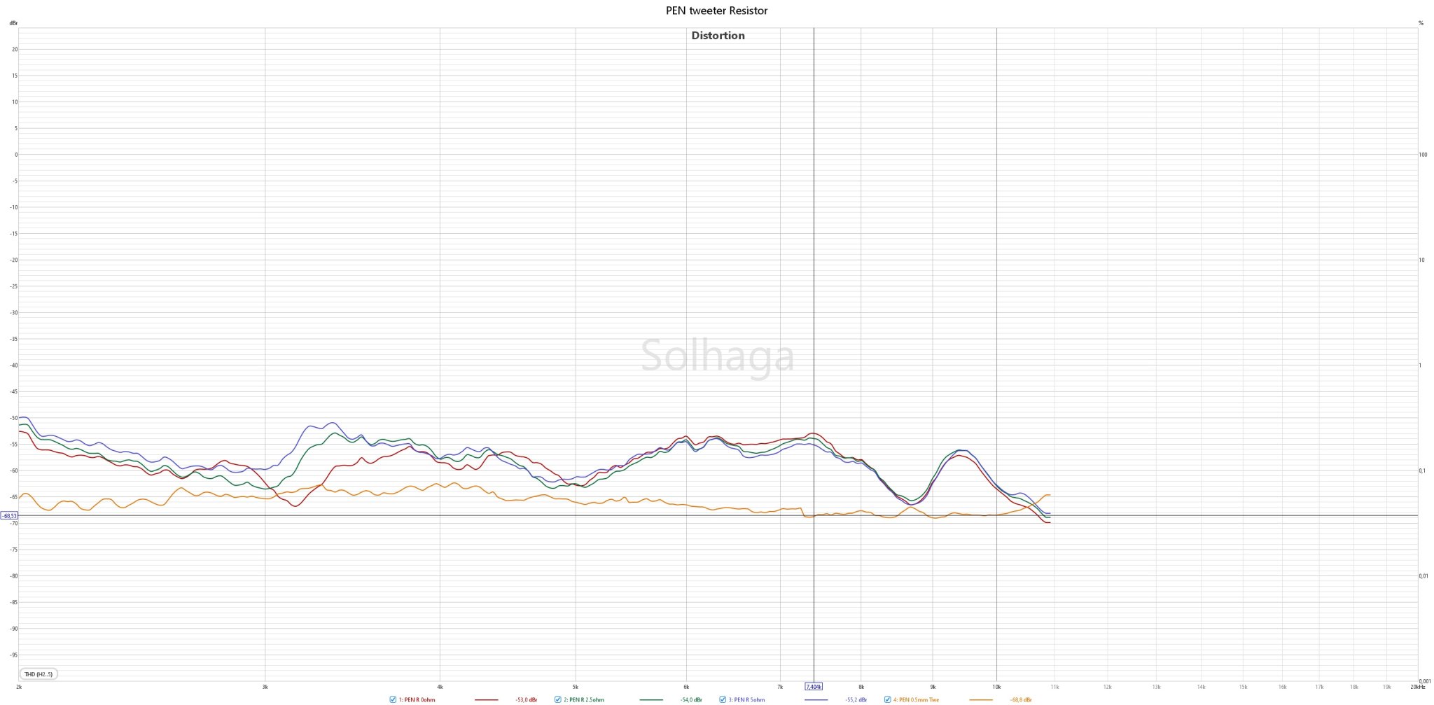

I did almost the same for the tweeter. The outer traces are in parallel (2.2Ω) and in series with the inner (4Ω).
That gives 6.6Ω for a full length membrane. So this time the current in the outer traces are lower than the in the inner.
Normal tweeter in blue, 6.6Ω in green.
So the overall distortion went up and especially the 3HD.
It resembles the results when I had the heavier copper tape on the edges.
I then reckon the current in the outer traces now are too low.
I will make a new tweeter membrane where the inner trace in series with an external resistor (4Ω?) will be in parallel with the two outer traces in series.
So the total resistance will be 4Ω and the inner and outer current will be of the same magnitude.
I can then even experiment with various resistor values.
Even with different external resistor values, the distortion is still too high compared to a normal series tweeter (yellow):
Distortion is almost 15dB higher for some frequencies.
So I reckon there are other things going on here:
Any suggestions on how to go forward?
- traces not centered,
- tweeter touching the sides or the mid membrane,
- membrane is re-used too many times resulting in weak corrugations,
- wrong kind of surround or weakened surround.
I cleaned up a bit and inserted new surround foam.
Then I mounted the tweeter membrane alone:
Blue is the standard tweeter membrane configuration that would be 13.2ohm in full length. All traces gets the same current.
Purple is a membrane with the inner trace in series with the two outer traces that are in parallel. That's 6.6ohm full length.
The outer traces only gets half the current each.
Teal is the same as purple but with a resistor in series with the inner trace. Full length resistance is then 4ohm.
The outer traces gets a little more current.
Red is the same as teal but with a higher resistor value in series with the inner trace. Full length resistance is then 4.6ohm.
As the blue and purple traces are almost the same, I can use the purple configuration without having to have several membranes in series/parallel.
So now it is time to build the full length SMAPPP motors...

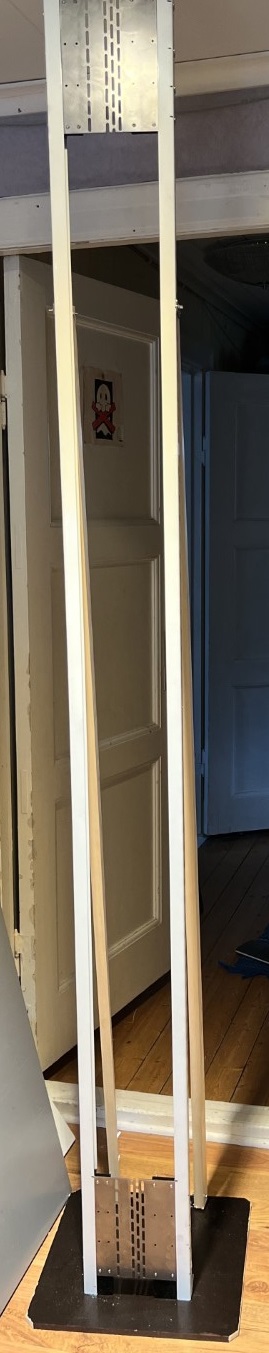

This is the intended frame:
I've made mounting jigs for gluing the magnets:
One for each panel; I don't know yet if I can reuse them:
The left front panel has the same pattern as the back right panel and so has the back left the same as the front right.
The eleven front left panels glued in less than an hour, sadly the glue has to cure for 24 hours.
All 528 magnets have been glued to the 44 panels.
So let's mount the panels and the baffles to the frames:
The front will be spray painted black once all the screws are mounted..
Panels and baffles are glued with the same glue I used for the magnets; UHU Max Repair Power that Supermagnete.de recommends:
Back side:
Perhaps I should spray paint it as well; the baffles comes in all sorts of colors.

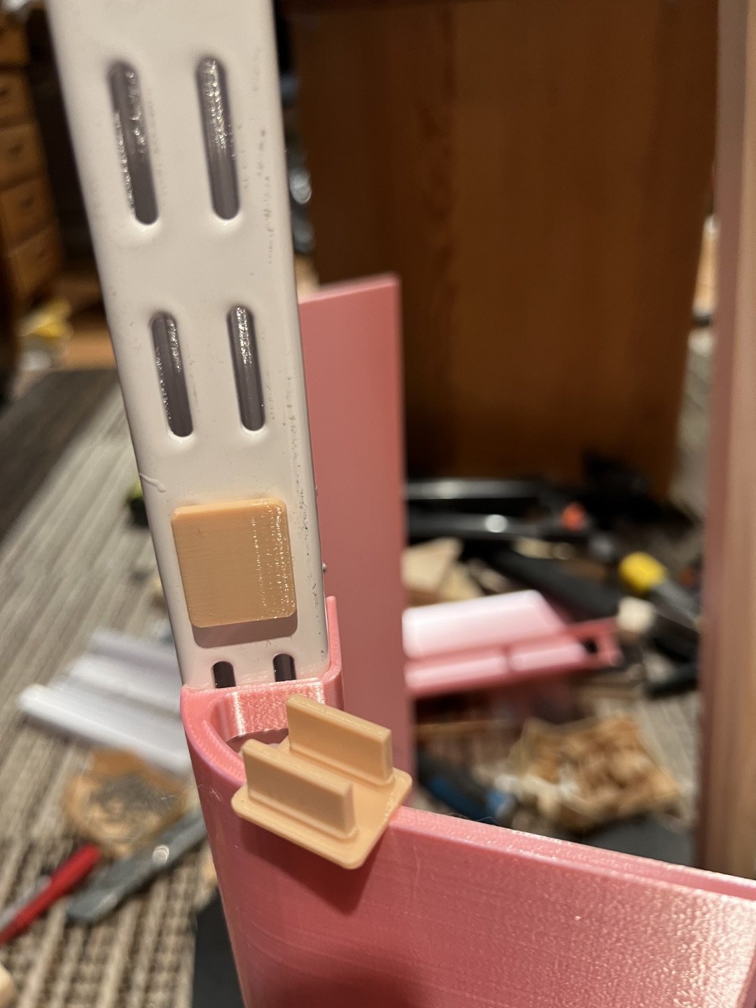

I've made small plugs to lock the panel assembly to the frames. Glue is of course applied.
Like this.
Back side:
Like this.
