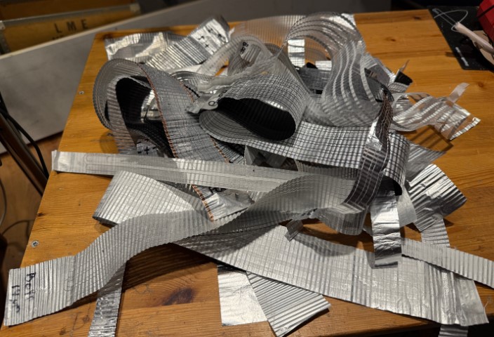

I've made PEN, BOPP and Alu+PET membranes with 14µm aluminium foil.
For the tweeter the Alu+PET had the less distortion almost at par with the best PEN membrane but sadly all 14µm membranes dropped too much in the highs.
For the mid none of the 14µm aluminium foil membranes could match the 6µm aluminium foil with PEN membranes.
So PEN and 6µm aluminium foil it is. I hope that this was the last rabbit hole.

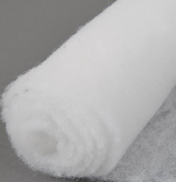

At the same time I can remove the foam surround and replace it with Quilt Batting:
One last straw though.
What if I use the 14µm aluminium foil only for the 3mm wide circuit and then the 6µm aluminium on the flip side of the membrane?
The weight will be the same as for a 14µm aluminium foil with fillings.
It'll behave as one membrane throughout the width and it'll corrugate easy and there will be no need for alignment.
Is there a specific reason you have decided to not use the Clas ohlson white foam strips anymore or is this just for testing?At the same time I can remove the foam surround and replace it with Quilt Batting:
I suspected that the foam strips were not even compressed, it would seem like the compressing side is compressed more than the stationary side and by doing so gets the membrane not exactly in the middle.
