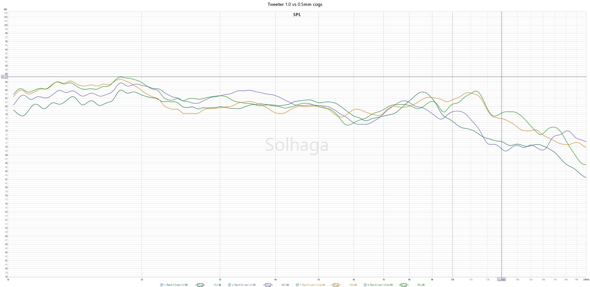

Here's some measurements with a 1+2 with fill corrugated with 1.0 mm 40 cogs rollers as reference (green trace).
SPL at 0.3m:

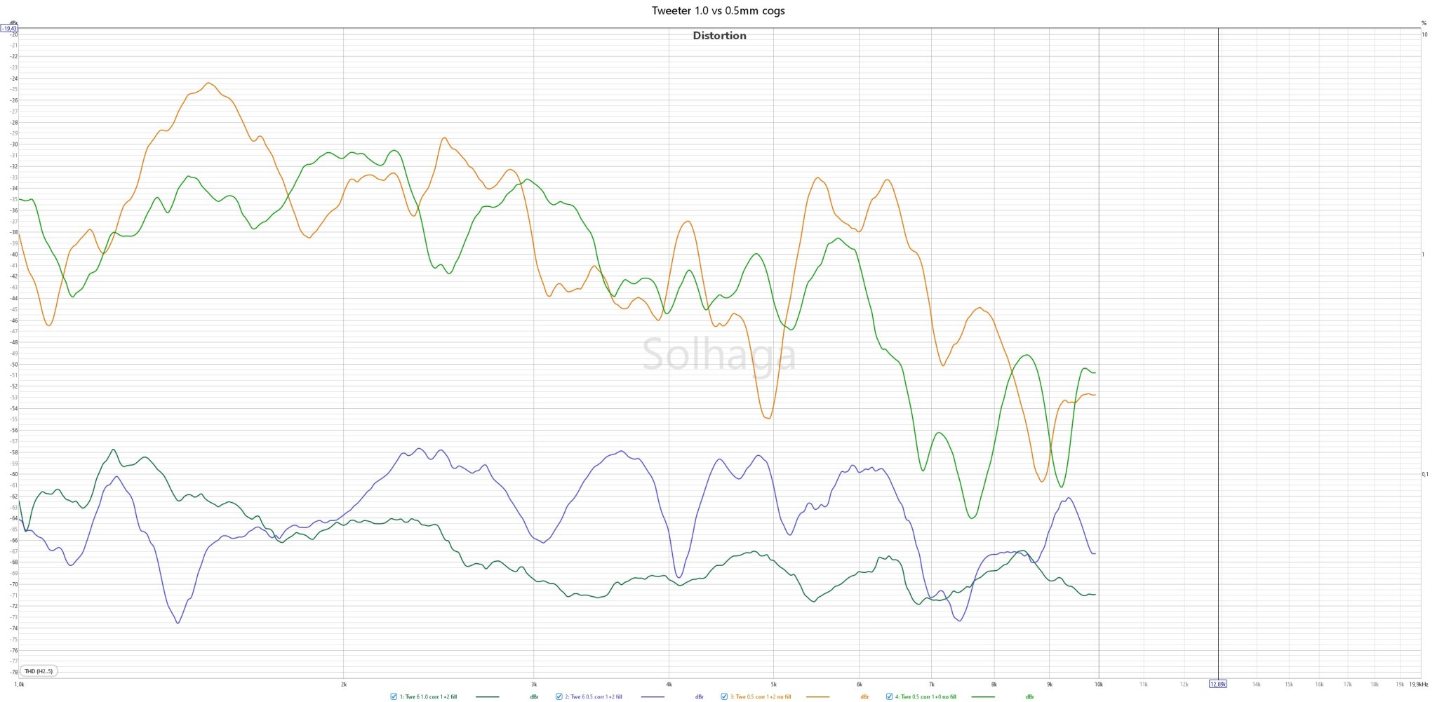

As I see it, the 1+2 with filler and 0.5mm cogs (blue trace) is the winner. One thing that is different from the 1.0mm version is that I removed any glue residue on the 0.5mm versions.
I don't think it was the reduced weight as such that made the difference; the lighter 1+2 and 1+0 without fillers were worse above 16kHz.
Distortion at 0.3m:
Here the SPL winner above (blue trace) has higher THD as the 2+1 with filler and 1.0mm corrugation (green trace).
This can of course be unrelated to the cog sizes; a lot of membranes has to be tested to get secure results but time and effort are not endless.
I will however test 1+2 membranes corrugated with 0.67mm cogs and 0.75mm cogs.

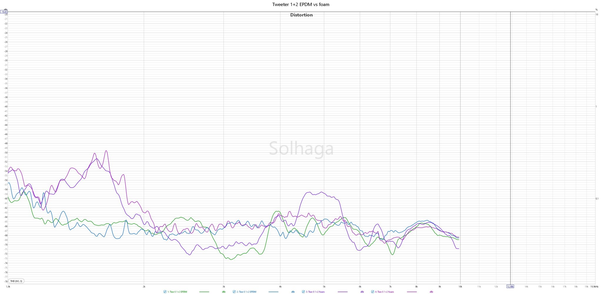

So what about foam vs EPDM?
The two purple one are foam at 0.3m (3) and 1.0m (4). Compared to the two other EPDM (1) and (3) at 0.3 and 1.0m respectively.
I reckon that the foam surround even if softer, has longer contact with the membrane than the EPDM surround, the EPDM having a more pointy contact surfaces.
The take away from this rabbit hole is the keep the EPDM and the 1+2 with filler corrugation but with glue residual removal.

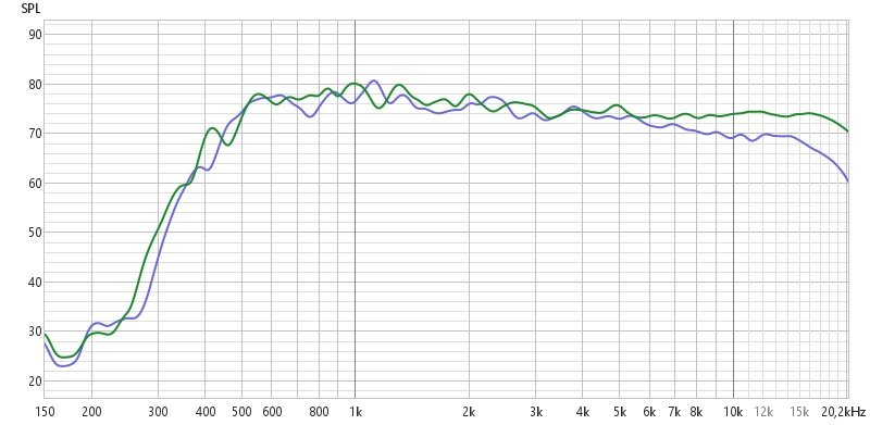

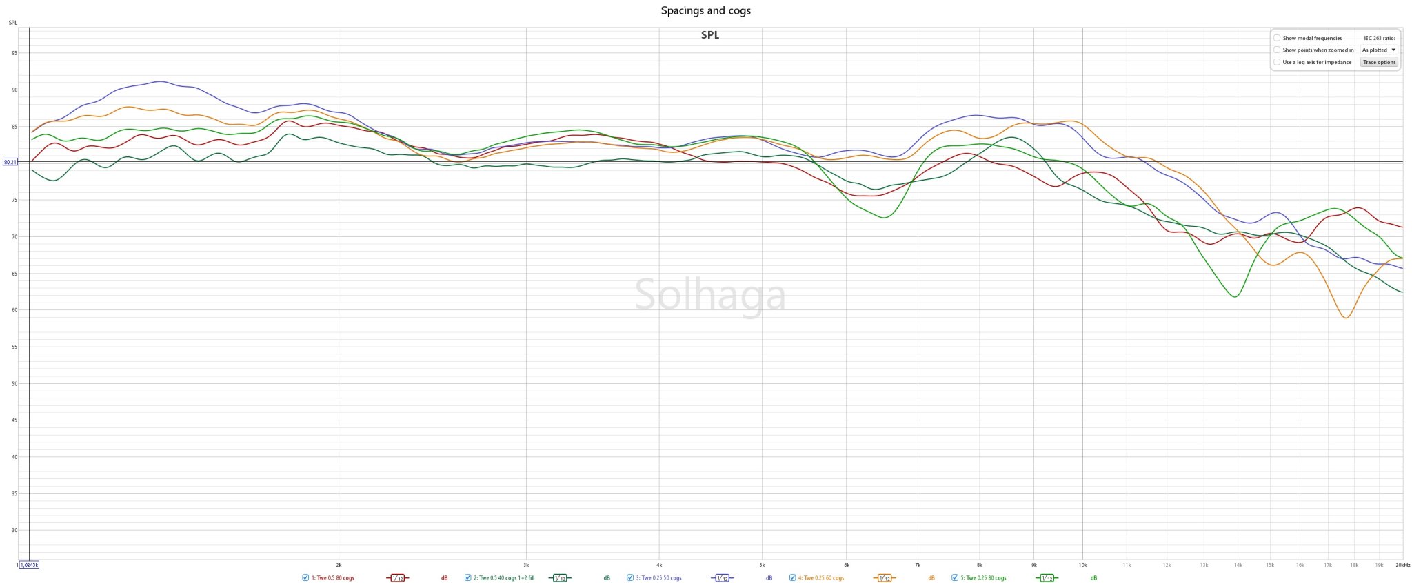

Some measurements:
SPL
The 60 (orange) and 80 (light green) cog membranes has to uneven SPL response for my liking.

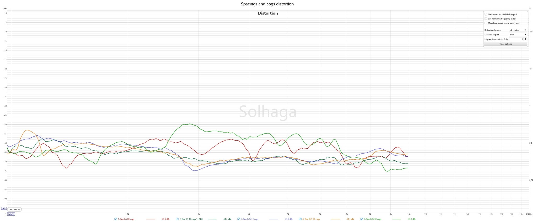

Distortion (THD):
The 80 (red and light green) cogs membranes has too high distortion. I suspect that the reason for it is that the membrane is too thin so that the suspension just doesn't "grab" the membrane.

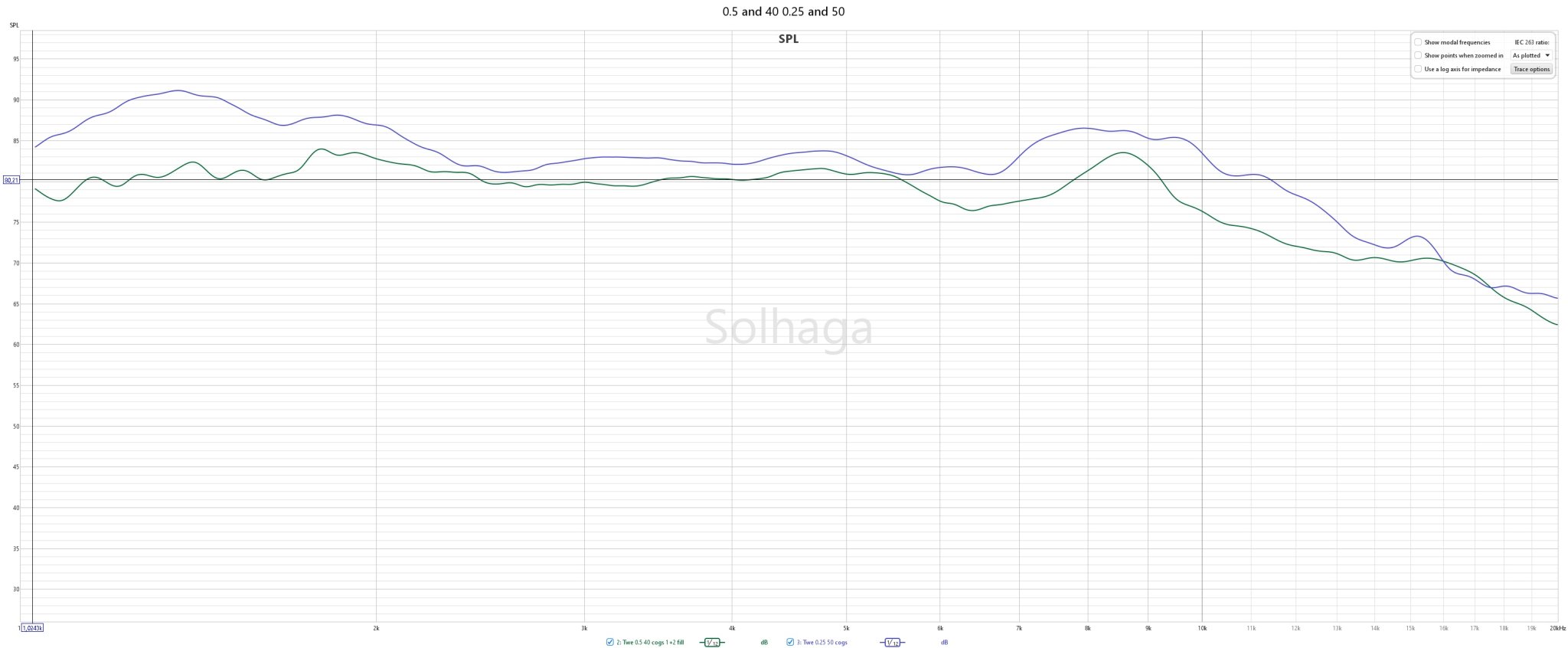

The conclusion of the above is that 0.5mm spacing and 40 cogs together with 0.25mm spacing and 50 cogs is almost tthe same.
0.25mm spacing and 50 cogs has a slightly more even response.

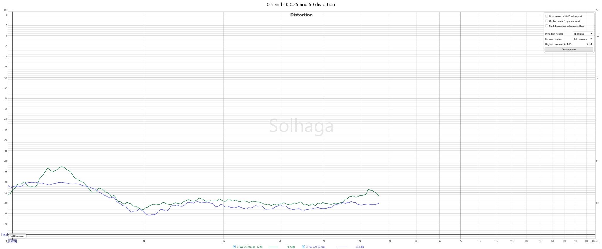

THD
Hard to chose a winner based on THD.

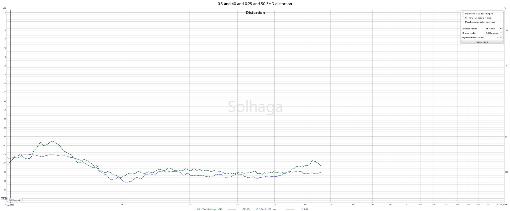

Distortion 3HD:
So the winner is 0.25mm spacing and 50 cogs (blue) corrugation.

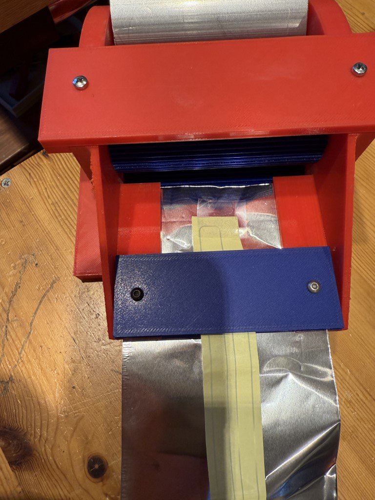

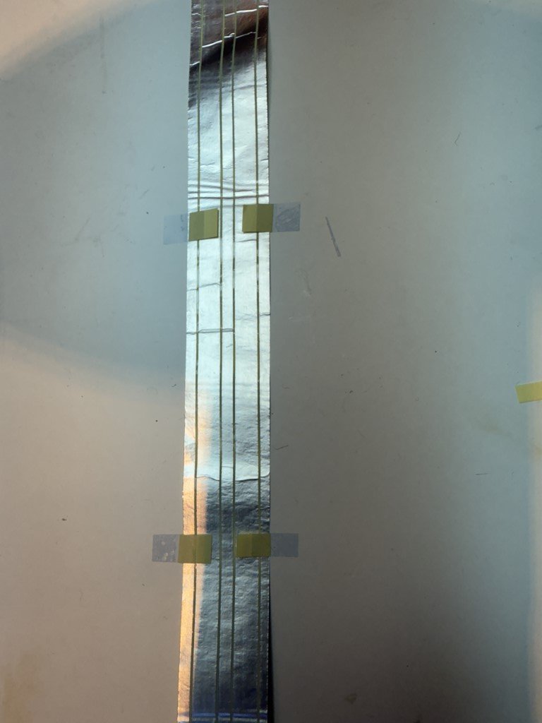

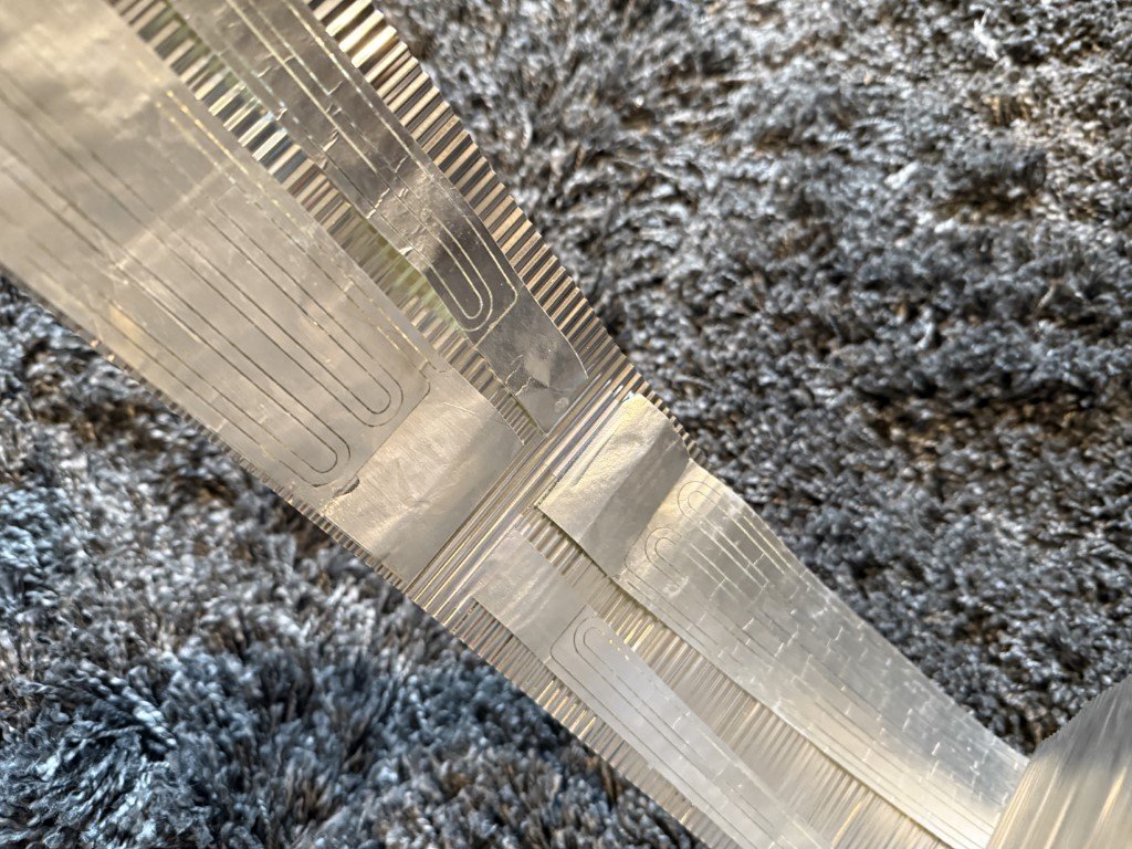

Since it came in another thread, I have some update on my corrugation method above:
A couple of rabbit holes later...
I've managed to bake membranes with the 3M 74 PET film.
I use 40µm aluminium foils with the membrane in the middle like a sandwich.
The 40µm aluminium foil I use is really for hookahs!
As the membrane and 40µm aluminium foil has slighty different coefficients of expansion and to keep it from sliding from side to side during corrgation, it's wise to only tape the membrane to the start of the membrane and then have paper/tape support along the edges.
The paper should be over the membrane so the membrane will come lose really easy.
As I'm baking the membrane, I use heat resistant tape.

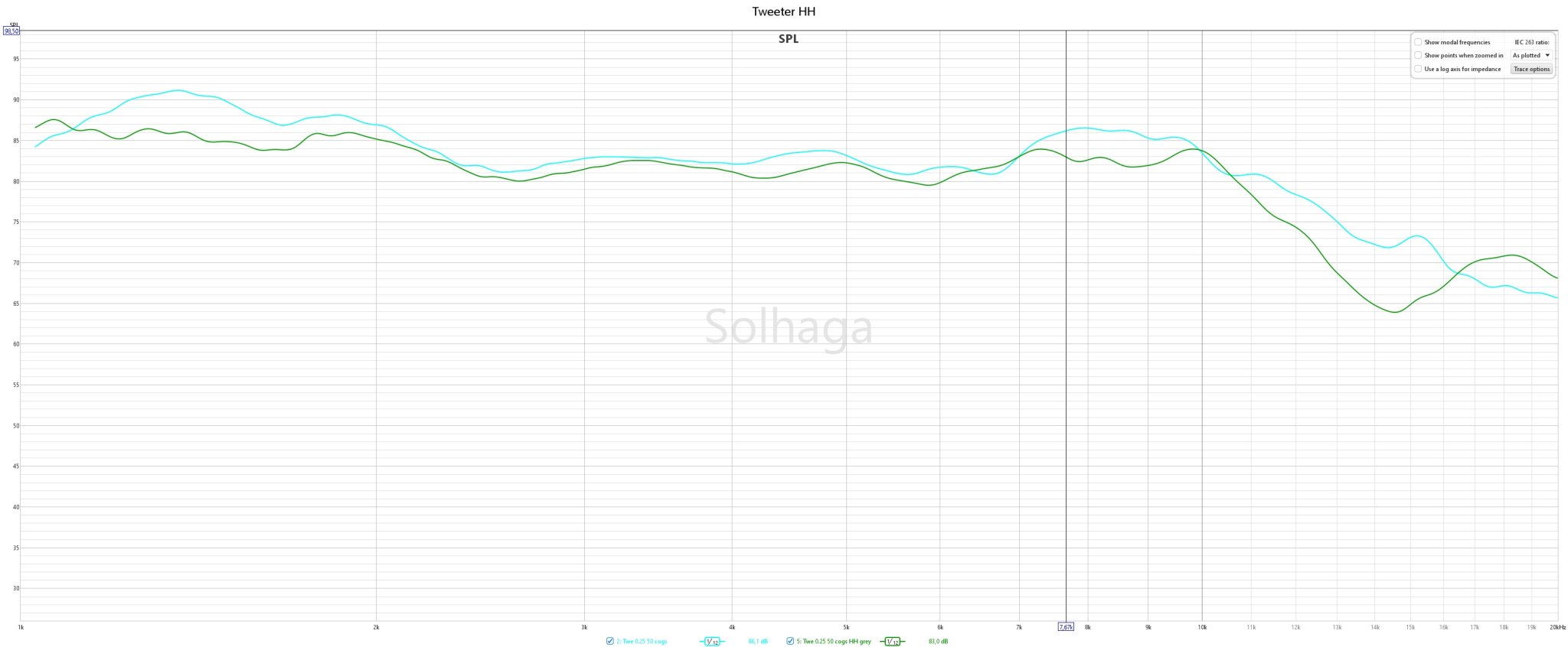

I have also tested the proposed Helmholtz's resonator mitigation; I put strips of this between the magnets on the front plate.
It didn't do any good:
Distortion was more or less the same.
The 0.25mm spacing and 50 cogs membrane (teal) could actually be used, after some EQ that is.

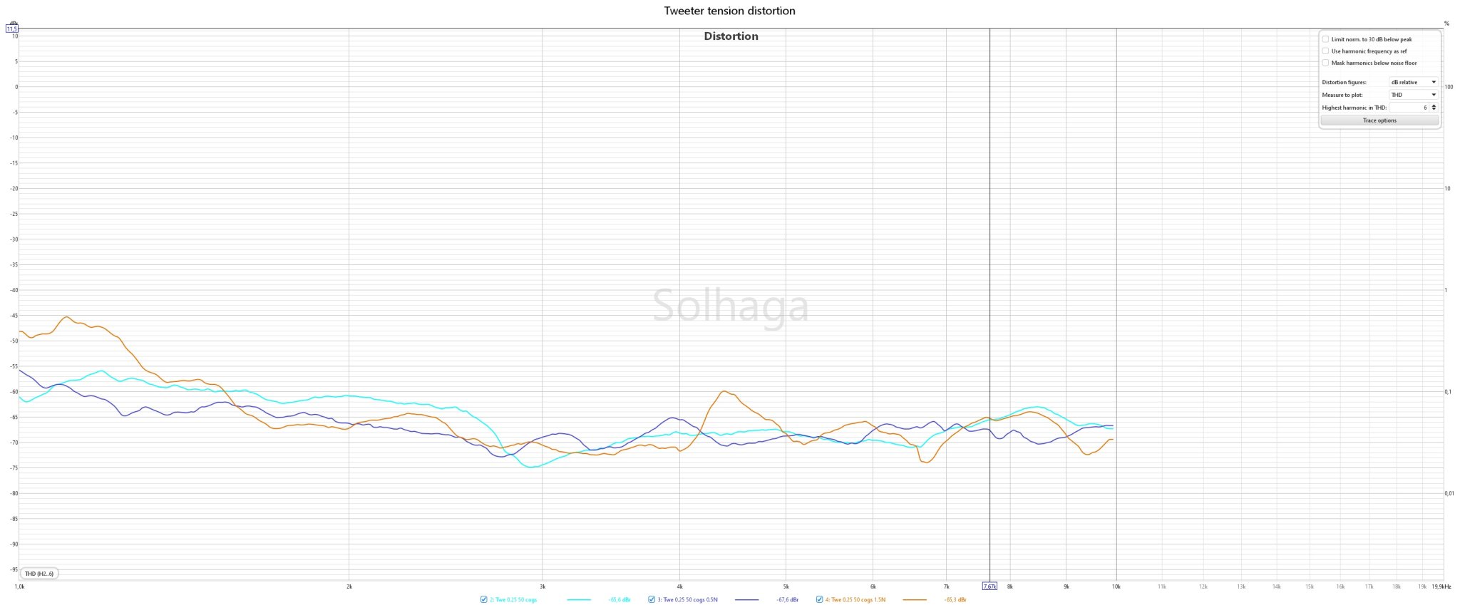

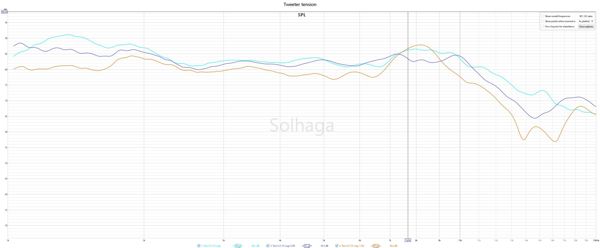

I also tested different tensions as suggested.
Teal, same as above, is without barely any tension, blue is with 0.5N and brown is with 1.5N. So much for the tension!
I will use 0.25mm spacing and 50 cogs for the mid membrane as well.

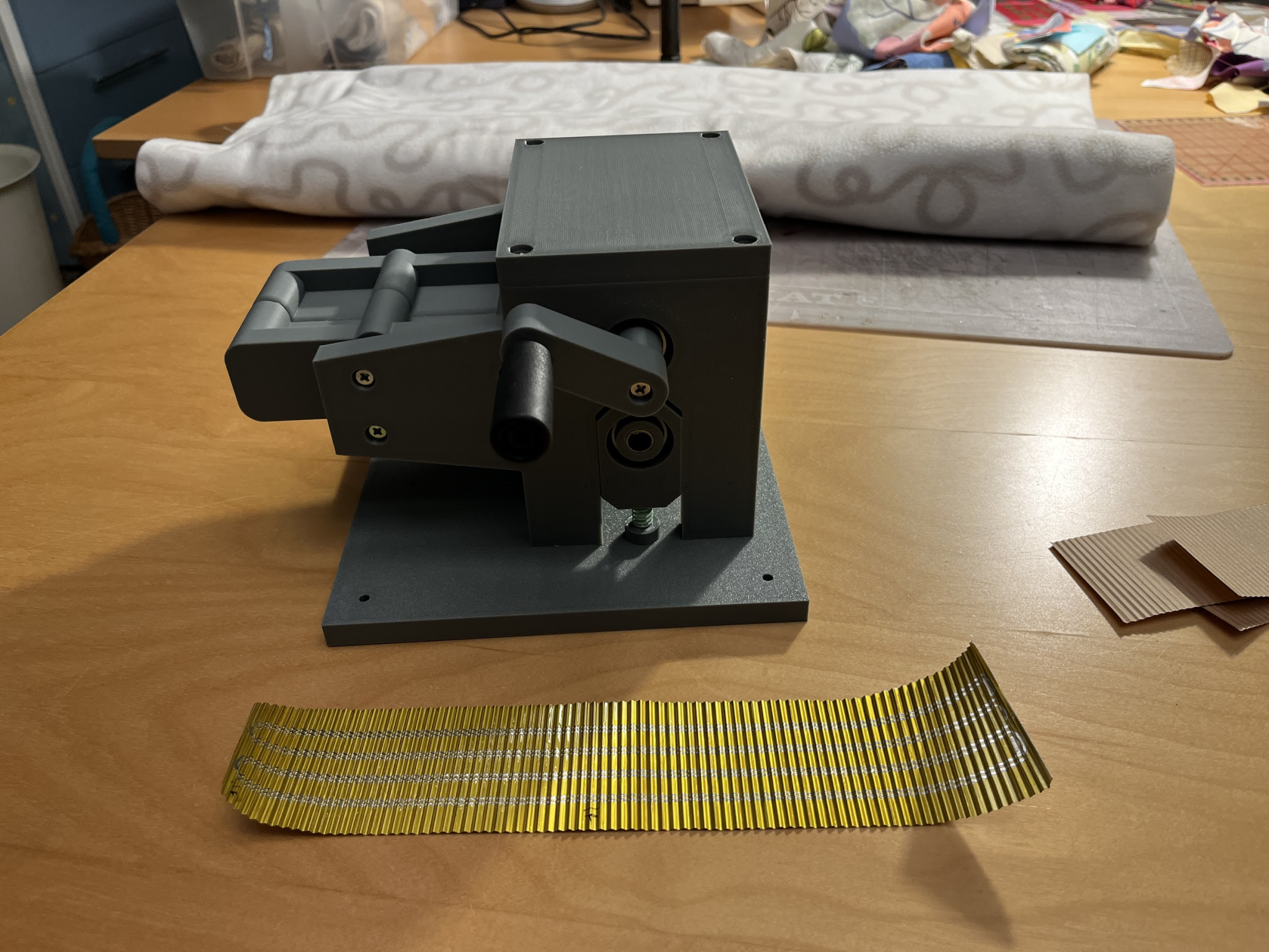

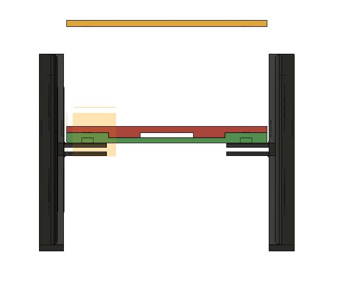

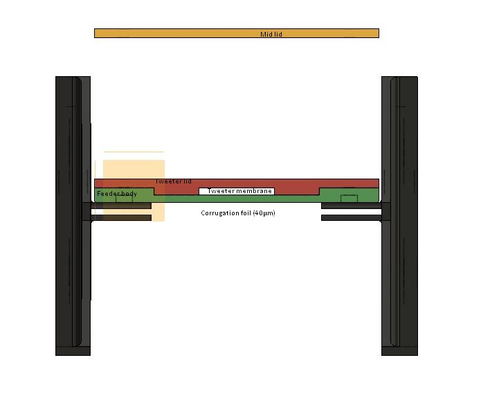

Some update on the corrugation. I've decided to only have one layer of the 40µm baking helper aluminium.
When rolled up, the next turn will enclose the membrane to baked anyway.
By doing so I have better control of the centering of the membrane on the helper aluminium when cranking the rollers.
I've also design a separate feeder for the membrane, the lid, 25mm (red) or 55mm (yellow), is depending if it's the tweeter or mid membrane that are to be corrugated:

The length of the feeder for the corrugation helper aluminium is 75mm and for the membrane helper 35mm. I will soon find out if that's enough.
As I'm using 3M 74 film and 3M 56 film, I don't need no additional adhesive; the intrinsic Thermosetting Rubber does the trick.
As the backing is PET, I can corrugate and bake the membranes and then the Thermosetting Rubber for sure helps as well.

this is a tiny thing i made today, for ther montior 9 cm long version one measurement on axis one when standing up. this will look insane different with 80-140 cm long one. this is not gated so some of the lower end would be lower 🙂
