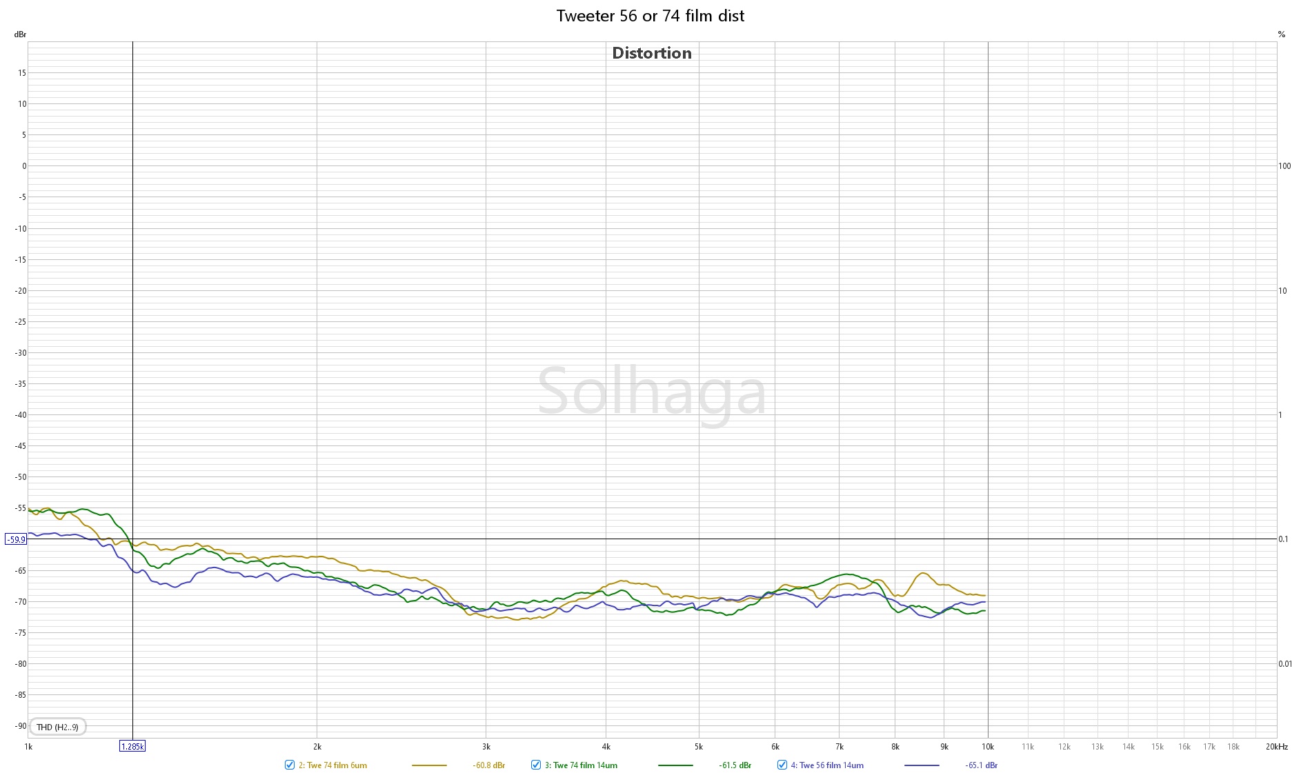

That's an Overlay view where the distortion levels are compared from many measurements.
To be able to compare, all measurements shown are relative a 0dB fundamental level; a perfect EQ.
As I intend to use EQ via FIR filters, I am not that interested in distortion measurements that are not dB relative.

UMIK-2 isn't the most accurate microphone even with the calibration file.
But there are so much other variables that affect the measurements, positioning, no having an anechoic chamber and so on.
And I don't know how accurate my dB-meter is either over the frequency range.
But for sure, I can do a litmus test.

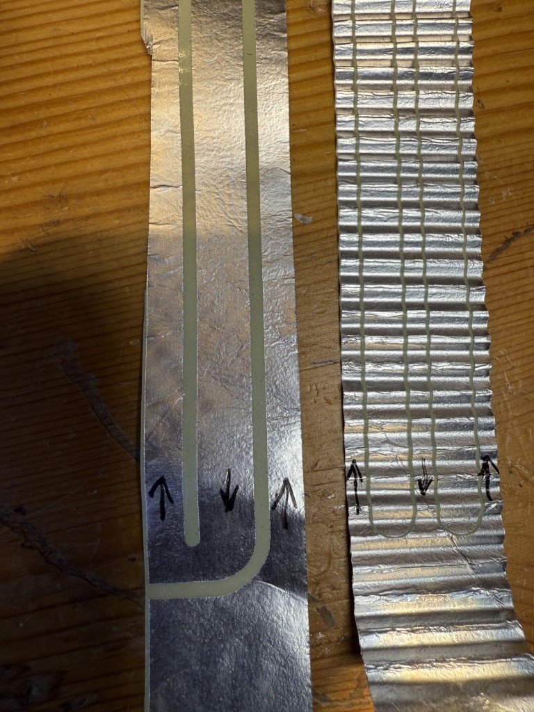

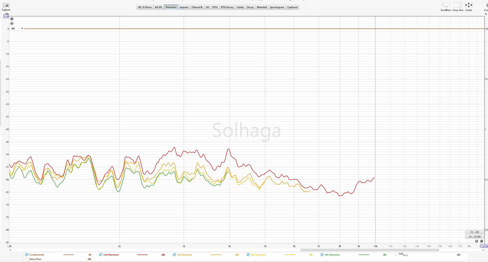

I made an oversized tweeter membrane, oversized in the meaning that the aluminium trace between the magnets were wider than the perfect 3mm.
In this case I tried 8mm between and 5.5mm outside the magnets, the left one in the picture below:
The reason for doing this membrane was to see if I could get away with an easier membrane to cut and weed.
I reckon that the membrane doesn't move that much being a tweeter; at 300Hz you'll need 100 times more movement than at 3kHz.
So the non linearity of the magnetic field density shouldn't matter that much.

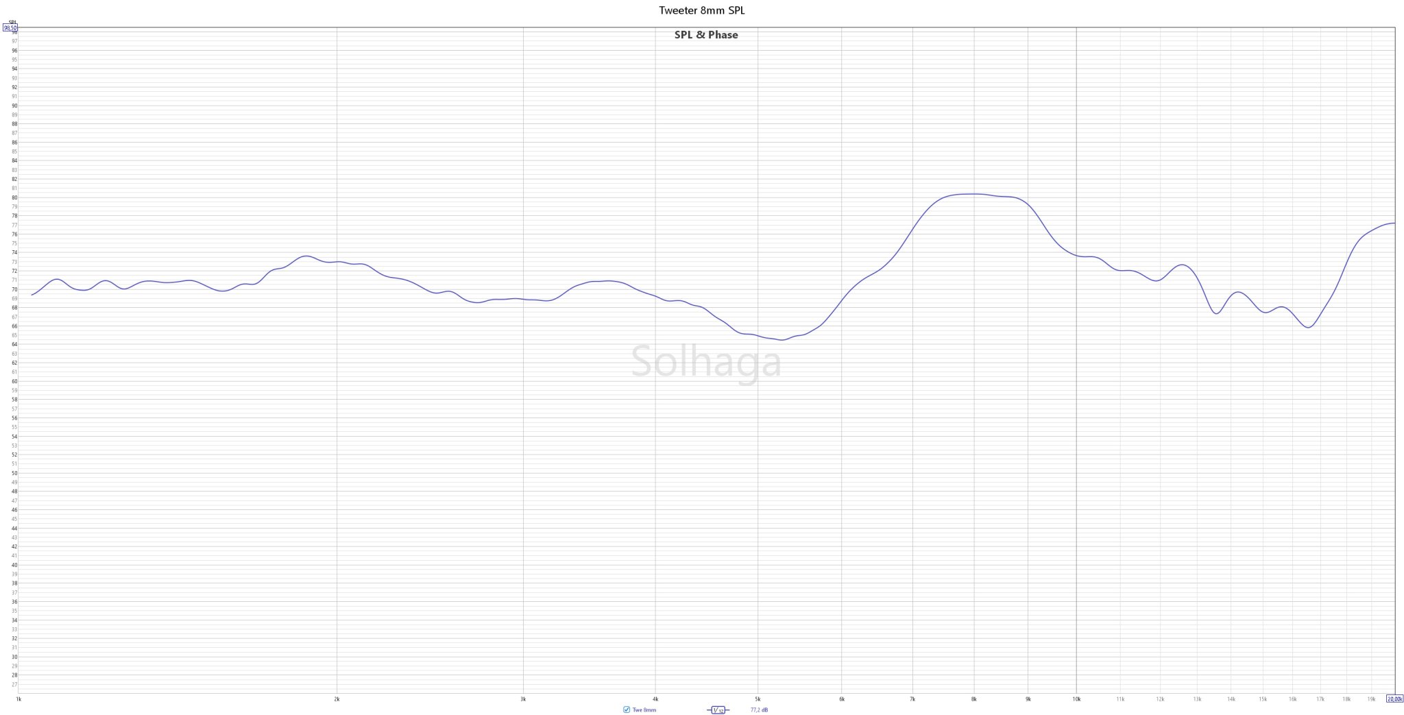

I got a bumpy curve but also good levels in the high end:

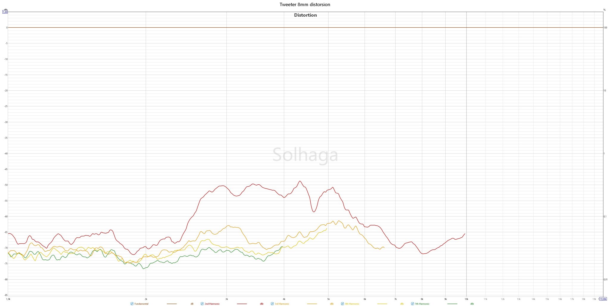

Distortion went through the roof though below 6kHz:
So I guess I'm stuck with the membrane to the right.
I think that I'm stuck the Silhouette Cameo 5 machine and the membranes as they are.
I'll just make enough of them and then pick out the best four.

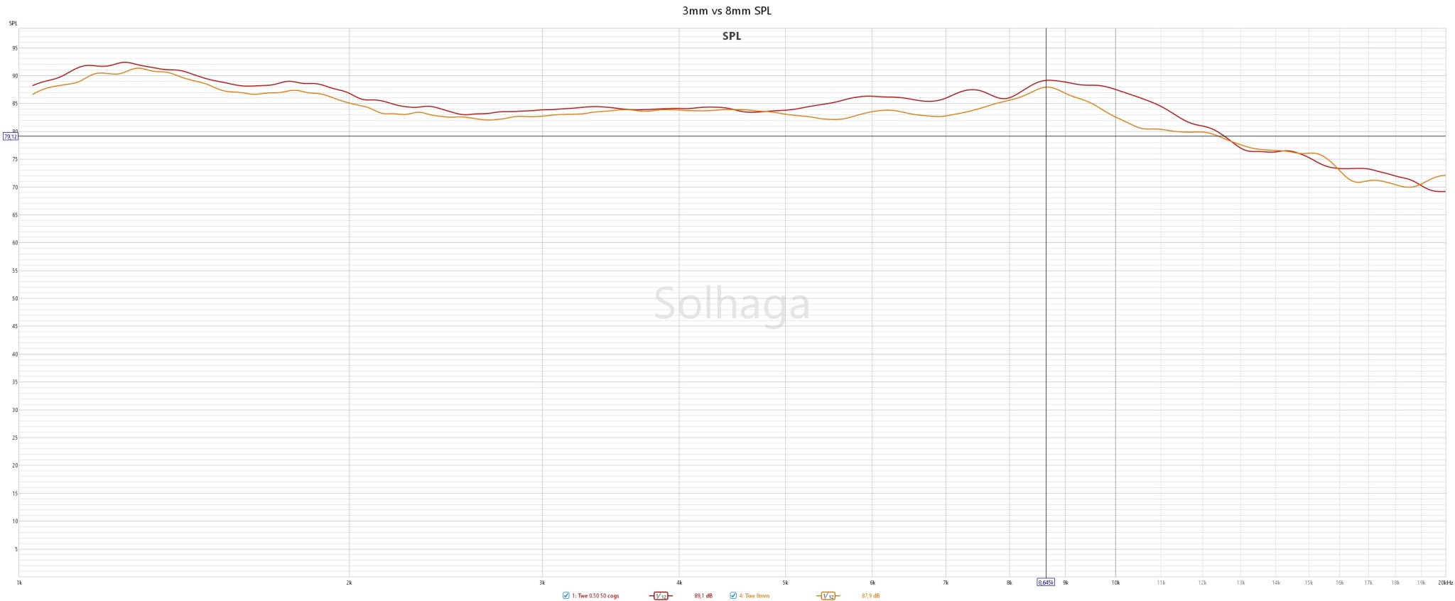

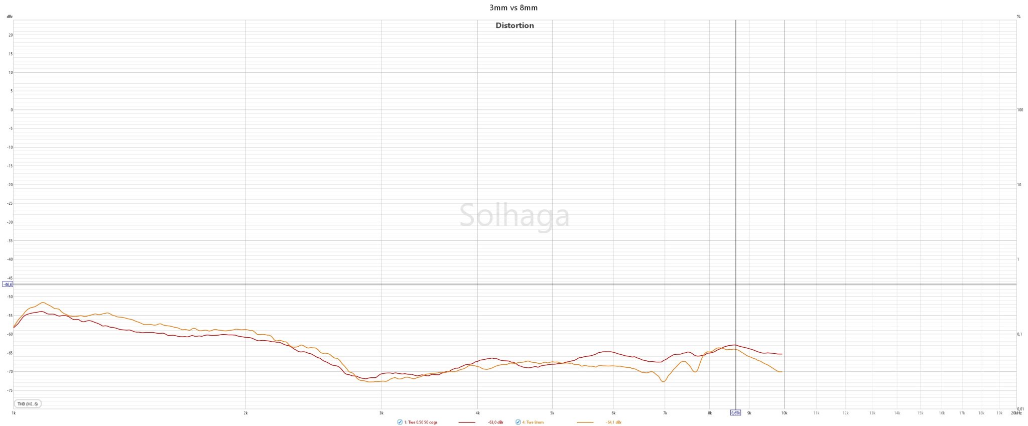

Well, just redid the above measurements.
Here's some overlay with the 3mm membrane as well.
SPL:
Distortion:
And there not much of a difference in both SPL and THD, even for the higher harmonics.
I guess there was a disturbance during the measurement in the previous post.
